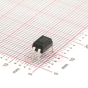

PC814 Series PC814 Series s Features 1. AC input 2. High isolation voltage between input and output ( V : 5 000Vrms ) 3. Compact dual-in-line package PC814 ( 1-channel type ) PC824 (2-channel type ) PC844 ( 4-channel type ) 4. Current transfer ratio CTR : MIN. 20% at I F = ± 1mA, VCE = 5V 5. Recognized by UL, file No. E64380 AC Input Photocoupler g Lead forming type ( I type ) and taping reel type ( P type ) are also available. ( PC814I/PC814P ) s Outline Dimensions PC814 2.54 ± 0.25 4 CTR rank mark Primary side mark PC814 3 6.5 ± 0.5 ( Unit : mm ) Internal connection diagram 4 3 1 2 0.9 ± 0.2 1.2 ± 0.3 1 2 s Applications 1. Programmable controllers 2. Telephone sets, telephone exchangers 3. System appliances 4. Signal transmission between circuits of different potentials and impedances PC844 Internal connection diagram 16 15 14 13 12 11 10 9 3.5 ± 0.5 0.5TYP. 4.58 ± 0.5 7.62 ± 0.3 3.0 ± 0.5 0.26 ± 0.1 0.5 ± 0.1 θ θ = 0 to 13 ˚ θ 1 Anode, Cathode 2 Anode, Cathode 3 Emitter 4 Collector PC824 1 2 3 4 5 6 7 8 8 1.2 ± 0.3 7 6 5 6.5 ± 0.5 0.9 ± 0.2 Internal connection diagram 8765 1 3 5 7 Anode, Cathode 2 4 6 8 Anode, Cathode 9 11 13 15 Emitter 10 12 14 16 Collector 1.2 ± 0.3 16 15 14 13 12 11 10 PC824 0.9 ± 0.2 9 6.5 ± 0.5 CTR rank mark 0.5TYP. 3.5 ± 0.5 1 2 3 4 2.54 ± 0.25 9.66 ± 0.5 1 2 3 4 PC844 7.62 ± 0.3 1 2 3 4 5 6 7 8 2.54 ± 0.25 3.5 ± 0.5 0.5TYP. 7.62 ± 0.3 CTR rank mark 19.82 ± 0.5 3.0 ± 0.5 0.26 ± 0.1 0.5 ± 0.1 θ θ = 0 to 13 ˚ θ 3.0 ± 0.5 0.26 ± 0.1 θ θ = 0 to 13 ˚ θ 0.5 ± 0.1 1 3 Anode,Cathode 2 4 Anode,Cathode 5 7 Emitter 6 8 Collector “ In the absence of confirmation by device specification sheets, SHARP takes no responsibility for any defects that occur in equipment using any of SHARP's devices, shown in catalogs, data books, etc. Contact SHARP in order to obtain the latest version of the device specification sheets before using any SHARP's device. ” PC814 Series s Absolute Maximum Ratings Parameter Forward current *1 Peak forward current Power dissipation Collector-emitter voltage Emitter-collector voltage Collector current Collector power dissipation Total power dissipation *2 Isolation voltage Operating temperature Storage temperature *3 Soldering temperature Symbol IF I FM P V CEO V ECO IC PC P tot V iso T opr T stg T sol Rating ± 50 ±1 70 35 6 50 150 200 5 000 - 30 to + 100 - 55 to + 125 260 ( Ta = 25˚C ) Unit mA A mW V V mA mW mW V rms ˚C ˚C ˚C Input Output *1 Pulse width
PC814
物料型号: - PC814(1通道型) - PC824(2通道型) - PC844(4通道型)
器件简介: PC814系列是AC输入光耦合器,具有高隔离电压(5000Vrms)和紧凑的双列直插式封装。它们被认可于UL,文件编号E64380。
引脚分配: - PC814:1脚为阳极(Anode),2脚为阴极(Cathode),3脚为发射极(Emitter),4脚为集电极(Collector)。 - PC824和PC844:每个通道的引脚类似,奇数脚为阳极和阴极,偶数脚为发射极和集电极。
参数特性: - 正向电流(IF):±50mA - 峰值正向电流(IFM):±1A - 功耗(P):70mW - 集电极-发射极电压(VCEO):35V - 发射极-集电极电压(VECO):6V - 集电极电流(IC):50mA - 集电极功耗(PC):150mW - 总功耗(Ptot):200mW - 隔离电压(VISO):5000Vrms
功能详解: - 光耦合器通过光电效应实现输入与输出之间的电气隔离。 - 电流传输比(CTR):在IF=±1mA,VCE=5V时,最小值为20%。 - 响应时间包括上升时间和下降时间,具体数值取决于负载电阻。
应用信息: - 可编程控制器 - 电话机和电话交换机 - 系统设备 - 不同电位和阻抗电路之间的信号传输
封装信息: - PC814系列提供双列直插式封装,具体尺寸为2.54mm±0.25mm(引脚间距),0.9mm±0.2mm(封装宽度),1.2mm±0.3mm(封装长度),6.5mm(总长度)。
