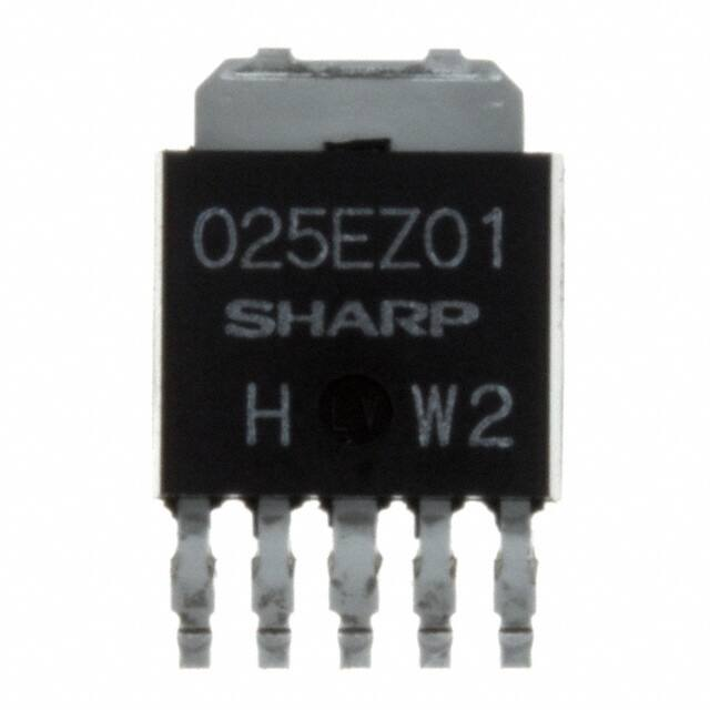

PQ025EZ01ZZH
PQ025EZ01ZZH
    SHARP(夏普)
    TO-252-6
    IC REG LINEAR 2.5V 1A SC63
PQ025EZ01ZZH 数据手册
PQxxxEZ5MZxH Series/PQxxxEZ01ZxH Series PQxxxEZ5MZxH Series PQxxxEZ01ZxH Series Features 1.Low voltage operation (Minimum operating voltage: 2.35V) 2.5V input → available 1.5 to 1.8V 2.Low dissipation current Dissipation current at no load: MAX. 2mA Output OFF-state dissipation current: MAX. 5μA 3.Built-in overcurrent protection and overheat protection functions 4.RoHS directive compliant Compact Surface Mount type Low Power-Loss Voltage Regulators ■ Outline Dimensions (Unit : mm) 6.6M AX. 5.2±0.5 3 2.3±0.5 ( 0.5) Epoxy resin 9.7M AX. 5.5±0.5 0 1 5 EZ5 M Lead finish identification mark M IN. ( 0~0.25) +0.2 0.5–0.1 Applications 1.Peripheral equipment of personal computers 2.Power supplies for various electronic equipment such as DVD player or STB 2.5 4–( 1.27) ( ) : Typical dimensions Product mass:(0.3g) 1 2 3 4 5 Model Line-up Output current (IO) Package type Taping Sleeve Taping Sleeve Taping Sleeve Taping Sleeve Output voltage (VO) 1 3 1.5V 1.8V 2.5V 1 2 3 4 5 Specific IC 2 5 0.5A 1A PQ015EZ5MZPH PQ018EZ5MZPH PQ025EZ5MZPH PQ015EZ5MZZH PQ018EZ5MZZH PQ025EZ5MZZH PQ015EZ01ZPH PQ018EZ01ZPH PQ025EZ01ZPH PQ015EZ01ZZH PQ018EZ01ZZH PQ025EZ01ZZH 3.0V 3.3V DC input (VIN) ON/OFF control terminal (VC) DC output(VO) NC GND 0.5A 1A PQ030EZ5MZPH PQ033EZ5MZPH PQ030EZ5MZZH PQ033EZ5MZZH PQ030EZ01ZPH PQ033EZ01ZPH PQ030EZ01ZZH PQ033EZ01ZZH Lead finish:Lead-free solder plating (Composition: Sn2Cu) Absolute Maximum Ratings Parameter Input voltage (Ta=25°C) Unit V V A W ˚C ˚C ˚C ˚C Rating Symbol 10 VIN *1 ON/OFF control terminal voltage 10 VC 0.5 Output PQxxxEZ5MZxH Series IO current PQxxxEZ01ZxH Series 1 *2 8 Power dissipation PD *3 Tj 150 Junction temperature Operating temperature Topr -40 to +85 Tstg -40 to +150 Storage temperature 260(10s) Tsol Soldering temperature *1 All are open except GND and applicable terminals. *2 PD: With infinite heat sink *3 Overheat protection may operate at Tj:125°C to 150°C Notice The content of data sheet is subject to change without prior notice. In the absence of confirmation by device specification sheets, SHARP takes no responsibility for any defects that may occur in equipment using any SHARP devices shown in catalogs, data books, etc. Contact SHARP in order to obtain the latest device specification sheets before using any SHARP device. 1 Sheet No.: OP06021 ( 0.9) ( 0.5) ( 1.7) H PQxxxEZ5MZxH Series/PQxxxEZ01ZxH Series Electrical Characteristics (Unless otherwise specified, condition shall be VIN=VO(TYP.)+1V, IO=0.3A,VC=2.7V,Ta=25˚C(PQxxxEZ5MZxH)) (Unless otherwise specified, condition shall be VIN=VO(TYP.)+1V, IO=0.5A,VC=2.7V,Ta=25˚C(PQxxxEZ01ZxH)) Parameter Input voltage Output voltage Load regulation PQxxxEZ5MZxH PQxxxEZ01ZxH Symbol VIN Conditions MIN. TYP. MAX. VO RegL RegI TCVO RR PQxxxEZ5MZxH PQxxxEZ01ZxH - - IO=5mA to 0.5A IO=5mA to 1A VIN=VO(TYP.)+1V to VO(TYP.)+6V,IO=5mA Refer to below table Refer to below table Unit V V % % %/°C dB V V μA V μA mA μA - - - 45 - 2.0 - - - - - 0.2 0.1 ±0.01 2.0 1.0 - - 0.5 - 200 0.8 2 2 5 Line regulation Temperature coefficient of output voltage Ripple Rejection 4 Tj=0 to 125°C, IO=5mA Refer to Fig.2 60 0.2 - - - - 1 Dropout voltage VI-O 6 ON-state voltage for control ON-state current for control OFF-state voltage for control OFF-state current for control Quiescent current Output OFF-state dissipation current VC(ON) IC(ON) VC(OFF) IC(OFF) Iq Iqs IO=0.3A 5 IO=0.5A - - - 5 VC=0.4V IO=0A IO=0A, VC=0.4V - 4 Applied PQ030EZ5MZxH,PQ033EZ5MZxH 5 Input voltage shall be the value when output voltage is 95% in comparison with the initial value. 6 In case of opening control terminal ② , output voltage turns off. Input voltage range (Unless otherwise specified, condition shall be IO=0.3A,VC=2.7V,Ta=25˚C(PQxxxEZ5MZxH)) (Unless otherwise specified, condition shall be IO=0.5A,VC=2.7V,Ta=25˚C(PQxxxEZ01ZxH)) Model No. PQ015EZ5MZxH / PQ015EZ01ZxH PQ018EZ5MZxH / PQ018EZ01ZxH PQ025EZ5MZxH / PQ025EZ01ZxH PQ030EZ5MZxH / PQ030EZ01ZxH PQ033EZ5MZxH / PQ033EZ01ZxH Symbol Conditions VIN VIN VIN VIN VIN − − − − − MIN. 2.35 2.35 3.0 3.5 3.8 TYP. − − − − − MAX. 10 10 10 10 10 Unit V V V V V Output voltage (Unless otherwise specified, condition shall be VIN=VO(TYP.)+1V, IO=0.3A,VC=2.7V,Ta=25˚C(PQxxxEZ5MZxH)) (Unless otherwise specified, condition shall be VIN=VO(TYP.)+1V, IO=0.5A,VC=2.7V,Ta=25˚C(PQxxxEZ01ZxH)) Model No. PQ015EZ5MZxH / PQ015EZ01ZxH PQ018EZ5MZxH / PQ018EZ01ZxH PQ025EZ5MZxH / PQ025EZ01ZxH PQ030EZ5MZxH / PQ030EZ01ZxH PQ033EZ5MZxH / PQ033EZ01ZxH Symbol Conditions VO VO VO VO VO − − − − − MIN. 1.45 1.75 2.438 2.925 3.218 TYP. 1.5 1.8 2.5 3 3.3 MAX. 1.55 1.85 2.562 3.075 3.382 Unit V V V V V Sheet No.: OP06021 2 PQxxxEZ5MZxH Series/PQxxxEZ01ZxH Series Fig.1 Test Circuit VIN 1 3 A IO VO + 0.33μF 5 A Iq 2 VC A IC + 47μF V RL Fig.2 Test Circuit for Ripple Rejection + 1 ei ~ + VIN 0.33μF 5 2.7V 2 VC + 47μF RL 3 IO eo V ~ f=120Hz(sine wave) ei(rms)=0.5V VIN= VO(TYP)+0.5V IO=0.3A RR=20log(ei(rms)/eo(rms)) Fig.3 Power Dissipation vs. Ambient Temperature 10 Fig.4 Overcurrent Protection Characteristics (PQ015EZ5MZxH) 1.5 V IN =2.35V V IN =3V V IN =3.3V V IN =2.5V Power dissipation PD (W) Output voltage VO (V) 8 PD : With infinite heat sink 1.2 0.9 5 0.6 V IN =5V 0.3 0 −40 −20 0 20 40 60 80 0 0 0.1 0.2 0.3 0.4 0.5 0.6 0.7 0.8 0.9 1 1.1 1.2 Ambient temperature Ta (°C) Note) Oblique line portion:Overheat protection may operate in this area. Output current IO (A) Sheet No.: OP06021 3 PQxxxEZ5MZxH Series/PQxxxEZ01ZxH Series Fig.5 Overcurrent Protection Characteristics (PQ018EZ5MZxH) 1.8 1.6 V IN =2.35V Fig.6 Overcurrent Protection Characteristics (PQ025EZ5MZxH) 2.5 V IN =3V V IN =3.3V V IN =3.6V Output voltage VO (V) 1.4 1.2 1 0.8 0.6 0.4 0.2 0 V IN =3.3V Output voltage VO (V) V IN =2.5V V IN =3V 2 1.5 1 V IN =5V V IN =4.5V 0 0.1 0.2 0.3 0.4 0.5 0.6 0.7 0.8 0.9 1 1.1 1.2 V IN =5V 0.5 0 0 0.1 0.2 0.3 0.4 0.5 0.6 0.7 0.8 0.9 1 1.1 1.2 Output current IO (A) Output current IO (A) Fig.7 Overcurrent Protection Characteristics (PQ030EZ5MZxH) 3 Fig.8 Overcurrent Protection Characteristics (PQ033EZ5MZxH) 3.5 V IN =10V V IN =4.5V V IN =7V V IN =5.5V Output voltage VO (V) V IN =10V V IN =7V V IN =5.5V V IN =5V V IN =4.5V Output voltage VO (V) 2.5 2 1.5 1 0.5 0 3 2.5 2 1.5 1 0.5 V IN =5V 0 0.1 0.2 0.3 0.4 0.5 0.6 0.7 0.8 0.9 1 1.1 1.2 0 0 0.1 0.2 0.3 0.4 0.5 0.6 0.7 0.8 0.9 1 1.1 1.2 Output current IO (A) Output current IO (A) Fig.9 Overcurrent Protection Characteristics (PQ015EZ01ZxH) 1.5 V IN =2.35V V IN =3V Fig.10 Overcurrent Protection Characteristics (PQ018EZ01ZxH) 1.8 1.6 V IN =2.35V V IN =3V V IN =3.3V V IN =2.5V Output voltage VO (V) 1.2 Output voltage VO (V) V IN =2.5V 1.4 1.2 1 0.8 0.6 0.4 0.2 0.9 V IN =3.3V 0.6 V IN =5V V IN =5V 0.3 0 0 0.5 1 1.5 2 0 0 0.5 1 1.5 2 Output current IO (A) Output current IO (A) Sheet No.: OP06021 4 PQxxxEZ5MZxH Series/PQxxxEZ01ZxH Series Fig.11 Overcurrent Protection Characteristics (PQ025EZ01ZxH) 2.5 V IN =3V V IN =3.3V Fig.12 Overcurrent Protection Characteristics (PQ030EZ01ZxH) 3 2.5 2 1.5 1 0.5 0 Output voltage VO (V) Output voltage VO (V) 2 V IN =3.6V V IN =10V V IN =7V V IN =5.5V V IN =5V V IN =4.5V 1.5 V IN =5V 1 V IN =4.5V 0.5 0 0 0.5 1 1.5 2 0 0.5 1 1.5 2 Output current IO (A) Output current IO (A) Fig.13 Overcurrent Protection Characteristics (PQ033EZ01ZxH) 3.5 V IN =10V V IN =7V V IN =5.5V V IN =5V V IN =4.5V Fig.14 Output Voltage vs. Ambient Temperature (PQ015EZ5MZxH / PQ015EZ01ZxH) 1.55 1.54 V IN =2.5V V C =2.7V Output voltage VO (V) 3 Output voltage VO (V) 1.53 1.52 1.51 1.5 1.49 1.48 1.47 1.46 1.45 −50 P Q 015EZ01ZxH :I O=0.5A P Q 015EZ5MZxH :I O=0.3A 2.5 2 1.5 1 0.5 0 0 0.5 1 1.5 2 −25 0 25 50 75 100 125 Output current IO (A) Ambient temperature Ta (°C) Fig.15 Output Voltage vs. Ambient Temperature (PQ018EZ5MZxH / PQ018EZ01ZxH) 1.85 1.84 V IN =2.8V V C =2.7V Fig.16 Output Voltage vs. Ambient Temperature (PQ025EZ5MZxH / PQ025EZ01ZxH) 2.525 2.52 V IN =3.5V V C =2.7V Output voltage VO (V) Output voltage VO (V) 1.83 1.82 1.81 1.8 1.79 1.78 1.77 1.76 1.75 −50 −25 0 25 50 75 100 125 P Q 018EZ01ZxH :I O=0.5A P Q 018EZ5MZxH :I O=0.3A 2.515 2.51 2.505 2.5 2.495 2.49 2.485 2.48 2.475 −50 −25 0 25 50 75 100 125 P Q 025EZ01ZxH :I O=0.5A P Q 025EZ5MZxH :I O=0.3A Ambient temperature Ta (°C) Ambient temperature Ta (°C) Sheet No.: OP06021 5 PQxxxEZ5MZxH Series/PQxxxEZ01ZxH Series Fig.17 Output Voltage vs. Ambient Temperature (PQ030EZ5MZxH / PQ030EZ01ZxH) 3.05 3.04 V IN =4V V C =2.7V Fig.18 Output Voltage vs. Ambient Temperature (PQ033EZ5MZxH / PQ033EZ01ZxH) 3.35 3.34 V IN =4.3V V C =2.7V Output voltage VO (V) 3.03 3.02 3.01 3 2.99 2.98 2.97 2.96 2.95 −50 −25 0 25 50 75 100 125 P Q 030EZ01ZxH :I O=0.5A P Q 030EZ5MZxH :I O=0.3A Output voltage VO (V) 3.33 3.32 3.31 3.3 3.29 3.28 3.27 3.26 3.25 −50 −25 0 25 50 75 100 125 P Q 033EZ01ZxH :I O=0.5A P Q 033EZ5MZxH :I O=0.3A Ambient temperature Ta (°C) Ambient temperature Ta (°C) Fig.19 Output Voltage vs. Input Voltage (PQ015EZ5MZxH) 1.6 1.4 Fig.20 Output Voltage vs. Input Voltage (PQ018EZ5MZxH) 2 1.8 Output voltage VO (V) Output voltage VO (V) 1.2 1 0.8 0.6 0.4 0.2 0 0 1 2 3 R L =3Ω ( I O=0.5A ) R L =5Ω ( I O=0.3A ) R L =∞Ω ( I O=0A ) V C =2.7V T a=R oom temp. C IN =0.33μF C O=47μF 4 5 1.6 1.4 1.2 1 0.8 0.6 0.4 0.2 0 0 1 2 3 R L =3.6Ω ( I O=0.5A ) R L =6Ω ( I O=0.3A ) R L =∞Ω ( I O=0A ) V C =2.7V T a=R oom temp. C IN =0.33μF C O=47μF 4 5 Input voltage VIN (V) Input voltage VIN (V) Fig.21 Output Voltage vs. Input Voltage (PQ025EZ5MZxH) 2.5 R L =∞Ω ( I O=0A ) Fig.22 Output Voltage vs. Input Voltage (PQ030EZ5MZxH) 3.5 3 V C =2.7V T a=R oom temp. C IN =0.33μF C O=47μF R L =6Ω ( I O=0.5A ) 2 R L =10Ω ( I O=0.3A ) 1.5 1 0.5 5 0 0 1 2 3 4 5 R L =∞Ω ( I O=0A ) Output voltage VO (V) Output voltage VO (V) 2 R L =5Ω ( I O=0.5A ) 2.5 1.5 R L =8.3Ω ( I O=0.3A ) 1 V C =2.7V T a=R oom temp. C IN =0.33μF C O=47μF 0 1 2 3 4 0.5 0 Input voltage VIN (V) Input voltage VIN (V) Sheet No.: OP06021 6 PQxxxEZ5MZxH Series/PQxxxEZ01ZxH Series Fig.23 Output Voltage vs. Input Voltage (PQ033EZ5MZxH) 3.5 3 V C =2.7V T a=R oom temp. C IN =0.33μF C O=47μF R L =6.6Ω ( I O=0.5A ) 2 R L =11Ω ( I O=0.3A ) 1.5 1 0.5 0 0 1 2 3 4 5 R L =∞Ω ( I O=0A ) Fig.24 Output Voltage vs. Input Voltage (PQ015EZ01ZxH) 1.6 1.4 Output voltage VO (V) Output voltage VO (V) 2.5 1.2 1 0.8 0.6 0.4 0.2 0 0 1 2 V C =2.7V T a=R oom temp. C IN =0.33μF C O=47μF 3 4 5 R L =1.5Ω ( I O=1A ) R L =3Ω ( I O=0.5A ) R L =∞Ω ( I O=0A ) Input voltage VIN (V) Input voltage VIN (V) Fig.25 Output Voltage vs. Input Voltage (PQ018EZ01ZxH) 2 1.8 Fig.26 Output Voltage vs. Input Voltage (PQ025EZ01ZxH) 2.5 Output voltage VO (V) 1.4 1.2 1 0.8 0.6 0.4 0.2 0 0 1 2 R L =1.8Ω ( I O=1A ) R L =3.6Ω ( I O=0.5A ) R L =∞Ω ( I O=0A ) Output voltage VO (V) 1.6 2 R L =2.5Ω ( I O=1A ) 1.5 R L =5Ω ( I O=0.5A ) R L =0Ω ( I O=0A ) 1 V C =2.7V T a=R oom temp. C IN =0.33μF C O=47μF 0 1 2 3 4 5 V C =2.7V T a=R oom temp. C IN =0.33μF C O=47μF 3 4 5 0.5 0 Input voltage VIN (V) Input voltage VIN (V) Fig.27 Output Voltage vs. Input Voltage (PQ030EZ01ZxH) 3.5 3 V C =2.7V T a=R oom temp. C IN =0.33μF C O=47μF R L =3Ω ( I O=1A ) R L =6Ω ( I O=0.5A ) R L =∞Ω ( I O=0A ) Fig.28 Output Voltage vs. Input Voltage (PQ033EZ01ZxH) 3.5 3 V C =2.7V T a=R oom temp. C IN =0.33μF C O=47μF R L =3.3Ω ( I O=1A ) R L =6.6Ω ( I O=0.5A ) R L =∞Ω ( I O=0A ) Output voltage VO (V) 2.5 2 1.5 1 0.5 0 0 Output voltage VO (V) 2.5 2 1.5 1 0.5 1 2 3 4 5 0 0 1 2 3 4 5 Input voltage VIN (V) Input voltage VIN (V) Sheet No.: OP06021 7 PQxxxEZ5MZxH Series/PQxxxEZ01ZxH Series Fig.29 Circuit Operating Current vs. Input Voltage (PQ015EZ5MZxH) 20 Fig.30 Circuit Operating Current vs. Input Voltage (PQ018EZ5MZxH) 20 Circuit operating current IBIAS (mA) 10 Circuit operating current IBIAS (mA) V C =2.7V T a=R oom temp. C IN =0.33μF C O=47μF V C =2.7V T a=R oom temp. C IN =0.33μF C O=47μF 10 R L =3.6Ω ( I O=0.5A ) R L =6Ω ( I O=0.3A ) R L =∞Ω ( I O=0A ) 0 0 1 2 5 3 4 R L =3Ω ( I O=0.5A ) R L =5Ω ( I O=0.3A ) R L =∞Ω ( I O=0A ) 0 0 1 2 5 3 4 Input voltage VIN (V) Input voltage VIN (V) Fig.31 Circuit Operating Current vs. Input Voltage (PQ025EZ5MZxH) 20 Fig.32 Circuit Operating Current vs. Input Voltage (PQ030EZ5MZxH) 20 Circuit operating current IBIAS (mA) Circuit operating current IBIAS (mA) V C =2.7V T a=R oom temp. C IN =0.33μF C O=47μF V C =2.7V T a=R oom temp. C IN =0.33μF C O=47μF R L =10Ω ( I O=0.3A ) R L =6Ω ( I O=0.5A ) 10 R L =5Ω ( I O=0.5A ) R L =8.3Ω ( I O=0.3A ) R L =∞Ω ( I O=0A ) 0 0 1 2 5 3 4 10 R L =∞Ω ( I O=0A ) 0 0 1 2 5 3 4 Input voltage VIN (V) Input voltage VIN (V) Fig.33 Circuit Operating Current vs. Input Voltage (PQ033EZ5MZxH) 20 Fig.34 Circuit Operating Current vs. Input Voltage (PQ015EZ01ZxH) 20 Circuit operating current IBIAS (mA) R L =6.6Ω ( I O=0.5A ) R L =11Ω ( I O=0.3A ) 10 Circuit operating current IBIAS (mA) V C =2.7V T a=R oom temp. C IN =0.33μF C O=47μF V C =2.7V T a=R oom temp. C IN =0.33μF C O=10μF R L =1.5Ω ( I O=1A ) 10 R L =3Ω ( I O=0.5A ) 0 R L =∞Ω ( I O=0A ) 0 1 2 5 3 4 0 R L =∞Ω ( I O=0A ) 0 1 2 5 3 4 Input voltage VIN (V) Input voltage VIN (V) Sheet No.: OP06021 8 PQxxxEZ5MZxH Series/PQxxxEZ01ZxH Series Fig.35 Circuit Operating Current vs. Input Voltage (PQ018EZ01ZxH) 20 Fig.36 Circuit Operating Current vs. Input Voltage (PQ025EZ01ZxH) 30 Circuit operating current IBIAS (mA) Circuit operating current IBIAS (mA) V C =2.7V T a=R oom temp. C IN =0.33 F C O=47 F R L =1.8 (I O=1A ) V C =2.7V T a=R oom temp. C IN =0.33 F C O=47 F 20 R L =2.5 (I O=1A ) 10 R L =3.6 (I O=0.5A ) 10 R L =5 RL 0 1 2 5 3 (I O=0.5A ) (I O=0A ) 4 0 RL 0 1 2 5 3 (I O=0A ) 4 0 Input voltage VIN (V) Input voltage VIN (V) Fig.37 Circuit Operating Current vs. Input Voltage (PQ030EZ01ZxH) 30 Fig.38 Circuit Operating Current vs. Input Voltage (PQ033EZ01ZxH) 30 Circuit operating current IBIAS (mA) R L =3 (I O=1A ) Circuit operating current IBIAS (mA) V C =2.7V T a=R oom temp. C IN =0.33 F C O=47 F 20 R L =6 ( I O=0.5A ) V C =2.7V T a=R oom temp. C IN =0.33 F C O=47 F 20 R L =6.6 (I O=0.5A ) R L =3.3 (I O=1A ) 10 10 0 RL 0 1 2 (I O=0A ) 5 3 4 0 RL 0 1 2 (I O=0A ) 5 3 4 Input voltage VIN (V) Input voltage VIN (V) Fig.39 Quiescent Current vs. Junction Temperature 1.4 1.2 1 0.8 0.6 0.4 0.2 0 50 25 0 25 018 :V IN =2.8V 015 :V IN =2.5V 033 :V IN =4.3V 030 :V IN =4.0V I O=0A V C =2.7V Fig.40 Dropout Voltage vs. Junction Temperature 0.25 V IN =2.35V V C =2.7V Quiescent current Iq(μA) Dropout voltage VI-O(V) 025 :V IN =3.5V 0.2 P Q 033EZ01ZxH : I O=0.5A P Q 030EZ01ZxH :I O=0.5A 0.15 P Q 033EZ5MZxH :I O=0.3A P Q 030EZ5MZxH :I O=0.3A 0.1 0.05 0 P Q xxxEZ01ZxH P Q xxxEZ5MZxH 50 75 100 125 50 25 0 25 50 75 100 125 Junction temperature Tj (°C) Junction temperature Tj (°C) Sheet No.: OP06021 9 PQxxxEZ5MZxH Series/PQxxxEZ01ZxH Series Fig.41 Ripple Rejection vs. Input Ripple Frequency 75 015 (V IN =3.5V ) 70 65 60 55 50 033 (V IN =5.3V ) 030 (V IN =5V ) 025 (V IN =4.5V ) 018 (V IN =3.8V ) Fig.42 Ripple Rejection vs. Output Current 80 015 (V IN =3.5V ) 018 (V IN =3.8V ) 025 (V IN =4.5V ) Ripple rejection RR (dB) Ripple rejection RR (dB) 75 70 65 60 55 50 45 030 (V IN =5V ) 033 (V IN =5.3V ) P Q xxxEZ01ZxH P Q xxxEZ5MZxH ei(rms) =0.5V 45 V C =2.7V I O=0.3A 40 C O=47µF P Q xxxEZ01ZxH Ta=R oom temp. P Q xxxEZ5MZxH 35 0.1 1 10 100 40 ei (rms) =0.5V f =120Hz V C =2.7V C O=47µF Ta=R oom temp. 0 0.25 0.5 0.75 1 Input ripple frequency f (kHz) Output current IO(A) Fig.43 Typical Application 1 3 VO V IN + C IN 5 2 CO + LOAD ON/OFF signal High:Output ON Low or open:Output OFF Fig.44 Power Dissipation vs. Ambient Temperature (Typical Value) 3 Power dissipation PD (W) Cu area 740mm2 2 Cu area 180mm2 Cu area 100mm2 Cu area 70mm2 Cu area 36mm 2 Mounting PCB PCB Cu 1 0 −20 0 20 40 60 80 Material : Glass-cloth epoxy resin Size : 50×50×1.6mm Cu thickness : 35μm Ambient temperature Ta (°C) Sheet No.: OP06021 10
