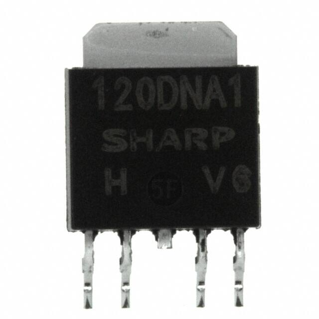

PQxxxDNA1ZPH Series PQxxxDNA1ZPH Series Features Compact Surface Mount type Low Power-Loss Voltage Regulators ■ Outline Dimensions (Unit : mm) 1.Output current : 1A 2.High isolation voltage VIN:MAX.24 V 3.Low dissipation current (Dissipation current at no load: MAX. 8mA Output OFF-state dissipation current: MAX.5μA) 4.Built-in ON/OFF function 5.Built-in overcurrent and overheat protection functions 6.Built-in ASO protection function 7.Ceramic capacitor compatible 8.RoHS directive compliant 2.1±0.5 6.6MAX. 5.2±0.5 (0.3) 3 (1.7) Lead finish identification mark H (0~0.25) 0.3 +0.2 -0.1 Applications (0.3) 4-(1.27) 1.AV equipment 2.OA equipment ( (0.9) 9.7MAX. 2.5MIN. 5.5±0.2 0.7 MAX. Epoxy resin 050DNA1 ) : Typical dimensions Product mass:(0.2g) 1 2 4 5 Model Line-up 1 3 Output Voltage (TYP.) Model No. Specific IC 3.3V 5.0V 8.0V 9.0V 12.0V PQ033DNA1ZPH PQ050DNA1ZPH PQ080DNA1ZPH PQ090DNA1ZPH PQ120DNA1ZPH 5 2 1 2 3 4 5 DC input (VIN) ON/OFF control terminal (VC) DC output(VO) NC GND Lead finish:Lead-free solder plating (Composition: Sn2Cu) Absolute Maximum Ratings (Ta=25°C) Parameter Symbol *1 VIN Input voltage *1 Output control voltage VC IO Output current *2 Power dissipation PD *3 Junction temperature Tj Operating temperature Topr Tstg Storage temperature Soldering temperature Tsol Rating Unit V 24 24 V A 1 8 W 150 °C °C -40 to +85 -40 to +150 °C °C 260(10s) *1 All are open except GND and applicable terminals. *2 PD: With infinite heat sink *3 Overheat protection may operate at Tj:125°C to 150°C Notice The content of data sheet is subject to change without prior notice. In the absence of confirmation by device specification sheets, SHARP takes no responsibility for any defects that may occur in equipment using any SHARP devices shown in catalogs, data books, etc. Contact SHARP in order to obtain the latest device specification sheets before using any SHARP device. 1 Sheet No.: OP06051 PQxxxDNA1ZPH Series Electrical Characteristics (1) PQ033DNA1ZPH (Unless otherwise specified,condition shall be VIN=5V,IO=0.5A,VC=2.7V,Ta=25°C) Parameter 5 Symbol - MIN. TYP. MAX. 3.218 3.3 3.382 V IO=5mA to 1A - 0.2 1.0 % Conditions Output voltage VO Load regulation Line regulation RegL RegI VIN=4 to 14V,IO=5mA Temperature coefficient of output voltage TCVO Tj=0 to +125°C, IO=5mA Refer to Fig.3 Ripple rejection RR Dropout voltage VI-O VC(ON) VIN=3.5V,IO=0.5A IC(ON) VC=2.7V ON-state voltage for control ON-state current for control - OFF-state voltage for control VC(OFF) - OFF-state current for control IC(OFF) Iq VC=0.4V IO=0A Iqs IO=0A, VC=0.4V Quiescent current Output OFF-state dissipation current 2.0 - Unit 0.2 1.0 % ±0.01 60 - %/°C dB 0.2 0.5 V - - V 200 0.8 μA 4 2 8 μA mA - 5 μA V 5 In case of opening control terminal ②, output voltage turns off (2) PQ050DNA1ZPH (Unless otherwise specified,condition shall be VIN=7V,IO=0.5A,VC=2.7V,Ta=25°C) TYP. MAX. VO - MIN. Output voltage 4.875 5.0 5.125 V Load regulation Line regulation RegL IO=5mA to 1A 0.2 1.0 % RegI VIN=6 to 16V,IO=5mA Temperature coefficient of output voltage TCVO Tj=0 to +125°C, IO=5mA Refer to Fig.3 - Parameter 5 Symbol Conditions Ripple rejection RR Dropout voltage VI-O VC(ON) 4 ,IO=0.5A IC(ON) VC=2.7V ON-state voltage for control ON-state current for control - OFF-state voltage for control VC(OFF) - OFF-state current for control IC(OFF) Iq VC=0.4V IO=0A Iqs IO=0A, VC=0.4V Quiescent current Output OFF-state dissipation current 2.0 - Unit 0.2 1.0 % ±0.01 60 - %/°C dB 0.2 0.5 V - - V 200 0.8 μA 4 2 8 μA mA - 5 μA V 4 Input voltage shall be the value when output voltage is 95% in comparison with the initial value. 5 In case of opening control terminal ②, output voltage turns off (3) PQ080DNA1ZPH (Unless otherwise specified,condition shall be VIN=10V,IO=0.5A,VC=2.7V,Ta=25°C) Parameter 5 Symbol Conditions Output voltage VO - Load regulation Line regulation RegL IO=5mA to 1A RegI VIN=9 to 19V,IO=5mA Temperature coefficient of output voltage TCVO Tj=0 to +125°C, IO=5mA Refer to Fig.3 Ripple rejection RR Dropout voltage VI-O VC(ON) 4 ,IO=0.5A IC(ON) VC=2.7V ON-state voltage for control ON-state current for control - OFF-state voltage for control VC(OFF) OFF-state current for control IC(OFF) Iq VC=0.4V IO=0A Iqs IO=0A, VC=0.4V Quiescent current Output OFF-state dissipation current MIN. TYP. MAX. 7.8 8.0 8.2 V - 0.2 1.0 % 0.2 1.0 % ±0.01 60 - %/°C dB 0.2 0.5 V - - V 200 0.8 μA 4 2 8 μA mA - 5 μA 2.0 - Unit V 4 Input voltage shall be the value when output voltage is 95% in comparison with the initial value. 5 In case of opening control terminal ②, output voltage turns off Sheet No.: OP06051 2 PQxxxDNA1ZPH Series (4) PQ090DNA1ZPH (Unless otherwise specified,condition shall be VIN=11V,IO=0.5A,VC=2.7V,Ta=25°C) TYP. MAX. VO - MIN. Output voltage 8.775 9.0 9.225 V Load regulation Line regulation RegL IO=5mA to 1A 0.2 1.0 % Temperature coefficient of output voltage TCVO - Parameter 5 Symbol Conditions VIN=10 to 20V,IO=5mA RegI Tj=0 to +125°C, IO=5mA Refer to Fig.3 Ripple rejection RR Dropout voltage VI-O VC(ON) 4 ,IO=0.5A IC(ON) VC=2.7V ON-state voltage for control ON-state current for control - 2.0 OFF-state voltage for control VC(OFF) - OFF-state current for control IC(OFF) Iq VC=0.4V IO=0A Iqs IO=0A, VC=0.4V Quiescent current Output OFF-state dissipation current - Unit 0.2 1.0 % ±0.01 60 - %/°C dB 0.2 0.5 V - - V 200 0.8 μA 4 2 8 μA mA - 5 μA V 4 Input voltage shall be the value when output voltage is 95% in comparison with the initial value. 5 In case of opening control terminal ②, output voltage turns off (5) PQ120DNA1ZPH (Unless otherwise specified,condition shall be VIN=14V,IO=0.5A,VC=2.7V,Ta=25°C) Parameter 5 Symbol Output voltage VO Load regulation Line regulation RegL Temperature coefficient of output voltage TCVO - MIN. TYP. MAX. 11.7 12.0 12.3 V IO=5mA to 1A - 0.2 1.0 % Conditions VIN=13 to 23V,IO=5mA RegI Tj=0 to +125°C, IO=5mA Refer to Fig.3 Ripple rejection RR Dropout voltage VI-O VC(ON) 4 ,IO=0.5A IC(ON) VC=2.7V ON-state voltage for control ON-state current for control - 2.0 OFF-state voltage for control VC(OFF) - OFF-state current for control IC(OFF) Iq VC=0.4V IO=0A Iqs IO=0A, VC=0.4V Quiescent current Output OFF-state dissipation current - Unit 0.2 1.0 % ±0.01 60 - %/°C dB 0.2 0.5 V - - V 200 0.8 μA 4 2 8 μA mA - 5 μA V 4 Input voltage shall be the value when output voltage is 95% in comparison with the initial value. 5 In case of opening control terminal ②, output voltage turns off Fig.1 Example of application 1 VIN VO 3 2 CIN CO Load 5 ON/OFF signal High:Output ON Low or Open:Output OFF Sheet No.: OP06051 3 PQxxxDNA1ZPH Series Fig.2 Test Circuit VIN VO 3 1 A 2 5 1μF A IC V 10μF RL Iq A IO VC Fig.3 Test Circuit for Ripple Rejection + 3 1 ei ~ IO 2 1μF VIN eo VC 5 V ~ 10μF RL 2.7V f=120Hz(sine wave) ei(rms)=0.5V VIN= 5V (PQ033DNA1ZPH) 7V (PQ050DNA1ZPH) 10V (PQ080DNA1ZPH) 11V (PQ090DNA1ZPH) 14V (PQ120DNA1ZPH) IO=0.3A RR=20log(ei(rms)/eo(rms)) Fig.5 Overcurrent Protection Characteristics (PQ033DNA1ZPH) 10 4.0 8 3.5 Output voltage VO (V) Power dissipation PD (W) Fig.4 Power Dissipation vs. Ambient Temperature 5 3.0 VIN=9V VIN=15V 0 25 50 VIN=24V 2.0 1.5 VIN=5V 1.0 0 0 75 85 100 125 150 Ambient temperature Ta (°C) Note) Oblique line portion:Overheat protection may operate in this area. VIN=12V VIN=3.8V 2.5 VC=2.7V CIN=1μF CO=10μF Ta=Room temp. 0.5 0 -40 -20 VIN=7V 0.2 0.4 0.6 0.8 1.0 1.2 1.4 1.6 Output current IO (A) Sheet No.: OP06051 4 PQxxxDNA1ZPH Series Fig.6 Overcurrent Protection Characteristics (PQ050DNA1ZPH) VIN=5.5V Output voltage VO (V) 5.0 4.0 10 VIN=7V Output voltage VO (V) 5.5 Fig.7 Overcurrent Protection Characteristics (PQ090DNA1ZPH) VIN=12V VIN=15V 3.0 VIN=9V VIN=24V 2.0 VC=2.7V CIN=1μF CO=10μF Ta=Room temp. 1.0 0 0 VIN=12V 8 VIN=9.5V VIN=24V VIN=20V VIN=11V 4 2 0 0 0.2 0.4 0.6 0.8 1.0 1.2 1.4 1.6 1.7 VC=2.7V CIN=1μF CO=10μF Ta=Room temp. 0.2 0.4 0.6 0.8 1.0 1.2 1.4 1.6 1.7 Output current IO (A) Output current IO (A) Fig.8 Overcurrent Protection Characteristics (PQ120DNA1ZPH) 13 12 10 VIN=24V VIN=12.5V 8 VIN=14V VIN=17V 6 4 VC=2.7V CIN=1μF CO=10μF Ta=Room temp. 2 0 VIN=14V VC=2.7V IO=0.5A CIN=1μF CO=10μF 11.98 Output voltage VO (V) Output voltage VO (V) Fig.9 Output Voltage vs. Ambient Temperature (PQ120DNA1ZPH) VIN=15V 12 0 11.96 11.94 11.92 11.9 11.88 11.86 11.84 11.82 11.8 -50 0.2 0.4 0.6 0.8 1.0 1.2 1.4 1.6 1.7 Output current IO (A) Circuit operating current IBIAS (mA) Output voltage VO (V) 12 RL=∞Ω (IO=0A) 8 RL=24Ω (IO=0.5A) RL=12Ω (IO=1A) 4 VC=2.7V Ta=Room temp. CIN=1μF CO=10μF 2 0 0 2 4 6 8 10 12 0 25 50 75 100 125 150 Fig.11 Circuit Operating Current vs. Input Voltage (PQ120DNA1ZPH) 14 6 -25 Ambient temperature Ta (°C) Fig.10 Output Voltage vs. Input Voltage (PQ120DNA1ZPH) 10 VIN=15V 6 26 24 20 16 12 RL=12Ω (IO=1A) 8 4 0 14 16 18 VC=2.7V Ta=Room temp. CIN=1μF CO=10μF RL=24Ω (IO=0.5A) RL=∞Ω (IO=0A) 0 2 4 6 8 10 12 14 15 Input voltage VIN (V) Input voltage VIN (V) Sheet No.: OP06051 5 PQxxxDNA1ZPH Series Fig.12 Quiescent Current vs. Ambient Temperature (PQ120DNA1ZPH) 0.3 VIN=14V VC=2.7V IO=0A CIN=1μF CO=10μF 3.8 3.6 3.4 Dropout voltage VI-O(V) Quiescent current Iq(μA) 4 Fig.13 Dropout Voltage vs. Ambient Temperature (PQ120DNA1ZPH) 3.2 3 2.8 2.6 2.4 VIN=11.4V VC=2.7V IO=0.5A CIN=1μF CO=10μF 0.25 0.2 0.15 0.1 0.05 2.2 2 -50 -25 0 25 50 75 0 -50 100 125 150 Ambient temperature Ta (°C) 0 25 50 75 100 125 150 Ambient temperature Ta (°C) Fig.14 Ripple Rejection vs. Input Ripple Frequency (PQ120DNA1ZPH) Fig.15 Ripple Rejection vs. Output Current (PQ120DNA1ZPH) 80 80 75 70 Ripple rejection RR (dB) Ripple rejection RR (dB) -25 60 50 40 ei(rms)=0.5V VC=2.7V IO=0.3A 30 CO=10μF 70 65 60 55 ei(rms)=0.5V f=120HZ VC=2.7V CO=10μF 50 45 Ta=Room temp. 20 VIN=14V 0.1 1 10 100 1 000 Input ripple frequency f (kHz) 40 Ta=Room temp. VIN=14V 0 0.25 0.5 0.75 1 Output current IO(A) Fig.16 Power Dissipation vs. Ambient Temperature (Typical Value) Power dissipation PD (W) Cu area 740mm2 2.0 1.5 Cu area 180mm2 Cu area 100mm2 Mounting PCB Cu area 70mm2 PCB Cu 1 Cu area 36mm2 0.5 0 -40 Material : Glass-cloth epoxy resin Size : 50×50×1.6mm Cu thickness : 35μm -20 0 20 40 60 80 100 120 Ambient temperature Ta (°C) Sheet No.: OP06051 6
