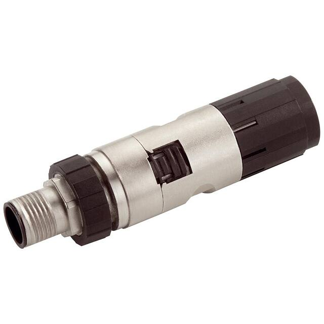

Data sheet 6GK1901-0DB20-6AA8 product type designation IE FC M12 Plug PRO (PROFINET) product description M12 connector with high protection, 4-pole, D-coded Industrial Ethernet FastConnect M12 plug PRO 2x2 M12 plug-in connector with rugged metal enclosure and FC connection method, with axial cable outlet (D-coded) 1 pack=8 units for SCALANCE X208 PRO and ET 200 PRO PN suitability for use For connecting electrical cables to SCALANCE X208PRO, ET200 PRO PN or ET200 eco PN for fast assembly with the FastConnect system transfer rate transfer rate / for Industrial Ethernet 10 Mbit/s, 100 Mbit/s interfaces number of electrical connections ● for Industrial Ethernet FC TP cables 4 ● for network components or terminal equipment 1 type of electrical connection ● for Industrial Ethernet FC TP cables integrated cut-and-clamp contacts for 4-wire TP FC installation cable AWG22 ● for network components or terminal equipment M12 connector (D-coded) type of electrical connection / FastConnect Yes mechanical data material / of the enclosure metal number of reuses 10 locking mechanism design Screwed joint design, dimensions and weights type of cable outlet 180° cable outlet width 19 mm height 19 mm depth 73 mm net weight 40 g ambient conditions ambient temperature ● during operation -40 ... +85 °C ● during storage -40 ... +85 °C ● during transport -40 ... +85 °C relative humidity ● at 25 °C / without condensation / during operation / maximum 95 % chemical resistance ● to water resistant protection class IP IP65/67 product features, product functions, product components / general product feature 6GK19010DB206AA8 Page 1/2 12.18.2020 Subject to change without notice © Copyright Siemens ● PoE capability Yes ● PoE+capability Yes ● silicon-free Yes product component ● strain relief Yes standards, specifications, approvals certificate of suitability ● RoHS conformity Yes ● UL approval Yes ● cULus approval Yes ● railway application in accordance with EN 50155 No standard for structured cabling Cat5 further information / internet-Links Internet-Link ● to web page: selection aid TIA Selection Tool http://www.siemens.com/snst ● to website: Industrial communication http://www.siemens.com/simatic-net ● to website: Industry Mall https://mall.industry.siemens.com ● to website: Information and Download Center http://www.siemens.com/industry/infocenter ● to website: Image database http://automation.siemens.com/bilddb ● to website: CAx-Download-Manager http://www.siemens.com/cax ● to website: Industry Online Support https://support.industry.siemens.com last modified: 6GK19010DB206AA8 Page 2/2 12/18/2020 12.18.2020 Subject to change without notice © Copyright Siemens
