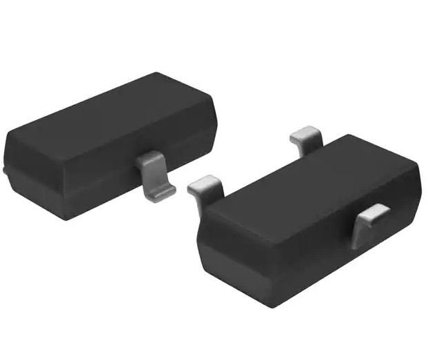

BSS 131 SIPMOS ® Small-Signal Transistor • N channel • Enhancement mode • Logic Level • VGS(th) = 0.8...2.0V Pin 1 G Type BSS 131 Type BSS 131 BSS 131 Pin 2 S Marking SRs Pin 3 D VDS 240 V ID 0.1 A RDS(on) 16 Ω Package SOT-23 Ordering Code Q62702-S565 Q67000-S229 Tape and Reel Information E6327 E6433 Maximum Ratings Parameter Drain source voltage Drain-gate voltage Symbol Values 240 240 Unit V VDS VDGR VGS Vgs ID RGS = 20 kΩ Gate source voltage Gate-source peak voltage,aperiodic Continuous drain current ± 14 ± 20 A 0.1 TA = 26 °C DC drain current, pulsed IDpuls 0.4 TA = 25 °C Power dissipation Ptot 0.36 W TA = 25 °C Semiconductor Group 1 Sep-13-1996 BSS 131 Maximum Ratings Parameter Chip or operating temperature Storage temperature Thermal resistance, chip to ambient air DIN humidity category, DIN 40 040 IEC climatic category, DIN IEC 68-1 1) For package mounted on aluminium 15 mm x 16.7 mm x 0.7 mm Symbol Values -55 ... + 150 -55 ... + 150 ≤ 350 ≤ 285 E 55 / 150 / 56 Unit °C K/W Tj Tstg RthJA Therminal resistance, chip-substrate- reverse side 1)RthJSR Electrical Characteristics, at Tj = 25°C, unless otherwise specified Parameter Symbol min. Static Characteristics Drain- source breakdown voltage Values typ. max. Unit V(BR)DSS 240 1.4 0.1 2 1 12 15 2 1 60 30 10 V VGS = 0 V, ID = 0.25 mA, Tj = 25 °C Gate threshold voltage VGS(th) 0.8 VGS=VDS, ID = 1 mA Zero gate voltage drain current IDSS µA nA nA Ω 16 26 VDS = 240 V, VGS = 0 V, Tj = 25 °C VDS = 240 V, VGS = 0 V, Tj = 125 °C VDS = 130 V, VGS = 0 V, Tj = 25 °C Gate-source leakage current IGSS RDS(on) VGS = 20 V, VDS = 0 V Drain-Source on-state resistance VGS = 10 V, ID = 0.1 A VGS = 4.5 V, ID = 0.1 A Semiconductor Group 2 Sep-13-1996 BSS 131 Electrical Characteristics, at Tj = 25°C, unless otherwise specified Parameter Symbol min. Dynamic Characteristics Transconductance Values typ. max. Unit gfs 0.06 0.14 60 8 3.5 - S pF 80 12 5 ns 5 8 VDS≥ 2 * ID * RDS(on)max, ID = 0.1 A Input capacitance Ciss Coss - VGS = 0 V, VDS = 25 V, f = 1 MHz Output capacitance VGS = 0 V, VDS = 25 V, f = 1 MHz Reverse transfer capacitance Crss - VGS = 0 V, VDS = 25 V, f = 1 MHz Turn-on delay time td(on) VDD = 30 V, VGS = 10 V, ID = 0.26 A RGS = 50 Ω Rise time tr 8 12 VDD = 30 V, VGS = 10 V, ID = 0.26 A RGS = 50 Ω Turn-off delay time td(off) 12 16 VDD = 30 V, VGS = 10 V, ID = 0.26 A RGS = 50 Ω Fall time tf 15 20 VDD = 30 V, VGS = 10 V, ID = 0.26 A RGS = 50 Ω Semiconductor Group 3 Sep-13-1996 BSS 131 Electrical Characteristics, at Tj = 25°C, unless otherwise specified Parameter Symbol min. Reverse Diode Inverse diode continuous forward current IS A 0.8 0.1 0.4 V 1.2 Values typ. max. Unit TA = 25 °C Inverse diode direct current,pulsed ISM - TA = 25 °C Inverse diode forward voltage VSD VGS = 0 V, IF = 0.2 A, Tj = 25 °C Semiconductor Group 4 Sep-13-1996 BSS 131 Power dissipation Ptot = ƒ(TA) Drain current ID = ƒ(TA) parameter: VGS ≥ 10 V 0.11 A 0.40 W Ptot 0.32 0.28 0.24 ID 0.09 0.08 0.07 0.06 0.20 0.05 0.16 0.04 0.12 0.08 0.04 0.00 0 20 40 60 80 100 120 °C 160 0.03 0.02 0.01 0.00 0 20 40 60 80 100 120 °C 160 TA TA Safe operating area ID=f(VDS) parameter : D = 0.01, TC=25°C Drain-source breakdown voltage V(BR)DSS = ƒ(Tj) 285 V 275 V(BR)DSS 70 2 265 260 255 250 245 240 235 230 225 220 215 -60 -20 20 60 100 °C 160 Tj Semiconductor Group 5 Sep-13-1996 BSS 131 Typ. output characteristics ID = ƒ(VDS) parameter: tp = 80 µs , Tj = 25 °C 0.24 A 0.20 Typ. drain-source on-resistance RDS (on) = ƒ(ID) parameter: tp = 80 µs, Tj = 25 °C 50 Ptot = 0W l k jihf e g d VGS [V] a 2.0 2.5 3.0 3.5 4.0 4.5 5.0 6.0 7.0 8.0 9.0 10.0 b c Ω RDS (on) 40 35 30 25 20 15 a b ID 0.18 0.16 0.14 0.12 0.10 0.08 0.06 0.04 0.02 0.00 0 1 2 3 4 5 6 7 8 a c d e f g h i j c ed f h bk l j ki g 10 5 0 V 10 0.00 0.02 0.04 0.06 0.08 0.10 0.12 0.14 A 0.18 VGS [V] = a 2.5 2.0 b 3.0 c 3.5 d 4.0 e f 4.5 5.0 g 6.0 h i 7.0 8.0 j 9.0 k 10.0 VDS ID Typ. transfer characteristics ID = f(VGS) parameter: tp = 80 µs Typ. forward transconductance gfs = f (ID) parameter: tp = 80 µs, 0.32 0.24 S A 0.20 ID 0.24 gfs 0.18 0.16 0.20 0.14 0.16 0.12 0.10 0.12 0.08 0.08 0.06 0.04 0.04 0.02 0.00 0 1 2 3 4 5 6 7 8 V 10 0.00 0.00 0.04 0.08 0.12 0.16 0.20 0.24 A ID 0.30 VGS Semiconductor Group 6 Sep-13-1996 BSS 131 Drain-source on-resistance RDS (on) = ƒ(Tj ) parameter: ID = 0.1 A, VGS = 10 V 40 Gate threshold voltage VGS (th) = ƒ(Tj) parameter: VGS = VDS, ID = 1 mA 4.6 V 4.0 Ω RDS (on) 32 28 24 20 16 12 VGS(th) 3.6 3.2 2.8 98% 2.4 98% 2.0 typ 1.6 1.2 typ 8 4 0 -60 -20 20 60 100 °C 160 2% 0.8 0.4 0.0 -60 -20 20 60 100 °C 160 Tj Tj Typ. capacitances C = f (VDS) parameter:VGS=0V, f = 1 MHz 10 3 Forward characteristics of reverse diode IF = ƒ(VSD) parameter: Tj , tp = 80 µs 10 0 pF C 10 2 A IF 10 -1 Ciss 10 1 10 -2 Coss Crss Tj = 25 °C typ Tj = 150 °C typ Tj = 25 °C (98%) Tj = 150 °C (98%) 10 0 0 5 10 15 20 25 30 V VDS 40 10 -3 0.0 0.4 0.8 1.2 1.6 2.0 2.4 V 3.0 VSD Semiconductor Group 7 Sep-13-1996 BSS 131 Package outlines SOT-23 Dimensions in mm Semiconductor Group 8 Sep-13-1996

1. 物料型号: - 型号:BSS 131
2. 器件简介: - BSS 131是一款N沟道增强型逻辑电平小信号晶体管。
3. 引脚分配: - Pin 1: G(栅极) - Pin 2: S(源极) - Pin 3: D(漏极)
4. 参数特性: - 漏源电压(VDs):240V - 栅源电压(VGs):±14V(连续工作),±20V(峰值) - 栅极阈值电压(VGS(th)):0.8V至2.0V - 连续漏极电流(ID):0.1A - 脉冲漏极电流(IDpuls):0.4A - 最大功耗(Ptot):0.36W
5. 功能详解: - 该器件具有N沟道增强型逻辑电平特性,适用于逻辑电路中的开关应用。 - 电气特性表提供了详细的静态和动态参数,如漏源击穿电压、栅极阈值电压、漏极电流、栅源漏电流等。
6. 应用信息: - 由于是小信号晶体管,适用于高速开关和放大应用,尤其是在逻辑电平信号处理中。
7. 封装信息: - 封装类型:SOT-23 - 封装标记:SRs
