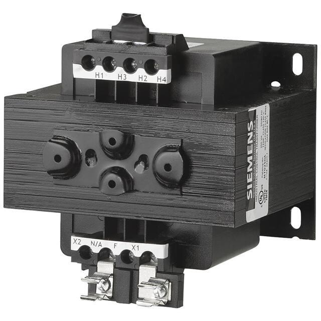

    CONTROL TRANSFORMER,200VA,240/48
MT0200M 数据手册
Data sheet US2:MT0200M Control Power Transformer, 200va, PRI 240x480v, SEC 120x240v, Domestic, product brand name Control Power Transformer design of the product Control power voltage special product feature Robust design General technical data weight [lb] Height x Width x Depth [in] 8.5 lb 4.16 × 4.5 × 4.14 in ● ambient temperature [°F] during operation -4 ... +104 °F ● ambient temperature during operation -20 ... +40 °C country of origin Mexico operating apparent power rated value 200 V·A Enclosure design of the housing Open Mounting/wiring mounting position Any fastening method Surface mounting type of electrical connection at output for main current circuit Screw-type terminals (touchsafe) type of electrical connection at input for main current circuit Screw-type terminals (touchsafe) Inputs/ Outputs input variables of primary voltage 240x480vac output dimensions of secondary voltage 120x240vac phase number of the inputs 1 electrical input frequency 50 ... 60 Hz input voltage _1 240 V input voltage _2 480 V phase number of the outputs 1 electrical output frequency 60 ... 50 Hz output voltage _1 rated value 120 V output voltage _2 rated value 240 V certificate of suitability UL / CSA Further information Industrial Controls - Product Overview (Catalogs, Brochures,…) www.usa.siemens.com/iccatalog Industry Mall (Online ordering system) https://mall.industry.siemens.com/mall/en/us/Catalog/product?mlfb=US2:MT0200M Service&Support (Manuals, Certificates, Characteristics, FAQs,...) US2:MT0200M Page 1/2 12.19.2020 Subject to change without notice © Copyright Siemens https://support.industry.siemens.com/cs/US/en/ps/US2:MT0200M Image database (product images, 2D dimension drawings, 3D models, device circuit diagrams, EPLAN macros, ...) http://www.automation.siemens.com/bilddb/cax_de.aspx?mlfb=US2:MT0200M&lang=en Certificates/approvals https://support.industry.siemens.com/cs/US/en/ps/US2:MT0200M/certificate last modified: 3/12/2020 US2:MT0200M Page 2/2 12.19.2020 Subject to change without notice © Copyright Siemens
