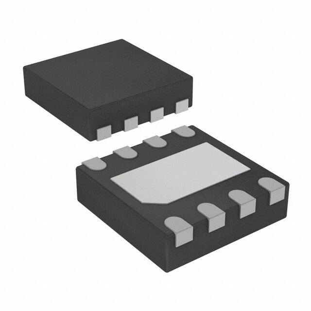

SI51211-A01AFMR 数据手册
Si51211 Data Sheet Three Output Factory Programmable Clock Generator KEY FEATURES The factory programmable Si51211 is a low power, small footprint and frequency flexible programmable clock generator targeting low power, low cost and high volume consumer and embedded applications. The device operates from a single crystal or an external clock source and generates 1 to 3 outputs up to 170 MHz. The device is factory programmed to provide customized output frequencies and control input such as frequency select, spread spectrum on, power down and output enable. Center spread spectrum can also be programmed to reduce EMI to meet board level system requirements. Applications • 8 to 48 MHz crystal input • Programmable FSEL, SSONb, PD, and OE input functions 4 PLL with Modulation Control XIN/ 3 CLKIN XOUT 2 VDD 1 • Accepts crystal or reference clock input • 3 to 165 MHz reference clock input • Digital still camera • IP phone • Smart meter • Crystal/XO replacement • EMI reduction • Portable devices VDDO 8 • Generates up to 3 CMOS clock outputs from 3 to 170 MHz To Pin 7 V-REG To Core Programmable Configuration Register To Pin 4 and Pin 6 VSS 5 silabs.com | Smart. Connected. Energy-friendly. Buffers, Dividers, and Switch Matrix SSCLK1/ REFCLK/ OE/FSEL/ SSONb SSCLK2/ 6 OE/SSONb/PD 7 SSCLK3 (VDDO) Rev. 1.0 Si51211 Data Sheet Feature List 1. Feature List The Si51211 highlighted features are listed below. • Generates up to 3 CMOS clock outputs from 3 to 170 MHz • Accepts crystal or reference clock input • 3 to 165 MHz reference clock input • 8 to 48 MHz crystal input • Programmable FSEL, SSONb, PD, and OE input functions • Low power dissipation silabs.com | Smart. Connected. Energy-friendly. • Separate voltage supply pins • VDD = 2.5 to 3.3 V • VDDO = 1.8 to 3.3 V (VDDO < VDD) • ±0.25%, ±0.5% or ±1% spread spectrum (center spread) • Low cycle-cycle jitter • Ultra small 8-pin TDFN package (1.4 mm x 1.6 mm) Rev. 1.0 | 1 Si51211 Data Sheet Design Considerations 2. Design Considerations 2.1 Typical Application Schematic 2.2 Comments and Recommendations Decoupling Capacitor: A decoupling capacitor of 0.1 μF must be used between VDD and VSS on pins 1 and 8. Place the capacitor on the component side of the PCB as close to the VDD pin as possible. The PCB trace to the VDD pin and to the GND via should be kept as short as possible. Do not use vias between the decoupling capacitor and the VDD pin. In addition, a 10 µF capacitor should be placed between VDD and VSS. Series Termination Resistor: A series termination resistor is recommended if the distance between the outputs (SSCLK or REFCLK pins) and the load is over 1 ½ inches. The nominal impedance of the SSCLK output is about 30 Ω. Use a 20 Ω resistor in series with the output to terminate a 50 Ω trace impedance and place a 20 Ω resistor as close to the SSCLK output as possible. Crystal and Crystal Load: Only use a parallel resonant fundamental AT cut crystal. Do not use higher overtone crystals. To meet the crystal initial accuracy specification (in ppm) make sure that the external crystal load capacitor is matched to the crystal load specification. To determine the value of CL1 and CL2, use the following formula: CL1 = CL2 = 2CL − (Cpin + Cp); where CL is the load capacitance stated by the crystal manufacturer, Cpin is the Si51211 pin capacitance (3 pF), and Cp is the parasitic capacitance of the PCB traces. Example: If a crystal with CL = 12 pF specification is used and Cp = 1 pF (parasitic PCB capacitance on PCB), 19 or 20 pF external capacitors from pins XIN (pin 2) and XOUT (Pin 3) to VSS are required. Users must verify Cp value. Table 2.1. Crystal Specifications Equivalent Series Resistance (ESR) Crystal Output Capacitance (CO) Load Capacitance (CL) < 50 Ω < 3 pF < 13 pF silabs.com | Smart. Connected. Energy-friendly. Rev. 1.0 | 2 Si51211 Data Sheet Electrical Specifications 3. Electrical Specifications Table 3.1. DC Electrical Specifications (VDD = 2.5 V ±10%, or VDD = 3.3V ±-10%, VDDO = VDD, CL = 10 pF, TA = –40 to 85 °C) Parameter Symbol Operating Voltage VDD Output High Voltage Test Condition Min Typ Max Unit VDD = 3.3 V ± 10% 2.97 3.3 3.63 V VDD = 2.5 V ± 10% 2.25 2.5 2.75 V VDDO VDDO < VDD 1.71 — 3.6 V VOH IOH = –4 mA, VDDX – 0.5 — — V VDDX = VDD or VDDO Output Low Voltage VOL IOL = 4 mA — — 0.3 V Input High Voltage VIH CMOS Level 0.7 VDD — — V Input Low Voltage VIL CMOS Level 0 — 0.3 VDD V Operating Supply Current1 IDD FIN = 12 MHz, SSCLK1 = 12 MHz, SSCLK2 = 24 MHz, CL= 5 pF, VDD = VDDO = 3.3 V — 6.3 10 mA IDDPD — 0.5 0.65 mA — 30 — Ω Pin 6 — 150k — Ω Input pin capacitance — 3 5 pF — — 10 pF Power Down Current Nominal Output Impedance ZO Internal Pull-up/Pull-down Resistor RPUP/RPD Input Pin Capacitance CIN Load Capacitance CL Note: 1. IDD depends on input and output frequency configurations. Table 3.2. AC Electrical Specifications (VDD = 2.5 V ±10%, or VDD = 3.3 V ±10%, VDDO = VDD, CL = 10 pF, TA = –40 to 85 °C) Parameter Symbol Condition Min Typ Max Unit Input Frequency Range FIN1 Crystal input 8 — 48 MHz Input Frequency Range FIN2 Reference clock Input 3 — 165 MHz Output Frequency Range FOUT SSCLK1/2/3 3 — 170 MHz Frequency Accuracy FACC Configuration dependent — 0 — ppm DCOUT Measured at VDDO/2 45 50 55 % 40 50 60 % 30 50 70 % Output Duty Cycle FOUT < 75 MHz Measured at VDDO/2 FOUT > 75 MHz Input Duty Cycle DCIN silabs.com | Smart. Connected. Energy-friendly. CLKIN, CLKOUT through PLL Rev. 1.0 | 3 Si51211 Data Sheet Electrical Specifications Parameter Symbol Condition Min Typ Max Unit Output Rise/Fall Time tr/tf CL= 10 pF, 20 to 80% — 1 2 ns Period Jitter PJ1 SSCLK1/2/3, at the same frequency — 12 20 ps rms PJ2 SSCLK1/2/3, at different output frequencies1 — 30 952 ps rms CCJ1 SSCLK1/2/3, at the same frequency — 85 150 ps CCJ2 SSCLK1/2/3, at different output frequencies1 — 145 2902 ps Power-up Time tPU Time from 0.9 VDD to valid frequencies at all clock outputs — 1.2 5 ms Output Enable Time tOE Time from OE rising edge to active at outputs SSCLK1/2 (asynchronous), FOUT = 133 MHz — 15 — ns Output Disable Time tOD Time from OE falling edge to active at outputs SSCLK1/2 (asynchronous), FOUT = 133 MHz — 15 — ns — 37 — kHz Cycle-to-Cycle Jitter Spread Spectrum Modulation Rate3 SSDEV Note: 1. Example frequency configurations: • 8 MHz, 100 MHz, 75 MHz • 48 MHz, 100 MHz, 66 2/3 MHz • 96 MHz, 133 1/3 MHz, 133 1/3 MHz 2. Jitter performance depends on configuration and programming parameters. 3. The SS modulation rate is a fixed ratio of the reference frequency with values in the range of 30 kHz to 50 kHz based on the frequency plan. Table 3.3. Absolute Maximum Conditions Parameter Symbol Condition Min Typ Max Unit –0.5 — 4.2 V Main Supply Voltage VDD Input Voltage VIN Relative to VSS –0.5 — VDD+0.5 V Temperature, Storage TS Non-functional –65 — 150 °C Temperature, Operating Ambient TA Functional, I-Grade –40 — 85 °C ESD Protection (Human Body Model) ESDHBM JEDEC (JESD 22-A114) –4000 — 4000 V ESD Protection (Charge Device Model) ESDCDM JEDEC (JESD 22-C101) –1500 — 1500 V ESD Protection (Machine Model) ESDMM JEDEC (JESD 22-A115) –200 — 200 V Note: 1. While using multiple power supplies, the Voltage on any input or I/O pin cannot exceed the power pin during power-up. Power supply sequencing is not required. silabs.com | Smart. Connected. Energy-friendly. Rev. 1.0 | 4 Si51211 Data Sheet Functional Description 4. Functional Description 4.1 Input Frequency Range The input frequency range is from 8.0 to 48.0 MHz for crystals and ceramic resonators. If an external clock is used, the input frequency range is from 3.0 to 165.0 MHz. 4.2 Output Frequency Range and Outputs Up to three outputs can be programmed as SSCLK or REFCLK. SSCLK output can be synthesized to any value from 3 to 170 MHz with spread based on valid input frequency. The spread at the SSCLK pins can be enabled or disabled by the SSONb input control pin. If SSONb is used, when this pin is pulled high (VDD), the frequency at SSCLK pin is synthesized to the nominal value of the input frequency without spread. If low (GND), the frequency at SSCLK is synthesized to the nominal value of the input frequency with spread.. REFCLK is the buffered output of the oscillator and is the same frequency as the input frequency without spread. By using only low cost, fundamental mode crystals, the Si51211 can synthesize output frequency up to 170 MHz, eliminating the need for higher order crystals (Xtals) and crystal oscillators (XOs). This reduces the cost while improving the system clock accuracy, performance, and reliability. 4.3 Programmable Spread Percent (%) The spread percent (%) value is programmable to ±0.25%, ±0.5% or ±1% (center spread) for all SSCLK frequencies. 4.4 SSONb or Frequency Select (FSEL) The Si51211 pins 4 and 6 can be programmed as SSONb to enable or disable the programmed spread percent value. If SSONb is used, when this pin is pulled high (VDD),the frequency at SSCLK pin is synthesized to the nominal value of the input frequency without spread. If low (GND), the frequency at SSCLK is synthesized to the nominal value of the input frequency with spread. Pin 4 can also be programmed as frequency select (FSEL) function. If FSEL function is used, the output pin can be programmed for different set of frequencies as selected by FSEL. SSCLK value can be any frequency from 3 to up to 170 MHz, but the spread % is the same percent value. REFCLK is the same frequency as the input reference clock. The set of frequencies in the table below are given as an example, using a 48 MHz crystal. Table 4.1. Example Frequencies FSEL SSCLK1 Pin 4 Pin 6 0 66 MHz, ±1% 1 33 MHz, ±1% 4.5 Power Down (PD) or Output Enable (OE) The Si51211 pin 6 can be programmed as PD input. Pin 4 and pin 6 can be programmed as OE input. PD turns off both PLL and output buffers whereas OE only disables the output buffers to Hi-Z. The OE function is asynchronous. Any requirement for synchronous operations (like glitchless output clock switching) needs to be handled externally. silabs.com | Smart. Connected. Energy-friendly. Rev. 1.0 | 5 Si51211 Data Sheet Pin Description 5. Pin Description VDD 1 XOUT 2 XIN/CLKIN SSCLK1/REFCLK FSEL/SSONb/OE 8 VDDO 7 SSCLK3 3 6 SSCLK2/SSONb/OE/ PD 4 5 VSS Si51211 Figure 5.1. 8-Pin TDFN Table 5.1. Si51211 8-Pin Descriptions Pin # Name Type Description 1 VDD PWR 2.5 to 3.3 V power supply. 2 XOUT O Crystal output. Leave this pin unconnected (floating) if an external clock input is used. 3 XIN/CLKIN I External crystal and clock input. 4 SSCLK1/REFCLK/FSEL/SSONb/OE I/O 5 VSS GND 6 SSCLK2/SSONb/PD/OE I/O Programmable SSCLK2 output or MultiFunction control input. The frequency at this pin is synthesized by the internal PLL if programmed as SSCLK2 with or without spread. SSCLK2 output can also be programmed as a buffered output of crystal or reference clock input divided by N, 2 < N < 8. If programmed as a MultiFunction control input, it can be OE, PD, and SSONb. This pin cannot be programmed as FSEL control input. 7 SSCLK3 O Programmable SSCLK3 output. The frequency at this pin is synthesized by internal PLL with or without spread. It is powered by VDDO pin (pin 8). 8 VDDO PWR 1.8 to 3.3 V output power supply to SSCLK3 (pin 7) VDDO ≤ VDD. silabs.com | Smart. Connected. Energy-friendly. Programmable SSCLK1 or REFCLK output or MultiFunction control input. The frequency at this pin is synthesized by the internal PLL if programmed as SSCLK1 with or without spread. If programmed as REFCLK, output clock is a buffered output of crystal or reference clock input. If programmed as a MultiFunction control input, it can be OE, FSEL, and SSONb. Ground. Rev. 1.0 | 6 Si51211 Data Sheet Ordering Guide 6. Ordering Guide Table 6.1. Si51211 Ordering Guide Part Number Package Type Temperature Si51211-Axxxxx-GM 8-pin TDFN Industrial, –40 to 85 °C Si51211-Axxxxx-GMR 8-pin TDFN—Tape and Reel Industrial, –40 to 85 °C Si51211 Si 52112 Axxxxx Bx Si512xx Programmable Clock Generator Product Family GMR GM2R Operating Temp Range G = -40 to 85°C M = TDFN, ROHS6, Pb-free R = Tape & Reel (Blank) = Coil Tape A = Product Revision A xxxxx = 2nd option code A five character code will be assigned for each unique configuration silabs.com | Smart. Connected. Energy-friendly. Rev. 1.0 | 7 Si51211 Data Sheet Package Outline 7. Package Outline Figure 7.1. 8-pin TDFN Table 7.1. Si51211 Package Dimensions Dimension mm mils Symbol Min Max Min Max A 0.70 0.80 27.56 31.50 A1 0 0.05 0 1.97 A3 0.175 0.225 6.89 8.86 D 1.3 1.5 51.18 59.06 E 1.5 1.7 59.06 66.93 D2 0.20 0.30 7.87 11.81 E2 1.0 1.1 39.37 43.31 e 0.4 BSC 15.75 BSC NX b 0.15 0.25 5.91 9.84 NX L 0.25 0.45 9.84 17.72 0° 0° 4° 0° 4° ND 0 NE 4 silabs.com | Smart. Connected. Energy-friendly. Rev. 1.0 | 8 Si51211 Data Sheet Package Outline Dimension Symbol mm Min mils Max Min Max Note: 1. Spade width, lead width and lead thickness exclusive of solder plate. 2. Package outline exclusive of mold flashes and burr dimensions. 3. Coplanarity applies to the exposed pad as well as the terminals. Coplanarity shall not exceed 0.08 mm. 4. Warpage shall not exceed 0.10 mm. 5. The Terminal #1 identifier and terminal numbering convention shall conform to JESD 95-1 SPP-012. Details of Terminal #1 identifier are optional, but must be located within the zone indicated. The Terminal #1 identifier may be either a mold or marked feature. 6. ND and NE refer to the number of terminals on each D and E side respectively. silabs.com | Smart. Connected. Energy-friendly. Rev. 1.0 | 9 Si51211 Data Sheet PCB Land Pattern 8. PCB Land Pattern The figure below illustrates the PCB land pattern details for the device. The table below lists the values for the dimensions shown in the illustration. Figure 8.1. Si51211 8-pin TDFN PCB Land Pattern Table 8.1. PCB Land Pattern Dimensions Dimension mm D 1.00 E 0.40 L 0.5 W 0.3 X1 1.05 Y1 0.25 silabs.com | Smart. Connected. Energy-friendly. Rev. 1.0 | 10 Si51211 Data Sheet PCB Land Pattern Dimension mm Note: General 1. All dimensions shown are in millimeters (mm). 2. This Land Pattern Design is based on the IPC-7351 guidelines. 3. All dimensions shown are at Maximum Material Condition (MMC). Least Material Condition is calculated based on a fabrication allowance of 0.05 mm. Solder Mask Design 1. All metal pads are to be non-solder mask defined (NSMD). Clearance between the solder mask and the metal pad is to be 60 μm minimum, all the way around the pad. Stencil Design 1. A stainless steel, laser-cut and electro-polished stencil with trapezoidal walls should be used to assure good solder paste release. 2. The stencil thickness should be 0.125 mm (5 mils). 3. The ratio of stencil aperture to land pad size should be 1:1 for all perimeter pads. 4. A 2x1 array of 0.55 mm square openings on 0.90 mm pitch should be used for the center ground pad. Card Assembly 1. A No-Clean, Type-3 solder paste is recommended. 2. The recommended card reflow profile is per the JEDEC/IPC J-STD-020 specification for Small Body Components. silabs.com | Smart. Connected. Energy-friendly. Rev. 1.0 | 11 Si51211 Data Sheet Revision History 9. Revision History 9.1 Revision 1.0 April 20, 2016 • Updated max output frequency to 170 MHz • Updated max clock input frequency to 165 MHz • Updated Operating Temperature to Industrial temperature, –40 °C to 85 °C • Updated PD programmable active state • Removed programmable output rise/fall time, SSEL. • Updated Table 3.1 DC Electrical Specifications on page 3 • Updated Table 3.2 AC Electrical Specifications on page 3 • Updated pin descriptions in Pin Descriptions • Updated customized part numbering nomenclature in 6. Ordering Guide • Added land pattern drawing silabs.com | Smart. Connected. Energy-friendly. Rev. 1.0 | 12 Table of Contents 1. Feature List . . . . . . . . . . . . . . . . . . . . . . . . . . . . . . . . 1 2. Design Considerations. . . . . . . . . . . . . . . . . . . . . . . . . . . . 2 2.1 Typical Application Schematic . . . . . . . . . . . . . . . . . . . . . . . . 2 2.2 Comments and Recommendations . . . . . . . . . . . . . . . . . . . . . . . 2 3. Electrical Specifications . . . . . . . . . . . . . . . . . . . . . . . . . . . 3 4. Functional Description. . . . . . . . . . . . . . . . . . . . . . . . . . . . 5 4.1 Input Frequency Range . . . . . . . . . . . . . . . . . . . . . . . . . . 5 4.2 Output Frequency Range and Outputs . . . . . . . . . . . . . . . . . . . . . 5 4.3 Programmable Spread Percent (%) . . . . . . . . . . . . . . . . . . . . . . 5 4.4 SSONb or Frequency Select (FSEL) . . . . . . . . . . . . . . . . . . . . . . 5 4.5 Power Down (PD) or Output Enable (OE) . . . . . . . . . . . . . . . . . . . . 5 5. Pin Description . . . . . . . . . . . . . . . . . . . . . . . . . . . . . . 6 6. Ordering Guide . . . . . . . . . . . . . . . . . . . . . . . . . . . . . . 7 7. Package Outline . . . . . . . . . . . . . . . . . . . . . . . . . . . . . . 8 8. PCB Land Pattern . . . . . . . . . . . . . . . . . . . . . . . . . . . . 10 9. Revision History . . . . . . . . . . . . . . . . . . . . . . . . . . . . . 12 9.1 Revision 1.0 . . . . . . . . . . . . . . . . . . . . . . . . . . . . . .12 Table of Contents 13 ClockBuilder Pro One-click access to Timing tools, documentation, software, source code libraries & more. Available for Windows and iOS (CBGo only). www.silabs.com/CBPro Timing Portfolio www.silabs.com/timing SW/HW www.silabs.com/CBPro Quality www.silabs.com/quality Support and Community community.silabs.com Disclaimer Silicon Laboratories intends to provide customers with the latest, accurate, and in-depth documentation of all peripherals and modules available for system and software implementers using or intending to use the Silicon Laboratories products. Characterization data, available modules and peripherals, memory sizes and memory addresses refer to each specific device, and "Typical" parameters provided can and do vary in different applications. Application examples described herein are for illustrative purposes only. Silicon Laboratories reserves the right to make changes without further notice and limitation to product information, specifications, and descriptions herein, and does not give warranties as to the accuracy or completeness of the included information. Silicon Laboratories shall have no liability for the consequences of use of the information supplied herein. This document does not imply or express copyright licenses granted hereunder to design or fabricate any integrated circuits. The products are not designed or authorized to be used within any Life Support System without the specific written consent of Silicon Laboratories. A "Life Support System" is any product or system intended to support or sustain life and/or health, which, if it fails, can be reasonably expected to result in significant personal injury or death. Silicon Laboratories products are not designed or authorized for military applications. Silicon Laboratories products shall under no circumstances be used in weapons of mass destruction including (but not limited to) nuclear, biological or chemical weapons, or missiles capable of delivering such weapons. Trademark Information Silicon Laboratories Inc.® , Silicon Laboratories®, Silicon Labs®, SiLabs® and the Silicon Labs logo®, Bluegiga®, Bluegiga Logo®, Clockbuilder®, CMEMS®, DSPLL®, EFM®, EFM32®, EFR, Ember®, Energy Micro, Energy Micro logo and combinations thereof, "the world’s most energy friendly microcontrollers", Ember®, EZLink®, EZRadio®, EZRadioPRO®, Gecko®, ISOmodem®, Precision32®, ProSLIC®, Simplicity Studio®, SiPHY®, Telegesis, the Telegesis Logo®, USBXpress® and others are trademarks or registered trademarks of Silicon Laboratories Inc. ARM, CORTEX, Cortex-M3 and THUMB are trademarks or registered trademarks of ARM Holdings. Keil is a registered trademark of ARM Limited. All other products or brand names mentioned herein are trademarks of their respective holders. Silicon Laboratories Inc. 400 West Cesar Chavez Austin, TX 78701 USA http://www.silabs.com
