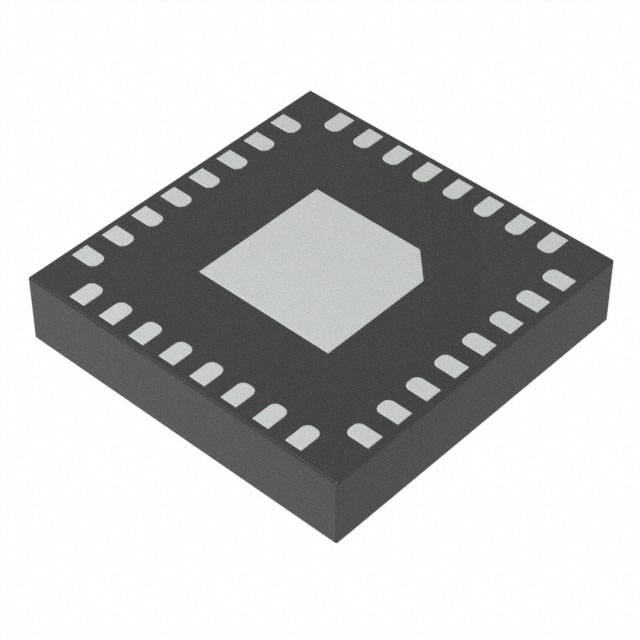

SI5332F-D-GM1
SI5332F-D-GM1
    SILABS(芯科科技)
    TFQFN-32
    SI5332F-D-GM1
SI5332F-D-GM1 数据手册
