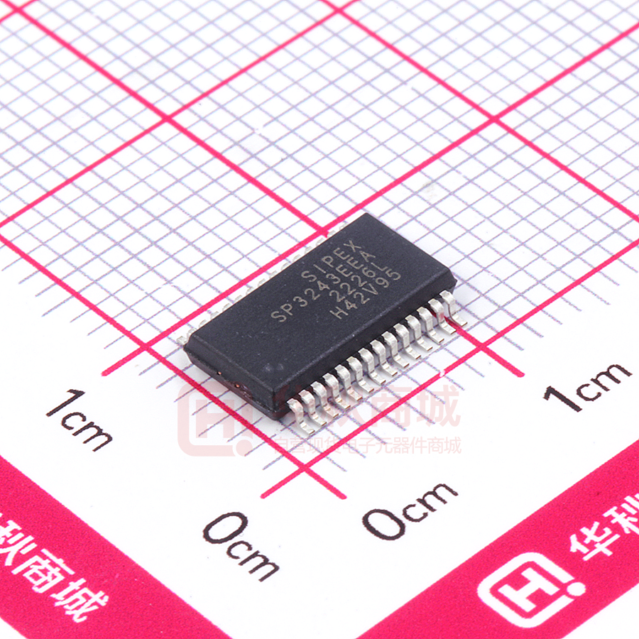

SP3243E Data Sheet 3 Driver / 5 Receiver Intelligent +3.0V to +5.5V RS-232 Transceivers General Description Features The SP3243E products (SP3243E, SP3243EB, SP3243EH, and SP3243EU) are 3 driver / 5 receiver RS-232 transceiver solutions intended for portable or hand-held applications such as notebook and palmtop computers. The SP3243E includes one complementary receiver that remains alert to monitor an external device’s Ring Indicate signal while the device is shutdown. The SP3243E and EB devices feature slew-rate limited outputs for reduced crosstalk and EMI. The “EU” and “EH” series are optimized for high speed with data rates up to 1Mbps, easily meeting the demands of high speed RS-232 applications. The SP3243E series uses an internal high-efficiency charge-pump power supply that requires only 0.1µF capacitors in 3.3V operation. This charge pump and MaxLinear’s driver architecture allow the SP3243E series to deliver compliant RS-232 performance from a single power supply ranging from +3.0V to +5.5V. The AUTO ON-LINE feature allows the device to automatically “wake-up” during a shutdown state when an RS-232 cable is connected and a connected peripheral is turned on. Otherwise, the device automatically shuts itself down, drawing less than 1µA. ■ ■ ■ ■ ■ ■ ■ ■ Meets true EIA / TIA-232-F standards from a +3.0V to +5.5V power supply Interoperable with EIA / TIA-232 and adheres to EIA / TIA-562 down to a +2.7V power source AUTO ON-LINE® circuitry automatically wakes up from a 1µA shutdown Regulated Charge Pump yields stable RS-232 outputs regardless of VCC variations Enhanced ESD specifications:  ±15kV Human Body Model  ±15kV IEC61000-4-2 Air Discharge  ±8kV IEC61000-4-2 Contact Discharge 250kbps minimum transmission rate (EB) 1000kbps minimum transmission rate (EU) Ideal for high speed RS-232 applications Ordering Information - page 23 Selection Table Table 1: SP3243E Selection Table Device Power Supplies SP3243E RS-232 Receivers External Components Auto On-Line Circuitry TTL # of 3-State Pins Data Rate (kbps) ESD Rating +3.0V to +5.5V 3 5 4 capacitors Yes Yes 28 120 15kV SP3243EB +3.0V to +5.5V 3 5 4 capacitors Yes Yes 28 250 15kV SP3243EH +3.0V to +5.5V 3 5 4 capacitors Yes Yes 28 460 15kV SP3243EU +3.0V to +5.5V 3 5 4 capacitors Yes Yes 28 1000 15kV • www.maxlinear.com• Rev. 1.0.4 RS-232 Drivers SP3243E Data Sheet Revision History Revision History Revision Release Date Change Description -- 02/05/06 Legacy Sipex Datasheet 1.0.0 7/23/09 Convert to Exar Format, Update ordering information and change revision to 1.0.0. 1.0.1 11/10/09 Add missing (EH) model identification for Driver output Skew and Transition-Region Slew Rate specification and change revision to 1.0.1. 1.0.2 06/06/11 Remove obsolete devices per PDN 110510-01 and change ESD rating to IEC61000-4-2. 1.0.3 05/24/19 Convert to MaxLinear format. Update Ordering Information and remove obsolete devices. Move pinouts to Pin Information section. Add ESD rating table to Absolute Maximum section. Remove obsolete WSOIC28 package information. 1.0.4 December 1, 2021 Updated: ■ In "Absolute Maximum Ratings" table, replaced "VCC + 6.0" maximum value for the "TxIN, ONLINE, SHUTDOWN" parameter with "6.0". December 1, 2021 232DSR00 ii SP3243E Data Sheet Table of Contents Table of Contents General Description............................................................................................................................................. i Features................................................................................................................................................................ i Selection Table..................................................................................................................................................... i Specifications ..................................................................................................................................................... 1 Absolute Maximum Ratings...........................................................................................................................................1 ESD Ratings ..................................................................................................................................................................1 Electrical Characteristics ...............................................................................................................................................2 Typical Performance Characteristics................................................................................................................ 4 Pin Information ................................................................................................................................................... 5 Pin Configuration ...........................................................................................................................................................5 Pin Descriptions ............................................................................................................................................................6 Typical Operating Circuit ................................................................................................................................... 7 Description .......................................................................................................................................................... 8 Theory of Operation ........................................................................................................................................... 9 Drivers ...........................................................................................................................................................................9 Receivers ....................................................................................................................................................................10 Charge Pump .............................................................................................................................................................. 10 Phase 1: VSS Charge Storage............................................................................................................................10 Phase 2: VSS Transfer........................................................................................................................................10 Phase 3: VDD Charge Storage ...........................................................................................................................11 Phase 4: VDD Transfer .......................................................................................................................................11 AUTO ONLINE Circuitry ..............................................................................................................................................11 ESD Tolerance ............................................................................................................................................................15 Mechanical Dimensions ................................................................................................................................... 17 QFN32 .........................................................................................................................................................................17 Recommended Land Pattern and Stencil....................................................................................................... 18 QFN32 .........................................................................................................................................................................18 Mechanical Dimensions ................................................................................................................................... 19 SSOP28 ......................................................................................................................................................................19 Recommended Land Pattern and Stencil....................................................................................................... 20 SSOP28 ......................................................................................................................................................................20 Mechanical Dimensions ................................................................................................................................... 21 TSSOP28 ....................................................................................................................................................................21 December 1, 2021 232DSR00 iii SP3243E Data Sheet Table of Contents Recommended Land Pattern and Stencil....................................................................................................... 22 TSSOP28 ....................................................................................................................................................................22 Ordering Information........................................................................................................................................ 23 December 1, 2021 232DSR00 iv SP3243E Data Sheet List of Figures List of Figures Figure 1: Transmitter Skew vs. Load Capacitance ............................................................................................... 4 Figure 2: Transmitter Output Voltage vs. Supply Voltage for the SP3243EU....................................................... 4 Figure 3: Transmitter Output Voltage vs. Load Capacitance for the SP3243EU.................................................. 4 Figure 4: Supply Current vs. Load Capacitance for the SP3243EU ..................................................................... 4 Figure 5: Supply Current vs. Supply Voltage for the SP3243EU.......................................................................... 4 Figure 6: Transmitter Output Voltage vs. Load Capacitance for the SP3243EB .................................................. 4 Figure 7: Slew Rate vs. Load Capacitance........................................................................................................... 5 Figure 8: SP3243E Pinout (Top View) SSOP / TSSOP........................................................................................ 5 Figure 9: SP3243E Pinout (Top View) QFN32 ..................................................................................................... 5 Figure 10: SP3243E Typical Operating Circuit ..................................................................................................... 7 Figure 11: Interface Circuitry Controlled by Microprocessor Supervisory Circuit ................................................. 8 Figure 12: Loopback Test Circuit for RS-232 Driver Data Transmission Rates ................................................... 9 Figure 13: Loopback Test Results at 1Mbps ........................................................................................................ 9 Figure 14: Loopback Test Results at 250kbps ..................................................................................................... 9 Figure 15: Charge Pump — Phase 1.................................................................................................................. 10 Figure 16: Charge Pump — Phase 2.................................................................................................................. 10 Figure 17: Charge Pump — Phase 3.................................................................................................................. 11 Figure 18: Charge Pump — Phase 4.................................................................................................................. 11 Figure 19: AUTO ON-LINE Timing Waveforms .................................................................................................. 12 Figure 20: SP3243E Driver Output Voltages vs. Load Current per Transmitter ................................................. 12 Figure 21: Mouse Drive Application.................................................................................................................... 13 Figure 22: Attaching SP3243E to a DB-9 Connector.......................................................................................... 13 Figure 23: Stage I of AUTO ON-LINE Circuitry .................................................................................................. 14 Figure 24: Stage II of AUTO ON-LINE Circuitry ................................................................................................. 14 Figure 25: ESD Test Circuit for Human Body Model .......................................................................................... 16 Figure 26: ESD Test Circuit for IEC61000-4-2 ................................................................................................... 16 Figure 27: ESD Test Waveform for IEC61000-4-2 ............................................................................................. 16 Figure 28: Mechanical Dimensions, QFN32 ....................................................................................................... 17 Figure 29: Recommended Land Pattern and Stencil, QFN32 ............................................................................ 18 Figure 30: Mechanical Dimensions, SSOP28..................................................................................................... 19 Figure 31: Recommended Land Pattern and Stencil, SSOP28.......................................................................... 20 Figure 32: Mechanical Dimensions, TSSOP28 .................................................................................................. 21 Figure 33: Recommended Land Pattern and Stencil, TSSOP28........................................................................ 22 Figure 34: Part Nomenclature............................................................................................................................. 24 December 1, 2021 232DSR00 v SP3243E Data Sheet List of Tables List of Tables Table 1: SP3243E Selection Table........................................................................................................................ i Table 2: Absolute Maximum Ratings .................................................................................................................... 1 Table 3: ESD Ratings ........................................................................................................................................... 1 Table 4: Electrical Characteristics ........................................................................................................................ 2 Table 5: Device Pin Descriptions.......................................................................................................................... 6 Table 6: SP3243E SHUTDOWN Truth Table ..................................................................................................... 10 Table 7: Minimum Recommended Charge Pump Capacitor Value .................................................................... 11 Table 8: AUTO ON-LINE Logic........................................................................................................................... 14 Table 9: Transceiver ESD Tolerance Levels ...................................................................................................... 16 Table 10: Ordering Information........................................................................................................................... 23 December 1, 2021 232DSR00 vi SP3243E Data Sheet Specifications Specifications Absolute Maximum Ratings Important: These are stress ratings only and functional operation of the device at these ratings or any other above those indicated in the operation sections of the specifications below is not implied. Exposure to absolute maximum ratings conditions for extended periods of time may affect reliability and cause permanent damage to the device. Table 2: Absolute Maximum Ratings Parameter Minimum Maximum Units VCC -0.3 6.0 V V+(1) -0.3 7.0 V V-(1) +0.3 -7.0 V V+ + |V-|(1) +13 V ICC (DC VCC or GND current) ±100 mA 6.0 V ±15 V ±13.2 V VCC + 0.3 V Input Voltages TxIN, ONLINE, SHUTDOWN -0.3 RxIN Output Voltages TxOUT -0.3 RxOUT, STATUS Short-Circuit Duration TxOUT Continuous Temperature Storage temperature -65 150 °C 28-pin SSOP (derate 11.2mW/°C above +70°C) 900 mW 28-pin TSSOP (derate 13.2mW/°C above +70°C) 1059 mW 32-pin QFN (derate 29.4mW/°C above +70°C) 2352 mW Value Units ±15 kV Power Dissipation per Package 1. V+ and V- can have maximum magnitudes of 7V, but their absolute difference cannot exceed 13V. ESD Ratings Table 3: ESD Ratings Parameter Level HBM — Human Body Model (driver outputs and receiver inputs) IEC61000-4-2 Air Discharge (driver outputs and receiver inputs) 4 ±15 kV IEC61000-4-2 Contact Discharge (driver outputs and receiver inputs) 4 ±8 kV December 1, 2021 232DSR00 1 SP3243E Data Sheet Electrical Characteristics Electrical Characteristics Unless otherwise noted, the following specifications apply for VCC = +3.0V to +5.5V with TAMB = TMIN to TMAX, C1 - C4 = 0.1µF. Typical values apply at VCC = +3.3V or +5.0V and TAMB = 25°C. Table 4: Electrical Characteristics Parameter Test Condition Minimum Typical Maximum Units DC Characteristics Supply current, AUTO ON-LINE All RxIN open, ONLINE = GND, SHUTDOWN = VCC, VCC = 3.3V, TAMB = 25oC, TxIN = GND or VCC 1.0 10 µA Supply current, shutdown SHUTDOWN = GND, VCC = 3.3V, TAMB = 25oC, TxIN = VCC or GND 1.0 10 µA Supply current, AUTO ON-LINE disabled ONLINE = SHUTDOWN = Vcc, no load, VCC = 3.3V, TAMB = +25oC, TxIN = GND or VCC 0.3 1.0 mA 0.8 V Logic Inputs and Receiver Outputs Input logic threshold Low High VCC = 3.3V or 5.0V, TxIN, ONLINE, SHUTDOWN 2.4 V Input leakage current TxIN, ONLINE, SHUTDOWN, TAMB = +25°C, VIN = 0V to VCC ±0.01 ±1.0 µA Output leakage current Receivers disabled, VOUT = 0V to VCC ±0.05 ±10 µA Output voltage Low IOUT = 1.6mA 0.4 V Output voltage High IOUT = -1.0mA VCC - 0.6 VCC - 0.1 V Output voltage swing All driver outputs loaded with 3kΩ to GND, TAMB = +25oC ±5.0 ±5.4 V Output resistance VCC = V+ = V- = 0V, VOUT = +2V 300 Output short-circuit current VOUT = 0V Output leakage current VCC = 0V or 3.0V to 5.5V, VOUT = +12V, drivers disabled Driver Outputs Ω ±35 ±60 mA ±25 µA 15 V Receiver Inputs Input voltage range Input threshold Low Input threshold High -15 VCC = 3.3V 0.6 1.2 V VCC = 5.0V 0.8 1.5 V VCC = 3.3V 1.5 2.4 V VCC = 5.0V 1.8 2.4 V 7 kΩ Input hysteresis 0.3 Input resistance December 1, 2021 3 232DSR00 5 V 2 SP3243E Data Sheet Electrical Characteristics Table 4: Electrical Characteristics Parameter Test Condition Minimum Typical Maximum Units AUTO ON-LINE Circuitry Characteristics (ONLINE = GND, SHUTDOWN = VCC) 25°C STATUS output voltage Low IOUT = 1.6mA STATUS output voltage High IOUT = -1.0mA Receiver threshold to drivers enabled (tONLINE) Figure 19 350 Receiver positive or negative threshold to STATUS High (tSTSH) Figure 19 0.2 Receiver positive or negative threshold to STATUS Low (tSTSL) Figure 19 30 0.4 VCC - 0.6 V V µs µs µs Timing Characteristics Maximum data rate Receiver propagation delay U RL = 3kΩ, CL = 250pF, one driver active 1000 kbps H RL = 3kΩ, CL = 1000pF, one driver active 460 kbps B RL = 3kΩ, CL = 1000pF, one driver active 250 kbps - RL = 3kΩ, CL = 1000pF, one driver active 120 kbps tPHL tPLH Receiver input to receiver output, CL = 150pF 0.15 µs 0.15 µs Receiver output enable time Normal operation 200 ns Receiver output disable time Normal operation 200 ns Driver skew Receiver skew Transition-region slew rate December 1, 2021 E, EB EH, EU | tPHL - tPLH | | tPHL - tPLH | EH, EU VCC = 3.3V, RL = 3kΩ, TAMB = 25°C, measurements taken from -3.0V to +3.0V or E, EB +3.0V to -3.0V 232DSR00 6 100 500 ns 50 100 ns 50 ns 90 V/µs 30 V/µs 3 SP3243E Data Sheet Typical Performance Characteristics Typical Performance Characteristics Unless otherwise noted, the following performance characteristics apply for VCC = +3.3V, 1000kbps data rate, all drivers loaded with 3kΩ, 0.1µF charge pump capacitors, and TAMB = +25°C. 200 Transmitter Output Voltage (V) Skew (ns) 150 100 T1 at 500Kbps T2 at 31.2Kbps All TX loaded 3K // CLoad 50 6 4 2 -2 -4 0 -6 0 250 500 1000 Load Capacitance (pF) 1500 2.7 2000 Figure 1: Transmitter Skew vs. Load Capacitance 3.5 4 Supply Voltage (V) 4.5 5 40 6 2Mbps 4 35 1.5Mbps 1Mbps 2 1 TX at full data rate 2 TX’ s at1/16 data rate 0 -2 1Mbps -4 1.5Mbps 2Mbps 30 120K bps 250K bps 25 20K bps 20 15 1 T ra ns mi tte r a t full D a ta R a te 10 2 T ra ns mi tte rs a t 1 5.5 K bps 5 A ll Tra ns mi tte rs loa de s 3K + Loa d C a p 0 -6 0 250 500 1000 Load Capacitance (pF) 1500 0 2000 1000 2000 3000 4000 5000 Load Capacitance (pF) Figure 4: Supply Current vs. Load Capacitance for the SP3243EU Figure 3: Transmitter Output Voltage vs. Load Capacitance for the SP3243EU 6 Transmitter Output Voltage (V) 25 20 Supply Current (mA) 3 Figure 2: Transmitter Output Voltage vs. Supply Voltage for the SP3243EU Supply Current (mA) Transmitter Output Voltage (V) 1 D rive r a t 1Mbps O the r D rive rs a t 62.5K bps A ll Drivers Loa de d w ith 3K // 250pF 0 15 10 1 T ransmitter at 250Kbps 2 T ransmitters at 15.6Kbps All drivers loaded with 3K // 1000pF 5 0 2.7 3 3.5 4 4.5 TxOUT + 2 0 -2 TxOUT - -4 -6 5 Supply Voltage (V DC ) 0 1000 2000 3000 4000 5000 Load Capacitance (pF) Figure 6: Transmitter Output Voltage vs. Load Capacitance for the SP3243EB Figure 5: Supply Current vs. Supply Voltage for the SP3243EU December 1, 2021 4 232DSR00 4 SP3243E Data Sheet Pin Information 25 Slew Rate (V/μs) 20 - Slew + Slew 15 10 1 Transmitter at 250Kbps 2 Transmitter at 15.6Kbps All drivers loaded 3K + Load Cap 5 0 0 500 1000 2000 3000 4000 5000 Load Capacitance (pF) Figure 7: Slew Rate vs. Load Capacitance Pin Information 24 C1- R3IN 6 R5IN 8 22 SHUTDOWN 21 STATUS T1OUT 9 20 R2OUT T2OUT 10 19 R1OUT T3OUT 11 18 R2OUT T3IN 12 17 R3OUT T2IN 13 16 R4OUT T1IN 14 15 R5OUT Figure 8: SP3243E Pinout (Top View) SSOP / TSSOP December 1, 2021 24 2 23 3 22 4 21 SP3243E 5 20 6 19 7 18 8 17 9 7 23 ONLINE 1 NC GND C1ONLINE SHUTDOWN STATUS R 2 OUT R1 OUT T3 OUT T3 IN T2 IN T1 IN R5OUT R4OUT R3OUT R 2OUT R4IN SP3243E NC R1 IN R2 IN R3 IN R4 IN R5 IN T1OUT T2OUT 25 5 16 R2IN 26 GND 27 25 15 4 14 R1IN 28 VCC 13 26 29 3 30 V- 12 V+ 11 27 31 C2- 2 10 28 C1+ 32 C2+ 1 VC2NC C2+ C1+ NC V+ VCC Pin Configuration 232DSR00 Figure 9: SP3243E Pinout (Top View) QFN32 5 SP3243E Data Sheet Pin Descriptions Pin Descriptions Table 5: Device Pin Descriptions Pin Number Name Function SP3243E SSOP SP3243EUCR QFN and TSSOP C1+ Positive terminal of the voltage doubler charge-pump capacitor 28 28 V+ Regulated +5.5V output generated by the charge pump 27 26 C1- Negative terminal of the voltage doubler charge-pump capacitor 24 22 C2+ Positive terminal of the inverting charge-pump capacitor 1 29 C2- Negative terminal of the inverting charge-pump capacitor 2 31 V- Regulated -5.5V output generated by the charge pump 3 32 R1IN RS-232 receiver input 4 2 R2IN RS-232 receiver input 5 3 R3IN RS-232 receiver input 6 4 R4IN RS-232 receiver input 7 5 R5IN RS-232 receiver input 8 6 R1OUT TTL / CMOS receiver output 19 17 R2OUT TTL / CMOS receiver output 18 16 R2OUT Non-inverting receiver-2 output, active in shutdown 20 18 R3OUT TTL / CMOS receiver output 17 15 R4OUT TTL / CMOS receiver output 16 14 R5OUT TTL / CMOS receiver output 15 13 STATUS TTL / CMOS output indicating online and shutdown status 21 19 T1IN TTL / CMOS driver input 14 12 T2IN TTL / CMOS driver input 13 11 T3IN TTL / CMOS driver input 12 10 ONLINE Apply logic HIGH to override AUTO ON-LINE circuitry keeping drivers active 23 (SHUTDOWN must also be logic HIGH, refer to Table 6) 21 T1OUT RS-232 driver output 9 7 T2OUT RS-232 driver output 10 8 T3OUT RS-232 driver output 11 9 GND Ground 25 23 VCC +3.0V to +5.5V supply voltage 26 25 SHUTDOWN Apply logic LOW to SHUTDOWN driver and charge pump. This overrides all AUTO ON-LINE circuitry and ONLINE (Refer to Table 6) 22 20 NC No connection - 1, 24, 27, 30 December 1, 2021 232DSR00 6 SP3243E Data Sheet Typical Operating Circuit Typical Operating Circuit VCC C5 C1 + + 26 VCC 0.1μ F 28 C1+ V+ 27 0.1μ F C3 + 0.1μ F 24 C11 C2+ C2 + 0.1μ F TTL/CMOS INPUTS SP3243E V- 3 C4 2 C214 T1IN T1OUT 13 T2IN T2OUT 10 12 T3IN T3OUT 11 + 0.1μ F 9 RS-232 OUTPUTS 20 R2OUT 19 R1OUT R1IN 4 R2IN 5 R3IN 6 R4IN 7 R5IN 8 5kΩ 18 R2OUT 5kΩ TTL/CMOS OUTPUTS 17 R3OUT 5kΩ 16 R4OUT RS-232 INPUTS 5kΩ 15 VCC 22 23 To μ P Supervisor Circuit R5OUT 5kΩ SHUTDOWN ONLINE 21 STATUS GND 25 Figure 10: SP3243E Typical Operating Circuit December 1, 2021 232DSR00 7 SP3243E Data Sheet Description Description The SP3243E transceivers meet the EIA / TIA-232 and ITU-T V.28 / V.24 communication protocols and can be implemented in battery-powered, portable or hand-held applications such as notebook or palmtop computers. The SP3243E devices feature MaxLinear’s proprietary and patented (U.S. 5,306,954) on-board charge pump circuitry that generates ±5.5V RS-232 voltage levels from a single +3.0V to +5.5V power supply. The SP3243EU device can operate at a data rate of 1000kbps fully loaded. controller IC by preventing forward biasing of the protection diodes where VCC may be disconnected. The SP3243E series is an ideal choice for power sensitive designs. The SP3243E devices feature AUTO ON-LINE circuitry which reduces the power supply drain to a 1µA supply current. The SP3243E is a 3-driver / 5-receiver device, ideal for portable or hand-held applications. The SP3243E includes one complementary always-active receiver that can monitor an external device (such as a modem) in shutdown. This aids in protecting the UART or serial In many portable or hand-held applications, an RS-232 cable can be disconnected or a connected peripheral can be turned off. Under these conditions, the internal charge pump and the drivers will be shut down. Otherwise, the system automatically comes online. This feature allows design engineers to address power saving concerns without major design changes. VCC + C5 + C1 26 VCC 0.1 μF 28 C1+ V+ 27 0.1 μF C3 + 0.1 μF 24 C11 C2+ C2 + 0.1 μF SP3243E V- 3 C4 2 C2- TxD 14 T1 IN T1 OUT RTS 13 T2 IN T2 OUT 10 DTR 12 T3 IN T3 OUT 11 + 0.1 μF 9 RS-232 OUTPUTS 20 R2 OUT UART or Serial μC RxD 19 R1 OUT CTS 18 R2 OUT R 1 IN 4 5KΩ R 2 IN 5 R 3 IN 6 R 4 IN 7 R 5 IN 8 5KΩ DSR 17 R3 OUT 5KΩ DCD 16 R4OUT RS-232 INPUTS 5KΩ 15 R5OUT RI VCC 22 23 21 5KΩ SHUTDOWN ONLINE STATUS GND 25 RESET μP Supervisor IC VIN Figure 11: Interface Circuitry Controlled by Microprocessor Supervisory Circuit December 1, 2021 232DSR00 8 SP3243E Data Sheet Theory of Operation Theory of Operation +3V to +5V The SP3243E series is made up of four basic circuit blocks: C5 1. Drivers 2. Receivers C1 + 0.1 μF + V+ 0.1 μF 3. The MaxLinear proprietary charge pump C3 + 0.1 μF C1C2+ 4. AUTO ON-LINE circuitry C2 + SP3243 VC4 0.1 μF C2- Drivers The drivers are inverting level transmitters that convert TTL or CMOS logic levels to 5.0V EIA / TIA-232 levels with an inverted sense relative to the input logic levels. Typically, the RS-232 output voltage swing is ±5.4V with no load and ±5V minimum fully loaded. The driver outputs are protected against infinite short-circuits to ground without degradation in reliability. These drivers comply with the EIA-TIA-232-F and all previous RS-232 versions. Unused drivers inputs should be connected to GND or VCC. TTL/CMOS INPUTS Figure 12 shows a loopback test circuit used to test the RS-232 Drivers. Figure 13 shows the test results where one driver was active at 1Mbps and all three drivers were loaded with an RS-232 receiver in parallel with a 250pF capacitor. Figure 14 shows the test results of the loopback circuit with all drivers active at 250kbps with typical RS-232 loads in parallel with 1000pF capacitors. A superior RS-232 data transmission rate of 1Mbps makes the SP3243EU an ideal match for high speed LAN and personal computer peripheral applications. T1IN T1OUT TXIN TXOUT + 0.1 μF R1IN R1OUT 5KΩ TTL/CMOS OUTPUTS RXIN RXOUT 5KΩ The drivers have a minimum data rate of 250kbps (EB) or 1000kbps (EU) fully loaded. 1000pF VCC 1000pF SHUTDOWN ONLINE To μP Supervisor Circuit STATUS GND 18 Figure 12: Loopback Test Circuit for RS-232 Driver Data Transmission Rates Figure 14: Loopback Test Results at 250kbps Figure 13: Loopback Test Results at 1Mbps December 1, 2021 VCC C1+ 232DSR00 9 SP3243E Data Sheet Receivers Receivers pump is disabled. This oscillator controls the four phases of the voltage shifting. A description of each phase follows. The receivers convert ±5.0V EIA / TIA-232 levels to TTL or CMOS logic output levels. Receivers are High-Z when the AUTO ON-LINE circuitry is enabled or when in shutdown. The truth table logic of the SP3243 driver and receiver outputs can be found in Table 6. Phase 1: VSS Charge Storage Table 6: SP3243E SHUTDOWN Truth Table SHUTDOWN TxOUT RxOUT R2OUT 0 High-Z High-Z Active 1 Active Active Active During this phase of the clock cycle, the positive side of capacitors C1 and C2 are initially charged to VCC. Cl+ is then switched to GND and the charge in C1– is transferred to C2–. Since C2+ is connected to VCC, the voltage potential across capacitor C2 is now 2 times VCC. VCC = +5V 1. In AUTO ON-LINE Mode where ONLINE = GND and SHUTDOWN = VCC, the device will shut down if there is no activity present at the receiver inputs. +5V C1 The SP3243E includes an additional non-inverting receiver with an output R2OUT. R2OUT is an extra output that remains active and monitors activity while the other receiver outputs are forced into high impedance. This allows a Ring Indicator (RI) signal from a peripheral to be monitored without forward biasing the TTL / CMOS inputs of the other devices connected to the receiver outputs. Since receiver input is usually from a transmission line where long cable lengths and system interference can degrade the signal, the inputs have a typical hysteresis margin of 300mV. This ensures that the receiver is virtually immune to noisy transmission lines. Should an input be left unconnected, an internal 5kΩ pull-down resistor to ground will commit the output of the receiver to a HIGH state. + C2 – –5V C4 + – – + + – VDD Storage Capacitor VSS Storage Capacitor C3 –5V Figure 15: Charge Pump — Phase 1 Phase 2: VSS Transfer Phase two of the clock connects the negative terminal of C2 to the VSS storage capacitor and the positive terminal of C2 to GND. This transfers a negative generated voltage to C3. This generated voltage is regulated to a minimum voltage of -5.5V. Simultaneous with the transfer of the voltage to C3, the positive side of capacitor C1 is switched to VCC and the negative side is connected to GND. Charge Pump VCC = +5V The charge pump is a MaxLinear-patented design (U.S. 5,306,954) and uses a unique approach compared to older, less-efficient designs. The charge pump still requires four external capacitors, but uses a four-phase voltage shifting technique to attain symmetrical 5.5V power supplies. The internal power supply consists of a regulated dual charge pump that provides output voltages of 5.5V regardless of the input voltage (VCC) over the +3.0V to +5.5V range. This is important to maintain compliant RS-232 levels regardless of power supply fluctuations. C4 C1 + – C2 + – – + + – -5.5V VDD Storage Capacitor VSS Storage Capacitor C3 Figure 16: Charge Pump — Phase 2 The charge pump operates in a discontinuous mode using an internal oscillator. If the output voltages are less than a magnitude of 5.5V, the charge pump is enabled. If the output voltages exceed a magnitude of 5.5V, the charge December 1, 2021 232DSR00 10 SP3243E Data Sheet AUTO ONLINE Circuitry Phase 3: VDD Charge Storage The third phase of the clock is identical to the first phase — the charge transferred in C1 produces -VCC in the negative terminal of C1, which is applied to the negative side of capacitor C2. Since C2+ is at VCC, the voltage potential across C2 is 2 times VCC. VCC = +5V +5V C1 + C2 – –5V – – + VDD Storage Capacitor VSS Storage Capacitor C3 –5V Figure 17: Charge Pump — Phase 3 Phase 4: VDD Transfer The fourth phase of the clock connects the negative terminal of C2 to GND, and transfers this positive generated voltage across C2 to C4, the VDD storage capacitor. This voltage is regulated to +5.5V. At this voltage, the internal oscillator is disabled. Simultaneous with the transfer of the voltage to C4, the positive side of capacitor C1 is switched to VCC and the negative side is connected to GND, allowing the charge pump cycle to begin again. The charge pump cycle will continue as long as the operational conditions for the internal oscillator are present. VCC = +5V +5.5V C1 + – C2 C4 + – – + + – VDD Storage Capacitor VSS Storage Capacitor C3 Figure 18: Charge Pump — Phase 4 Since both V+ and V– are separately generated from VCC, in a no–load condition V+ and V– will be symmetrical. Older charge pump approaches that generate V– from V+ will show a decrease in the magnitude of V– compared to V+ due to the inherent inefficiencies in the design. The December 1, 2021 Table 7: Minimum Recommended Charge Pump Capacitor Value Input Voltage VCC Charge Pump Capacitor Value 3.0V to 3.6V C1 - C4 = 0.1µF 4.5V to 5.5V C1 = 0.047µF, C2 - C4 = 0.33µF 3.0V to 5.5V C1 - C4 = 0.22µF C4 + + – clock rate for the charge pump typically operates at greater than 250kHz. The external capacitors can be as low as 0.1µF with a 16V breakdown voltage rating. The MaxLinear-patented charge pumps are designed to operate reliably with a range of low cost capacitors. Either polarized or non polarized capacitors may be used. If polarized capacitors are used they should be oriented as shown in the Typical Operating Circuit. The V+ capacitor may be connected to either ground or VCC (polarity reversed.) The charge pump operates with 0.1µF capacitors for 3.3V operation. For other supply voltages, see the table for required capacitor values. Do not use values smaller than those listed. Increasing the capacitor values (for example, by doubling in value) reduces ripple on the transmitter outputs and may slightly reduce power consumption. C2, C3, and C4 can be increased without changing C1’s value. For best charge pump efficiency, locate the charge pump and bypass capacitors as close as possible to the IC. Surface mount capacitors are best for this purpose. Using capacitors with lower equivalent series resistance (ESR) and self-inductance, along with minimizing parasitic PCB trace inductance, will optimize charge pump operation. Designers are also advised to consider that capacitor values may shift over time and operating temperature. AUTO ONLINE Circuitry The SP3243E devices have a patent pending AUTO ONLINE circuitry on board that saves power in applications such as laptop computers, palmtop (PDA) computers and other portable systems. The SP3243E devices incorporate an AUTO ON-LINE circuit that automatically enables itself when the external transmitters are enabled and the cable is connected. Conversely, the AUTO ON-LINE circuit also disables most of the internal circuitry when the device is not being used and goes into a standby mode where the device typically draws 1µA. This function is externally controlled by the ONLINE pin. When this pin is tied to a logic LOW, the 232DSR00 11 SP3243E Data Sheet AUTO ONLINE Circuitry AUTO ON-LINE function is active. Once active, the device is enabled until there is no activity on the receiver inputs. The receiver input typically sees at least ±3V, which is generated from the transmitters at the other end of the cable with a ±5V minimum. When the external transmitters are disabled or the cable is disconnected, the receiver inputs will be pulled down by their internal 5kΩ resistors to ground. When this occurs over a period of time, the internal transmitters will be disabled and the device goes into a shutdown or standby mode. When ONLINE is HIGH, the AUTO ON-LINE mode is disabled. The AUTO ON-LINE circuit has two stages: 1. Inactive Detection S H U T D O W N VCC The STATUS pin outputs a logic LOW signal if the device is shutdown. This pin goes to a logic HIGH when the external transmitters are enabled and the cable is connected. For easy programming, the STATUS can be used to indicate DSR or a Ring Indicator signal. Tying ONLINE and SHUTDOWN together will bypass the AUTO ON-LINE circuitry so this connection acts like a shutdown input pin. STATUS 0V The AUTO ON-LINE mode can be disabled by the SHUTDOWN pin. If this pin is a logic LOW, the AUTO ONLINE function will not operate regardless of the logic state of the ONLINE pin. Table 8 summarizes the logic of the AUTO ON-LINE operating modes. The truth table logic of the SP3243E driver and receiver outputs can be found in Table 6. When the SP3243E devices are shut down, the charge pumps are turned off. V+ charge pump output decays to VCC, the V- output decays to GND. The decay time will depend on the size of capacitors used for the charge pump. Once in shutdown, the time required to exit the shut down state and have valid V+ and V- levels is typically 200µs. 2. Accumulated Delay RECEIVER +2.7V 0V RS-232 INPUT VOLTAGES -2.7V disabled, the supply current is reduced to 1µA. This can commonly occur in hand-held or portable applications where the RS-232 cable is disconnected or the RS-232 drivers of the connected peripheral are turned off. tSTSL tSTSH 6 The first stage, shown in Figure 23, detects an inactive input. A logic HIGH is asserted on RXINACT if the cable is disconnected or the external transmitters are disabled. Otherwise, RXINACT will be at a logic LOW. This circuit is duplicated for each of the other receivers. The second stage of the AUTO ON-LINE circuitry, shown in Figure 24, processes all the receiver’s RXINACT signals with an accumulated delay that disables the device to a 1µA supply current. The STATUS pin goes to a logic LOW when the cable is disconnected, the external transmitters are disabled, or the SHUTDOWN pin is invoked. The typical accumulated delay is around 20µs. -2 8.6 4.93 3.46 2.67 1.82 1.57 1.38 1.23 1.12 1.02 Figure 19: AUTO ON-LINE Timing Waveforms 0 0.939 -5V Vout+ Vout- 2 0.869 0V 4 0.62 +5V DRIVER RS-232 OUTPUT VOLTAGES Transmitter Output Voltage [V] tONLINE -4 -6 Load Current Per Transmitter [mA] Figure 20: SP3243E Driver Output Voltages vs. Load Current per Transmitter The SP3243E driver outputs are able to maintain voltage under loading of up to 2.5mA per driver, ensuring sufficient output for mouse-driving applications. When the SP3243E drivers or internal charge pump are December 1, 2021 232DSR00 12 SP3243E Data Sheet AUTO ONLINE Circuitry VOUT + 0 0 VOUT - 1 Figure 21: Mouse Drive Application VCC + C5 26 VCC 0.1 μF 28 C1+ + V+ 27 0.1 μF C1 + C3 0.1 μF 24 C11 C2+ SP3243E V- 3 + C2 0.1 μF C4 2 C214 T1IN T1OUT 13 T2IN T2OUT 10 12 T3IN T3OUT 11 + 0.1 μF 9 20 R2OUT R1IN 4 19 R1OUT 5k Ω R2IN 5 18 R2OUT 5k Ω R3IN 17 R3OUT 6 5k Ω R4IN 7 16 R4OUT 5k Ω 15 R5OUT VCC 22 23 To μP Supervisor Circuit R5IN 8 5k Ω DB-9 Connector SHUTDOWN ONLINE 21 STATUS 6 7 8 9 GND 25 DB-9 Connector Pins: 1. Received Line Signal Detector 2. Received Data 3. Transmitted Data 4. Data Terminal Ready 5. Signal Ground (Common) 6. 7. 8. 9. 1 2 3 4 5 DCE Ready Request to Send Clear to Send Ring Indicator Figure 22: Attaching SP3243E to a DB-9 Connector December 1, 2021 232DSR00 13 SP3243E Data Sheet AUTO ONLINE Circuitry Table 8: AUTO ON-LINE Logic RS-232 Signal at Receiver Input SHUTDOWN Input ONLINE Input STATUS Output Transceiver Status Yes High Low High Normal operation (Auto-Online) No High High Low Normal operation No High Low Low Shutdown (Auto-Online) Yes Low High / Low High Shutdown No Low High / Low Low Shutdown Inactive Detection Block RXIN RS-232 Receiver Block RXINACT RXOUT Figure 23: Stage I of AUTO ON-LINE Circuitry Delay Stage Delay Stage Delay Stage Delay Stage Delay Stage STATUS R1INACT R2INACT R3INACT R4INACT R5INACT SHUTDOWN Figure 24: Stage II of AUTO ON-LINE Circuitry December 1, 2021 232DSR00 14 SP3243E Data Sheet ESD Tolerance ESD Tolerance The SP3243E series incorporates ruggedized ESD cells on all driver output and receiver input pins. The ESD structure is improved over our previous family for more rugged applications and environments sensitive to electro-static discharges and associated transients. The improved ESD tolerance is at least ±15kV without damage nor latch-up. There are different methods of ESD testing applied: a. MIL-STD-883, Method 3015.7 b. IEC61000-4-2 Air-Discharge c. IEC61000-4-2 Direct Contact The Human Body Model has been the generally accepted ESD testing method for semiconductors. This method is also specified in MIL-STD-883, Method 3015.7 for ESD testing. The premise of this ESD test is to simulate the human body’s potential to store electro-static energy and discharge it to an integrated circuit. The simulation is performed by using a test model as shown in Figure 25. This method will test the IC’s capability to withstand an ESD transient during normal handling such as in manufacturing areas where the ICs tend to be handled frequently. The IEC-61000-4-2, formerly IEC801-2, is generally used for testing ESD on equipment and systems. For system manufacturers, they must guarantee a certain amount of ESD protection since the system itself is exposed to the outside environment and human presence. The premise with IEC61000-4-2 is that the system is required to withstand an amount of static electricity when ESD is applied to points and surfaces of the equipment that are accessible to personnel during normal usage. The transceiver IC receives most of the ESD current when the ESD source is applied to the connector pins. The test circuit for IEC61000-4-2 is shown on Figure 26. There are two methods within IEC61000-4-2, the Air Discharge method and the Contact Discharge method. humidity will tend to change the discharge current. For example, the rise time of the discharge current varies with the approach speed. The Contact Discharge Method applies the ESD current directly to the EUT. This method was devised to reduce the unpredictability of the ESD arc. The discharge current rise time is constant since the energy is directly transferred without the air-gap arc. In situations such as hand held systems, the ESD charge can be directly discharged to the equipment from a person already holding the equipment. The current is transferred on to the keypad or the serial port of the equipment directly and then travels through the PCB and finally to the IC. The circuit models in Figure 25 and Figure 26 represent the typical ESD testing circuit used for all three methods. The CS is initially charged with the DC power supply when the first switch (SW1) is on. Now that the capacitor is charged, the second switch (SW2) is on while SW1 switches off. The voltage stored in the capacitor is then applied through RS, the current limiting resistor, onto the device under test (DUT). In ESD tests, the SW2 switch is pulsed so that the device under test receives a duration of voltage. For the Human Body Model, the current limiting resistor (RS) and the source capacitor (CS) are 1.5kΩ and 100pF, respectively. For IEC-61000-4-2, the current limiting resistor (RS) and the source capacitor (CS) are 330Ω and 150pF, respectively. The higher CS value and lower RS value in the IEC61000-4-2 model are more stringent than the Human Body Model. The larger storage capacitor injects a higher voltage to the test point when SW2 is switched on. The lower current limiting resistor increases the current charge onto the test point. With the Air Discharge Method, an ESD voltage is applied to the equipment under test (EUT) through air. This simulates an electrically charged person ready to connect a cable onto the rear of the system only to find an unpleasant zap just before the person touches the back panel. The high energy potential on the person discharges through an arcing path to the rear panel of the system before he or she even touches the system. This energy, whether discharged directly or through air, is predominantly a function of the discharge current rather than the discharge voltage. Variables with an air discharge such as approach speed of the object carrying the ESD potential to the system and December 1, 2021 232DSR00 15 SP3243E Data Sheet ESD Tolerance RS RC SW1 SW2 Device Under Test CS DC Power Source Figure 25: ESD Test Circuit for Human Body Model Contact-Discharge Model RS RC RV SW1 SW2 Device Under Test CS DC Power Source R S and RV add up to 330Ω for IEC1000-4-2. Figure 26: ESD Test Circuit for IEC61000-4-2 I→ Table 9: Transceiver ESD Tolerance Levels 30A IEC 61000-4-2 Device Pin Tested Human Body Model Air Discharge Direct Contact Level Driver outputs ±15kV ±15kV ±8kV 4 Receiver inputs ±15kV ±15kV ±8kV 4 15A 0A t = 0ns t→ t = 30ns Figure 27: ESD Test Waveform for IEC61000-4-2 December 1, 2021 232DSR00 16 SP3243E Data Sheet Mechanical Dimensions Mechanical Dimensions QFN32 BOTTOM VIEW TOP VIEW SIDE VIEW TERMINAL DETAILS Drawing No.: POD-00000036 Revision: B Figure 28: Mechanical Dimensions, QFN32 December 1, 2021 232DSR00 17 SP3243E Data Sheet Recommended Land Pattern and Stencil Recommended Land Pattern and Stencil QFN32 TYPICAL RECOMMENDED LAND PATTERN TYPICAL RECOMMENDED STENCIL Drawing No.: POD-00000036 Revision: B Figure 29: Recommended Land Pattern and Stencil, QFN32 December 1, 2021 232DSR00 18 SP3243E Data Sheet Mechanical Dimensions Mechanical Dimensions SSOP28 TOP VIEW SIDE VIEW 1 SIDE VIEW 2 DETAIL A TERMINAL DETAILS Drawing No.: POD-000000 133 Figure 30: Mechanical Dimensions, SSOP28 December 1, 2021 232DSR00 19 SP3243E Data Sheet Recommended Land Pattern and Stencil Recommended Land Pattern and Stencil SSOP28 TYPICAL RECOMMENDED LAND PATTERN TYPICAL RECOMMENDED STENCIL Drawing No.: POD-000000 133 Revision: A Figure 31: Recommended Land Pattern and Stencil, SSOP28 December 1, 2021 232DSR00 20 SP3243E Data Sheet Mechanical Dimensions Mechanical Dimensions TSSOP28 TOP VIEW SIDE VIEW 1 SIDE VIEW 2 © © DETAIL A © © TERMINAL DETAILS Drawing No.: POD-000000 134 Revision: A Figure 32: Mechanical Dimensions, TSSOP28 December 1, 2021 232DSR00 21 SP3243E Data Sheet Recommended Land Pattern and Stencil Recommended Land Pattern and Stencil TSSOP28 TYPICAL RECOMMENDED LAND PATTERN TYPICAL RECOMMENDED STENCIL Drawing No.: POD-000000 134 Revision: A Figure 33: Recommended Land Pattern and Stencil, TSSOP28 December 1, 2021 232DSR00 22 SP3243E Data Sheet Ordering Information Ordering Information Table 10: Ordering Information Ordering Part Number Operating Temperature Range Package Packaging Method Lead-Free 0°C to 70°C 28-pin SSOP Tube Yes 120kbps Data Rate SP3243ECA-L SP3243ECA-L/TR 0°C to 70°C 28-pin SSOP Reel Yes SP3243ECY-L/TR 0°C to 70°C 28-pin TSSOP Reel Yes SP3243EEA-L -40°C to 85°C 28-pin SSOP Tube Yes SP3243EEA-L/TR -40°C to 85°C 28-pin SSOP Reel Yes SP3243EEY-L -40°C to 85°C 28-pin TSSOP Tube Yes SP3243EEY-L/TR -40°C to 85°C 28-pin TSSOP Reel Yes 0°C to 70°C 28-pin SSOP Reel Yes 250kbps Data Rate SP3243EBCA-L/TR SP3243EBCY-L/TR 0°C to 70°C 28-pin TSSOP Reel Yes SP3243EBEA-L/TR -40°C to 85°C 28-pin SSOP Reel Yes SP3243EBEY-L -40°C to 85°C 28-pin TSSOP Tube Yes SP3243EBEY-L/TR -40°C to 85°C 28-pin TSSOP Reel Yes SP3243EHCA-L/TR 0°C to 70°C 28-pin SSOP Reel Yes SP3243EHEA-L/TR -40°C to 85°C 28-pin SSOP Reel Yes 460kbps Data Rate 1Mbps Data Rate SP3243EUCA-L/TR 0°C to 70°C 28-pin SSOP Reel Yes SP3243EUCY-L/TR 0°C to 70°C 28-pin TSSOP Reel Yes SP3243EUEA-L/TR -40°C to 85°C 28-pin SSOP Reel Yes SP3243EUEY-L/TR -40°C to 85°C 28-pin TSSOP Reel Yes SP3243EUER-L/TR -40°C to 85°C 32-pin QFN Reel Yes Note: For the most up-to-date information and additional information on environment rating, go to www.maxlinear.com/SP3243E, www.maxlinear.com/SP3243EB, www.maxlinear.com/SP3243EH, and www.maxlinear.com/SP3243EU. December 1, 2021 232DSR00 23 SP3243E Data Sheet Disclaimer SP3243 E U EY L /TR Tape and Reel options “L” suffix indicates Lead Free packaging Package Type Part Number A= SSOP Y= TSSOP R= QFN Temperature Range C= Commercial Range 0ºc to 70ºC E= Extended Range -40ºc to 85ºC Speed Indicator ESD Rating Blank= 120Kbps B= 250Kbps H= 460kbps U= 1Mbps E= 15kV HBM and IEC 1000-4 Figure 34: Part Nomenclature Corporate Headquarters: 5966 La Place Court, Suite 100 Carlsbad, CA 92008 Tel.: +1 (760) 692-0711 Fax: +1 (760) 444-8598 www.maxlinear.com The content of this document is furnished for informational use only, is subject to change without notice, and should not be construed as a commitment by MaxLinear, Inc. MaxLinear, Inc. assumes no responsibility or liability for any errors or inaccuracies that may appear in the informational content contained in this guide. Complying with all applicable copyright laws is the responsibility of the user. Without limiting the rights under copyright, no part of this document may be reproduced into, stored in, or introduced into a retrieval system, or transmitted in any form or by any means (electronic, mechanical, photocopying, recording, or otherwise), or for any purpose, without the express written permission of MaxLinear, Inc. Maxlinear, Inc. does not recommend the use of any of its products in life support applications where the failure or malfunction of the product can reasonably be expected to cause failure of the life support system or to significantly affect its safety or effectiveness. Products are not authorized for use in such applications unless MaxLinear, Inc. receives, in writing, assurances to its satisfaction that: (a) the risk of injury or damage has been minimized; (b) the user assumes all such risks; (c) potential liability of MaxLinear, Inc. is adequately protected under the circumstances. MaxLinear, Inc. may have patents, patent applications, trademarks, copyrights, or other intellectual property rights covering subject matter in this document. Except as expressly provided in any written license agreement from MaxLinear, Inc., the furnishing of this document does not give you any license to these patents, trademarks, copyrights, or other intellectual property. MaxLinear, the MaxLinear logo, any MaxLinear trademarks (MxL, Full-Spectrum Capture, FSC, G.now, AirPHY, Puma, and AnyWAN), and the MaxLinear logo on the products sold are all property of MaxLinear, Inc. or one of MaxLinear’s subsidiaries in the U.S.A. and other countries. All rights reserved. Other company trademarks and product names appearing herein are the property of their respective owners. © 2021 MaxLinear, Inc. All rights reserved.
SP3243EEA-L/TR
物料型号:SP3243E系列,包括SP3243E、SP3243EB、SP3243EH和SP3243EU。
器件简介:SP3243E系列是3驱动器/5接收器的RS-232收发器解决方案,适用于便携式或手持设备,如笔记本电脑和掌上电脑。该系列包括一个补充接收器,用于在设备关闭时监控外部设备的Ring Indicate信号。SP3243E和EB设备具有限斜率输出,以减少串扰和电磁干扰。EU和EH系列针对高速优化,数据传输速率可达1Mbps,满足高速RS-232应用需求。SP3243E系列使用内部高效充电泵电源,仅需0.1µF电容即可在3.3V操作下工作。
引脚分配:SP3243E系列有28个引脚,包括电源引脚、地引脚、RS-232驱动器输入/输出、接收器输入、充电泵电容引脚、自动在线电路引脚、TTL三态引脚等。
参数特性:SP3243E系列符合EIA/TIA-232-F标准,从+3.0V到+5.5V的电源供应。具有自动在线电路,可在1µA关闭状态下自动唤醒。调节充电泵可提供稳定的RS-232输出,不受VCC变化影响。增强的ESD规格:人体模型±15kV、IEC61000-4-2空气放电±15kV、IEC61000-4-2接触放电±8kV。
功能详解:SP3243E系列包括驱动器、接收器、充电泵和自动在线电路。驱动器将TTL或CMOS逻辑电平转换为5.0V EIA/TIA-232电平。接收器将±5.0V EIA/TIA-232电平转换为TTL或CMOS逻辑输出电平。充电泵采用四相电压移位技术,提供对称的5.5V电源。自动在线电路在没有活动时自动关闭内部电路,进入待机模式,通常只消耗1µA电流。
应用信息:SP3243E系列适用于电池供电的便携式或手持应用,如笔记本电脑或掌上电脑。特别适合对功耗敏感的设计。
