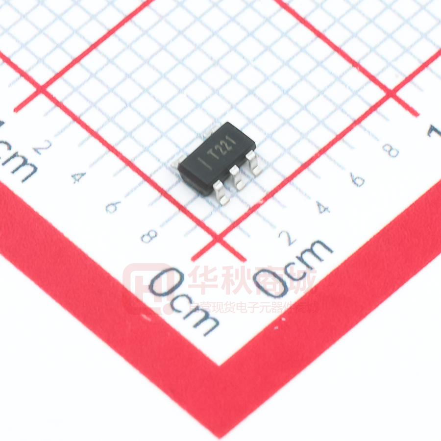

SP6203 / SP6205 300mA/500mA Low Noise CMOS LDO Regulators May 17, 2021 Rev. 2.0.2 GENERAL DESCRIPTION APPLICATIONS • Battery-Powered Systems The SP6203 and SP6205 are ultra low noise CMOS LDOs with very low dropout and ground current. The noise performance is achieved by means of an external bypass capacitor without sacrificing turn-on and turn-off speed critical to portable applications. Extremely stable and easy to use, these devices offer excellent PSRR and Line/Load regulation. Target applications include battery-powered equipment such as portable and wireless products. Regulators' ground current increases only slightly in dropout. Fast turn-on/turn-off enable control and an internal 30Ω pull down on output allows quick discharge of output even under no load conditions. Both LDOs are protected with current limit and thermal shutdown. • Medical Equipments • MP3/CD Players • Digital Cameras FEATURES • 300mA/500mA Output Current − SP6203: 300mA – SP6205: 500mA − Low Dropout Voltage: 0.6Ω PMOS FET • 2.7V to 5.5V Input Voltage − Fixed and Adjustable Output Voltage − Accurate Output Voltage: 2% over Temp. • 67dB Power Supply Rejection Ratio The SP6205 is available in fixed & adjustable output voltage versions and come in an industry standard 5-pin SOT-23 and small 2X3mm 8-pin DFN packages. For SC-70 100mA CMOS LDO, SP6213 is available. • 12μVRMS Low Output Noise • Unconditionally Stable with 2.2μF Ceramic • Low Quiescent Current: 45μA • Low Ground Current: 350μA at 500mA • Fast Turn-On and Turn-Off: 60μS • Very Good Load/Line Regulation: 0.07/0.04 % • Current Limit and Thermal Protection • RoHS Compliant “Green”/Halogen Free 5-Pin SOT23 and 8-Pin DFN Packages TYPICAL APPLICATION DIAGRAM Fig. 1: SP6203/SP6205 Application Diagram 1 SP6203 / SP6205 300mA/500mA Low Noise CMOS LDO Regulators ABSOLUTE MAXIMUM RATINGS OPERATING RATINGS These are stress ratings only and functional operation of the device at these ratings or any other above those indicated in the operation sections of the specifications below is not implied. Exposure to absolute maximum rating conditions for extended periods of time may affect reliability. Input Voltage Range VIN .......................... +2.7V to +5.5V Enable Input Voltage VEN................... ...............0 to 5.5V Junction Temperature Range ................. -40°C to +125°C Thermal Resistance ...................................................... SOT-23-5 (θJA) .............................................191°C/W DFN-8 (θJA) ................................................... 59°C/W VIN .............................................................. -2V to 6.0V Output Voltage VOUT .............................. -0.6V to VIN +1V Enable Input Voltage VEN................ .. ...............-2V to 6V Storage Temperature .............................. -65°C to 150°C Power Dissipation ............................... Internally Limited1 Lead Temperature (Soldering, 5 sec) ................... +260°C Junction Temperature ........................................ +150°C Note 1: Maximum power dissipation can be calculated using the formula: PD = (TJ (max) - TA) / θJA, where TJ(max) is the junction temperature, TA is the ambient temperature and θJA is the junction-to-ambient thermal resistance. θJC is 6°C/W for this package. Exceeding the maximum allowable power dissipation will result in excessive die temperature and the regulator will go into thermal shutdown mode. ELECTRICAL SPECIFICATIONS Specifications with standard type are for an Operating Junction Temperature of TJ = 25°C only; limits applying over the full Operating Junction Temperature range are denoted by a “•”. Minimum and Maximum limits are guaranteed through test, design, or statistical correlation. Typical values represent the most likely parametric norm at TJ = 25°C, and are provided for reference purposes only. Unless otherwise indicated, VIN = (VOUT + 0.5V) to 6V, CIN = 2.2µF, COUT = 2.2µF and IOUT = 100µA, TJ= –40°C to 85°C. Parameter Min. Typ. Input Voltage Output Voltage -2 Output Voltage Temperature Coefficient2 Reference Voltage 1.225 Load Regulation 3 Dropout Voltage for VOUT ≥ 3.0V4 V • Ground Pin Current5 Shutdown Supply Current 0.33 0.55 Conditions +2 % • Variation from specified VOUT ∆ VOUT/∆T ppm/°C • 1.25 1.275 V 0.04 0.3 %/V 0.07 0.13 0.06 60 120 180 300 0.3 0.5 % IOUT = 0.1mA to 300mA (SP6203) IOUT = 0.1mA to 500mA (SP6205) mV IOUT IOUT IOUT IOUT IOUT = = = = = 0.1mA 100mA 200mA 300mA (SP6203) 500mA (SP6205) • • IOUT IOUT IOUT IOUT IOUT = = = = = 0.1mA (IQUIESCENT) 100mA 200mA 300mA (SP6203) 500mA (SP6205) • VEN < 0.4V (shutdown) 45 110 175 235 350 Thermal Shutdown Junction Temperature Units 6 50 Line Regulation Current Limit Max. 300 500 330 490 0.01 1 0.50 0.85 0.8 1.4 170 ∆VOUT (VIN below 6V) • • • 100 µA µA A Adjustable version only VOUT = 0V (SP6203) VOUT = 0V (SP6205) °C Regulator Turns off Thermal Shutdown Hysteresis 12 °C Regulator turns on again at 158°C Power Supply Rejection Ratio 67 dB f ≤ 1kHz Output Noise Voltage 6 Thermal Regulation7 Wake-Up Time (TWU)8 (from shutdown mode) 210DSR00 150 630 12 50 %/W ∆VOUT / ∆PD 75 0.05 25 µVRMS CBYP CBYP CBYP CBYP 50 2 µS = = = = 0nF, IOUT = 0.1mA 0nF, IOUT = 300mA 10nF, IOUT = 0.1mA 10nF, IOUT = 300mA VIN ≥ 4V10 IOUT = 30mA Rev. 2.0.2 SP6203 / SP6205 300mA/500mA Low Noise CMOS LDO Regulators Parameter Min. Turn-On Time (TON)9 (from shutdown mode) Turn-Off Time (TOFF) Output Discharge Resistance Max. Units Conditions 60 120 µS VIN ≥ 4V10 IOUT = 30mA 100 15 250 25 µS IOUT = 0.1mA, VIN ≥ 4V10 IOUT = 300mA, VIN ≥ 4V10 30 Enable Input Logic Low Voltage Enable Input Logic High Voltage Typ. Ω 0.4 1.6 No Load V • Regulator Shutdown V • Regulator Enabled Note 2: Output voltage temperature coefficient is defined as the worst case voltage change divided by the total temperature range. Note 3: Regulation is measured at constant junction temperature using low duty cycle pulse testing. Changes in output voltage due to heating effects are covered by the thermal regulation specification. Note 4: Dropout-voltage is defined as the input to output differential at which the output voltage drops 2% below its nominal value measured at 1V differential. Note 5: Ground pin current is the regulator quiescent current. The total current drawn from the supply is the sum of the load current plus the ground pin current. Note 6: Output noise voltage is defined within a certain bandwidth, namely 10Hz < BW < 100kHz. An external bypass cap (10nF) from reference output (BYP pin) to ground significantly reduces noise at output. Note 7: Thermal regulation is defined as the change in output voltage at a time “t” after a change in power dissipation is applied, excluding load and line regulation effects. Specifications are for a 300mA load pulse at VIN = 6V for t = 1ms. Note 8: The wake-up time (TWU) is defined as the time it takes for the output to start rising after enable is brought high. Note 9: The total turn-on time is called the settling time (TS), which is defined as the condition when both the output and the bypass node are within 2% of their fully enabled values when released from shutdown. Note 10: For output voltage versions requiring VIN to be lower than 4V, timing (TON & TOFF) increases slightly. BLOCK DIAGRAM Fig. 2: SP6203/SP6205 Functional Diagram 210DSR00 3 Rev. 2.0.2 SP6203 / SP6205 300mA/500mA Low Noise CMOS LDO Regulators PIN ASSIGNMENT 5-Pin SOT23 8-Pin DFN Fig. 3: SP6203/SP6205 Pin Assignment PIN DESCRIPTION Name SOT-23-5 VIN 1 Power Supply Input GND 2 Ground Terminal EN 3 Enable/Shutdown - Logic high = enable - Logic low = shutdown BYP/ADJ 4 VOUT 5 Name DFN-8 Description Bypass - Fixed voltage option: Reference bypass input for ultra-quiet operation. Connecting a 10nF cap on this pin reduces output noise. Adjustable Input – Adjustable voltage option: Adjustable regulator feedback input. Connect to a resistive voltageDivider network. Regulator Output Voltage Description ADJ 1 Adjustable Input – Adjustable voltage option: Adjustable regulator feedback input. Connect to a resistive voltageDivider network. NC 2 No Connect GND 3 Ground Terminal EN 4 Enable/Shutdown - Logic high = enable - Logic low = shutdown VIN 5 Power Supply Input NC 6 No Connect NC 7 No Connect VOUT 8 Regulator Output Voltage 210DSR00 4 Rev. 2.0.2 SP6203 / SP6205 300mA/500mA Low Noise CMOS LDO Regulators ORDERING INFORMATION Part Number Ambient Temperature Range Lead-Free Package Packing Method Voltage Option SP6203EM5-L-2-8/TR 2.8V SP6205EM5-L/TR SP6205EM5-L-3-0/TR -40°C≤TA≤+125°C Yes SOT-23-5 ADJ Tape & Reel SP6205EM5-L-3-3/TR 3.0V 3.3V SP6205ER-L/TR DFN8 ADJ NOTE: For the most up-to-date ordering information and additional information on environment rating, go to www.maxlinear.com/SP6203 and www.maxlinear.com/SP6205. 210DSR00 5 Rev. 2.0.2 SP6203 / SP6205 300mA/500mA Low Noise CMOS LDO Regulators TYPICAL PERFORMANCE CHARACTERISTICS All data taken at VIN = 2.7V to 5.5V, TJ = TA = 25°C, unless otherwise specified - Schematic and BOM from Application Information section of this datasheet. Fig. 4: Current Limit Fig. 5: Turn-On Time, RLOAD=50Ω (60mA) Fig. 6: Turn-Off Time, RLOAD=6Ω (500mA) Fig. 7: Turn-Off Time, RLOAD=30KΩ (0.1mA) Fig. 8: Load Regulation, IO=100µA ~500mA Fig. 9: Regulation, Line Step from 4V to 6V, IO=1mA 210DSR00 6 Rev. 2.0.2 SP6203 / SP6205 300mA/500mA Low Noise CMOS LDO Regulators Fig. 10: Start Up Waveform, VIN=3.5V, IO=500mA Fig. 11: Start Up Waveform, Slow VIN , No Load Fig. 12: Start Up Waveform, Slow VIN, 500mA Output Load Fig. 13: Start Up Waveform, Slow VIN, COUT=1000μF, IO=0mA Fig. 14: Start Up Waveform, Slow VIN, COUT=1000μF, IO=500mA Fig. 15: Fast VIN, No Load 210DSR00 7 Rev. 2.0.2 SP6203 / SP6205 300mA/500mA Low Noise CMOS LDO Regulators Fig. 17: Fast VIN = 1000μF Output Load Fig. 16: Fast VIN, 500mA Output Load Fig. 18: Fast VIN , COUT=1000μF, IO=500mA Fig. 19: Output Noise, CBYP = 10nF 210DSR00 Fig. 20: Output Noise, CBYP = open 8 Rev. 2.0.2 SP6203 / SP6205 300mA/500mA Low Noise CMOS LDO Regulators THEORY OF OPERATION or tantalum capacitor may be used at the input. GENERAL OVERVIEW OUTPUT CAPACITOR The SP6203/6205 is intended for applications where very low dropout voltage, low supply current and low output noise are critical, even with high load conditions (500mA maximum). Unlike bipolar regulators, the SP6203/6205 (CMOS LDO) supply current increases only slightly with load current. An output capacitor is required between VOUT and GND to prevent oscillation. A 2.2μF output capacitor is recommended. Larger values make the chip more stable which means an improvement of the regulator’s transient response. Also, when operating from other sources than batteries, supply-noise rejection can be improved by increasing the value of the input and output capacitors and using passive filtering techniques. The SP6203/6205 contains an internal bandgap reference which is fed into the inverting input of the LDO-amplifier. The output voltage is then set by means of a resistor divider and compared to the bandgap reference voltage. The error LDO-amplifier drives the gate of a P-channel MOSFET pass device that has a RDS(ON) of 0.6Ω at 500mA producing a 300mV drop at the output. For a lower output current, a smaller output capacitance can be chosen. Finally, the output capacitor should have an effective series resistance (ESR) of 0.5Ω or less. Furthermore, the SP6203/6205 has its own current limit circuitry (500mA/850mA) to ensure that the output current will not damage the device during output short, overload or start-up. Therefore, the use of good quality ceramic or tantalum capacitors is advised. BYPASS CAPACITOR Also, the SP6203/6205 includes thermal shut-down circuitry to turn off the device when the junction temperature exceeds 170°C and it re-mains off until the temperature drops by 12°C. A bypass pin (BYP) is provided to decouple the bandgap reference. A 10nF external capacitor connected from BYP to GND reduces noise present on the internal reference, which in turn significantly reduces output noise and also improves power supply rejection. Note that the minimum value of COUT must be increased to maintain stability when the bypass capacitor is used because CBYP reduces the regulator phase margin. If output noise is not a concern, this input may be left unconnected. Larger capacitor values may be used to further improve power supply rejection, but result in a longer time period (slower turn on) to settle output voltage when power is initially applied. ENABLE/SHUTDOWN OPERATION The SP6203/6205 is turned off by pulling the VEN pin below 0.4V and turned on by pulling it above 1.6V. If this enable/shutdown feature is not required, it should be tied directly to the input supply voltage to keep the regulator output on at all time. While in shutdown, VOUT quickly falls to zero (turn-off time is dependent on load conditions and output capacitance on VOUT) and power consumption drops nearly to zero. NO LOAD STABILITY The SP6203/6205 will remain stable and in regulation with no external load (other than the internal voltage driver) unlike many other voltage regulators. This is especially important in CMOS RAM battery back-up applications. INPUT CAPACITOR A small capacitor of 2.2μF is required from VIN to GND if a battery is used as the power source. Any good quality electrolytic, ceramic 210DSR00 9 Rev. 2.0.2 SP6203 / SP6205 300mA/500mA Low Noise CMOS LDO Regulators TURN ON TIME TJ(max) is the maximum junction temperature of the die and is 125°C. TA is the ambient temperature. θJA is the junction-to-ambient thermal resistance for the regulator and is layout dependent. The SOT-23-5 package has a θJA of approximately 191°C/W for minimum PCB copper footprint area. The turn on response is split up in two separate response categories: the wake up time (TWU) and the settling time (TS). The wake up time is defined as the time it takes for the output to rise to 2% of its total value after being released from shutdown (EN > 0.4V). The settling time is defined as the condition where the output reaches 98% of its total value after being released from shutdown. The latter is also called the turn on time and is dependent on the output capacitor, a little bit on load and, if present, on a bypass capacitor. This results in a maximum power dissipation of: PD(max)=[(125°C-25°C)/(191°C/W)] = 523mW The actual power dissipation of the regulator circuit can be determined using one simple equation: PD = (VIN - VOUT) * IOUT + VIN * IGND To prevent the device from entering thermal shutdown, maximum power dissipation cannot be exceeded. Substituting PD(max) for PD and solving for the operating conditions that are critical to the application will give the maximum operating conditions for the regulator circuit. For example, if we are operating the SP6203 3.0V at room temperature, with a minimum footprint layout and output current of 300mA, the maximum input voltage can be determined, based on the equation below. Ground pin current can be taken from the electrical specifications table (0.23mA at 300mA). TURN OFF TIME The turn off time is defined as the condition where the output voltage drops about 66% (θ) of its total value. 5θ to 7θ is the constant where the output voltage drops nearly to zero. There will always be a small voltage drop in shutdown because of the switch unless we short-circuit it. The turn off time of the output voltage is dependent on load conditions, output capacitance on VOUT (time constant τ = RLCL) and also on the difference in voltage between input and output. 390mW = (VIN-3.0V) * 300mA + VIN * 0.23mA After calculations, we find that the maximum input voltage of a 3.0V application at 300mA of output current in a SOT-23-5 package is 4.7V. So if the intent is to operate a 5V output version from a 6V supply at 300mA load and at a 25°C ambient temperature, then the actual total power dissipation will be: THERMAL CONSIDERATIONS The SP6203/6205 is designed to provide 300/500mA of continuous current in a tiny package. Maximum power dissipation can be calculated based on the output current and the voltage drop across the part. To determine the maximum power dissipation of the package, use the junction-to-ambient thermal resistance of the device and the following basic equation: PD=([6V-5V]*[300mA])+(6V*0.23mA)=301.4mW This is well below the 523mW package maximum. Therefore, the regulator can be used. Note that the regulator cannot always be used at its maximum current rating. For example, in a 5V input to 3.0V output application at an ambient temperature of 25°C and operating at the full 500mA (IGND=0.355mA) load, the PD = (TJ(max) - TA) / θJA 210DSR00 10 Rev. 2.0.2 SP6203 / SP6205 300mA/500mA Low Noise CMOS LDO Regulators LAYOUT CONSIDERATIONS regulator is limited to a much lower load current, determined by the following equation: The primary path of heat conduction out of the package is via the package leads. Therefore, careful considerations have to be taken into account: 523mW = ( [5V-3V]*[ Iload(max)]) +(5V*0.350mA) After calculation, we find that in such an application (SP6205) the regulator is limited to 260.6mA. Doing the same calculations for the 300mA LDO (SP6203) will limit the regulator’s output current to 260.9mA. 1) Attaching the part to a larger copper footprint will enable better heat transfer from the device, especially on PCB’s where there are internal ground and power planes. 2) Place the input, output and bypass capacitors close to the device for optimal transient response and device behavior. Also, taking advantage of the very low dropout voltage characteristics of the SP6203/6205, power dissipation can be reduced by using the lowest possible input voltage to minimize the input-to-output drop. 3) Connect all ground connections directly to the ground plane. In case there’s no ground plane, connect to a common local ground point before connecting to board ground. ADJUSTABLE REGULATOR APPLICATIONS The SP6203/6205 can be adjusted to a specific output voltage by using two external resistors (see functional diagram). The resistors set the output voltage based on the following equation: Such layouts will provide a much better thermal conductivity (lower θJA) for, a higher maximum allowable power dissipation limit. VOUT = VREF * (R1/R2 + 1) Resistor values are not critical because ADJ (adjust) has a high input impedance, but for best performance use resistors of 470KΩ or less. DUAL-SUPPLY OPERATION When used in dual supply systems where the regulator load is returned to a negative supply, the output voltage must be diode clamped to ground. 210DSR00 11 Rev. 2.0.2 SP6203 / SP6205 300mA/500mA Low Noise CMOS LDO Regulators MECHANICAL DIMENSIONS 8-PIN DFN 2X3 210DSR00 12 Rev. 2.0.2 SP6203 / SP6205 300mA/500mA Low Noise CMOS LDO Regulators RECOMMENDED LAND PATTERN AND STENCIL 8-PIN DFN 2X3 210DSR00 13 Rev. 2.0.2 SP6203 / SP6205 300mA/500mA Low Noise CMOS LDO Regulators MECHANICAL DIMENSIONS 5-PIN SOT-23 210DSR00 14 Rev. 2.0.2 SP6203 / SP6205 300mA/500mA Low Noise CMOS LDO Regulators REVISION HISTORY Date Revision Description April 3, 2012 2.0.0 Reformatted Data Sheet Includes top package marking update. August 31, 2018 2.0.1 Updated to MaxLinear logo. Updated format and Ordering Information. Updated Adjustable Regulator Applications section. Removed obsolete Fixed Voltage DFN option. Corrected output noise voltage conditions in Electrical Specifications. May 17, 2021 2.0.2 Replaced low quiescent current value with 45μA in the Features section. Corporate Headquarters: 5966 La Place Court Suite 100 Carlsbad, CA 92008 Tel.: +1 (760) 692-0711 Fax: +1 (760) 444-8598 www.maxlinear.com The content of this document is furnished for informational use only, is subject to change without notice, and should not be construed as a commitment by MaxLinear, Inc. MaxLinear, Inc. assumes no responsibility or liability for any errors or inaccuracies that may appear in the informational content contained in this guide. Complying with all applicable copyright laws is the responsibility of the user. Without limiting the rights under copyright, no part of this document may be reproduced into, stored in, or introduced into a retrieval system, or transmitted in any form or by any means (electronic, mechanical, photocopying, recording, or otherwise), or for any purpose, without the express written permission of MaxLinear, Inc. MaxLinear, Inc. does not recommend the use of any of its products in life support applications where the failure or malfunction of the product can reasonably be expected to cause failure of the life support system or to significantly affect its safety or effectiveness. Products are not authorized for use in such applications unless MaxLinear, Inc. receives, in writing, assurances to its satisfaction that: (a) the risk of injury or damage has been minimized; (b) the user assumes all such risks; (c) potential liability of MaxLinear, Inc. is adequately protected under the circumstances. MaxLinear, Inc. may have patents, patent applications, trademarks, copyrights, or other intellectual property rights covering subject matter in this document. Except as expressly provided in any written license agreement from MaxLinear, Inc., the furnishing of this document does not give you any license to these patents, trademarks, copyrights, or other intellectual property. MaxLinear, the MaxLinear logo, any MaxLinear trademarks (MxL, Full-Spectrum Capture, FSC, G.now, AirPHY, Puma, and AnyWAN), and the MaxLinear logo on the products sold are all property of MaxLinear, Inc. or one of MaxLinear’s subsidiaries in the U.S.A. and other countries. All rights reserved. Other company trademarks and product names appearing herein are the property of their respective owners. © 2021 MaxLinear, Inc. All rights reserved. 210DSR00 15 Rev. 2.0.2

物料型号:MAXLINEAR SP6203/SP6205
器件简介:SP6203和SP6205是超低噪声CMOS低压差线性稳压器(LDO),具有非常低的 dropout 电压和地电流。
这些设备通过外部旁路电容实现噪声性能,同时不牺牲对便携应用至关重要的开机和关机速度。
它们非常稳定且易于使用,提供出色的电源抑制比(PSRR)和线性/负载调节。
目标应用包括电池供电设备,如便携式和无线产品。
引脚分配: - SP6203:5引脚SOT-23封装,包括电源输入VIN、地GND、使能/关闭EN、旁路/调整BYP/ADJ和调节输出电压VoUT。
- SP6205:8引脚DFN封装,包括可调节输入ADJ、无连接NC、地GND、使能/关闭EN、电源输入VIN、无连接NC、无连接NC和调节输出电压VoUT。
参数特性: - 输出电流:SP6203为300mA,SP6205为500mA。
- 输入电压范围:2.7V至5.5V。
- 固定和可调输出电压选项。
- 电源抑制比:67dB。
- 输出噪声:12μVRMS。
- 低静态电流:45μA。
- 低地电流:350μA(在500mA时)。
- 快速开机和关机:60μS。
- 良好的负载/线性调节:0.07/0.04%。
- 过流保护和热保护。
- 符合RoHS标准的“绿色”/无卤素封装。
功能详解: - 设备在掉电时地电流仅轻微增加。
- 快速的开机/关机能力允许在无负载条件下迅速放电。
- 内部30Ω下拉电阻有助于快速放电。
- 具有过流保护和热关机保护。
应用信息: - 电池供电系统。
- 医疗设备。
- MP3/CD播放器。
- 数码相机。
封装信息: - SP6203:5引脚SOT-23封装。
- SP6205:8引脚DFN封装,符合行业标准。
