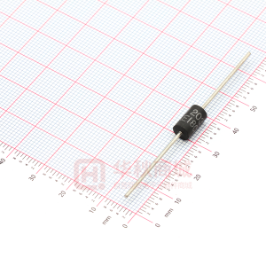

ELECTRONIC 1.5KE6.8(C)-LF THRU 1.5KE540(C)A-LF 1500W TRANSIENT VOLTAGE SUPPRESSOR FEATURES PLASTIC PACKAGE HAS UNDERWRITERS LABORATORY FLAMMABILITY CLASSIFICATION 94V-0 1500W SURGE CAPABILITY AT 1ms EXCELLENT CLAMPING CAPABILITY LOW ZENER IMPEDANCE FAST RESPONSE TIME:TYPICALLY LESS THAN 1.0 PS FROM 0 VOLTS TO BV MIN TYPICAL IR LESS THAN 1μA ABOVE 10V HIGH TEMPERATURE SOLDERING GUARANTEED:260℃/10S /.375〞(9.5mm) LEAD LENGTH/5LBS., (2.3KG) TENSION LEAD FREE 1.0(25.4) MIN .042(1.07) .037(0.94) .375(9.5) .335(8.5) .220(5.6) .197(5.0) MECHANICAL DATA CASE:MOLDED PLASTIC TERMINALS︰AXIAL LEADS, SOLDERABLE PER MIL-STD-202, METHOD 208 POLARITY:COLOR BAND DENOTED CATHODE EXCEPT BIPOLAR WEIGHT:1.2 GRAMS MAXIMUM RATINGS AND ELECTRICAL CHARACTERISTICS RATINGS AT 25°C AMBIENT TEMPERATURE UNLESS OTHERWISE SPECIFIED RATINGS PEAK POWER DISSIPATION AT TA=25℃, TP=1ms(NOTE1) PEAK PULSE CURRENT WITH A 10/1000us WAVEFORM(NOTE 1) STEADY STATE POWER DISSIPATION AT TL=75℃, LEAD LENGTHS 0.375” (9.5mm) (NOTE2) PEAK FORWARD SURGE CURRENT, 8.3ms SINGLE HALF SINE-WAVE SUPERIMPOSED ON RATED LOAD (JEDEC METHOD) (NOTE 3) TYPICAL THERMAL RESISTANCE JUNCTUION-TO-AMBIENT OPERATING AND STORAGE TEMPERATURE RANGE NOTE︰ SYMBOL PPK IPPM PM(AV) IFSM 1.0(25.4) MIN CASE:DO-201AE DIMENSIONS IN INCHES AND (MILLIMETERS) VALUE MINIMUM 1500 SEE NEXT TABLE 6.5 200 UNITS WATTS A WATTS Amps ℃/W ℃ RθJA 75 - 55 TO + 175 TJ,TSTG 1. NON-REPETITIVE CURRENT PULSE, PER FIG.3 AND DERATED ABOVE TA=25℃PER FIG 2. 2. MOUNTED ON COPPER PAD AREA OF 1.6×1.6” (40×40mm) PER FIG. 5 3. 8.3ms SINGLE HALF SINE-WAVE, DUTY CYCLE=4 PULSES PER MINUTES MAXIMUM 4. FOR BIDIRECTIONAL USE C SUFFIX FOR 10﹪TOLERANCE, CA SUFFIX FOR 5﹪TOLERANCE http:// www.sirectsemi.com BREAKDOWN VBR (VOLTS) JEDEC TYPE NUMBER GENERAL PART NUMBER @IT (mA) MIN MAX WORKING PEAK REVERSE VOLTAGE VRWM(VOLTS) 5.50 5.80 6.05 6.40 6.63 7.02 7.37 7.78 8.10 8.55 8.92 9.40 9.72 10.2 10.5 11.1 12.1 12.8 12.9 13.6 14.5 15.3 16.2 17.1 17.8 18.8 19.4 20.5 21.8 23.1 24.3 25.6 26.8 28.2 29.1 30.8 31.6 33.3 34.8 36.8 36.1 40.2 41.3 43.6 45.4 47.8 50.2 53.0 55.1 58.1 60.7 64.1 66.4 70.1 MAXIMUM REVERSE LEAKAGE AT VRWM IR(μA) 1000 1000 500 500 200 200 50 50 10 10 5.0 5.0 5.0 5.0 5.0 5.0 5.0 5.0 5.0 5.0 5.0 5.0 5.0 5.0 5.0 5.0 5.0 5.0 5.0 5.0 5.0 5.0 5.0 5.0 5.0 5.0 5.0 5.0 5.0 5.0 5.0 5.0 5.0 5.0 5.0 5.0 5.0 5.0 5.0 5.0 5.0 5.0 5.0 5.0 MAXIMUM REVERSE SURGE CURRENT IRSM(AMPS) 139 143 128 132 120 124 109 112 100 103 93.0 96.0 87.0 90.0 79.0 82.0 68.0 71.0 64.0 67.0 56.5 59.5 51.5 54.0 47.0 49.0 43.0 45.0 38.5 40.0 34.5 36.0 31.5 33.0 29.0 30.0 26.5 28.0 24.0 25.3 22.2 23.2 20.4 21.4 18.6 19.5 16.9 17.7 15.3 16.3 13.9 14.6 12.7 13.3 MAX CLAMPING VOLTAGE VRWM (VOLTS) 10.8 10.5 11.7 11.3 12.5 12.1 13.8 13.4 15.0 14.5 16.2 15.6 17.3 16.7 19.0 18.2 22.0 21.2 23.5 22.5 26.5 25.2 29.1 27.7 31.9 30.6 34.7 33.2 39.1 37.5 43.5 41.4 47.7 45.7 52.0 49.9 56.4 53.9 61.9 59.3 67.8 64.8 73.5 70.1 80.5 77.0 89.0 85.0 98.0 92.0 108.0 103.0 118.0 113.0 MAXIMUM TEMPERATURE COEFFICIENT OF VBR(%C) VRSM(VOLTS) 0.057 0.057 0.061 0.061 0.065 0.065 0.068 0.068 0.073 0.073 0.075 0.075 0.078 0.078 0.081 0.081 0.084 0.084 0.086 0.086 0.088 0.088 0.090 0.090 0.092 0.092 0.094 0.094 0.096 0.096 0.097 0.097 0.098 0.098 0.099 0.099 0.100 0.100 0.101 0.101 0.101 0.101 0.102 0.102 0.103 0.103 0.104 0.104 0.104 0.104 0.105 0.105 0.105 0.105 1N6267 1N6267A 1N6268 1N6268A 1N6269 1N6269A 1N6270 1N6270A 1N6271 1N6271A 1N6272 1N6272A 1N6273 1N6273A 1N6274 1N6274A 1N6275 1N6275A 1N6276 1N6276A 1N6277 1N6277A 1N6278 1N6278A 1N6279 1N6279A 1N6280 1N6280A 1N6281 1N6281A 1N6282 1N6282A 1N6283 1N6283A 1N6284 1N6284A 1N6285 1N6285A 1N6286 1N6286A 1N6287 1N6287A 1N6288 1N6288A 1N6289 1N6289A 1N6290 1N6290A 1N6291 1N6291A 1N6292 1N6292A 1N6293 1N6293A 1.5KE6.8(C)-LF 1.5KE6.8(C)A-LF 1.5KE7.5(C)-LF 1.5KE7.5(C)A-LF 1.5KE8.2(C)-LF 1.5KE8.2(C)A-LF 1.5KE9.1(C)-LF 1.5KE9.1(C)A-LF 1.5KE10(C)-LF 1.5KE10(C)A-LF 1.5KE11(C)-LF 1.5KE11(C)A-LF 1.5KE12(C)-LF 1.5KE12(C)A-LF 1.5KE13(C)-LF 1.5KE13(C)A-LF 1.5KE15(C)-LF 1.5KE15(C)A-LF 1.5KE16(C)-LF 1.5KE16(C)A-LF 1.5KE18(C)-LF 1.5KE18(C)A-LF 1.5KE20(C)-LF 1.5KE20(C)A-LF 1.5KE22(C)-LF 1.5KE22(C)A-LF 1.5KE24(C)-LF 1.5KE24(C)A-LF 1.5KE27(C)-LF 1.5KE27(C)A-LF 1.5KE30(C)-LF 1.5KE30(C)A-LF 1.5KE33(C)-LF 1.5KE33(C)A-LF 1.5KE36(C)-LF 1.5KE36(C)A-LF 1.5KE39(C)-LF 1.5KE39(C)A-LF 1.5KE43(C)-LF 1.5KE43(C)A-LF 1.5KE47(C)-LF 1.5KE47(C)A-LF 1.5KE51(C)-LF 1.5KE51(C)A-LF 1.5KE56(C)-LF 1.5KE56(C)A-LF 1.5KE62(C)-LF 1.5KE62(C)A-LF 1.5KE68(C)-LF 1.5KE68(C)A-LF 1.5KE75(C) -LF 1.5KE75(CA-LF 1.5KE82(C)-LF 1.5KE82(C)A-LF 6.12 6.45 6.75 7.13 7.38 7.79 8.19 8.65 9.00 9.50 9.90 10.5 10.8 11.4 11.7 12.4 13.5 14.3 14.4 15.2 16.2 17.1 18.0 19.0 19.8 20.9 21.6 22.8 24.3 25.7 27.0 28.5 29.7 31.4 32.4 34.2 35.1 37.1 38.7 40.9 42.3 44.7 45.9 48.5 50.4 53.2 55.8 58.9 61.2 64.6 67.5 71.3 73.8 77.9 7.48 7.14 8.25 7.88 9.02 8.61 10.0 9.55 11.0 10.5 12.1 11.6 13.2 12.6 14.3 13.7 16.5 15.8 17.6 16.8 19.8 18.9 22.0 21.0 24.2 23.1 26.4 25.2 29.7 28.4 33.0 31.5 36.3 34.7 39.6 37.8 42.9 41.0 47.3 45.2 51.7 49.4 56.1 53.6 61.8 58.8 68.2 65.1 74.8 71.4 82.5 78.8 90.2 86.1 10 10 10 10 10 10 1.0 1.0 1.0 1.0 1.0 1.0 1.0 1.0 1.0 1.0 1.0 1.0 1.0 1.0 1.0 1.0 1.0 1.0 1.0 1.0 1.0 1.0 1.0 1.0 1.0 1.0 1.0 1.0 1.0 1.0 1.0 1.0 1.0 1.0 1.0 1.0 1.0 1.0 1.0 1.0 1.0 1.0 1.0 1.0 1.0 1.0 1.0 1.0 http:// www.sirectsemi.com DEVICE GENERAL PART NUMBER 1.5KE91(C)-LF 1.5KE91(C)A-LF 1.5KE100(C)-LF 1.5KE100(C)A-LF 1.5KE110(C)-LF 1.5KE110(C)A-LF 1.5KE120(C)-LF 1.5KE120(C)A-LF 1.5KE130(C)-LF 1.5KE130(C)A-LF 1.5KE150(C)-LF 1.5KE150(C)A-LF 1.5KE160(C)-LF 1.5KE160(C)A-LF 1.5KE170(C)-LF 1.5KE170(C)A-LF 1.5KE180(C)-LF 1.5KE180(C)A-LF 1.5KE200(C)-LF 1.5KE200(C)A-LF 1.5KE220(C)-LF 1.5KE220(C)A-LF 1.5KE250(C)-LF 1.5KE250(C)A-LF 1.5KE300(C)-LF 1.5KE300(C)A-LF 1.5KE350(C)-LF 1.5KE350(C)A-LF 1.5KE400(C)-LF 1.5KE400(C)A-LF 1.5KE440(C)-LF 1.5KE440(C)A-LF 1.5KE480(C)-LF 1.5KE480(C)A-LF 1.5KE510(C)-LF 1.5KE510(C)A-LF 1.5KE540(C)-LF 1.5KE540(C)A-LF BREAKDOWN VBR(VOLTS) @IT (mA) MIN 81.9 86.5 90.0 95.0 99.0 106.0 108.0 114.0 117.0 124.0 136.0 143.0 144.0 152.0 153.0 162.0 162.0 171.0 180.0 190.0 196.0 209.0 225.0 237.0 270.0 285.0 315.0 333.0 360.0 380.0 396.0 418.0 432.0 456.0 459.0 485.0 486.0 513.0 MAX 100.0 95.50 110.0 105.0 121.0 116.0 132.0 126.0 143.0 137.0 165.0 158.0 176.0 168.0 187.0 179.0 198.0 189.0 220.0 210.0 242.0 231.0 275.0 263.0 330.0 315.0 385.0 368.0 440.0 420.0 484.0 462.0 528.0 504.0 561.0 535.0 594.0 567.0 1.0 1.0 1.0 1.0 1.0 1.0 1.0 1.0 1.0 1.0 1.0 1.0 1.0 1.0 1.0 1.0 1.0 1.0 1.0 1.0 1.0 1.0 1.0 1.0 1.0 1.0 1.0 1.0 1.0 1.0 1.0 1.0 1.0 1.0 1.0 1.0 1.0 1.0 WORKING PEAK REVERSE VOLTAGE VRWM(VOLTS) 73.7 77.8 81.0 85.5 89.2 94.0 97.2 102.0 106.0 111.0 121.0 128.0 130.0 136.0 138.0 145.0 146.0 154.0 162.0 171.0 175.0 185.0 202.0 214.0 243.0 256.0 284.0 300.0 324.0 342.0 356.0 376.0 389.0 408.0 413.0 434.0 437.0 459.0 MAXIMUM REVERSE LEAKAGE AT VRWM IR(μA) 5.0 5.0 5.0 5.0 5.0 5.0 5.0 5.0 5.0 5.0 5.0 5.0 5.0 5.0 5.0 5.0 5.0 5.0 5.0 5.0 5.0 5.0 5.0 5.0 5.0 5.0 5.0 5.0 5.0 5.0 5.0 5.0 5.0 5.0 5.0 5.0 5.0 5.0 MAXIMUM REVERSE CURRENT IRSM (AMPS) 11.4 12.0 10.4 11.0 9.5 9.9 8.7 9.1 8.0 8.4 7.0 7.2 6.5 6.8 6.2 6.4 5.8 6.1 5.2 5.5 4.4 4.6 4.2 4.4 3.5 3.6 3.0 3.1 2.6 2.7 2.4 2.5 2.19 2.28 2.06 2.15 1.94 2.03 MAX CLAMPING VOLTAGE VRWM (VOLTS) 131.8 125.0 144.0 137.0 158.0 152.0 173.0 165.0 187.0 179.0 215.0 207.0 230.0 219.0 244.0 234.0 258.0 246.0 287.0 274.0 344.0 328.0 360.0 344.0 430.0 414.0 504.0 482.0 574.0 548.0 631.0 602.0 686.0 658.0 729.0 698.0 772.0 740.0 MAXIMUM TEMPERATURE COEFFICIENT OF VBR(%C) VRSM(VOLTS) 0.106 0.106 0.106 0.106 0.107 0.107 0.107 0.107 0.107 0.107 0.108 0.108 0.108 0.108 0.108 0.108 0.108 0.108 0.108 0.108 0.108 0.108 0.110 0.110 0.110 0.110 0.110 0.110 0.110 0.110 0.110 0.110 0.110 0.110 0.110 0.110 0.110 0.110 1N6294 1N6294A 1N6295 1N6295A 1N6296 1N6296A 1N6297 1N6297A 1N6298 1N6298A 1N6299 1N6299A 1N6300 1N6300A 1N6301 1N6301A 1N6302 1N6302A 1N6303 1N6303A NOTES: 1. VBR MEASURED AFTER IT APPLIED FOR 300 μS,IT=SQUARE WAVE PULSE OR EQUIVALENT 2. SURGE CURRENT WAVEFORM PER FIGURE 3 AND DERATED PER FIGURE 2. 3. VF=3.5V MAX, IF=100A (1.5KE6.8(C) THRU 1.5KE200(C)A) VF=6.5V MAX, IF=100A (1.5KE220(C) THRU 1.5KE540(C)A) PER 1/2 SQUARE OR EQUIVALENT SINE WAVE. PW=8.3ms, DUTY CYCLE=4 PULSES PER MINUTE MXIMUM 4. FOR BIPOLAR TYPES HAVING VRWM OF 10 VOLTS AND UNDER, THE IR LIMIT IS DOUBLED http:// www.sirectsemi.com RATINGS AND CHARACTERISTIC CURVES 1.5KE6.8(C)-LF THRU 1.5KE540(C)A-LF FIG. 1 - PEAK PULSE POWER RATING CURVE PEAK PULSE POWER (PPP) or CURRENT (IPP) DERATING IN PERCENTAGE,% PPPM, PEAK PULSE POWER,KW 100 NON-REPETITIVE PULSE WAVEFORM SHOWN in FIG. 3 TA=25℃ FIG. 2 - PULSE DERATING CURVE 100 10 75 50 1.0 25 0.1 0.1US 1.0US 10US 100US 1.0MS 10MS 0 0 25 50 75 100 125 150 175 200 Ta, AMBIENT TEMPERATURE,℃ td, PULSE WIDTH, sec FIG. 3 - PULSE WAVEFORM 150 IPPM, PEAK PULSE CURRENT, % CJ, CAPACITANCE , PF tr =10usec. PEAK VALUE IPPM PULSE WIDTH (td) is DEFINED as the POINT WHERE the PEAK CURRENT DECAYS to 50% of IPP FIG. 4 - TYPICAL JUNCTION CAPACITANCE 10,000 UNDIRECTIONAL BIDIRECTIONAL 100 1,000 VR=0 HALF VALUE Ipp 2 50 10/1000uSec. WAVEFORM as DEFINED by R.E.A. 100 F=1 MHZ Vsig=50mVp-p TJ=25℃ VR=RATED STAND-OFF VOLTAGE 10 0 0 td 5 1.0 2.0 t, TIME,ms 3.0 4.0 10 100 500 V(BR), BREAKDOWN VOLTAGE, VOLTS PM(AV), STEADY STATE POWER DISSIPATION, (W) FIG. 5 – STEADY STATE POWER DERATING CURVE 8.0 7.0 6.0 5.0 4.0 3.0 2.0 1.0 0 0 60Hz Resistive or Inductive Load PEAK FORWARD SURGE CURRENT, AMPERES FIG. 6 - MAXIMUM NON-REPETITIVE PEAK FORWARD SURGE CURRENT UNIDIRECTIONAL ONLY 200 100 L=0.375” (9.5mm) Lead Lengths 1.6×1.6×.040” (40×40×1mm) Copper Heat Sinks 9.3ms SINGLE HALF SINE-WAVE 8.3ms SINGLE HALF SINE-WAVE (JEDEC Method) (JEDEC Method) TJJ=Tjjmax. T =T max. 25 50 75 100 125 150 TL, LEAD TEMPERATURE (℃) 175 200 10 1 10 NUMBER OF CYCLES AT 60HZ 100 http:// www.sirectsemi.com RATINGS AND CHARACTERISTIC CURVES 1.5KE6.8(C)-LF THRU 1.5KE540(C)A-LF FIG. 7 - INCREMENTAL CLAMPING VOLTAGE CURVE UNIDIRECTIONAL 100 WAVEFORM: 10×1000 IMPULSE △VC=VC-V(BR) 1.5KE200-LF FIG. 8 - INCREMENTAL CLAMPING VOLTAGE CURVE UNIDIRECTIONAL 100 WAVEFORM: 10×1000 IMPULSE △VC=VC-V(BR) 1.5KE200-LF 1.5KE130-LF △VC, INCREMENTAL CLAMPING VOLTAGE 1.5KE130-LF △VC, INCREMENTAL CLAMPING VOLTAGE 20 1.5KE100-LF 20 10 1.5KE75-LF 10 1.5KE75-LF 1.5KE39-LF 1.5KE39-LF 2.0 1.5KE33-LF 2.0 1.5KE33-LF 1.0 1.0 1 5KE6 8-LF 1.5KE9.1-LF 1.5KE18-LF 1.5KE12-LF 1.5KE6.8-LF 1.5KE9.1-LF 0.2 0.1 0.5 1 2.0 10 20 50 0.2 0.1 0.5 1 2.0 10 20 50 IPP, PEAK PULSE CURRENT, AMPS IPP, PEAK PULSE CURRENT, AMPS FIG. 9 - INCREMENTAL CLAMPING VOLTAGE CURVE BIDIRECTIONAL 100 WAVEFORM: 10×1000 IMPULSE △VC=VC-V(BR) FIG. 10 - INCREMENTAL CLMPING VOLTAGE CURVE BIDIRECTIONAL 100 WAVEFORM: 10×1000 IMPULSE △VC=VC-V(BR) 1.5KE200C-LF △VC, INCREMENTAL CLAMPING VOLTAGE 20 1.5KE200C-LF △VC, INCREMENTAL CLAMPING VOLTAGE 20 1.5KE75C-LF 10 1.5KE75C-LF 10 1.5KE39C-LF 1.5KE30C-LF 1.5KE15C-LF 1.5KE39C-LF 2.0 1.5KE30C-LF 1.5KE15C-LF 1.5KE11C-L 1.5KE7.5C-LF 2.0 1.5KE11C-LF 1.0 1.5KE7.5C-LF 0.2 0.1 0.5 1 2.0 10 20 50 0.2 0.1 0.5 1 2.0 10 20 50 IPP, PEAK PULSE CURRENT, AMPS IPP, PEAK PULSE CURRENT, AMPS http:// www.sirectsemi.com RATINGS AND CHRACTERISTIC CURVES 1.5KE6.8(C)-LF THRU 1.5KE540(C)A-LF FIG. 11 - INSTANTANEOUS FORWARD VOLTAGE CHARACTERISTIS CURVE 100 ☉V - TEMPERATURE COEFFICIENT -mv/℃ 1,000 FIG. 12 - BREAKDOWN VOLTAGE TEMPERATURE COEFFICIENT CURVE 100 UNIDIRECTIONAL BIDIRECTIONAL 10 FORWARD CURRENT PULSE WIDTH=300US 1% DUTY CYCLE TJ=25℃ 10 1 1 5 10 20 50 100 200 500 V(BR), BREAKDOWN VOLTAGE, VOLTS UNIDIRECTIONAL (ONLY) 0.1 0 0.4 0.8 1.2 1.6 2.0 INSTANTANEOUS FORWARD CURRENT, AMPERES http:// www.sirectsemi.com
1.5KE20-LF
1. 物料型号: - 1.5KE6.8(C)-LF 至 1.5KE540(C)A-LF,这些型号是瞬态电压抑制二极管的型号,它们具有不同的工作电压和电流参数。
2. 器件简介: - 本文档描述的是瞬态电压抑制二极管(Transient Voltage Suppressor),它们用于保护电子设备免受电压突波的影响。这些二极管具有优异的钳位能力、低齐纳阻抗、快速响应时间等特点。
3. 引脚分配: - 这些器件采用DO-201AE封装,具有轴向引脚,引脚可焊性符合MIL-STD-202标准。
4. 参数特性: - 包括峰值功率耗散、峰值脉冲电流、稳态功率耗散、峰值正向浪涌电流、结到环境的典型热阻等参数。 - 例如,1.5KE6.8(C)-LF型号的最小峰值功率耗散为1500瓦特,工作峰值反向电压为6.12至7.48伏特。
5. 功能详解: - 这些二极管能够承受高达1500W的浪涌能力,在1ms内。它们还具有低齐纳阻抗和快速响应时间,典型值小于1.0皮秒。
6. 应用信息: - 适用于需要电压保护的应用场合,如电源、信号线路等。
7. 封装信息: - 器件采用塑料封装,具有UL94V-0的可燃性等级。引脚长度为1.375英寸(9.5mm),能够承受260°C/10秒的高温焊接。
