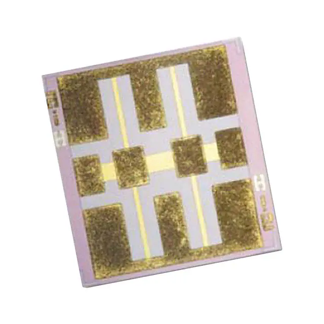

DATA SHEET ATN3580 Series: Fixed Attenuator Pads Features Specified flat response to 40 GHz Return loss > 16 dB to 40 GHz ● Available at 1–10, 12, 15, 20, 30 and 40 dB ● Power handling to 1 W CW ● Rugged thin film silicon chips ● ● Description The ATN3580 series of attenuator chips incorporate thin film resistors on high resistivity silicon chips to achieve precision attenuation, tight flatness and high return loss to 40 GHz. The design uses a balanced TEE resistive structure to assure broad bandwidth performance. The thin film technology offers improved power handling capability in comparison to the traditional thick film printed attenuator. All ATN3580 attenuator chips are specified for their attenuation at DC. In addition, a wafer probe sample test is performed to 40 GHz to assure meeting the flatness specification. Skyworks’ measurements indicate that attenuation typically increases with increasing frequency, as shown in Figure 1. Absolute Maximum Ratings Characteristic Incident power @ 25 °C Operating temperature Storage temperature Value 1W -55 °C to +175 °C -65 °C to +200 °C Performance is guaranteed only under the conditions listed in the specifications table and is not guaranteed under the full range(s) described by the Absolute Maximum specifications. Exceeding any of the absolute maximum/minimum specifications may result in permanent damage to the device and will void the warranty. CAUTION: Although this device is designed to be as robust as possible, Electrostatic Discharge (ESD) can damage this device. This device must be protected at all times from ESD. Static charges may easily produce potentials of several kilovolts on the human body or equipment, which can discharge without detection. Industry-standard ESD precautions must be employed at all times. Skyworks Solutions, Inc. • Phone [781] 376-3000 • Fax [781] 376-3100 • sales@skyworksinc.com • www.skyworksinc.com 200141 Rev.A • Skyworks Proprietary Information • Products and Product Information are Subject to Change Without Notice. • February 7, 2005 1 DATA SHEET • ATN3580 SERIES Electrical Specifications at 25 °C Nominal Attenuation (dB) 1 2 3 4 5 6 7 8 9 10 12 15 20 30 40 Attenuation Tolerance @ DC (dB) ± 0.15 ± 0.15 ± 0.25 ± 0.25 ± 0.25 ± 0.25 ± 0.25 ± 0.35 ± 0.35 ± 0.35 ± 0.50 ± 0.50 ± 1.10 ± 1.60 ± 1.60 Attenuation Flatness DC–12 GHz (dB) ± 0.20 ± 0.20 ± 0.20 ± 0.20 ± 0.20 ± 0.40 ± 0.40 ± 0.40 ± 0.40 ± 0.40 ± 0.40 ± 0.40 ± 1.00 ± 1.00 ± 1.00 DC–26.5 GHz (dB) ± 0.50 ± 0.50 ± 0.50 ± 0.50 ± 0.50 ± 0.60 ± 0.60 ± 0.60 ± 0.60 ± 0.60 ± 0.60 ± 0.60 ± 2.00 ± 2.00 ± 2.00 DC–40 GHz (dB) ± 1.00 ± 1.00 ± 1.00 ± 1.00 ± 1.00 ± 1.00 ± 1.00 ± 1.00 ± 1.00 ± 1.00 ± 1.00 ± 1.00 ± 4.00 ± 4.00 ± 4.00 Outline Drawing 516-060 516-060 516-060 516-060 516-060 518-060 518-060 518-060 518-060 518-060 518-060 518-060 518-060 518-060 518-060 Part Number ATN3580-01 ATN3580-02 ATN3580-03 ATN3580-04 ATN3580-05 ATN3580-06 ATN3580-07 ATN3580-08 ATN3580-09 ATN3580-10 ATN3580-12 ATN3580-15 ATN3580-20 ATN3580-30 ATN3580-40 Return Loss ATN3580 Series DC–7 GHz (dB) Min. 22 DC–12 GHz (dB) Min. 20 DC–26.5 GHz (dB) Min. 18 DC–40 GHz (dB) Min. 16 Skyworks Solutions, Inc. • Phone [781] 376-3000 • Fax [781] 376-3100 • sales@skyworksinc.com • www.skyworksinc.com 2 February 7, 2005 • Skyworks Proprietary Information • Products and Product Information are Subject to Change Without Notice. • 200141 Rev.A DATA SHEET • ATN3580 SERIES Typical Performance Data 12.0 11.5 50 40 Attenuation (dB) 10.5 10.0 9.5 9.0 8.5 8.0 0 10 20 30 40 Return Loss (dB) 11.0 S22 MAG. 30 S11 MAG. 20 10 0 0 10 20 30 40 Frequency (GHz) Frequency (GHz) Figure 1. ATN3580-10 Attenuation vs. Frequency Figure 2. ATN3580-10 Return Loss vs. Frequency Outline Drawings 518-060 COPLANAR RESISTOR PADS MUST BE GROUNDED INPUT/OUTPUT 0.012 (0.30 mm) 0.010 (0.25 mm) TYP. 0.030 (0.76 mm) 0.0045 (0.114 mm) 0.0035 (0.089 mm) 2 PLACES SEE NOTE 3 2 PLACES SILICON 0.0075 (0.190 mm) 0.0055 (0.140 mm) IN OUT 0.028 (0.71 mm) 516-060 0.0075 (0.191 mm) 0.0055 (0.140 mm) INPUT/OUTPUT 0.002 (0.05 mm) MIN. TYP. 0.006 (0.15 mm) 0.004 (0.10 mm) TYP. SQ. COPLANAR RESISTOR, PADS MUST BE GROUNDED 0.032 0.029 (0.81 mm) (0.74 mm) 0.0055 (0.140 mm) 0.0045 (0.114 mm) 2 PLACES SEE NOTE 3 2 PLACES 0.020 (0.51 mm) 0.026 (0.66 mm) SCHEMATIC ATT. PADS SILICON 0.0075 (0.190 mm) 0.0055 (0.140 mm) SCHEMATIC ATT. PADS IN OUT 1. Cross hatching = gold contact areas. 2. Dimensions not specified in this drawing vary per attenuation value. 3. Indicates attenuation value. 4. This DIM. can be as highh 0.012 for high attenuation values. 5. Back surface is gold, grounding not required. 1. Cross hatching = gold contact areas. 2. Dimensions not specified in this drawing vary per attenuation value. 3. Indicates attenuation value. 4. Back surface is gold, grounding not required. Skyworks Solutions, Inc. • Phone [781] 376-3000 • Fax [781] 376-3100 • sales@skyworksinc.com • www.skyworksinc.com 200141 Rev.A • Skyworks Proprietary Information • Products and Product Information are Subject to Change Without Notice. • February 7, 2005 3 DATA SHEET • ATN3580 SERIES Copyright © 2002, 2003, 2004, 2005, Skyworks Solutions, Inc. All Rights Reserved. Information in this document is provided in connection with Skyworks Solutions, Inc. (“Skyworks”) products. These materials are provided by Skyworks as a service to its customers and may be used for informational purposes only by the customer. Skyworks assumes no responsibility for errors or omissions in these materials. Skyworks may make changes to its documentation, products, specifications and product descriptions at any time, without notice. Skyworks makes no commitment to update the information and shall have no responsibility whatsoever for conflicts, incompatibilities, or other difficulties arising from future changes to its documentation, products, specifications and product descriptions. No license, express or implied, by estoppel or otherwise, to any intellectual property rights is granted by or under this document. Except as may be provided in Skyworks Terms and Conditions of Sale for such products, Skyworks assumes no liability whatsoever in association with its documentation, products, specifications and product descriptions. THESE MATERIALS ARE PROVIDED “AS IS” WITHOUT WARRANTY OF ANY KIND, EITHER EXPRESS OR IMPLIED OR OTHERWISE, RELATING TO SALE AND/OR USE OF SKYWORKS PRODUCTS INCLUDING WARRANTIES RELATING TO FITNESS FOR A PARTICULAR PURPOSE, MERCHANTABILITY, PERFORMANCE, QUALITY OR NON-INFRINGEMENT OF ANY PATENT, COPYRIGHT OR OTHER INTELLECTUAL PROPERTY RIGHT. SKYWORKS FURTHER DOES NOT WARRANT THE ACCURACY OR COMPLETENESS OF THE INFORMATION, TEXT, GRAPHICS OR OTHER ITEMS CONTAINED WITHIN THESE MATERIALS. SKYWORKS SHALL NOT BE LIABLE FOR ANY DAMAGES, INCLUDING SPECIAL, INDIRECT, INCIDENTAL, OR CONSEQUENTIAL DAMAGES, INCLUDING WITHOUT LIMITATION, LOST REVENUES OR LOST PROFITS THAT MAY RESULT FROM THE USE OF THESE MATERIALS WHETHER OR NOT THE RECIPIENT OF MATERIALS HAS BEEN ADVISED OF THE POSSIBILITY OF SUCH DAMAGE. Skyworks products are not intended for use in medical, lifesaving or life-sustaining applications. Skyworks customers using or selling Skyworks products for use in such applications do so at their own risk and agree to fully indemnify Skyworks for any damages resulting from such improper use or sale. The following are trademarks of Skyworks Solutions, Inc.: Skyworks®, the Skyworks logo, and Breakthrough Simplicity®. Product names or services listed in this publication are for identification purposes only, and may be trademarks of Skyworks or other third parties. Third-party brands and names are the property of their respective owners. Additional information, posted at www.skyworksinc.com, is incorporated by reference. Skyworks Solutions, Inc. • Phone [781] 376-3000 • Fax [781] 376-3100 • sales@skyworksinc.com • www.skyworksinc.com 4 February 7, 2005 • Skyworks Proprietary Information • Products and Product Information are Subject to Change Without Notice. • 200141 Rev.A
