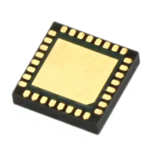

    IC FRONTEND MOD 802.11ABGN 32LGA
SE2548A-R 数据手册
DATA SHEET SE2548A: Dual-Band 802.11a/b/g/n Wireless LAN Front-End Preliminary Information Applications Product Description      The SE2548A is a complete 802.11a/b/g/n WLAN RF front-end module providing all the functionality of the power amplifiers, filtering, power detector, T/R switch, diplexers and associated matching. The SE2548A provides a complete 2.4 GHz and 5 GHz WLAN RF solution from the output of the transceiver to the antenna in an ultra compact form factor. IEEE802.11b DSSS WLAN IEEE802.11g OFDM WLAN IEEE802.11a OFDM WLAN IEEE802.11n WLAN Access Points, PCMCIA, PC cards Features          All RF ports matched to 50 Ω Integrated 2.4 GHz PA, 5 GHz PA, TX Filter, T/R switches and diplexers Integrated Power Detector for each TX Chain 21 dBm O/P Power, 802.11b, 11 Mbits, ACPR = 35 dBc 18 dBm @ 3.0 % EVM, 802.11g, 54 Mbits 16.5 dBm @ 3.0 % EVM, 802.11a, 54 Mbits Single supply voltage: 3.3 V ± 10 % Lead free, Halogen free, RoHS compliant, MSL 3 5mm x 5mm x 1.0mm, LGA Package Ordering Information Part No. Package Remark SE2548A SE2548A-R SE2548A-EK1 32 pin LGA 32 pin LGA N/A Samples Tape and Reel Evaluation kit Designed for ease of use, all RF ports are matched to 50 Ω to simplify PCB layout and the interface to the transceiver RFIC. The SE2548A also includes a transmitter power detector for each band and transmit chain with 20 dB of dynamic range for each transmit chain. Each transmit chain has a separate digital enable control for transmitter power ramp on/off control. The power ramp rise/fall time is less than 0.7 μsec. The device also provides a notch filter from 3.2603.267 GHz and 3.28-3.89 GHz prior to the input of each 2.4 GHz and 5 GHz power amplifiers, respectively. The SE2548A packaged in 5mm x 5mm x 1.0mm, Halogen free, Lead free, ROHS compliant, MSL 3 LGA package. Functional Block Diagram Skyworks Solutions, Inc. • Phone [781] 376-3000 • Fax [781] 376-3100 • sales@skyworksinc.com • www.skyworksinc.com 202422A • Skyworks Proprietary Information • Products and Product Information are Subject to Change Without Notice • September 25, 2012 1 DATA SHEET SE2548A: Dual-Band 802.11a/b/g/n Wireless LAN Front-End Preliminary Information Figure 1: SE2548A Functional Block Diagram Skyworks Solutions, Inc. • Phone [781] 376-3000 • Fax [781] 376-3100 • sales@skyworksinc.com • www.skyworksinc.com 202422A • Skyworks Proprietary Information • Products and Product Information are Subject to Change Without Notice • September 25, 2012 2 DATA SHEET SE2548A: Dual-Band 802.11a/b/g/n Wireless LAN Front-End Preliminary Information Pin Out Diagram Figure 2: SE2548A Pin Out (Top View Through Package) Pin Out Description Pin No. Name 1 Rg 2.4 GHz RF Receive Output 2 Ra 5 GHz RF Receive Output 3 GND 4 Tg 5 GND 6 Ta 7 GND Description Ground 2.4 GHz RF Transmit Input Ground 5 GHz RF Transmit Input Ground 8 Det 2.4/5 GHz Power Detector Output 9 ENa 5 GHz Power Amplifier Enable 10 ENg 2.4 GHz Power Amplifier Enable 11 VCC Supply Voltage 12-16 NU 17 VCC Not Used 18-20 NU 21-22 GND Ground 23 Ant Antenna 24 GND Ground 25 CRx Receive Switch Control 26 CTx Transmit Switch Control 27-28 NU Not Used Supply Voltage Not Used Skyworks Solutions, Inc. • Phone [781] 376-3000 • Fax [781] 376-3100 • sales@skyworksinc.com • www.skyworksinc.com 202422A • Skyworks Proprietary Information • Products and Product Information are Subject to Change Without Notice • September 25, 2012 3 DATA SHEET SE2548A: Dual-Band 802.11a/b/g/n Wireless LAN Front-End Preliminary Information Pin No. Name 29-30 GND 31-32 NU Description Ground Not Used Absolute Maximum Ratings These are stress ratings only. Exposure to stresses beyond these maximum ratings may cause permanent damage to, or affect the reliability of the device. Avoid operating the device outside the recommended operating conditions defined below. This device is ESD sensitive. Handling and assembly of this device should be at ESD protected workstations. Symbol Definition Min. Max. Unit VCC Supply Voltage -0.3 4.0 V PU ENa, ENg -0.3 4.0 V Ta, Tg, ANT terminated in 50Ω match - 12.0 dBm Operating Temperature Range 0 85 °C -40 150 °C TXRF TA TSTG Storage Temperature Range Recommended Operating Conditions Symbol Parameter VCC Supply Voltage TA Ambient Temperature Min. Typ. Max. Unit 3.0 3.3 3.6 V 0 25 85 °C Caution! Class 0 ESD sensitive device DC Electrical Characteristics Conditions: VCC = 3.3 V, TA = 25 °C, as measured on Skyworks Solutions’ SE2548A-EV1 evaluation board (deembedded to device), all unused ports terminated with 50 ohms, unless otherwise noted Symbol Parameter ICC-G Total 802.11g Transmit Supply Current ICC-B ICC-A ICC_OFF Conditions Min. Typ. Max. Unit POUT = 18 dBm, 54 Mbps OFDM signal, 64 QAM ENg = 3.3 V, ENa = 0 V - 170 - mA Total 802.11b Transmit Supply Current POUT = 21 dBm, 11 Mbps CCK signal, BT = 0.45, ENg = 3.3 V, ENa = 0 V - 250 - mA Total 802.11a Transmit Supply Current POUT = 16 dBm, 54 Mbps OFDM signal, 64 QAM, ENa = 3.3 V, ENg = 0 V - 175 200 mA Total Supply Current No RF, ENg = ENa = 0 V - 2 10 μA Skyworks Solutions, Inc. • Phone [781] 376-3000 • Fax [781] 376-3100 • sales@skyworksinc.com • www.skyworksinc.com 202422A • Skyworks Proprietary Information • Products and Product Information are Subject to Change Without Notice • September 25, 2012 4 DATA SHEET SE2548A: Dual-Band 802.11a/b/g/n Wireless LAN Front-End Preliminary Information Logic Characteristics Conditions: VCC = 3.3 V, TA = 25 °C, as measured on Skyworks Solutions’ SE2548A-EV1 evaluation board (deembedded to device), all unused ports terminated with 50 ohms, unless otherwise noted. Symbol Parameter Conditions Min. Typ. Max. Unit VENH Logic High Voltage for ENg, ENa (Module On) - 1.8 - VCC V VENL Logic Low Voltage ENg, ENa (Module Off) - 0 - 0.5 V IENH Input Current Logic High Voltage (ENg, ENa) - - 100 200 μA IENL Input Current Logic Low Voltage (ENg, ENa) - - 0.2 - μA Switch Characteristics Conditions: VCC = VEN = 3.3 V, TA = 25 °C, as measured on Skyworks Solutions’ SE2548A-EV1 evaluation board (de-embedded to device), all unused ports terminated with 50 ohms, unless otherwise noted. Symbol Parameter Conditions Min. Typ. Max. Unit VCTL_ON Control Voltage (On State) - 3.0 - 3.6 V VCTL_OFF Control Voltage (OFF State) - 0.0 - 0.2 V SW ON Low Loss Switch Control Voltage High State = VCTL_ON VCTL_OFF 2.8 - VCC V SW OFF High Loss Switch Control Voltage Low State = VCTL_OFF VCTL_OFF 0 - 0.3 V ICTL_ON Switch Control Bias Current (RF Applied) On pin (CTx, CRx) being driven high. RF Applied - - 100 µA ICTL_ON Switch Control Bias Current (No RF) On pin (CTx, CRx) being driven high. No RF - - 30 µA - - 100 pF Control Input Capacitance CCTL - Switch Control Logic Table CTx CRx Tg, Ta – ANT Rg, Ra – ANT SWON SW OFF ON OFF SW OFF SWON OFF ON SW OFF SW OFF OFF OFF All Other States Unsupported Switch State Skyworks Solutions, Inc. • Phone [781] 376-3000 • Fax [781] 376-3100 • sales@skyworksinc.com • www.skyworksinc.com 202422A • Skyworks Proprietary Information • Products and Product Information are Subject to Change Without Notice • September 25, 2012 5 DATA SHEET SE2548A: Dual-Band 802.11a/b/g/n Wireless LAN Front-End Preliminary Information 2.4 GHz AC Electrical Characteristics 2.4 GHz Transmit Characteristics Conditions: VCC = 3.3 V, ENg = CTx = 3.3 V, ENa = CRx = 0 V, TA = 25 °C, as measured on Skyworks Solutions’ SE2548A-EV1 evaluation board (de-embedded to device), all unused ports terminated with 50 ohms, unless otherwise noted. Symbol FIN Parameter Condition Min. Typ. - 2400 - 2500 MHz Frequency Range Max. Unit P802.11g Output power 54 Mbps OFDM signal, 64QAM, EVM = 3.0 % - 18 - dBm P802.11b Output power 11 Mbps CCK signal, BT = 0.45 ACPR(± 11MHz offset) < -35 ACPR(± 22MHz offset) < -56 - 21 - dBm P1dB P1dB - 23 25.5 - dBm S21 Small Signal Gain - 25 - 30 dB Small Signal Gain Variation Over Band - - 1.0 2.0 dB ΔS21 Gain at Ref-VCO 3216.00 to 3256.00 MHz 3262.00 to 3263.21 MHz 3269.33 to 3276.00 MHz 3282.67 to 3312.00 MHz - 0 9 4 9 17 dB 2f,3f Harmonics Pout ≤ 21 dBm, 11Mbps, CCK - - -45.2 dBm/MHz tr Rise Time 10 % to 90% of final output power level - - 0.7 μs tdr, tdf Delay and rise/fall Time 50 % of VEN edge and 90/10 % of final output power level - - 0.7 μs S11 Input Return Loss 10 15 - dB S213.2 STAB Ru - Stability CW, POUT = 21 dBm 0.1 GHz – 21 GHz Load VSWR = 6:1 Ruggedness Tg = 12dBm, ANT load varies over 6:1 VSWR All non-harmonically related outputs less than -42 dBm/MHz No Irreversible damage 2.4 GHz Receive Characteristics Conditions: VCC = 3.3 V, CRx = 3.3 V, ENg = ENa = CTx = 0 V, TA = 25 °C, as measured on Skyworks Solutions’ SE2548A-EV1 evaluation board (de-embedded to device), all unused ports terminated with 50 ohms, unless otherwise noted. Symbol FOUT Parameter Frequency Range Condition Min. Typ. - 2400 - Max. 2500 Skyworks Solutions, Inc. • Phone [781] 376-3000 • Fax [781] 376-3100 • sales@skyworksinc.com • www.skyworksinc.com 202422A • Skyworks Proprietary Information • Products and Product Information are Subject to Change Without Notice • September 25, 2012 Unit MHz 6 DATA SHEET SE2548A: Dual-Band 802.11a/b/g/n Wireless LAN Front-End Preliminary Information Symbol Parameter Condition Min. Typ. Max. Unit RXIL Insertion Loss - - 1.7 1.9 dB RXRL Return Loss - 10 15 - dB Rx Leakage CTx = SWON, CRx = SWOFF, Device transmitting (TXEN = 3.3 V) 18.0 dBm @ ANT, Power measured @ RX_OUT - - -3 dBm Antenna to Rx isolation Small signal input into ANT, Device not transmitting, Power measured @ RXRF, CTx (Ant to Rx Iso) = SWON, CRx = SWOFF 21 - 28 dB TRISOL-2 ANTRISOL 5 GHz AC Electrical Characteristics 5 GHz Transmit Characteristics Conditions: VCC = 3.3 V, ENa and CTx = 3.3 V, ENg = CRx = 0 V, TA = 25 °C, as measured on Skyworks Solutions’ SE2548A-EV1 evaluation board (de-embedded to device), all unused ports terminated with 50 ohms, unless otherwise noted. Symbol FIN P802.11a Parameter Frequency Range Nominal Output Power Condition Min. Typ. Max. Unit - 4900 - 5875 MHz 54 Mbps OFDM signal, 64 QAM, EVM = 3.0 % - 16.5 - dBm P1dB P1dB - 21 22.5 - dBm S21 Small Signal Gain - 22 - 29 dB Small Signal Gain Variation Over 40 MHz Channel - - 0.5 dB ΔS21 Small Signal Gain Variation Over subbands 4.9 – 5.1 GHz 5.15 – 5.7 GHz 5.7 – 5.85 GHz - 1 3 dB S211.6 Gain at Ref-VCO ÷ 2 1640.00 to 1942.00 MHz - - 21 dB S213.2 Gain at Ref-VCO 3280 to 3800 MHz 3828 to 3872 MHz 3882 to 3885 MHz - - 9 4 9 dB 5300 – 5850 MHz - - -48.2 All other bands - - -35.0 10 % to 90% of final output power level - - 0.7 2f,3f tr Harmonics @16dBm, 54Mbps, 802.11a Rise Time dBm/MHz Skyworks Solutions, Inc. • Phone [781] 376-3000 • Fax [781] 376-3100 • sales@skyworksinc.com • www.skyworksinc.com 202422A • Skyworks Proprietary Information • Products and Product Information are Subject to Change Without Notice • September 25, 2012 μs 7 DATA SHEET SE2548A: Dual-Band 802.11a/b/g/n Wireless LAN Front-End Preliminary Information Symbol Parameter tdr, tdf Delay and rise/fall Time S11 Input Return Loss STAB Ru Condition 50 % of VEN edge and 90/10 % of final output power level - Min. Typ. Max. Unit - - 0.7 μs 10 15 - dB Stability 64 QAM, POUT = 16 dBm 0.1 GHz – 21 GHz Load VSWR = 6:1 All non-harmonically related outputs less than -42 dBm/MHz Ruggedness TXa = 12dBm, ANT load varies over 6:1 VSWR No Irreversible damage 5 GHz Receive Characteristics Conditions: VCC = 3.3 V, CRx = 3.3 V, ENg = ENa = CTx = 0 V, TA = 25 °C, as measured on Skyworks Solutions’ SE2548A-EV1 evaluation board (de-embedded to device), all unused ports terminated with 50 ohms, unless otherwise noted. Symbol Parameter Condition Min. Typ. Max. Unit FOUT Frequency Range - 4900 - 5875 MHz RXIL Insertion Loss - - 2 2.5 dB RXRL Return Loss - 10 15 - dB - - 0 dBm 16 - 27 dB TALEAK ATTa Tx Power Leakage Pout = 16 dBm, ENa = 3.3 V, CTx = 3.3 V, CRx = 0 V Antenna to Rx isolation Small signal input into ANT, Device not transmitting, Power measured @ RXRF, CTx (Ant to Rx Iso) = SWON, CRx = SWOFF Skyworks Solutions, Inc. • Phone [781] 376-3000 • Fax [781] 376-3100 • sales@skyworksinc.com • www.skyworksinc.com 202422A • Skyworks Proprietary Information • Products and Product Information are Subject to Change Without Notice • September 25, 2012 8 DATA SHEET SE2548A: Dual-Band 802.11a/b/g/n Wireless LAN Front-End Preliminary Information 2.4 GHz Power Detector Characteristic Conditions: VCC = 3.3 V, “ENg and TxA1” OR “ENg and TxA2” = 3.3 V, RxA2 = RxA1 = 0 V, TA = 25 °C, as measured on Skyworks Solutions’ SE2548A-EV1 evaluation board (de-embedded to device), all unused ports terminated with 50 Ω, unless otherwise noted. Symbol Parameter FOUT Frequency Range PDR Power detect range, peak power Condition Min. Typ. - 2400 - 2500 MHz 0 - 22 dBm Measured at ANT0 or ANT1 Max. Unit PDZOUT DC Output impedance - - 200 - Ω PDVP21 Output Voltage, POUT = 21dBm - - 0.85 - V PDVp15 Output Voltage, POUT = 15dBm - - 0.55 - V PDVpnoRF Output Voltage, POUT = No RF - - 0.30 - V LPF-3dB Power detect low pass filter -3dB corner frequency - 1500 - KHz Load = high impedance Typ: 500 kΩ 2.5GHz Pow er Detector Response into 1MΩ Load 2400 2450 2500 VDET (V) 1.1 0.9 0.7 0.5 0.3 3 5 7 9 11 13 15 17 Output Pow er (dBm ) 19 21 23 Figure 3: SE2548A Power Detector vs. Output Power over Frequency (CW Signal) Skyworks Solutions, Inc. • Phone [781] 376-3000 • Fax [781] 376-3100 • sales@skyworksinc.com • www.skyworksinc.com 202422A • Skyworks Proprietary Information • Products and Product Information are Subject to Change Without Notice • September 25, 2012 9 DATA SHEET SE2548A: Dual-Band 802.11a/b/g/n Wireless LAN Front-End Preliminary Information 5 GHz Power Detector Characteristic Conditions: VCC = 3.3 V, “ENa and TxA1” OR “ENa and TxA2” = 3.3 V, RxA2 = RxA1 = 0 V, TA = 25 °C, as measured on Skyworks Solutions’ SE2548A-EV1 evaluation board (de-embedded to device), all unused ports terminated with 50 Ω, unless otherwise noted. Symbol Parameter FOUT Frequency Range PDR Power detect range, peak power Condition Min. Typ. - 4900 - 5850 MHz 0 - 21 dBm Measured at ANT Max. Unit PDZOUT DC Output impedance - - 200 - Ω PDVp18 Output Voltage, POUT = 18dBm - - 0.80 - V PDVp15 Output Voltage, POUT = 15dBm - - 0.62 - V PDVNoRF Output Voltage, POUT = No RF - - 0.30 - V LPF-3dB Power detect low pass filter -3dB corner frequency - 1500 - KHz Load = high impedance Typ: 500 kΩ 5GHz Pow er Detector Response into 1MΩ 4900 5150 5450 5850 VDET (V) 1.3 1.1 0.9 0.7 0.5 0.3 3 5 7 9 11 13 15 17 Output Pow er (dBm ) 19 21 23 Figure 4: Preliminary SE2548A Power Detector vs. Output Power over Frequency (CW Signal) Skyworks Solutions, Inc. • Phone [781] 376-3000 • Fax [781] 376-3100 • sales@skyworksinc.com • www.skyworksinc.com 202422A • Skyworks Proprietary Information • Products and Product Information are Subject to Change Without Notice • September 25, 2012 10 DATA SHEET SE2548A: Dual-Band 802.11a/b/g/n Wireless LAN Front-End Preliminary Information 2X 0.750±0.050 2X 0.250±0.050 2X 0.250±0.050 2X 0.750±0.050 2X 1.250±0.050 2X 1.750±0.050 25 26 27 28 29 30 31 32 8X 2.200±0.050 2X 1.750±0.050 1.00±0.10 5.00±0.10 2X 1.250±0.050 8X 2.200±0.050 Package Drawing 1.750±0.050 24 1 23 8X 2.200±0.050 2X 1.750±0.050 0.30 x 45° 2X 1.250±0.050 23 2 22 2X 0.750±0.050 22 3 4 21 2X 0.250±0.050 21 4 5 20 2X 0.250±0.050 20 5 6 19 2X 0.750±0.050 19 6 7 18 2X 1.250±0.050 18 8 17 2X 1.750±0.050 17 32 31 30 29 28 27 26 25 1 24 2 3 5.00±0.10 0.0 7 GND 12 13 14 15 8X 2.200±0.050 16 8 16 15 14 12 11 10 9 1.750±0.050 0.300±0.020 0.400±0.020 0.300±0.020 13 1.600±0.050 11 0.0 10 1.600±0.050 9 0.400±0.020 Figure 5: Package Drawing: Topside Skyworks Solutions, Inc. • Phone [781] 376-3000 • Fax [781] 376-3100 • sales@skyworksinc.com • www.skyworksinc.com 202422A • Skyworks Proprietary Information • Products and Product Information are Subject to Change Without Notice • September 25, 2012 11 DATA SHEET SE2548A: Dual-Band 802.11a/b/g/n Wireless LAN Front-End Preliminary Information Recommended Land and Solder Patterns PACKAGE OUTLINE 32 31 30 29 28 27 26 25 32 31 30 29 28 27 26 25 32 31 30 29 28 27 26 25 1 24 1 24 1 24 2 23 2 23 2 23 3 22 3 22 3 22 4 21 4 21 4 21 5 20 5 20 5 20 6 19 6 19 6 19 7 18 7 18 7 18 8 17 8 17 8 17 9 10 11 12 13 14 15 16 9 10 11 12 13 14 15 16 9 10 11 12 13 14 15 16 PCB METAL & VIA HOLE PCB SOLDER MASK PCB SOLDER STENCIL TOP (X-Ray) VIEW TOP (X-Ray) VIEW TOP (X-Ray) VIEW PERIPHERAL PAD PATTERN DETAIL CL CL RECOMMENDED FOOTPRINT NOTES: GENERAL NOTES: 1. ALL DIMENSIONS ARE IN MILLIMETERS. 2. DIMENSIONING AND TOLERANCES CONFORM TO ASME Y14.5M-1994. (UNLESS OTHERWISE SPECIFIED THE FOLLOWING VALUES APPLY) DECIMAL TOLERANCE: X.X (1 PLC) ± 0.1mm X.XX (2 PLC) ± 0.05mm X.XXX (3 PLC) ± 0.025mm ANGULAR TOLERANCE: ± 1° 3. UNLESS SPECIFIED DIMENSIONS ARE SYMMETRICAL ABOUT CENTER LINES. 4. VIA HOLE INFORMATION: 4a. RECOMMENDED VIA HOLE SIZE (Ø): 0.150 - 0.300mm 4b. RECOMMENDED VIA HOLE PITCH: AS SHOWN 4c. RECOMMENDED VIA WALL Cu PLATING: 30-35um 4d. RECOMMENDED THAT VIAS BE TENTED WITH SOLDERMASK ON PCB BACKSIDE AND FILLED WITH SOLDER. 4e. VIA IN SIGNAL PAD DETAIL, TYP 7 PLCS. 4f. TOTAL VIA COUNT AS SHOWN: 23. 5. SOLDER MASK GEOMETRY FEATURES: 5a. ALL PERIPHERAL PCB PADS ARE NON-SOLDER MASK DEFINED. 5b. ALL GROUND PADDLE FEATURES ARE SOLDER MASK DEFINED. 6. SOLDER STENCIL APERTURE FEATURES: 6a. SOLDER STENCIL APERATURE OPENINGS ARE SMALLER THEN PERIPHERAL PCB METAL PADS. 6b. RECOMMENDED SOLDER STENCIL APERTURE ARRAY TO TARGET APPROXIMATELY 50 - 80% COVERAGE OF SOLDER MASK OPENINGS, EXCEPT AS NOTED. 7. RECOMMENDED SOLDER STENCIL THICKNESS: 5.0mils (0.127mm). 8. PCB ACAD AND GERBER FILES AVAILABLE UPON REQUEST. Figure 6: Recommended Land and Solder Patterns Skyworks Solutions, Inc. • Phone [781] 376-3000 • Fax [781] 376-3100 • sales@skyworksinc.com • www.skyworksinc.com 202422A • Skyworks Proprietary Information • Products and Product Information are Subject to Change Without Notice • September 25, 2012 12 DATA SHEET SE2548A: Dual-Band 802.11a/b/g/n Wireless LAN Front-End Preliminary Information Package Handling Information Because of its sensitivity to moisture absorption, instructions on the shipping container label must be followed regarding exposure to moisture after the container seal is broken, otherwise, problems related to moisture absorption may occur when the part is subjected to high temperature during solder assembly. The SE2548A is capable of withstanding a Pb free solder reflow. Care must be taken when attaching this product, whether it is done manually or in a production solder reflow environment. If the part is manually attached, precaution should be taken to insure that the device is not subjected to temperatures above its rated peak temperature for an extended period of time. For details on both attachment techniques, precautions, and handling procedures recommended, please refer to:  “Land Grid Array Module Solder Reflow & Rework Information”, Document Number QAD-00046.  “Handling, Packing, Shipping and Use of Moisture Sensitive LGA”, Document Number QAD-00047. Product Branding Pin 1 Identifier Terminal Finish Pin 1 e4 Part Lot SiGe 2548A Lot Code Figure 7: SE2548A Branding Information Skyworks Solutions, Inc. • Phone [781] 376-3000 • Fax [781] 376-3100 • sales@skyworksinc.com • www.skyworksinc.com 202422A • Skyworks Proprietary Information • Products and Product Information are Subject to Change Without Notice • September 25, 2012 13 DATA SHEET SE2548A: Dual-Band 802.11a/b/g/n Wireless LAN Front-End Preliminary Information Tape and Reel Information Production quantities of this product are shipped in a standard tape-and-reel format. dimensions and sizing is shown in Table 1and Figure . Parameter Devices Per Reel Reel Diameter Specific tape and reel Value 3000 13 inches Table 1: Tape and Reel Dimensions Figure 8: Detailed Tape and Reel Information (All diminensions in Millimeters) Skyworks Solutions, Inc. • Phone [781] 376-3000 • Fax [781] 376-3100 • sales@skyworksinc.com • www.skyworksinc.com 202422A • Skyworks Proprietary Information • Products and Product Information are Subject to Change Without Notice • September 25, 2012 14 DATA SHEET SE2548A: Dual-Band 802.11a/b/g/n Wireless LAN Front-End Preliminary Information Document Change History Revision Date Notes 1.0 December 6, 2006 Created 1.1 March 24, 2007 Updated Pin Names Updated output power in 2GHz channel Updated 5GHz detector characteristics 1.2 No changes released to production June 29, 2007 Updated TX and RX specifications based on measured data, including power, gain, return loss in both 2GHz and 5GHz channels 1.4 September 29, 2007 Updated output power, and gain profile in the 2GHz and 5GHz channels Updated current consumption in the 2GHz and 5GHz channels Updated switch control logic table Update the 5GHz detector characteristics 1.5 November 6, 2007 Corrected labels of figures. 1.6 June 13, 2008 Updated for Halogen Free Added recommended land and solder patterns 1.7 May 26, 2009 Amended back page. 1.8 September 14, 2009 Updated pin definitions 1.9 March 28, 2012 Updated with Skyworks logo and disclaimer statement 1.3 Copyright © 2012 Skyworks Solutions, Inc. All Rights Reserved. Information in this document is provided in connection with Skyworks Solutions, Inc. (“Skyworks”) products or services. These materials, including the information contained herein, are provided by Skyworks as a service to its customers and may be used for informational purposes only by the customer. Skyworks assumes no responsibility for errors or omissions in these materials or the information contained herein. Skyworks may change its documentation, products, services, specifications or product descriptions at any time, without notice. Skyworks makes no commitment to update the materials or information and shall have no responsibility whatsoever for conflicts, incompatibilities, or other difficulties arising from any future changes. No license, whether express, implied, by estoppel or otherwise, is granted to any intellectual property rights by this document. Skyworks assumes no liability for any materials, products or information provided hereunder, including the sale, distribution, reproduction or use of Skyworks products, information or materials, except as may be provided in Skyworks Terms and Conditions of Sale. THE MATERIALS, PRODUCTS AND INFORMATION ARE PROVIDED “AS IS” WITHOUT WARRANTY OF ANY KIND, WHETHER EXPRESS, IMPLIED, STATUTORY, OR OTHERWISE, INCLUDING FITNESS FOR A PARTICULAR PURPOSE OR USE, MERCHANTABILITY, PERFORMANCE, QUALITY OR NON-INFRINGEMENT OF ANY INTELLECTUAL PROPERTY RIGHT; ALL SUCH WARRANTIES ARE HEREBY EXPRESSLY DISCLAIMED. SKYWORKS DOES NOT WARRANT THE ACCURACY OR COMPLETENESS OF THE INFORMATION, TEXT, GRAPHICS OR OTHER ITEMS CONTAINED WITHIN THESE MATERIALS. SKYWORKS SHALL NOT BE LIABLE FOR ANY DAMAGES, INCLUDING BUT NOT LIMITED TO ANY SPECIAL, INDIRECT, INCIDENTAL, STATUTORY, OR CONSEQUENTIAL DAMAGES, INCLUDING WITHOUT LIMITATION, LOST REVENUES OR LOST PROFITS THAT MAY RESULT FROM THE USE OF THE MATERIALS OR INFORMATION, WHETHER OR NOT THE RECIPIENT OF MATERIALS HAS BEEN ADVISED OF THE POSSIBILITY OF SUCH DAMAGE. Skyworks products are not intended for use in medical, lifesaving or life-sustaining applications, or other equipment in which the failure of the Skyworks products could lead to personal injury, death, physical or environmental damage. Skyworks customers using or selling Skyworks products for use in such applications do so at their own risk and agree to fully indemnify Skyworks for any damages resulting from such improper use or sale. Customers are responsible for their products and applications using Skyworks products, which may deviate from published specifications as a result of design defects, errors, or operation of products outside of published parameters or design specifications. Customers should include design and operating safeguards to minimize these and other risks. Skyworks assumes no liability for applications assistance, customer product design, or damage to any equipment resulting from the use of Skyworks products outside of stated published specifications or parameters. Skyworks, the Skyworks symbol, and “Breakthrough Simplicity” are trademarks or registered trademarks of Skyworks Solutions, Inc., in the United States and other countries. Third-party brands and names are for identification purposes only, and are the property of their respective owners. Additional information, including relevant terms and conditions, posted at www.skyworksinc.com, are incorporated by reference. Skyworks Solutions, Inc. • Phone [781] 376-3000 • Fax [781] 376-3100 • sales@skyworksinc.com • www.skyworksinc.com 202422A • Skyworks Proprietary Information • Products and Product Information are Subject to Change Without Notice • September 25, 2012 15
