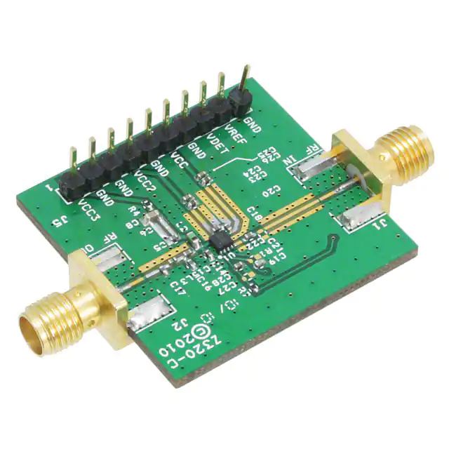

    EVAL KIT FOR SE2609L
SE2609L-EK1 数据手册
DATA SHEET SE2609L: 2.4 GHz Power Amplifier with Power Detector Preliminary Information Applications Product Description   The SE2609L is a 2.4 GHz power amplifier designed for use in the 2.4 GHz ISM band for wireless LAN applications. The device incorporates a power detector for closed loop monitoring of the output power.  DSSS 2.4 GHz WLAN (IEEE802.11b) OFDM 2.4 GHz WLAN (IEEE802.11g or IEEE802.11n) Access Points, PCMCIA, PC cards Features        The SE2609L is enabled by a 2.85V reference. 3.3 V Supply Operation with 2.85 V reference o 19 dBm, EVM = 3 %, 802.11g, OFDM 54 Mbps o 22 dBm, ACPR < -32 dBc, 802.11b 5.0V Supply Operation with 2.85V reference 28 dB Gain Integrated temperature compensated power detector Analog reference voltage control for maximum flexibility Lead Free, Halogen Free and RoHS compliant Small package: 8 pin 2 mm x 2 mm x 0.9 mm QFN, MSL 1 The SE2609L temperature compensated power detector is highly immune to mismatch at its output with less than 1.5 dB of variation with a 2:1 mismatch. Ordering Information Part Number Package Remark SE2609L SE2609L-R SE2609L-AK1 8 Pin QFN 8 Pin QFN Application Kit Samples Tape and Reel Standard Skyworks Solutions, Inc. • Phone [781] 376-3000 • Fax [781] 376-3100 • sales@skyworksinc.com • www.skyworksinc.com 202439A • Skyworks Proprietary Information • Products and Product Information are Subject to Change Without Notice • September 25, 2012 1 DATA SHEET SE2609L: 2.4 GHz Power Amplifier with Power Detector Preliminary Information Functional Block Diagram Figure 1: Functional Block Diagram Pin Out Diagram VREF 1 DET Ground Paddle 8 RF OUT 2 7 GND GND 3 6 VCC RF IN 4 5 VCC Figure 2: SE2609L Pin-Out Diagram Pin Out Description Pin No. Name 1 VREF Description Reference voltage supply Skyworks Solutions, Inc. • Phone [781] 376-3000 • Fax [781] 376-3100 • sales@skyworksinc.com • www.skyworksinc.com 202439A • Skyworks Proprietary Information • Products and Product Information are Subject to Change Without Notice • September 25, 2012 2 DATA SHEET SE2609L: 2.4 GHz Power Amplifier with Power Detector Preliminary Information 2 DET Analog power detector output 3 GND Ground 4 RF_IN RF input 5 VCC Supply stage 1 and 0 6 VCC Supply stage 2 7 GND Ground 8 RF_OUT RF output & Supply Stage 3 Skyworks Solutions, Inc. • Phone [781] 376-3000 • Fax [781] 376-3100 • sales@skyworksinc.com • www.skyworksinc.com 202439A • Skyworks Proprietary Information • Products and Product Information are Subject to Change Without Notice • September 25, 2012 3 DATA SHEET SE2609L: 2.4 GHz Power Amplifier with Power Detector Preliminary Information Absolute Maximum Ratings These are stress ratings only. Exposure to stresses beyond these maximum ratings for a long period of time may cause permanent damage to, or affect the reliability of the device. Avoid operating the device outside the recommended operating conditions defined below. This device is ESD sensitive. Handling and assembly of this device should be at ESD protected workstations. Symbol Definition Min. Max. Unit VCC Supply Voltage on pins VCC -0.3 5.5 V VREF Power Amplifier Reference Voltage -0.3 3.6 V RFin RF Input Power, RF_OUT terminated into 50Ω match - 10 dBm TSTG Storage Temperature Range -40 150 °C ESD HBM JEDEC JESD22-A114 all pins 500 V Min. Max. Unit Recommended Operating Conditions Symbol Parameter VCC Supply Voltage 3.0 5.5 V TA Ambient Temperature -20 85 °C DC Electrical Characteristics Conditions: VCC = 3.3, VREF = 2.85 V, TA = 25 °C, as measured on Skyworks Solutions’ SE2609L-EK1 evaluation board, unless otherwise noted. Symbol ICC-802.11b ICC-802.11g Parameter Supply Current (Sum of VCC0, VCC, VCC3) Supply Current (Sum of VCC,VCC3) Conditions Min. Typ. Max. POUT = 22 dBm, 11 Mbps CCK signal, BT = 0.45, VCC = VCC3 = 3.3 V - 200 - Unit mA POUT = 24 dBm, 11 Mbps CCK signal, BT = 0.45, VCC = VCC3 = 5.0 V POUT = 19 dBm, 54 Mbps OFDM signal, 64 QAM, VCC = VCC3 = 3.3 V 260 - 160 mA POUT = 22 dBm, 54 Mbps OFDM signal, 64 QAM, VCC = VCC3 = 5.0 V 220 ICQ Supply Current (Sum of VCC,VCC3) No RF - 100 - mA IOFF Supply Current VREF = 0 V, No RF - 2 10 μA VREF Reference Voltage - 2.70 2.85 2.90 V IREF Input Current Logic High Voltage - - 2.0 - mA Skyworks Solutions, Inc. • Phone [781] 376-3000 • Fax [781] 376-3100 • sales@skyworksinc.com • www.skyworksinc.com 202439A • Skyworks Proprietary Information • Products and Product Information are Subject to Change Without Notice • September 25, 2012 4 DATA SHEET SE2609L: 2.4 GHz Power Amplifier with Power Detector Preliminary Information AC Electrical Characteristics 802.11b/g AC Electrical Characteristics Conditions: VCC = 3.3V, VREF = 2.85 V, f = 2.45 GHz, TA = 25 °C, as measured on Skyworks Solutions’ SE2609LEK1 evaluation board, unless otherwise noted Symbol fL-U Parameter Conditions Min. Typ. Max. Unit - 2400 - 2500 MHz - 19 - Frequency Range 54 Mbps OFDM signal, 64 QAM, 3% EVM POUT Output Power 54 Mbps OFDM signal, 64 QAM, 3% EVM, VCC = 5.0V 22 11 Mbps CCK signal, BT = 0.45 22 11 Mbps CCK signal, BT = 0.45, VCC = 5.0V 24 P1dB Output 1dB compression point S11 Input Return Loss S21 Small Signal Gain PIN = -25 dBm Gain Variation over band PIN = -25 dBm, fIN= 2400 to 2500 MHz ΔS21 No modulation dBm - 25.5 - dBm - -10 - dB 26 28 32 dB - 0.5 - dB - -33 -52 - dBc POUT = 22 dBm @ VCC = 3.3 V or POUT = 24 dBm @ VCC = 5.0 V - -50 - dBm/MHz - -50 - dBm/MHz - - 0.5 - µSec Adjacent Channel Power Ratio ACPR 11 Mbps CCK signal, BT = 0.45, ±11 MHz offsets from carrier POUT = 22 dBm @ VCC = 3.3 V or ±22 MHz offsets from carrier POUT = 24 dBm @ VCC = 5.0 V 2f Harmonic, 1MBPS, BPSK 3f tr , tf Rise and Fall Time POUT = 22 dBm, 54 Mbps OFDM signal, 64 QAM VSWR = 6:1 All Phases STAB Stability POUT = 24 dBm, 54 Mbps OFDM signal, 64 QAM VSWR = 6:1 All Phases, VCC = 5.0 V VSWR Tolerance to output load mismatching All non-harmonically related outputs less than -50 dBc/100 kHz PIN = 10 dBm, CW, VCC = 3.3 V VSWR = 10:1 All Phases No damage PIN = -5 dBm, CW, VCC = 5.0V VSWR = 10:1 All Phases Skyworks Solutions, Inc. • Phone [781] 376-3000 • Fax [781] 376-3100 • sales@skyworksinc.com • www.skyworksinc.com 202439A • Skyworks Proprietary Information • Products and Product Information are Subject to Change Without Notice • September 25, 2012 5 DATA SHEET SE2609L: 2.4 GHz Power Amplifier with Power Detector Preliminary Information Power Detector Conditions: VCC = 3.3, VREF = 2.85 V, f = 2.45 GHz, TA = 25 °C, as measured on Skyworks Solutions’ SE2609L-EK1 evaluation board, unless otherwise noted Symbol PDR Parameter Conditions Min. Typ. - 0 - P1dB dBm POUT = 24 dBm, VCC = 5.0 V - 1.05 - V POUT = 22 dBm, VCC = 5.0 V - 0.90 - V POUT = 22 dBm, VCC = 3.3 V - 0.95 - V POUT = 19 dBm, VCC = 3.3V - 0.75 - V POUT = NO RF - 0.33 - V POUT detect range VDET Detector Voltage Max. Unit PDZOUT Output Impedance - - 2.3 - kΩ PDZLOAD DC load impedance - 10 - - kΩ Power Detector Response, CW 2450MHz, 5.0V 2450MHz, 3.3V 2400MHz, 5.0V 2400MHz, 3.3V 2500MHz, 5.0V 2500Mhz, 3.3V 1.2 1.1 1 VDET (V) 0.9 0.8 0.7 0.6 0.5 0.4 0.3 2 4 6 8 10 12 14 16 Output Power (dBm) 18 20 22 24 Figure 3: SE2609L Power Detector Characteristic Skyworks Solutions, Inc. • Phone [781] 376-3000 • Fax [781] 376-3100 • sales@skyworksinc.com • www.skyworksinc.com 202439A • Skyworks Proprietary Information • Products and Product Information are Subject to Change Without Notice • September 25, 2012 6 DATA SHEET SE2609L: 2.4 GHz Power Amplifier with Power Detector Preliminary Information Package Diagram 1 8 8 1 2 7 7 2 3 6 6 3 4 5 5 4 TOP VIEW BOTTOM VIEW Figure 4: SE2609L Package Diagram Recommended Land Pattern 1 8 1 8 1 8 2 7 2 7 2 7 3 6 3 6 3 6 4 5 4 5 4 5 Figure 5: SE2609L Package Diagram Skyworks Solutions, Inc. • Phone [781] 376-3000 • Fax [781] 376-3100 • sales@skyworksinc.com • www.skyworksinc.com 202439A • Skyworks Proprietary Information • Products and Product Information are Subject to Change Without Notice • September 25, 2012 7 DATA SHEET SE2609L: 2.4 GHz Power Amplifier with Power Detector Preliminary Information Branding Information Pin 1 Part Lot Code 2609 Lot Figure 6: SE2609L Branding and Pin 1 Location (Top View) Package Handling Information Because of its sensitivity to moisture absorption, instructions on the shipping container label must be followed regarding exposure to moisture after the container seal is broken, otherwise, problems related to moisture absorption may occur when the part is subjected to high temperature during solder assembly. The SE2609L is capable of withstanding a Pb free solder reflow. Care must be taken when attaching this product, whether it is done manually or in a production solder reflow environment. If the part is manually attached, precaution should be taken to insure that the device is not subjected to temperatures above its rated peak temperature for an extended period of time. For details on both attachment techniques, precautions, and handling procedures recommended, please refer to:   “QFN solder reflow and rework information application note”, Document Number QAD-00045 “Handling, packing, shipping and use of moisture sensitive QFN application note”, Document Number QAD-00044 Caution! Class 1B ESD sensitive device Skyworks Solutions, Inc. • Phone [781] 376-3000 • Fax [781] 376-3100 • sales@skyworksinc.com • www.skyworksinc.com 202439A • Skyworks Proprietary Information • Products and Product Information are Subject to Change Without Notice • September 25, 2012 8 DATA SHEET SE2609L: 2.4 GHz Power Amplifier with Power Detector Preliminary Information Tape and Reel Information Parameter Devices Per Reel Reel Diameter Tape Width Value 3000 7 inches 8 millimeters Y CL X X Y SECTION Y-Y CL SECTION X-X Figure 8: SE2609L-R Tape and Reel Information Skyworks Solutions, Inc. • Phone [781] 376-3000 • Fax [781] 376-3100 • sales@skyworksinc.com • www.skyworksinc.com 202439A • Skyworks Proprietary Information • Products and Product Information are Subject to Change Without Notice • September 25, 2012 9 DATA SHEET SE2609L: 2.4 GHz Power Amplifier with Power Detector Preliminary Information Document Change History Revision Date Notes 1.0 Mar 23, 2010 Created 1.1 Apr 30, 2010 Updated Package Marking 1.2 Jun 10, 2010 Updated tape and reel information 1.3 Aug 19, 2010 Updated tape and reel information Updated VSWR Conditions 1.4 Oct 12, 2010 Updated to include 5V operating conditions Updated VREF (MIN) to 2.7V 1.5 Nov 01, 2010 Updated ESD rating 1.6 Apr 03, 2012 Updated with Skyworks logo and disclaimer statement Copyright © 2012 Skyworks Solutions, Inc. All Rights Reserved. Information in this document is provided in connection with Skyworks Solutions, Inc. (“Skyworks”) products or services. These materials, including the information contained herein, are provided by Skyworks as a service to its customers and may be used for informational purposes only by the customer. Skyworks assumes no responsibility for errors or omissions in these materials or the information contained herein. Skyworks may change its documentation, products, services, specifications or product descriptions at any time, without notice. Skyworks makes no commitment to update the materials or information and shall have no responsibility whatsoever for conflicts, incompatibilities, or other difficulties arising from any future changes. No license, whether express, implied, by estoppel or otherwise, is granted to any intellectual property rights by this document. Skyworks assumes no liability for any materials, products or information provided hereunder, including the sale, distribution, reproduction or use of Skyworks products, information or materials, except as may be provided in Skyworks Terms and Conditions of Sale. THE MATERIALS, PRODUCTS AND INFORMATION ARE PROVIDED “AS IS” WITHOUT WARRANTY OF ANY KIND, WHETHER EXPRESS, IMPLIED, STATUTORY, OR OTHERWISE, INCLUDING FITNESS FOR A PARTICULAR PURPOSE OR USE, MERCHANTABILITY, PERFORMANCE, QUALITY OR NON-INFRINGEMENT OF ANY INTELLECTUAL PROPERTY RIGHT; ALL SUCH WARRANTIES ARE HEREBY EXPRESSLY DISCLAIMED. SKYWORKS DOES NOT WARRANT THE ACCURACY OR COMPLETENESS OF THE INFORMATION, TEXT, GRAPHICS OR OTHER ITEMS CONTAINED WITHIN THESE MATERIALS. SKYWORKS SHALL NOT BE LIABLE FOR ANY DAMAGES, INCLUDING BUT NOT LIMITED TO ANY SPECIAL, INDIRECT, INCIDENTAL, STATUTORY, OR CONSEQUENTIAL DAMAGES, INCLUDING WITHOUT LIMITATION, LOST REVENUES OR LOST PROFITS THAT MAY RESULT FROM THE USE OF THE MATERIALS OR INFORMATION, WHETHER OR NOT THE RECIPIENT OF MATERIALS HAS BEEN ADVISED OF THE POSSIBILITY OF SUCH DAMAGE. Skyworks products are not intended for use in medical, lifesaving or life-sustaining applications, or other equipment in which the failure of the Skyworks products could lead to personal injury, death, physical or environmental damage. Skyworks customers using or selling Skyworks products for use in such applications do so at their own risk and agree to fully indemnify Skyworks for any damages resulting from such improper use or sale. Customers are responsible for their products and applications using Skyworks products, which may deviate from published specifications as a result of design defects, errors, or operation of products outside of published parameters or design specifications. Customers should include design and operating safeguards to minimize these and other risks. Skyworks assumes no liability for applications assistance, customer product design, or damage to any equipment resulting from the use of Skyworks products outside of stated published specifications or parameters. Skyworks, the Skyworks symbol, and “Breakthrough Simplicity” are trademarks or registered trademarks of Skyworks Solutions, Inc., in the United States and other countries. Third-party brands and names are for identification purposes only, and are the property of their respective owners. Additional information, including relevant terms and conditions, posted at www.skyworksinc.com, are incorporated by reference. Skyworks Solutions, Inc. • Phone [781] 376-3000 • Fax [781] 376-3100 • sales@skyworksinc.com • www.skyworksinc.com 202439A • Skyworks Proprietary Information • Products and Product Information are Subject to Change Without Notice • September 25, 2012 10
