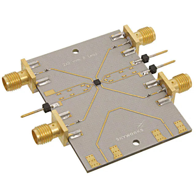

    EVAL BOARD FOR SKY13309
SKY13309-370LF-EVB 数据手册
DATA SHEET SKY13309-370LF: PHEMT GaAs IC SP3T Switch 0.1–3.0 GHz Features Simplified Block Diagram Positive low voltage control (0/3 V) ● Low insertion loss (0.5 dB at 2.5 GHz) ● High isolation (25 dB at 2.5 GHz) ● Excellent linearity performance (P 1 dB = 29 dBm) ● Miniature ultrathin MLP-8 pin plastic package (2 x 2 x 0.55 mm) ● Advanced PHEMT process ● Available lead (Pb)-free and RoHS-compliant MSL-1 @ 260 °C per JEDEC J-STD-020 ● RF3 V3 RFC RF2 V2 Description The SKY13309-370LF is a PHEMT GaAs IC SP3T antenna switch operating in the 0.1–3 GHz frequency range. Switching between the antenna and Tx/Rx ports is accomplished with 3 control voltages. The low loss, high isolation, high linearity, small size and low cost features make this switch ideal for all WLAN and Bluetooth® systems operating in the 2.4–2.5 GHz band. RF1 NEW V1 Skyworks offers lead (Pb)-free, RoHS (Restriction of Hazardous Substances)-compliant packaging. Electrical Specifications at 25 ºC, VHIGH = 2.1–5 V Condition Frequency Typ. Max. Unit Insertion loss Parameter RFC–RF1, RF2, RF3 0.1–3.0 GHz 2.4–2.5 GHz Min. 0.6 0.5 0.75 0.65 dB dB Return loss (Insertion loss state) RFC–RF1, RF2, RF3 0.1–3.0 GHz 2.4–2.5 GHz 20 20 dB dB Isolation RFC–RF1, RF2, RF3 0.1–3.0 GHz 2.4–2.5 GHz 22 22 25 25 dB dB Min. Typ. Operating Characteristics at 25 ºC Parameter Switching characteristics Rise/fall time On, off time Condition Frequency 10/90% or 90/10% RF 50% CTL to 90/10% RF Video feedthru Max. Unit 30 25 ns ns 40 mV Input power for 1 dB compression VLOW = 0 V, VHIGH = 3.3 V 2450 MHz 29 dBm Input third order intermodulation intercept For two-tone input power 17 dBm VLOW = 0 V, VHIGH = 2.1 V VLOW = 0 V, VHIGH = 3.3 V 2450 MHz 2450 MHz 37 45 dBm dBm Control voltages VLOW = 0 to 0.25 V @ 5 µA typ. VHIGH = 2.1 to 5.0 V @ 10 µA typ. 0 3.3 V V Skyworks Solutions, Inc. • Phone [781] 376-3000 • Fax [781] 376-3100 • sales@skyworksinc.com • www.skyworksinc.com 200721 Rev. G • Skyworks Proprietary Information • Products and Product Information are Subject to Change Without Notice. • June 12, 2008 1 DATA SHEET • SKY13309-370LF Typical Performance Data at 25° C (0, 3.3 V) RFC–RF1 State (Data Shown on 3 Units) 0 0 -0.1 -10 -0.3 Isolation (dB) Insertion Loss (dB) -0.2 -0.4 -0.5 -0.6 -0.7 -0.8 -20 -30 -40 -50 -0.9 -1.0 -60 0.5 1.0 1.5 2.0 2.5 3.0 0 1.0 1.5 2.0 Frequency (GHz) RFC to RF1 Insertion Loss RFC to RF3 Isolation 0 0 -10 -10 -20 -20 -30 -40 -50 3.0 2.5 3.0 2.5 3.0 -30 -40 -60 0 0.5 1.0 1.5 2.0 2.5 0 3.0 0.5 1.0 1.5 2.0 Frequency (GHz) Frequency (GHz) RFC to RF1 Return Loss RFC to RF2 Isolation 0 -10 -10 -20 -20 Isolation (dB) 0 -30 -40 -50 -30 -40 -50 -60 -60 0 0.5 1.0 1.5 2.0 2.5 3.0 0 0.5 1.0 1.5 2.0 Frequency (GHz) Frequency (GHz) RF1 to RF2 Isolation RF1 to RF3 Isolation Skyworks Solutions, Inc. • Phone [781] 376-3000 • Fax [781] 376-3100 • sales@skyworksinc.com • www.skyworksinc.com 2 2.5 -50 -60 Isolation (dB) 0.5 Frequency (GHz) Isolation (dB) Input/Output Return Loss (dB) 0 June 12, 2008 • Skyworks Proprietary Information • Products and Product Information are Subject to Change Without Notice. • 200721 Rev. G Typical Performance Data at 25° C (0, 3.3 V) RFC–RF2 State (Data Shown on 3 Units) 0 0 -0.1 -10 -0.3 Isolation (dB) Insertion Loss (dB) -0.2 -0.4 -0.5 -0.6 -0.7 -0.8 -20 -30 -40 -50 -0.9 -1.0 -60 0 0.5 1.0 1.5 2.0 2.5 3.0 0 0.5 1.0 1.5 2.0 Frequency (GHz) Frequency (GHz) RFC to RF2 Insertion Loss RFC to RF1 Isolation 2.5 3.0 DATA SHEET • SKY13309-370LF Typical Performance Data at 25° C (0, 3.3 V) RFC–RF3 State (Data Shown on 3 Units) 0 0 -0.1 -10 -0.3 Isolation (dB) Insertion Loss (dB) -0.2 -0.4 -0.5 -0.6 -0.7 -0.8 -20 -30 -40 -50 -0.9 -1.0 -60 0.5 1.0 1.5 2.0 2.5 3.0 0 1.0 1.5 2.0 Frequency (GHz) RFC to RF3 Insertion Loss RFC to RF1 Isolation 0 0 -10 -10 -20 -20 -30 -40 -50 3.0 2.5 3.0 2.5 3.0 -30 -40 -60 0 0.5 1.0 1.5 2.0 2.5 3.0 0 0.5 1.0 1.5 2.0 Frequency (GHz) Frequency (GHz) RFC to RF3 Return Loss RFC to RF2 Isolation 0 -10 -10 -20 -20 Isolation (dB) 0 -30 -40 -30 -40 -50 -50 -60 -60 0 0.5 1.0 1.5 2.0 2.5 3.0 0 0.5 1.0 1.5 2.0 Frequency (GHz) Frequency (GHz) RF3 to RF1 Isolation RF3 to RF2 Isolation Skyworks Solutions, Inc. • Phone [781] 376-3000 • Fax [781] 376-3100 • sales@skyworksinc.com • www.skyworksinc.com 4 2.5 -50 -60 Isolation (dB) 0.5 Frequency (GHz) Isolation (dB) Input/Output Return Loss (dB) 0 June 12, 2008 • Skyworks Proprietary Information • Products and Product Information are Subject to Change Without Notice. • 200721 Rev. G DATA SHEET • SKY13309-370LF Truth Table Absolute Maximum Ratings Low Insertion Loss Path V1 V2 V3 RFC–RF1 RFC–RF2 High Low Low Max input power @ 0/3V 30 dBm Low High Low Max input power @ 0/5V RFC–RF3 32 dBm Low Low High Operating voltage High = 2.1 to 5 V. Low = 0 to 0.25 V. All other states not recommended. If a non-recommended state occurs, no damage to the switch will occur but it will be placed into an undefined state Characteristic Value +8.0 V Operating temperature -40 °C to +85 °C Storage temperature -65 °C to +150 °C Performance is guaranteed only under the conditions listed in the specifications table and is not guaranteed under the full range(s) described by the Absolute Maximum specifications. Exceeding any of the absolute maximum/minimum specifications may result in permanent damage to the device and will void the warranty. Recommended Solder Reflow Profiles Refer to the “Recommended Solder Reflow Profile” Application Note. Tape and Reel Information Refer to the “Discrete Devices and IC Switch/Attenuators Tape and Reel Package Orientation” Application Note. CAUTION: Although this device is designed to be as robust as possible, ESD (Electrostatic Discharge) can damage this device. This device must be protected at all times from ESD. Static charges may easily produce potentials of several kilovolts on the human body or equipment, which can discharge without detection. Industry-standard ESD precautions must be employed at all times. Pin Out (Top View) RFC CBL 1 8 CBL RF3 -370 0.20 Ref. Seating Plane N/C 2 V3 7 2 V1 RF1 CBL 3 6 4 5 V2 CBL 0.02 + 0.03 0.02 - 0.02 Pin 1 Indicator 2 RF2 CBL = 47 pF for operation > 500 MHz. CBL = 220 pF for operation down to 50 MHz. Higher values recommended for lower frequency operation. Exposed paddle must be grounded. 0.6 Max. 0.90 + 0.10 0.90 - 0.15 0.45 + 0.05 0.45 - 0.07 Land Pattern Exposed Pad R 0.20 R0.20 8X 0.70 8X 0.45 0.85 + 0.05 0.85 - 0.07 Detail B Pin 1 8X 0.25 1.70 + 0.10 1.70 - 0.15 Detail A Detail C R0.12 Typ. 0.50 Pitch 0.25 2X 0.85 0.30 ± 0.010 CL 2X 0.45 Exposed Soldering Area Typ. 0.25 0.5 0.2 + 0.055 0.2 - 0.070 Detail C Detail B Skyworks Solutions, Inc. • Phone [781] 376-3000 • Fax [781] 376-3100 • sales@skyworksinc.com • www.skyworksinc.com 200721 Rev. G • Skyworks Proprietary Information • Products and Product Information are Subject to Change Without Notice. • June 12, 2008 5 DATA SHEET • SKY13309-370LF Part Marking Evaluation Board Pin 1 Indicator Skyworks P/N RF3 V1 (Tx) RF1 RF2 V1 (Tx) V2 (Rx) V2 (Rx) V3 (BT) V3 (BT) GND Rev 2 WLAN SP3T Apps S09 RFC GND GND GND Skyworks Skyworks Solutions, Inc. • Phone [781] 376-3000 • Fax [781] 376-3100 • sales@skyworksinc.com • www.skyworksinc.com 6 June 12, 2008 • Skyworks Proprietary Information • Products and Product Information are Subject to Change Without Notice. • 200721 Rev. G DATA SHEET • SKY13309-370LF Copyright © 2007, 2008, Skyworks Solutions, Inc. All Rights Reserved. Information in this document is provided in connection with Skyworks Solutions, Inc. (“Skyworks”) products or services. These materials, including the information contained herein, are provided by Skyworks as a service to its customers and may be used for informational purposes only by the customer. Skyworks assumes no responsibility for errors or omissions in these materials or the information contained herein. Skyworks may change its documentation, products, services, specifications or product descriptions at any time, without notice. Skyworks makes no commitment to update the materials or information and shall have no responsibility whatsoever for conflicts, incompatibilities, or other difficulties arising from any future changes. No license, whether express, implied, by estoppel or otherwise, is granted to any intellectual property rights by this document. Skyworks assumes no liability for any materials, products or information provided hereunder, including the sale, distribution, reproduction or use of Skyworks products, information or materials, except as may be provided in Skyworks Terms and Conditions of Sale. THE MATERIALS, PRODUCTS AND INFORMATION ARE PROVIDED “AS IS” WITHOUT WARRANTY OF ANY KIND, WHETHER EXPRESS, IMPLIED, STATUTORY, OR OTHERWISE, INCLUDING FITNESS FOR A PARTICULAR PURPOSE OR USE, MERCHANTABILITY, PERFORMANCE, QUALITY OR NON-INFRINGEMENT OF ANY INTELLECTUAL PROPERTY RIGHT; ALL SUCH WARRANTIES ARE HEREBY EXPRESSLY DISCLAIMED. SKYWORKS DOES NOT WARRANT THE ACCURACY OR COMPLETENESS OF THE INFORMATION, TEXT, GRAPHICS OR OTHER ITEMS CONTAINED WITHIN THESE MATERIALS. SKYWORKS SHALL NOT BE LIABLE FOR ANY DAMAGES, INCLUDING BUT NOT LIMITED TO ANY SPECIAL, INDIRECT, INCIDENTAL, STATUTORY, OR CONSEQUENTIAL DAMAGES, INCLUDING WITHOUT LIMITATION, LOST REVENUES OR LOST PROFITS THAT MAY RESULT FROM THE USE OF THE MATERIALS OR INFORMATION, WHETHER OR NOT THE RECIPIENT OF MATERIALS HAS BEEN ADVISED OF THE POSSIBILITY OF SUCH DAMAGE. Skyworks products are not intended for use in medical, lifesaving or life-sustaining applications, or other equipment in which the failure of the Skyworks products could lead to personal injury, death, physical or environmental damage. Skyworks customers using or selling Skyworks products for use in such applications do so at their own risk and agree to fully indemnify Skyworks for any damages resulting from such improper use or sale. Customers are responsible for their products and applications using Skyworks products, which may deviate from published specifications as a result of design defects, errors, or operation of products outside of published parameters or design specifications. Customers should include design and operating safeguards to minimize these and other risks. Skyworks assumes no liability for applications assistance, customer product design, or damage to any equipment resulting from the use of Skyworks products outside of stated published specifications or parameters. Skyworks, the Skyworks symbol, and “Breakthrough Simplicity” are trademarks or registered trademarks of Skyworks Solutions, Inc., in the United States and other countries. Third-party brands and names are for identification purposes only, and are the property of their respective owners. Additional information, including relevant terms and conditions, posted at www.skyworksinc.com, are incorporated by reference. Skyworks Solutions, Inc. • Phone [781] 376-3000 • Fax [781] 376-3100 • sales@skyworksinc.com • www.skyworksinc.com 200721 Rev. G • Skyworks Proprietary Information • Products and Product Information are Subject to Change Without Notice. • June 12, 2008 7
