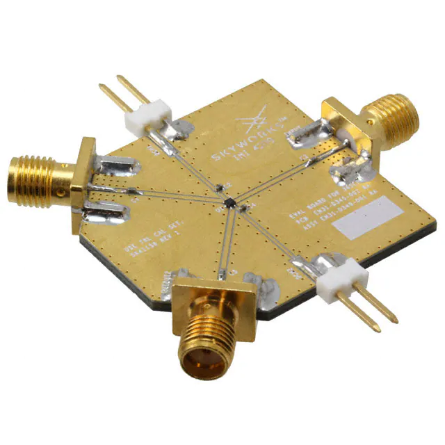

    EVAL BOARD FOR SKY13350
SKY13350-385LF-EVB 数据手册
DATA SHEET SKY13350-385LF: 0.01 to 6.0 GHz GaAs SPDT Switch Applications  WLAN 802.11 a/b/g networks  WLAN repeaters  ISM band radios  Low power transmit receive systems INPUT OUTPUT2 OUTPUT1 Features  Positive voltage control (0/1.6 V to 0/5.0 V)  Broadband frequency range: 0.01 to 6.0 GHz  Very low insertion loss: 0.35 dB typical @ 3 GHz  High isolation, 25 dB typical @ 3 GHz  Excellent linearity performance, IP0.5dB = +30 dBm with control voltage = 3 V  Ultra-miniature, MLPD (6-pin, 1 x 1 mm) package (MSL1, 260 C per JEDEC J-STD-020) Skyworks GreenTM products are compliant with all applicable legislation and are halogen-free. For additional information, refer to Skyworks Definition of GreenTM, document number SQ04–0074. 201174-001 VCTL1 VCTL2 Figure 1. SKY13350-385LF Block Diagram Description The SKY13350-385LF is a GaAs pHEMT FET single-pole, doublethrow (SPDT) switch. The switch can be used in transmit/receive applications by connecting the RF common port (INPUT, pin 6) to either the OUTPUT1 or OUTPUT2 port (pin 2 or 4, respectively) using a low loss path (i.e., a positive voltage applied to either VCTL1 or VCTL2 pins). The switch is “reflective short” on the isolated port. The switch is manufactured in a compact, 1 x 1 mm, 6-pin exposed pad plastic Micro Leadframe Package Dual (MLPD) package. INPUT A functional block diagram is shown in Figure 1. The pin configuration and package are shown in Figure 2. Signal pin assignments and functional pin descriptions are provided in Table 1. 6 VCTL1 1 3 VCTL2 4 OUTPUT2 GND OUTPUT1 2 5 Figure 2. SKY13350-385LF Pinout (Top View) Skyworks Solutions, Inc. • Phone [781] 376-3000 • Fax [781] 376-3100 • sales@skyworksinc.com • www.skyworksinc.com 201174H • Skyworks Proprietary Information • Products and Product Information are Subject to Change Without Notice • September 8, 2017 1 DATA SHEET • SKY13350-385LF: 0.01 TO 6.0 GHz GaAS SPDT SWITCH Table 1. SKY13350-385LF Signal Descriptions Pin Name Description Pin Name Description 1 VCTL1 DC control voltage 4 OUTPUT2 RF port. Must be DC blocked. 2 OUTPUT1 RF port. Must be DC blocked. 5 VCTL2 DC control voltage 3 GND Ground 6 INPUT RF port. Must be DC blocked Electrical and Mechanical Specifications The absolute maximum ratings of the SKY13350-385LF are provided in Table 2. The recommended operating conditions are specified in Table 3 and electrical specifications are provided in Table 4. Typical performance characteristics of the SKY13350-385LF are illustrated in Figures 3 through 9. The state of the SKY13350-385LF is determined by the logic provided in Table 5. Table 2. SKY13350-385LF Absolute Maximum Ratings Parameter Symbol Input power >500 MHz, 5 V >500 MHz, 3 V PIN Storage temperature TSTG Operating temperature TOP Minimum Maximum Units +32 +31 dBm dBm –65 +150 C –40 +105 C ESD HANDLING: Although this device is designed to be as robust as possible, electrostatic discharge (ESD) can damage this device. This device must be protected at all times from ESD when handling or transporting. Static charges may easily produce potentials of several kilovolts on the human body or equipment, which can discharge without detection. Industry-standard ESD handling precautions should be used at all times. Table 3. SKY13350-385LF Recommended Operating Conditions Parameter Symbol Min Typ Max Units Frequency f 0.01 6.0 GHz Control voltage: low high VCTL_L VCTL_H 0 1.6 0.2 5.0 V V Operating temperature TOP +25 Skyworks Solutions, Inc. • Phone [781] 376-3000 • Fax [781] 376-3100 • sales@skyworksinc.com • www.skyworksinc.com 2 September 8, 2017 • Skyworks Proprietary Information • Products and Product Information are Subject to Change Without Notice • 201174H C DATA SHEET • SKY13350-385LF: 0.01 TO 6.0 GHz GaAS SPDT SWITCH Table 4. SKY13350-385LF Electrical Specifications1 (VCTL = 0 V and +2.7 V, TOP = +25 C, PIN = 0 dBm, Characteristic Impedance [ZO] = 50 Ω, Unless Otherwise Noted) Parameter Symbol Test Condition Insertion loss 0.01 to 3.0 GHz 3.0 to 6.0 GHz Isolation 0.01 to 3.0 GHz 3.0 to 6.0 GHz Return loss (insertion loss state) Switching characteristics: Rise/fall time On/off time Min 18 17 Input IP3 IP0.5dB IIP3 Error vector magnitude EVM Control voltage: Low High VCTL_L VCTL_H Supply current ICC Max Units 0.35 0.60 0.50 0.80 dB dB 20 18 dB dB 0.01 to 3.0 GHz 3.0 to 6.0 GHz 21 18 dB dB 10/90% or 90/10% RF 50% VCTL to 90/10% RF 45 45 ns ns Video feedthrough 0.5 dB input compression point Typ 25 mV f = 2.45 GHz: VCTL = 1.8 V VCTL = 2.7 V +25 +30 dBm dBm f = 5.8 GHz: VCTL = 1.8 V VCTL = 2.7 V +25 +30 dBm dBm f = 2.45 GHz: VCTL = 1.8 V VCTL = 2.7 V +32 +50 dBm dBm f = 5.8 GHz: VCTL = 1.8 V VCTL = 2.7 V +30 +46 dBm dBm 802.11a, 54 Mbps, PIN =
