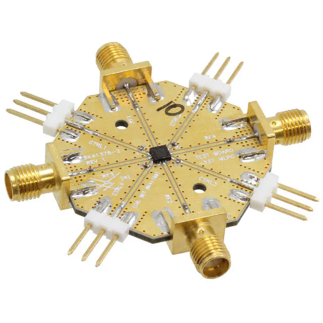

    EVAL BOARD FOR SKY13353
SKY13353-337LF-EVB 数据手册
DATA SHEET SKY13353-337LF: 0.5 – 3.0 GHz DPDT Diversity Switch Applications RF1  802.11 a/n diversity WLANs CTRL1 Features CTRL2 RF3  Broadband operation: 0.5 to 3.0 GHz  Positive voltage operation: +1.8 to +5 V  Low insertion loss: 0.7 dB typical @ 2.5 GHz  High isolation: 22 dB typical @ 2.4 GHz  IP1dB: +32 dBm typical @ +3 V RF4 CTRL4 CTRL3 RF2 S2146 Figure 1. SKY13353-337LF Block Diagram  Small, QFN (12-pin, 3 x 3 mm) package (MSL1, 260 C per JEDEC J-STD-020) Description RF1 12 11 The device provides high linearity, low insertion loss, and high isolation. Switching is controlled by four control voltage inputs (CTRL1, CTRL2, CTRL3, and CTRL4). Depending on the logic voltage level applied to the control pins, the four RF ports (RF1, RF2, RF3, and RF4) are connected together using a low insertion loss path, while maintaining a high isolation path to the alternate ports. Series DC blocking capacitors are required on all RF ports for proper operation. N/C N/C The SKY13353-337LF is a GaAs pHEMT Double-Pole, DoubleThrow (DPDT) switch designed for 0.5 to 3.0 GHz diversity WLAN applications that use two antennas for both transmit and receive paths. 10 RF3 2 8 RF4 CTRL4 3 7 CTRL3 4 5 6 N/C CTRL2 CTRL1 RF2 9 N/C 1 The SKY13353-337LF is provided in a 3 x 3 mm, 12-pin Quad Flat No-Lead (QFN) package. A functional block diagram is shown in Figure 1. The pin configuration and package are shown in Figure 2. Signal pin assignments and functional pin descriptions are provided in Table 1. S2145 Figure 2. SKY13353-337LF Pinout – 12-Pin QFN (Top View) Skyworks Solutions, Inc. • Phone [781] 376-3000 • Fax [781] 376-3100 • sales@skyworksinc.com • www.skyworksinc.com 201376A • Skyworks Proprietary Information • Products and Product Information are Subject to Change Without Notice • October 12, 2010 1 DATA SHEET • SKY13353-337LF DPDT DIVERSITY SWITCH Table 1. SKY13353-337LF Signal Descriptions Pin # 1 Note: Name CTRL1 Description Pin # Name DC control voltage 1 7 CTRL3 Description DC control voltage 3 2 RF3 RF port 3. DC blocking capacitors required. 8 RF4 RF port 4. DC blocking capacitors required. 3 CTRL4 DC control voltage 4 9 CTRL2 DC control voltage 2 4 N/C No connection required. May be connected to ground with no change in performance. 10 N/C No connection required. May be connected to ground with no change in performance. 5 RF2 RF port 2. DC blocking capacitors required. 11 RF1 RF port 1. DC blocking capacitors required. 6 N/C No connection required. May be connected to ground with no change in performance. 12 N/C No connection required. May be connected to ground with no change in performance. Exposed pad must be grounded through a low impedance path. Table 2. SKY13353-337LF Absolute Maximum Ratings Parameter Symbol Minimum Control voltage CTRL1, CTRL2, CTRL3, CTRL4 RF input power PIN Operating temperature TOP –40 Storage temperature TSTG –40 Note: Maximum Units +6 V +34 dBm +85 C +125 C Exposure to maximum rating conditions for extended periods may reduce device reliability. There is no damage to device with only one parameter set at the limit and all other parameters set at or below their nominal value. Exceeding any of the limits listed here may result in permanent damage to the device. CAUTION: Although this device is designed to be as robust as possible, Electrostatic Discharge (ESD) can damage this device. This device must be protected at all times from ESD. Static charges may easily produce potentials of several kilovolts on the human body or equipment, which can discharge without detection. Industry-standard ESD precautions should be used at all times. Electrical and Mechanical Specifications The absolute maximum ratings of the SKY13353-337LF are provided in Table 2. Electrical specifications are provided in Table 3. The state of the SKY13353-337LF is determined by the logic provided in Table 4. Typical performance characteristics are illustrated in Figures 3, 4, and 5. Skyworks Solutions, Inc. • Phone [781] 376-3000 • Fax [781] 376-3100 • sales@skyworksinc.com • www.skyworksinc.com 2 October 12, 2010 • Skyworks Proprietary Information • Products and Product Information are Subject to Change Without Notice • 201376A DATA SHEET • SKY13353-337LF DPDT DIVERSITY SWITCH Table 3. SKY13353-337LF Electrical Specifications (Note 1) (CTRL1 = CTRL2 = CTRL3 = CTRL4 = 3/0 V, TOP = +25 C, PIN = 0 dBm, Characteristic Impedance [ZO] = 50 Ω, Unless Otherwise Noted) Parameter Symbol Test Condition Min Typical Max Units 0.5 0.6 0.7 0.8 1.2 1.2 1.2 1.2 dB dB dB dB RF Specifications Insertion loss IL 0.5 to 1.0 GHz 1.0 to 2.0 GHz 2.0 to 2.5 GHz 2.5 to 3.0 GHz Isolation Iso 0.5 to 1.0 GHz 1.0 to 2.0 GHz 2.0 to 2.5 GHz 2.5 to 3.0 GHz Return loss |S11| 0.5 GHz to 3.0 GHz 1 dB Input Compression Point IP1dB @ 2.4 GHz 28 21 19 18 dB dB dB dB 20 dB +32 +36 dBm dBm CTRL1/2/3/4 = 2.3 V CTRL1/2/3/4 = 3.0 V +52 +52 dBm dBm 17 17 17 17 CTRL1/2/3/4 = 2.3 V CTRL1/2/3/4 = 5.0 V 3rd Order Input Intercept Point IIP3 @ 2.45 GHz, Δf = 5 MHz, PIN = +5 dBm/tone Second harmonic 2fo @ 2.4 GHz, PIN = +20 dBm, CTRL1/2/3/4 = 2.5 V +70 dBc Third harmonic 3fo @ 2.4 GHz, PIN = +20 dBm, CTRL1/2/3/4 = 2.5 V +85 dBc 50% control voltage to 90% RF 15 ns 50% control voltage to 10% RF 35 ns Switching speed DC Specifications Control voltage: High Low VHIGH VLOW Control current ICC 1.8 –0.2 3.0 0 5.0 +0.2 V V 5 50 μA Note 1: Performance is guaranteed only under the conditions listed in this Table. Skyworks Solutions, Inc. • Phone [781] 376-3000 • Fax [781] 376-3100 • sales@skyworksinc.com • www.skyworksinc.com 201376A • Skyworks Proprietary Information • Products and Product Information are Subject to Change Without Notice • October 12, 2010 3 DATA SHEET • SKY13353-337LF DPDT DIVERSITY SWITCH Table 4. SKY13353-337LF Truth Table Insertion Loss State CTRL1 CTRL2 CTRL3 CTRL4 RF1 to RF3 1 0 0 0 RF1 to RF4 0 1 0 0 RF2 to RF4 0 0 1 0 RF2 to RF3 0 0 0 1 RF1 to RF3 and RF2 to RF4 1 0 1 0 RF1 to RF4 and RF2 to RF3 0 1 0 1 Note: “1” = +1.8 to +5.0 V “0” = –0.2 to +0.2 V Any other state than described in this Table places the switch into an undefined state. An undefined state will not damage the device. Typical Performance Characteristics (CTRL1 = CTRL2 = CTRL3 = CTRL4 = 3/0 V, TOP = +25 C, PIN = 0 dBm, Characteristic Impedance [Zo] = 50 Ω, Unless Otherwise Noted) 0 0 –0.1 –40 °C +25 °C +85 °C –10 –0.3 Isolation (dB) Insertion Loss (dB) –0.2 –0.4 –0.5 –0.6 –0.7 –0.8 –20 –30 –40 °C +25 °C +85 °C –40 –0.9 –1.0 0.5 1.0 1.5 2.0 2.5 3.0 –50 0.5 1.0 1.5 2.0 Figure 3. Insertion Loss vs Frequency Over Temperature Figure 4. Isolation vs Frequency Over Temperature 0 Return Loss (dB) –5 –40 °C +25 °C +85 °C –10 –15 –20 –25 –30 –35 0.5 1.0 1.5 2.0 2.5 3.0 Frequency (GHz) Figure 5. Return Loss vs Frequency Over Temperature Skyworks Solutions, Inc. • Phone [781] 376-3000 • Fax [781] 376-3100 • sales@skyworksinc.com • www.skyworksinc.com 4 2.5 Frequency (GHz) Frequency (GHz) October 12, 2010 • Skyworks Proprietary Information • Products and Product Information are Subject to Change Without Notice • 201376A 3.0 DATA SHEET • SKY13353-337LF DPDT DIVERSITY SWITCH Evaluation Board Description Package and Handling Information The SKY13353-337LF Evaluation Board is used to test the performance of the SKY13353-337LF DPDT switch. An Evaluation Board schematic diagram is shown in Figure 6. An assembly drawing for the Evaluation Board is shown in Figure 7. Instructions on the shipping container label regarding exposure to moisture after the container seal is broken must be followed. Otherwise, problems related to moisture absorption may occur when the part is subjected to high temperature during solder assembly. The SKY13353-337LF is rated to Moisture Sensitivity Level 1 (MSL1) at 260 C. It can be used for lead or lead-free soldering. For additional information, refer to the Skyworks Application Note, Solder Reflow Information, document number 200164. Package Dimensions The PCB layout footprint for the SKY13353-337LF is shown in Figure 8. Typical case markings are noted in Figure 9. Package dimensions for the 12-pin QFN are shown in Figure 10, and tape and reel dimensions are provided in Figure 11. Care must be taken when attaching this product, whether it is done manually or in a production solder reflow environment. Production quantities of this product are shipped in a standard tape and reel format. × CTRL1 RF3 RF4 CTRL4 CTRL3 N/C 3 CTRL2 4 × 5 9 DC Control Voltage 2 8 7 RF Port 4 DC Control Voltage 3 N/C 2 RF Port 3 DC Control Voltage 4 N/C 1 RF2 DC Control Voltage 1 10 RF1 11 N/C 12 RF Port 1 × 6 × RF Port 2 S2147 Figure 6. SKY13353-337LF Evaluation Board Schematic Diagram Skyworks Solutions, Inc. • Phone [781] 376-3000 • Fax [781] 376-3100 • sales@skyworksinc.com • www.skyworksinc.com 201376A • Skyworks Proprietary Information • Products and Product Information are Subject to Change Without Notice • October 12, 2010 5 DATA SHEET • SKY13353-337LF DPDT DIVERSITY SWITCH RF1 CTRL1 CTRL2 RF3 RF4 CTRL4 CTRL3 RF2 47 pF on 4 RF traces S2154 Figure 7. SKY13353-337LF Evaluation Board Assembly Diagram Skyworks Solutions, Inc. • Phone [781] 376-3000 • Fax [781] 376-3100 • sales@skyworksinc.com • www.skyworksinc.com 6 October 12, 2010 • Skyworks Proprietary Information • Products and Product Information are Subject to Change Without Notice • 201376A DATA SHEET • SKY13353-337LF DPDT DIVERSITY SWITCH 12X 0.95 (To Metal Pads) 1.15 (Sq.) Solder Area Pitch 0.50 4X Ground Vias See Detail A 0.25 Solder Area 0.75 All measurements in millimeters Detail A 12X Scale = 48X S1855 Figure 8. SKY13353-337LF PCB Layout Footprint Pin 1 Indicator Skyworks Part # Lot # Date Code: (YY = Calendar Year WW = Week) Figure 9. Typical Part Markings (Top View) Skyworks Solutions, Inc. • Phone [781] 376-3000 • Fax [781] 376-3100 • sales@skyworksinc.com • www.skyworksinc.com 201376A • Skyworks Proprietary Information • Products and Product Information are Subject to Change Without Notice • October 12, 2010 7 DATA SHEET • SKY13353-337LF DPDT DIVERSITY SWITCH 1.150 +0.10/–0.15 C (0.20) Seating Plane 0.02 + 0.03/–0.02 A 3 B Pin 1 Indicator 1.000 0.575 Exposed Pad Detail A 0.575 3 1.000 1.150 +0.10/–0.15 B 0.15 C 2X Detail C 0.90 ± 0.10 2X 0.10 C Top View 0.20 Min. 12X 12X 4 0.08 C 0.15 C Side View A Detail B Bottom View R0.125 Typ. 0.18 0.55 +0.10 0.18 0.435 5 0.10 M C A B 0.435 0.5 0.25 +0.05/–0.07 0.05 M C Detail A Detail B Detail C Scale: 20X Scale: 20X Scale: 40X 12 Places All measurements are in millimeters. Dimensioning and tolerancing according to ASME Y14.5M-1994. Unilateral coplanarity applies to the exposed heat sink slug as well as the terminals. Plating requirement per source control drawing (SCD) 2504. Dimension applies to metallized terminal and is measured between 0.15 and 0.30 mm from the terminal tip. Do not measure at radius area. Figure 10. SKY13353-337LF 12-Pin QFN Package Dimensions Skyworks Solutions, Inc. • Phone [781] 376-3000 • Fax [781] 376-3100 • sales@skyworksinc.com • www.skyworksinc.com 8 October 12, 2010 • Skyworks Proprietary Information • Products and Product Information are Subject to Change Without Notice • 201376A S1866 DATA SHEET • SKY13353-337LF DPDT DIVERSITY SWITCH 4.00 ± 0.10 Pin #1 2.00 ± 0.05 1.75 ± 0.10 A 5.50 ± 0.05 3.30 ± 0.10 (Bo) B A 12.00 ± 0.30 0.30 ± 0.05 (T) ∅1.50 + 0.1/–0.0 8.00 ± 0.10 B 1.10 ± 0.10 (Ko) B R0.25 Typ. ∅1.50 Min. 3.30 ± 0.10 (Ao) A Notes: 1. Carrier tape: black conductive polystyrene, non-bakeable material. 2. Cover tape material: transparent conductive HSA. 3. Cover tape size: 9.20 mm width. 4. All measurements are in millimeters. S1698 Figure 11. SKY13353-337LF Tape and Reel Dimensions Skyworks Solutions, Inc. • Phone [781] 376-3000 • Fax [781] 376-3100 • sales@skyworksinc.com • www.skyworksinc.com 201376A • Skyworks Proprietary Information • Products and Product Information are Subject to Change Without Notice • October 12, 2010 9 DATA SHEET • SKY13353-337LF DPDT DIVERSITY SWITCH Ordering Information Model Name SKY13353-337LF 0.5-3.0 GHz DPDT Diversity Switch Manufacturing Part Number SKY13353-337LF Evaluation Board Part Numbers SKY13353-337LF-EVB Copyright © 2010 Skyworks Solutions, Inc. All Rights Reserved. Information in this document is provided in connection with Skyworks Solutions, Inc. (“Skyworks”) products or services. These materials, including the information contained herein, are provided by Skyworks as a service to its customers and may be used for informational purposes only by the customer. Skyworks assumes no responsibility for errors or omissions in these materials or the information contained herein. Skyworks may change its documentation, products, services, specifications or product descriptions at any time, without notice. Skyworks makes no commitment to update the materials or information and shall have no responsibility whatsoever for conflicts, incompatibilities, or other difficulties arising from any future changes. No license, whether express, implied, by estoppel or otherwise, is granted to any intellectual property rights by this document. Skyworks assumes no liability for any materials, products or information provided hereunder, including the sale, distribution, reproduction or use of Skyworks products, information or materials, except as may be provided in Skyworks Terms and Conditions of Sale. THE MATERIALS, PRODUCTS AND INFORMATION ARE PROVIDED “AS IS” WITHOUT WARRANTY OF ANY KIND, WHETHER EXPRESS, IMPLIED, STATUTORY, OR OTHERWISE, INCLUDING FITNESS FOR A PARTICULAR PURPOSE OR USE, MERCHANTABILITY, PERFORMANCE, QUALITY OR NON-INFRINGEMENT OF ANY INTELLECTUAL PROPERTY RIGHT; ALL SUCH WARRANTIES ARE HEREBY EXPRESSLY DISCLAIMED. SKYWORKS DOES NOT WARRANT THE ACCURACY OR COMPLETENESS OF THE INFORMATION, TEXT, GRAPHICS OR OTHER ITEMS CONTAINED WITHIN THESE MATERIALS. SKYWORKS SHALL NOT BE LIABLE FOR ANY DAMAGES, INCLUDING BUT NOT LIMITED TO ANY SPECIAL, INDIRECT, INCIDENTAL, STATUTORY, OR CONSEQUENTIAL DAMAGES, INCLUDING WITHOUT LIMITATION, LOST REVENUES OR LOST PROFITS THAT MAY RESULT FROM THE USE OF THE MATERIALS OR INFORMATION, WHETHER OR NOT THE RECIPIENT OF MATERIALS HAS BEEN ADVISED OF THE POSSIBILITY OF SUCH DAMAGE. Skyworks products are not intended for use in medical, lifesaving or life-sustaining applications, or other equipment in which the failure of the Skyworks products could lead to personal injury, death, physical or environmental damage. Skyworks customers using or selling Skyworks products for use in such applications do so at their own risk and agree to fully indemnify Skyworks for any damages resulting from such improper use or sale. Customers are responsible for their products and applications using Skyworks products, which may deviate from published specifications as a result of design defects, errors, or operation of products outside of published parameters or design specifications. Customers should include design and operating safeguards to minimize these and other risks. Skyworks assumes no liability for applications assistance, customer product design, or damage to any equipment resulting from the use of Skyworks products outside of stated published specifications or parameters. Skyworks, the Skyworks symbol, and “Breakthrough Simplicity” are trademarks or registered trademarks of Skyworks Solutions, Inc., in the United States and other countries. Third-party brands and names are for identification purposes only, and are the property of their respective owners. Additional information, including relevant terms and conditions, posted at www.skyworksinc.com, are incorporated by reference. Skyworks Solutions, Inc. • Phone [781] 376-3000 • Fax [781] 376-3100 • sales@skyworksinc.com • www.skyworksinc.com 10 October 12, 2010 • Skyworks Proprietary Information • Products and Product Information are Subject to Change Without Notice • 201376A
