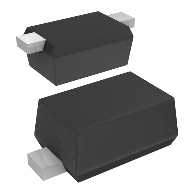

DATA SHEET SMP1302 Series: Switch and Attenuator Plastic Packaged PIN Diodes Applications  TV distribution and cellular base stations  High volume switch and attenuators Features  Designed for base station and handset applications  Low-distortion design  Available in tape and reel packaging  Packages rated MSL1 @ 260 C per JEDEC J-STD-020 Skyworks GreenTM products are compliant with all applicable legislation and are halogen-free. For additional information, refer to Skyworks Definition of GreenTM, document number SQ04–0074. Description The SMP1302 series of plastic packaged, surface mountable, low capacitance (0.3 pF) silicon PIN diodes is designed for highvolume switch and attenuator applications from 10 MHz to beyond 10 GHz. These diodes are designed for use in low-distortion TEE attenuators with low drive current (maximum resistance at 1 mA is 10 Ω) commonly used in TV distribution and cellular base station applications. The nominal 50 μm I region width, combined with a maximum resistance of 3 Ω at 10 mA, makes these diodes useful in large signal switch applications. The SMP1302 series provides single, dual, and quad diodes in a selection of plastic packages including SOT-23, SOD-323, SC-79, SC-88, and a small footprint SOD-882. Table 1 describes the various packages and marking of the SMP1302 series. Skyworks Solutions, Inc. • Phone [781] 376-3000 • Fax [781] 376-3100 • sales@skyworksinc.com • www.skyworksinc.com 200043Z • Skyworks Proprietary Information • Products and Product Information are Subject to Change Without Notice • November 15, 2017 1 DATA SHEET • SMP1302 SERIES PIN DIODES Table 1. SMP1302 Series Packaging and Marking Single Common Anode Reverse Series Pair Single Single Quad Common Cathode Single SOT-23 SOT-23 SOT-23 SOD-323 Green™ SC-79 Green™ SC-88 SOD-882 Green™ SMP1302-078LF Marking: XIX SMP1302-040LF Marking: W LS = 1.4 nH LS = 0.45 nH SMP1302-001LF Green™ Marking: RF1 SMP1302-003LF Green™ Marking:RF9 SMP1302-006LF Green™ Marking: RF8 SMP1302-011LF Marking: RF ♦SMP1302079LF Marking: Cathode and C3 LS = 1.5 nH LS = 1.5 nH LS = 1.5 nH LS = 1.5 nH LS = 0.7 nH SMP1302-078LF Pinout Table 2 provides the signal pin assignments for the 6-pin SC-88 quad common cathode package. Electrical and Mechanical Specifications Table 4. Resistance versus temperature measurements are provided in Table 5. Typical performance characteristics of the SMP1302 series are illustrated in Figures 1 to 4. Package dimensions are shown in Figures 5 to 13 (odd numbers), and tape and reel dimensions are provided in Figures 6 to 14 (even numbers). The absolute maximum ratings of the SMP1302 series are provided in Table 3. Electrical specifications are provided in Skyworks Solutions, Inc. • Phone [781] 376-3000 • Fax [781] 376-3100 • sales@skyworksinc.com • www.skyworksinc.com 2 November 15, 2017 • Skyworks Proprietary Information • Products and Product Information are Subject to Change Without Notice • 200043Z DATA SHEET • SMP1302 SERIES PIN DIODES Table 2. SMP1302-078LF Pin Signals Pin Name Pin Name 1 Anode 1 4 Anode 3 2 Common cathode 5 Common cathode 3 Anode 2 6 Anode 4 Table 3. SMP1302 Series Absolute Maximum Ratings1 Parameter Symbol Minimum Maximum Units Reverse voltage VR 200 V Power dissipation @ 25 °C lead temperature PD 250 mW Storage temperature TSTG -65 +150 C Operating temperature TA -65 +150 C Electrostatic discharge: ESD 1000 2000 V Human Body Model (HBM), Class 1C 1 Exposure to maximum rating conditions for extended periods may reduce device reliability. There is no damage to device with only one parameter set at the limit and all other parameters set at or below their nominal value. Exceeding any of the limits listed here may result in permanent damage to the device. ESD HANDLING: Although this device is designed to be as robust as possible, electrostatic discharge (ESD) can damage this device. This device must be protected at all times from ESD when handling or transporting. Static charges may easily produce potentials of several kilovolts on the human body or equipment, which can discharge without detection. Industry-standard ESD handling precautions should be used at all times. Table 4. SMP1302 Series Electrical Specifications1 (TA = +25 C, Unless Otherwise Noted) Parameter Symbol Test Condition Min Typ Max Units Reverse current IR VR = 200 V 10 μA Capacitance CT f = 1 MHz, V = 30 V 0.3 pF Resistance RS f = 100 MHz : 20 3 1.5 Ω Ω Ω I = 1 mA I = 10 mA I = 100 mA 15 Forward voltage VF IF = 10 mA 0.8 Carrier lifetime TI IF = 10 mA 0.7 μs 50 μm I region width V 1 Performance is guaranteed only under the conditions listed in this table.. Package and Handling Information Instructions on the shipping container label regarding exposure to moisture after the container seal is broken must be followed. Otherwise, problems related to moisture absorption may occur when the part is subjected to high temperature during solder assembly. The SMP1302 series is rated to Moisture Sensitivity Level 1 (MSL1) at 260 C. It can be used for lead or lead-free soldering. For additional information, refer to the Skyworks Application Note, Solder Reflow Information, document number 200164. Care must be taken when attaching this product, whether it is done manually or in a production solder reflow environment. Production quantities of this product are shipped in a standard tape and reel format. Skyworks Solutions, Inc. • Phone [781] 376-3000 • Fax [781] 376-3100 • sales@skyworksinc.com • www.skyworksinc.com 200043Z • Skyworks Proprietary Information • Products and Product Information are Subject to Change Without Notice • November 15, 2017 3 DATA SHEET • SMP1302 SERIES PIN DIODES Table 5. Resistance vs Temperature @ 100 MHz IF (mA) RS @ -55 °C (Ω) RS @ -15 °C (Ω) RS @ +25 °C (Ω) RS @ +65 °C (Ω) RS @ +100 °C (Ω) 0.02 599 653 692 715 722 0.10 123 135 143 154 161 0.3 42.2 46.6 49.7 54.3 56.8 1.0 13.5 15.0 16.2 17.9 18.8 10 2.0 2.3 2.6 2.9 3.0 20 1.34 1.50 1.70 2.00 2.00 100 0.60 0.74 1.00 1.10 1.10 Typical Performance Characteristics 100 100 10 1 0.1 0.01 0.1 1 10 1 0.1 200043-002 10 Forward Current (mA) 1000 200043-001 0.01 100 400 Forward Current (mA) 600 700 800 900 Figure 2. DC Characteristic 0.8 300 0.7 250 Conductance (μS) 1 MHz 0.6 0.5 0.4 0.3 1 GHz 100 MHz 200043-003 0.2 0.1 0 0 1 2 5 10 20 50 Reverse Voltage (V) Figure 3. Capacitance vs Reverse Voltage 100 200 0V 150 10 V 100 50 40 V 0 0 500 1000 1500 2000 Frequency (MHz) Figure 4. Conductance vs Frequency and Reverse Voltage Skyworks Solutions, Inc. • Phone [781] 376-3000 • Fax [781] 376-3100 • sales@skyworksinc.com • www.skyworksinc.com 4 1000 Forward Voltage (mV) Figure 1. Series Resistance vs Current @ 100 MHz Capacitance (pF) 500 200043-004 Series Resistance (Ω) (TA = +25 C, Unless Otherwise Noted) November 15, 2017 • Skyworks Proprietary Information • Products and Product Information are Subject to Change Without Notice • 200043Z DATA SHEET • SMP1302 SERIES PIN DIODES Box or Bar Polarity Indicator Area 0.006 (0.15 mm) Min 0.010 (0.25 mm) Min 0.014 (0.35 mm) Max 1 0.028 (0.70 mm) Min 0.035 (0.90 mm) Max 2 0.060 (1.50 mm) Min 0.067 (1.70 mm) Max 0.043 (1.10 mm) Min 0.051 (1.30 mm) Max 10° Max 0.020 (0.50 mm) Min 0.028 (0.70 mm) Max 0.003 (0.07 mm) Min 0.008 (0.20 mm) Max 10° Max Dimensions are in inches (millimeters shown in parentheses) 200043-007 Figure 5. SC-79 Package Dimension Drawing Ø1.50± 0.10 4.00 ± 0.10 4.00 ± 0.10 2.00 ± 0.05 0.229 ± 0.02 (T) 1.75 ± 0.10 B A B 8.00 ± 0.20 A 3.50 ± 0.05 1.40 ± 0.05 1.95 ± 0.05 (Bo) 2° Max Pin 1 Indicator 0.80 ± 0.05 (Ko) Ø0.50± 0.05 Section B 0.39 ± 0.05 Notes: 1. Carrier tape: black conductive polycarbonate or polystyrene. 2. Cover tape material: transparent conductive PSA. 3. Cover tape size: 5.4 mm width. 4. ESD-surface resistivity is ≤1 x 108 Ohms/square per EIA, JEDEC TNR Specification. 5. All measurements are in millimeters. 2o Max 0.90 ± 0.05 (Ao) Section A 200043-008 Figure 6. SC-79 Tape and Reel Dimensions Skyworks Solutions, Inc. • Phone [781] 376-3000 • Fax [781] 376-3100 • sales@skyworksinc.com • www.skyworksinc.com 200043Z • Skyworks Proprietary Information • Products and Product Information are Subject to Change Without Notice • November 15, 2017 5 DATA SHEET • SMP1302 SERIES PIN DIODES 0.079 (2.00 mm) ± 0.008 (0.20 mm) 0.0256 (0.65 mm) BSC 0.083 (2.10 mm) ± 0.012 (0.30 mm) 0.049 (1.25 mm) ± 0.004 (0.10 mm) 0.009 (0.23 mm) Ref 0.035 (0.90 mm) ± 0.004 (0.10 mm) 0.010 (0.25 mm) ± 0.006 (0.15 mm) 0.0055 (0.14 mm) ± 0.0015 (0.04 mm) 0.002 (0.005 mm) ± 0.002 (0.005 mm) 0.037 (0.95 mm) ± 0.006 (0.15 mm) 0.008 (0.20 mm) ± 0.004 (0.10 mm) Dimensions are in inches (millimeters shown in parentheses) 200043-009 Figure 7. SC-88 Package Dimension Drawing 4.00 ± 0.10 4.00 (Note 4) ∅1.50+ 0.10/–0.00 2.00 ± 0.05 1.75 ± 0.10 1.20 ± 0.10 (Ko) A Section B B Pin 1 R0.30 Typ ∅1.00 Min 0.30 ± 0.05 Notes: 1. 2. 3. 4. 5. 6. Carrier tape: black conductive polystyrene. Cover tape material: transparent conductive HSA. Cover tape size: 5.40 mm width. Ten sprocket hole pitch cumulative tolerance ±0.20 mm. All measurements are in millimeters. Standard reel size is 7 inches. Standard reel quantity is 3000 pcs. 2.25 ± 0.10 (Ao) Section A 200043-010 Figure 8. SC-88 Tape and Reel Dimensions Skyworks Solutions, Inc. • Phone [781] 376-3000 • Fax [781] 376-3100 • sales@skyworksinc.com • www.skyworksinc.com 6 November 15, 2017 • Skyworks Proprietary Information • Products and Product Information are Subject to Change Without Notice • 200043Z 8.00 +0.30/–0.10 A 3.50 ± 0.05 2.70 ± 0.10 (Bo) B DATA SHEET • SMP1302 SERIES PIN DIODES 0.060 (1.52 mm) Min 0.070 (1.78 mm) Max 0.090 (2.29 mm) Min 0.107 (2.72 mm) Max 0.044 (1.12 mm) Min 0.054 (1.37 mm) Max 1 0.000 (0 mm) Min 0.004 (0.10 mm) Max 0.013 (0.33 mm) Min 0.017 (0.43 mm) Max 2 0.012 (0.305 mm) Min 0.016 (0.406 mm) Max Cathode Indicator 0.036 (0.91 mm) Min 0.046 (1.17 mm) Max 0.008 Ref 0.025 (0.635 mm) Min 0.037 (0.940 mm) Max Gauge Datum For Foot Length Measurement 0.005 (0.127 mm) Min 0.008 (0.203 mm) Max 0.010 (0.25 mm) Min 0.018 (0.46 mm) Max Dimensions are in inches (millimeters shown in parentheses) 200043-011 Figure 9. SOD-323 Package Dimension Drawing 4.00 2.00 ± 0.05 Pin 1 Indicator Ø1.00 Min 4.00 (See Note 4) 1.75 ± 0.10 A R0.3 Max. 3.50 ± 0.05 2.90 (Bo) 2.08 1.35 (Ko) 8.00 +0.30/–0.10 0.30 ± 0.05 Ø1.50 +0.1/–0 A 1.52 (Ao) R0.5 Typ 1.07 (K1) Section A 0.84 Notes: 1. 2. 3. 4. 5. Carrier tape: black conductive polystyrene. Cover tape: transparent conductive PSA. Cover tape size: 5.4 mm width. 10 sprocket hole pitch cumulative tolerance: ±0.20 mm. All measurements are in millimeters. 200043-012 Figure 10. SOD-323 Tape and Reel Dimensions Skyworks Solutions, Inc. • Phone [781] 376-3000 • Fax [781] 376-3100 • sales@skyworksinc.com • www.skyworksinc.com 200043Z • Skyworks Proprietary Information • Products and Product Information are Subject to Change Without Notice • November 15, 2017 7 DATA SHEET • SMP1302 SERIES PIN DIODES 0.110 (2.80 mm) Min 0.120 (3.04 mm) Max 0.012 (0.30 mm) Min 0.020 (0.50 mm) Max 3 0.083 (2.10 mm) Min 0.104 (2.64 mm) Max 0.047 (1.20 mm) Min 0.055 (1.40 mm) Max 2 1 0.037 (0.95 mm) Ref 0.020 (0.51 mm) Ref 0.076 (1.92 mm) Ref 0.035 (0.89 mm) Min 0.044 (1.12 mm) Max 0.003 (0.080 mm) Min 0.008 (0.20 mm) Max 8° Max 0.0005 (0.01 mm) Min 0.004 (0.10 mm) Max 0.022 (0.55 mm) Ref Dimensions are in inches (millimeters shown in parentheses) 200043-013 Figure 11. SOT-23 Package Dimension Drawing 4.00 ø1.00 Min ø1.5 + 0.1/–0 4.00 (See Note 5) 1.75 ± 0.10 3.50 ± 0.05 A 2.70 (Bo) R 0.3 Max 2.2 1.20 (Ko) 0.8 ± 0.05 1.0 R 0.5 Typ Pin 1 Indicator 8.00 + 0.3/–0.1 2.00 ± 0.05 0.25 ± 0.05 A 3.10 (Ao) Section A Notes: 1. 2. 3. 4. 5. 6. 7. Carrier tape: black conductive polycarbonate. Cover tape material: transparent conductive PSA. Cover tape size: 5.40 mm width. Tolerance ±0.10 mm. Ten sprocket hole pitch cumulative tolerance: ±0.2 mm. All measurements are in millimeters. Alternative carrier tape dimensions are: Ao = 3.3 Bo = 2.9 Ko = 1.22 Figure 12. SOT-23 Tape and Reel Dimensions Skyworks Solutions, Inc. • Phone [781] 376-3000 • Fax [781] 376-3100 • sales@skyworksinc.com • www.skyworksinc.com 8 November 15, 2017 • Skyworks Proprietary Information • Products and Product Information are Subject to Change Without Notice • 200043Z 200043-014 DATA SHEET • SMP1302 SERIES PIN DIODES 0.03 C Seating Plane 0.05/0.00 Pin 1 Indicator 5 2X 0.25 ± 0.05 0.10 M A B C 0.05 2X 0.325 Terminal 1 1.000 0.650 B A 0.600 0.46 + 0.04 –0.06 0.05 2X 0.50 ± 0.05 0.10 M A B 4 2X Notes: 1. 2. 3. 4. All measurements are in millimeters. Dimensions and tolerances according to ASME Y14.5M-1994. These packages are used principally for discrete devices. This dimension includes stand-off height and package body thickness, but does not include attached features, e.g., external heatsink or chip capacitors. An integral heatslug is not considered an attached feature. 5. This dimension is primarily terminal plating, but does not include small metal protrusion. 200043-015 Figure 13. SOD-882 Package Dimension Drawing 4.00 ± 0.10 Cathode Indicator 2.00 ± 0.05 ∅1.55 ± 0.05 (D0) 0.20 8.00 ± 0.1 1.75 ± 0.10 3.50 ± 0.05 1.15 ± 0.05 (Bo) A ∅0.40 ± 0.05 (D1) 0.47 ± 0.05 (Ko) 2.00 ± 0.05 B A B Section A 0.70 ± 0.05 (A0) Notes: 1. 2. 3. 4. 5. Carrier tape: black conductive polycarbonate. Cover tape: transparent conductive material. Cover tape size: 5.4 mm width. ESD surface resistivity is ≥1 x 104 ~ ≤ 1 x 108 Ohms/square. All dimensions are in millimeters. Section B 200043-016 Figure 14. SOD-882 Tape and Reel Dimensions Skyworks Solutions, Inc. • Phone [781] 376-3000 • Fax [781] 376-3100 • sales@skyworksinc.com • www.skyworksinc.com 200043Z • Skyworks Proprietary Information • Products and Product Information are Subject to Change Without Notice • November 15, 2017 9 DATA SHEET • SMP1302 SERIES PIN DIODES Copyright © 2002-2017 Skyworks Solutions, Inc. All Rights Reserved. Information in this document is provided in connection with Skyworks Solutions, Inc. (“Skyworks”) products or services. These materials, including the information contained herein, are provided by Skyworks as a service to its customers and may be used for informational purposes only by the customer. Skyworks assumes no responsibility for errors or omissions in these materials or the information contained herein. Skyworks may change its documentation, products, services, specifications or product descriptions at any time, without notice. Skyworks makes no commitment to update the materials or information and shall have no responsibility whatsoever for conflicts, incompatibilities, or other difficulties arising from any future changes. No license, whether express, implied, by estoppel or otherwise, is granted to any intellectual property rights by this document. Skyworks assumes no liability for any materials, products or information provided hereunder, including the sale, distribution, reproduction or use of Skyworks products, information or materials, except as may be provided in Skyworks Terms and Conditions of Sale. THE MATERIALS, PRODUCTS AND INFORMATION ARE PROVIDED “AS IS” WITHOUT WARRANTY OF ANY KIND, WHETHER EXPRESS, IMPLIED, STATUTORY, OR OTHERWISE, INCLUDING FITNESS FOR A PARTICULAR PURPOSE OR USE, MERCHANTABILITY, PERFORMANCE, QUALITY OR NON-INFRINGEMENT OF ANY INTELLECTUAL PROPERTY RIGHT; ALL SUCH WARRANTIES ARE HEREBY EXPRESSLY DISCLAIMED. SKYWORKS DOES NOT WARRANT THE ACCURACY OR COMPLETENESS OF THE INFORMATION, TEXT, GRAPHICS OR OTHER ITEMS CONTAINED WITHIN THESE MATERIALS. SKYWORKS SHALL NOT BE LIABLE FOR ANY DAMAGES, INCLUDING BUT NOT LIMITED TO ANY SPECIAL, INDIRECT, INCIDENTAL, STATUTORY, OR CONSEQUENTIAL DAMAGES, INCLUDING WITHOUT LIMITATION, LOST REVENUES OR LOST PROFITS THAT MAY RESULT FROM THE USE OF THE MATERIALS OR INFORMATION, WHETHER OR NOT THE RECIPIENT OF MATERIALS HAS BEEN ADVISED OF THE POSSIBILITY OF SUCH DAMAGE. Skyworks products are not intended for use in medical, lifesaving or life-sustaining applications, or other equipment in which the failure of the Skyworks products could lead to personal injury, death, physical or environmental damage. Skyworks customers using or selling Skyworks products for use in such applications do so at their own risk and agree to fully indemnify Skyworks for any damages resulting from such improper use or sale. Customers are responsible for their products and applications using Skyworks products, which may deviate from published specifications as a result of design defects, errors, or operation of products outside of published parameters or design specifications. Customers should include design and operating safeguards to minimize these and other risks. Skyworks assumes no liability for applications assistance, customer product design, or damage to any equipment resulting from the use of Skyworks products outside of stated published specifications or parameters. Skyworks and the Skyworks symbol are trademarks or registered trademarks of Skyworks Solutions, Inc. or its subsidiaries in the United States and other countries. Third-party brands and names are for identification purposes only, and are the property of their respective owners. Additional information, including relevant terms and conditions, posted at www.skyworksinc.com, are incorporated by reference. Skyworks Solutions, Inc. • Phone [781] 376-3000 • Fax [781] 376-3100 • sales@skyworksinc.com • www.skyworksinc.com 10 November 15, 2017 • Skyworks Proprietary Information • Products and Product Information are Subject to Change Without Notice • 200043Z
