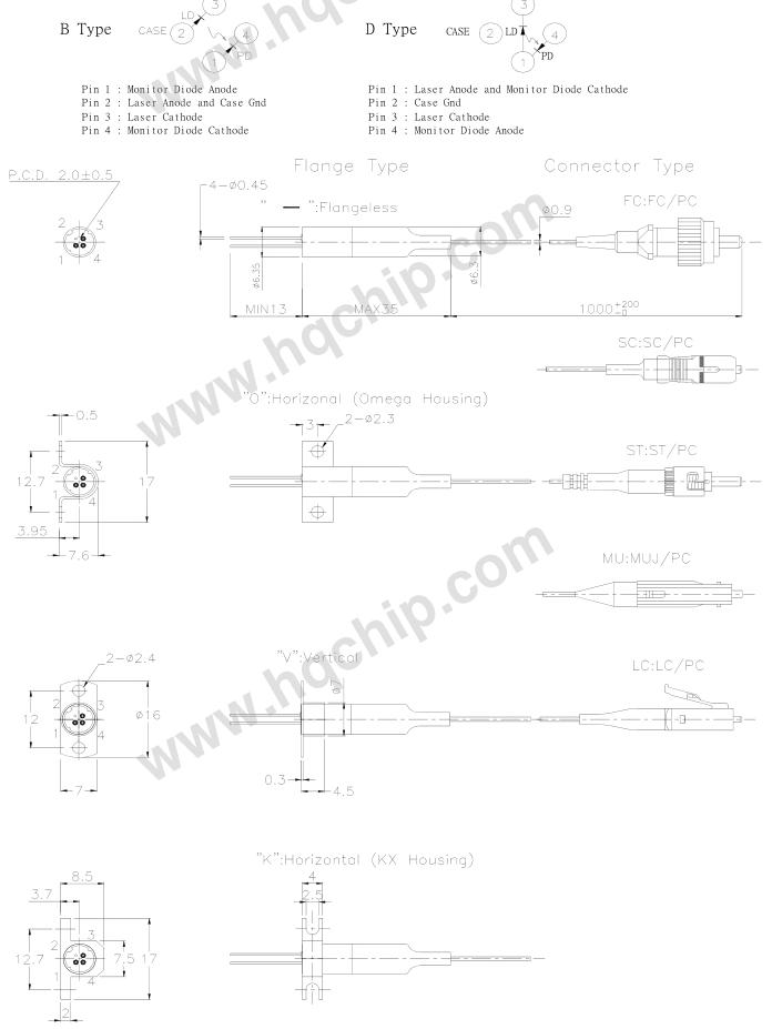

### 引脚分配 - 引脚图示为:![fig_20418](https://p3-flow-imagex-sign.byteimg.com/ocean-cloud-tos/pdf/8e93dccc4305c6d73af8d27e6aa39f4f_1_1200.jpg~tplv-a9rns2rl98-resize-crop:99:193:795:1120:696:927.jpeg?rk3s=1567c5c4&x-expires=1771129654&x-signature=O%2BYKMCfAlCf4BukzJe%2FnGQzdpGU%3D)

### 封装信息 - 光纤尾纤封装,包含FC/ST/SC/MU/LC等连接器选项。
