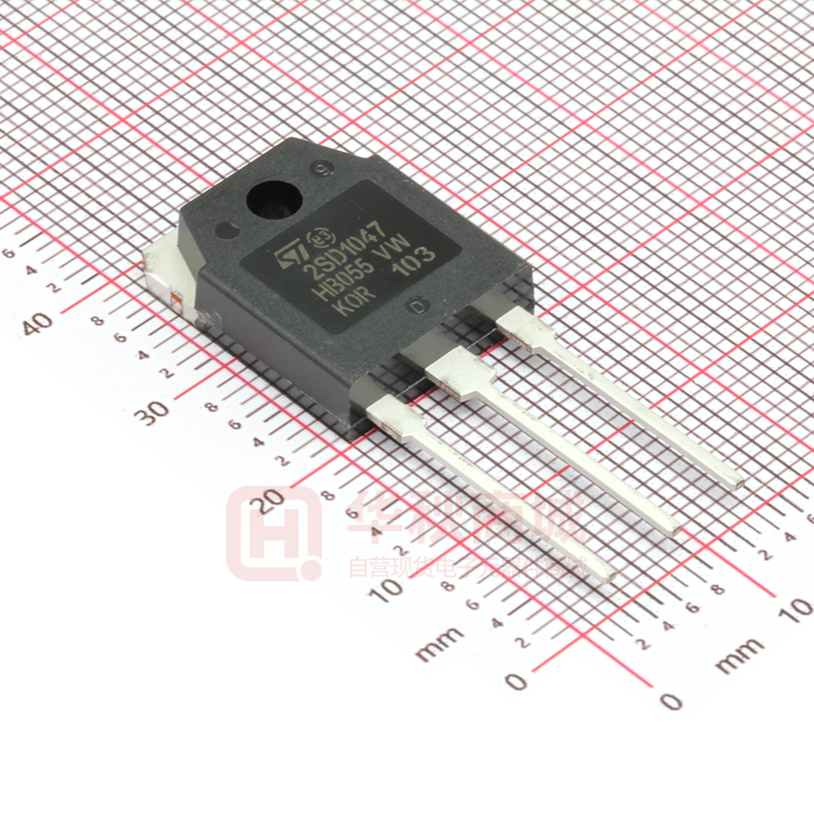

2SD1047 High power NPN epitaxial planar bipolar transistor Features ■ High breakdown voltage VCEO = 140 V ■ Typical ft = 20 MHz ■ Fully characterized at 125 oC Application ■ Power supply 3 2 1 Description TO-3P The device is a NPN transistor manufactured using new BiT-LA (Bipolar transistor for linear amplifier) technology. The resulting transistor shows good gain linearity behaviour. Table 1. Figure 1. Internal schematic diagram Device summary Order code Marking Package Packaging 2SD1047 2SD1047 TO-3P Tube April 2011 Doc ID 018729 Rev 1 1/10 www.st.com 10 Electrical ratings 1 2SD1047 Electrical ratings Table 2. Absolute maximum ratings Symbol Value Unit VCBO Collector-base voltage (IE = 0) 200 V VCEO Collector-emitter voltage (IB = 0) 140 V VEBO Emitter-base voltage (IC = 0) 6 V Collector current 12 A ICM Collector peak current (tP < 5 ms) 20 A Ptot Total dissipation at Tc = 25 °C 100 W Tstg Storage temperature -65 to 150 °C 150 °C Value Unit 1.25 °C/W IC TJ Table 3. Symbol Rthj-case 2/10 Parameter Max. operating junction temperature Thermal data Parameter Thermal resistance junction-case ____max Doc ID 018729 Rev 1 2SD1047 2 Electrical characteristics Electrical characteristics (Tcase = 25 °C; unless otherwise specified) Table 4. Symbol Electrical characteristics Parameter Test conditions Min. Typ. Max. Unit ICBO Collector cut-off current (IE = 0) VCB = 200 V 0.1 µA IEBO Emitter cut-off current (IC = 0) VEB = 6 V 0.1 µA V(BR)CEO(1) Collector-emitter I = 50 mA breakdown voltage (IB = 0) C 140 V V(BR)CBO Collector-base breakdown IC = 100 µA voltage (IE = 0) 200 V 6 V Emitter-base breakdown voltage (IC = 0) IE = 1 mA Collector-emitter saturation voltage IC = 5 A IC = 7 A IB = 500 mA IB = 700 mA 0.5 0.7 V V VBE Base-emitter voltage VCE = 5 V IC = 5 A 1.3 V hFE DC current gain IC = 1 A IC = 5 A VCE = 5 V VCE = 4 V fT Transition frequency IC = 0.5 A VCE = 12 V 20 MHz CCBO Collector-base capacitance (IE = 0) VCB = 10 V f = 1 MHz 150 pF Turn-on time VCC = 60 V IC = 5 A 0.22 µs Storage time IB1 = -IB2 = 0.5 A 4.3 µs 0.5 µs V(BR)EBO(1) VCE(sat)(1) 60 200 50 Resistive Load ton tstg tf Fall time 1. Pulse duration = 300 µs, duty cycle ≤ 1.5 % Doc ID 018729 Rev 1 3/10 Electrical characteristics 2.1 4/10 2SD1047 Electrical characteristics (curves) Figure 2. Safe operating area Figure 3. Output characteristics Figure 4. DC current gain Figure 5. Collector-emitter saturation voltage Figure 6. Base-emitter voltage Figure 7. Base-emitter voltage Doc ID 018729 Rev 1 2SD1047 2.2 Electrical characteristics Test circuit Figure 8. Resistive load switching test circuit 1) Fast electronic switch 2) Non-inductive resistor Doc ID 018729 Rev 1 5/10 Electrical characteristics Table 5. 2SD1047 TO-3P mechanical data mm Dim. Min. Max. A 4.6 5 A1 1.45 1.50 1.65 A2 1.20 1.40 1.60 b 0.80 1 1.20 b1 1.80 2.20 b2 2.80 3.20 c 0.55 0.60 0.75 D 19.70 19.90 20.10 D1 E 13.90 15.40 15.80 E1 13.60 E2 9.60 e 5.15 5.45 5.75 L 19.50 20 20.50 L1 6/10 Typ. 3.50 L2 18.20 P 3.10 18.40 3.30 Q 5 Q1 3.80 Doc ID 018729 Rev 1 18.60 2SD1047 Electrical characteristics Figure 9. TO-3P drawings Doc ID 018729 Rev 1 7/10 Package mechanical data 3 2SD1047 Package mechanical data In order to meet environmental requirements, ST offers these devices in different grades of ECOPACK® packages, depending on their level of environmental compliance. ECOPACK® specifications, grade definitions and product status are available at: www.st.com. ECOPACK is an ST trademark. 8/10 Doc ID 018729 Rev 1 2SD1047 4 Revision history Revision history Table 6. Document revision history Date Revision 12-Apr-2011 1 Changes Initial release. Doc ID 018729 Rev 1 9/10 2SD1047 Please Read Carefully: Information in this document is provided solely in connection with ST products. STMicroelectronics NV and its subsidiaries (“ST”) reserve the right to make changes, corrections, modifications or improvements, to this document, and the products and services described herein at any time, without notice. All ST products are sold pursuant to ST’s terms and conditions of sale. Purchasers are solely responsible for the choice, selection and use of the ST products and services described herein, and ST assumes no liability whatsoever relating to the choice, selection or use of the ST products and services described herein. No license, express or implied, by estoppel or otherwise, to any intellectual property rights is granted under this document. If any part of this document refers to any third party products or services it shall not be deemed a license grant by ST for the use of such third party products or services, or any intellectual property contained therein or considered as a warranty covering the use in any manner whatsoever of such third party products or services or any intellectual property contained therein. UNLESS OTHERWISE SET FORTH IN ST’S TERMS AND CONDITIONS OF SALE ST DISCLAIMS ANY EXPRESS OR IMPLIED WARRANTY WITH RESPECT TO THE USE AND/OR SALE OF ST PRODUCTS INCLUDING WITHOUT LIMITATION IMPLIED WARRANTIES OF MERCHANTABILITY, FITNESS FOR A PARTICULAR PURPOSE (AND THEIR EQUIVALENTS UNDER THE LAWS OF ANY JURISDICTION), OR INFRINGEMENT OF ANY PATENT, COPYRIGHT OR OTHER INTELLECTUAL PROPERTY RIGHT. UNLESS EXPRESSLY APPROVED IN WRITING BY AN AUTHORIZED ST REPRESENTATIVE, ST PRODUCTS ARE NOT RECOMMENDED, AUTHORIZED OR WARRANTED FOR USE IN MILITARY, AIR CRAFT, SPACE, LIFE SAVING, OR LIFE SUSTAINING APPLICATIONS, NOR IN PRODUCTS OR SYSTEMS WHERE FAILURE OR MALFUNCTION MAY RESULT IN PERSONAL INJURY, DEATH, OR SEVERE PROPERTY OR ENVIRONMENTAL DAMAGE. ST PRODUCTS WHICH ARE NOT SPECIFIED AS "AUTOMOTIVE GRADE" MAY ONLY BE USED IN AUTOMOTIVE APPLICATIONS AT USER’S OWN RISK. Resale of ST products with provisions different from the statements and/or technical features set forth in this document shall immediately void any warranty granted by ST for the ST product or service described herein and shall not create or extend in any manner whatsoever, any liability of ST. ST and the ST logo are trademarks or registered trademarks of ST in various countries. Information in this document supersedes and replaces all information previously supplied. The ST logo is a registered trademark of STMicroelectronics. All other names are the property of their respective owners. © 2011 STMicroelectronics - All rights reserved STMicroelectronics group of companies Australia - Belgium - Brazil - Canada - China - Czech Republic - Finland - France - Germany - Hong Kong - India - Israel - Italy - Japan Malaysia - Malta - Morocco - Philippines - Singapore - Spain - Sweden - Switzerland - United Kingdom - United States of America www.st.com 10/10 Doc ID 018729 Rev 1
