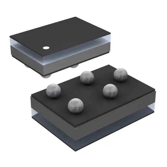

BALF-CC26-05D3 50 Ω nominal input / conjugate match balun CC2610, CC2620, CC2630, CC2640, CC2650 MHz, with integrated harmonic filter Datasheet - production data Description STMicroelectronics' BALF-CC26-05D3 is an ultra-miniature balun, integrating both matching network and harmonics filter. Matching impedance has been customized for the TI CC26xx series 5x5 SimpleLink™ multistandard wireless MCU. The device uses STMicroelectronics' IPD technology on a non-conductive glass substrate, which optimizes RF performance. Figure 1: Pin configuration Features        2.45 GHz balun with integrated matching network Matching optimized for CC26 series 5×5 external differential Low insertion loss Low amplitude imbalance Low phase imbalance Coated Flip-Chip on glass Small footprint < 1.5 mm² Benefits      Figure 2: Block diagram Very low profile High RF performance PCB space saving versus discrete solution RF BOM and size reduction Efficient manufacturability Antenna (50 Ω) Not necessary if internal bias is used Pin 3/4_RX/TX Pin 2_RFN Pin 1_RFP July 2016 DocID029603 Rev 1 This is information on a product in full production. BALF-CC26-05 1/8 www.st.com Characteristics 1 BALF-CC26-05D3 Characteristics Table 1: Absolute maximum ratings (limiting values) Symbol PIN VESD TOP Parameter Value Unit Input power RFIN 20 dBm ESD ratings MIL STD883C (HBM: C = 100 pF, R = 1.5 Ω, air discharge) 900 ESD ratings machine model (MM: C = 200 pF, R = 25 W, L = 500 nH) 100 V Operating temperature -40 to +105 °C Table 2: Electrical characteristics (Tamb = 25 °C) Value Symbol Parameter Unit Min. ZOUT ZIN Frequency range (bandwidth) IL Insertion loss in bandwidth RL DIFF Max. Match to 5x5 CC26xx series Ω 50 Ω Nominal input impedance f RL SE 2/8 Nominal differential output impedance Typ. 2400 2500 MHz 1.2 1.5 dB Single Ended Return loss in bandwidth -27 -18 dB Differential Return loss in bandwidth -23 -20 dB Phase_imbal Phase imbalance -16 16 ° Ampl_imbal Amplitude imbalance -0.3 0.3 dB H2 Second harmonic rejection -18 -17 H3 Third harmonic rejection -37 -35 DocID029603 Rev 1 BALF-CC26-05D3 1.2 Characteristics RF measurement Figure 3: Transmission Figure 4: Insertion loss (dB) (dB) 0 0.0 -0.2 -0.4 -10 -0.6 -0.8 -20 -1.0 -1.2 -1.4 -30 -1.6 -1.8 -2.0 -40 0 1 2 3 4 f (GHz) 5 6 7 2.0 8 2.1 2.2 2.3 2.4 f (GHz) 2.5 2.6 2.7 2.8 2.9 Figure 6: Return loss DIFF Figure 5: Return loss SE (dB) (dB) 0 0 -5 -5 -10 -10 -15 -20 -15 -25 -20 -30 -35 -25 0 1 2 3 4 f (GHz) 5 6 7 8 0 Figure 7: Amplitude imbalance 4 1 2 3 4 f (GHz) 5 6 7 8 Figure 8: Phase imbalance (dB) 20 3 15 2 10 1 5 0 0 -1 -5 -2 -10 -3 -15 (deg) -20 -4 2.3 2.4 2.5 2.6 2.3 2.4 2.5 2.6 f (GHz) f (GHz) DocID029603 Rev 1 3/8 Package information 2 BALF-CC26-05D3 Package information In order to meet environmental requirements, ST offers these devices in different grades of ECOPACK® packages, depending on their level of environmental compliance. ECOPACK® specifications, grade definitions and product status are available at: www.st.com. ECOPACK® is an ST trademark. 2.1 Flip-Chip CSPG 0.4 package information Figure 9: Flip-Chip CSPG 0.4 package outline 224 µm 604 µm 630 +/- 60 µm 224 µm 260 µm 433 µm DIFF2 GND DIFF1 250 µm VCC 260 µm 250 µm SE Bump side view Figure 10: PCB layout recommendation Vcc access = 50 Ω 125 µm 100 µm 100 µm 200 µm 160 µm 100 µm 500µm 130 µm 160 µm 130 µm 200 µm 1300 µm Differential line = 100 Ω 4/8 DocID029603 Rev 1 125 µm 100 µm Single ended line = 50 Ω Package information BALF-CC26-05D3 Figure 11: Footprint -non solder mask defined 2.2 Figure 12: Footprint - solder mask defined Flip-chip CSPG 0.4 packing information Figure 13: Flip-chip CSPG 0.4 tape outline DocID029603 Rev 1 5/8 Package information BALF-CC26-05D3 Figure 14: Flip-chip CSPG 0.4 tape outline 6/8 DocID029603 Rev 1 Ordering information BALF-CC26-05D3 3 Ordering information Table 3: Ordering information 4 Order code Marking Package Weight Base qty. Delivery mode BALF-CC26-05D3 TH Flip-Chip CSPG 0.4 1.724 mg 5000 Tape and reel (7") Revision history Table 4: Document revision history Date Revision 27-Jul-2016 1 Changes First issue. DocID029603 Rev 1 7/8 BALF-CC26-05D3 IMPORTANT NOTICE – PLEASE READ CAREFULLY STMicroelectronics NV and its subsidiaries (“ST”) reserve the right to make changes, corrections, enhancements, modifications, and improvements to ST products and/or to this document at any time without notice. Purchasers should obtain the latest relevant information on ST products before placing orders. ST products are sold pursuant to ST’s terms and conditions of sale in place at the time of order acknowledgement. Purchasers are solely responsible for the choice, selection, and use of ST products and ST assumes no liability for application assistance or the design of Purchasers’ products. No license, express or implied, to any intellectual property right is granted by ST herein. Resale of ST products with provisions different from the information set forth herein shall void any warranty granted by ST for such product. ST and the ST logo are trademarks of ST. All other product or service names are the property of their respective owners. Information in this document supersedes and replaces information previously supplied in any prior versions of this document. © 2016 STMicroelectronics – All rights reserved 8/8 DocID029603 Rev 1
