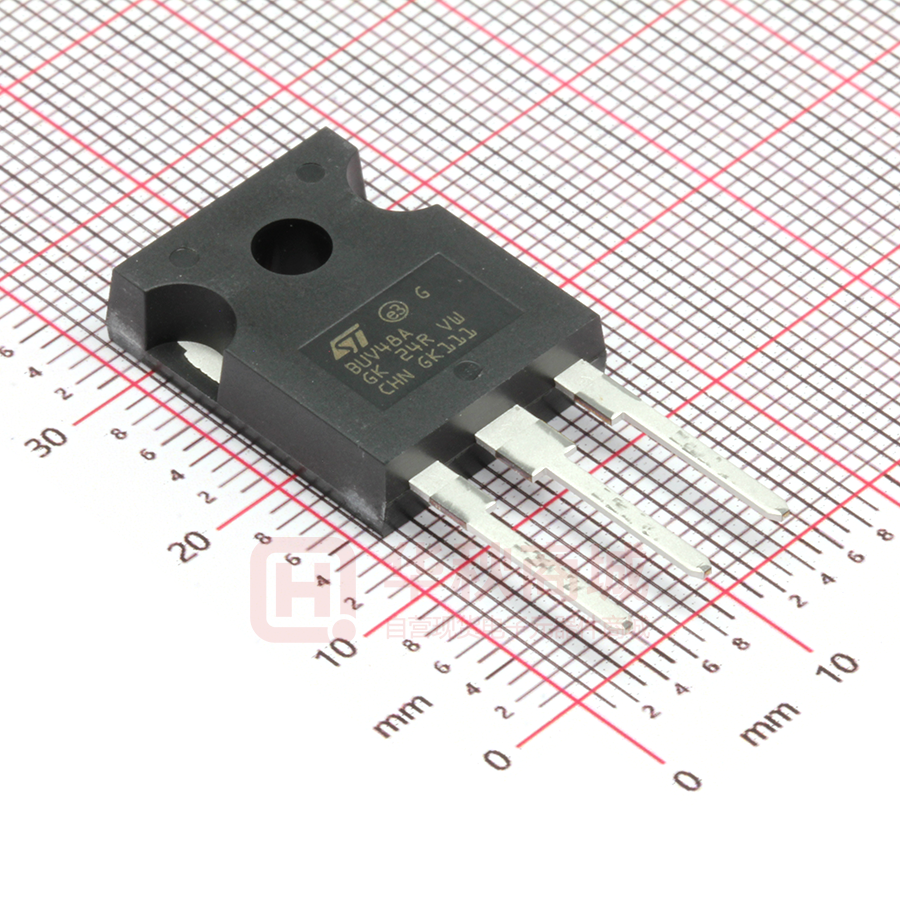

    高压快开关NPN功率晶体管
BUV48A 数据手册
BUV48A High voltage fast switching NPN power transistor Features ■ High current capability ■ Fast switching speed Applications ■ Switching mode power supplies ■ Flyback and forward single transistor low power converter 3 2 1 TO-247 Description The device is a multiepitaxial mesa NPN transistor mounted in TO-247 plastic package. It is intended for switching and industrial applications from single and three-phase mains. Table 1. Figure 1. Internal schematic diagram Device summary Order code Marking Package Packaging BUV48A BUV48A TO-247 Tube November 2009 Doc ID 5989 Rev 9 1/8 www.st.com 8 Absolute maximum ratings 1 Absolute maximum ratings Table 2. Absolute maximum ratings Symbol Parameter Value Unit VCER Collector-emitter voltage (RBE = 10 Ω) 1000 V VCES Collector-emitter voltage (VBE = 0) 1000 V VCEO Collector-emitter voltage (IB = 0) 450 V VEBO Emitter-base voltage (IC = 0) 7 V Collector current 15 A ICM Collector peak current 30 A ICP Collector peak current non repetitive (tp < 20 µs) 55 A IB Base current 4 A Base peak current 20 A PTOT Total dissipation at Tcase = 25 °C 125 W TSTG Storage temperature -65 to 150 °C 150 °C IC IBM TJ Table 3. Symbol RthJC 2/8 BUV48A Max. operating junction temperature Thermal data Parameter Thermal resistance junction-case Doc ID 5989 Rev 9 __max Value Unit 1 °C/W BUV48A 2 Electrical characteristics Electrical characteristics Tcase = 25 °C; unless otherwise specified. Table 4. Symbol Electrical characteristics Parameter Test conditions Min. Typ. Max. Unit µA mA ICES Collector cut-off current (VBE = 0) VCE = 1000 V VCE = 1000 V Tc = 125 °C 200 2 ICER Collector cut-off current (RBE = 10Ω) VCE = 1000 V VCE = 1000 V Tc = 125 °C 500 4 µA mA IEBO Emitter cut-off current (IC = 0) VEB = 5 V 1 mA Collector-emitter VCEO(sus)(1) sustaining voltage (IB = 0) IC = 200 mA Emitter-base voltage (IC = 0) IE = 50 mA VCE(sat)(1) Collector-emitter saturation voltage IC = 8 A IC = 12 A VBE(sat)(1) Base-emitter saturation voltage VEBO 450 V 30 V IB = 1.6 A IB = 2.4 A 1.5 5 V V IC = 8 A IB = 1.6 A 1.6 V DC current gain IC = 8 A VCE = 5 V ton ts tf Resistive load Turn-on time Storage time Fall time IC = 8 A VCC = 150 V IB1 = -IB2 = 1.6 A 1 3 0.8 µs µs µs ts tf Inductive load Storage time Fall time VCC = 300 V VBE = -5 V LB = 3 µH IC = 8 A IB1 = 1.6 A ts tf Inductive load Storage time Fall time VCC = 300 V VBE = -5 V LB = 3 µH IC = 8 A IB1 = 1.6 A TC = 125 °C hFE (1) 7 8 3 0.13 µs µs 5 0.4 µs µs 1. Pulse test: pulse duration ≤ 300 µs, duty cycle ≤ 2 % Doc ID 5989 Rev 9 3/8 Electrical characteristics 2.1 BUV48A Test circuit Figure 2. Resistive load switching test circuit 1. Fast electronic switch 2. Non-inductive resistor Figure 3. Inductive load switching test circuit 1. Fast electronic switch 2. Non-inductive resistor 3. Fast recovery rectifier 4/8 Doc ID 5989 Rev 9 BUV48A 3 Package mechanical data Package mechanical data In order to meet environmental requirements, ST offers these devices in different grades of ECOPACK® packages, depending on their level of environmental compliance. ECOPACK® specifications, grade definitions and product status are available at: www.st.com. ECOPACK® is an ST trademark. Doc ID 5989 Rev 9 5/8 Package mechanical data BUV48A TO-247 mechanical data Dim. mm. Min. Typ. 4.85 5.15 A1 2.20 2.60 b 1.0 1.40 b1 2.0 2.40 b2 3.0 3.40 c 0.40 0.80 D 19.85 20.15 E 15.45 15.75 e 5.45 L 14.20 14.80 L1 3.70 4.30 L2 18.50 øP 3.55 3.65 øR 4.50 5.50 S 6/8 Max. A 5.50 Doc ID 5989 Rev 9 BUV48A 4 Revision history Revision history Table 5. Document revision history Date Revision Changes 29-Oct-2007 8 Package change from TO-218 to TO-247. 16-Nov-2009 9 Added hFE specification Table 4 on page 3. Doc ID 5989 Rev 9 7/8 BUV48A Please Read Carefully: Information in this document is provided solely in connection with ST products. STMicroelectronics NV and its subsidiaries (“ST”) reserve the right to make changes, corrections, modifications or improvements, to this document, and the products and services described herein at any time, without notice. All ST products are sold pursuant to ST’s terms and conditions of sale. Purchasers are solely responsible for the choice, selection and use of the ST products and services described herein, and ST assumes no liability whatsoever relating to the choice, selection or use of the ST products and services described herein. No license, express or implied, by estoppel or otherwise, to any intellectual property rights is granted under this document. If any part of this document refers to any third party products or services it shall not be deemed a license grant by ST for the use of such third party products or services, or any intellectual property contained therein or considered as a warranty covering the use in any manner whatsoever of such third party products or services or any intellectual property contained therein. UNLESS OTHERWISE SET FORTH IN ST’S TERMS AND CONDITIONS OF SALE ST DISCLAIMS ANY EXPRESS OR IMPLIED WARRANTY WITH RESPECT TO THE USE AND/OR SALE OF ST PRODUCTS INCLUDING WITHOUT LIMITATION IMPLIED WARRANTIES OF MERCHANTABILITY, FITNESS FOR A PARTICULAR PURPOSE (AND THEIR EQUIVALENTS UNDER THE LAWS OF ANY JURISDICTION), OR INFRINGEMENT OF ANY PATENT, COPYRIGHT OR OTHER INTELLECTUAL PROPERTY RIGHT. UNLESS EXPRESSLY APPROVED IN WRITING BY AN AUTHORIZED ST REPRESENTATIVE, ST PRODUCTS ARE NOT RECOMMENDED, AUTHORIZED OR WARRANTED FOR USE IN MILITARY, AIR CRAFT, SPACE, LIFE SAVING, OR LIFE SUSTAINING APPLICATIONS, NOR IN PRODUCTS OR SYSTEMS WHERE FAILURE OR MALFUNCTION MAY RESULT IN PERSONAL INJURY, DEATH, OR SEVERE PROPERTY OR ENVIRONMENTAL DAMAGE. ST PRODUCTS WHICH ARE NOT SPECIFIED AS "AUTOMOTIVE GRADE" MAY ONLY BE USED IN AUTOMOTIVE APPLICATIONS AT USER’S OWN RISK. Resale of ST products with provisions different from the statements and/or technical features set forth in this document shall immediately void any warranty granted by ST for the ST product or service described herein and shall not create or extend in any manner whatsoever, any liability of ST. ST and the ST logo are trademarks or registered trademarks of ST in various countries. Information in this document supersedes and replaces all information previously supplied. The ST logo is a registered trademark of STMicroelectronics. All other names are the property of their respective owners. © 2009 STMicroelectronics - All rights reserved STMicroelectronics group of companies Australia - Belgium - Brazil - Canada - China - Czech Republic - Finland - France - Germany - Hong Kong - India - Israel - Italy - Japan Malaysia - Malta - Morocco - Philippines - Singapore - Spain - Sweden - Switzerland - United Kingdom - United States of America www.st.com 8/8 Doc ID 5989 Rev 9
