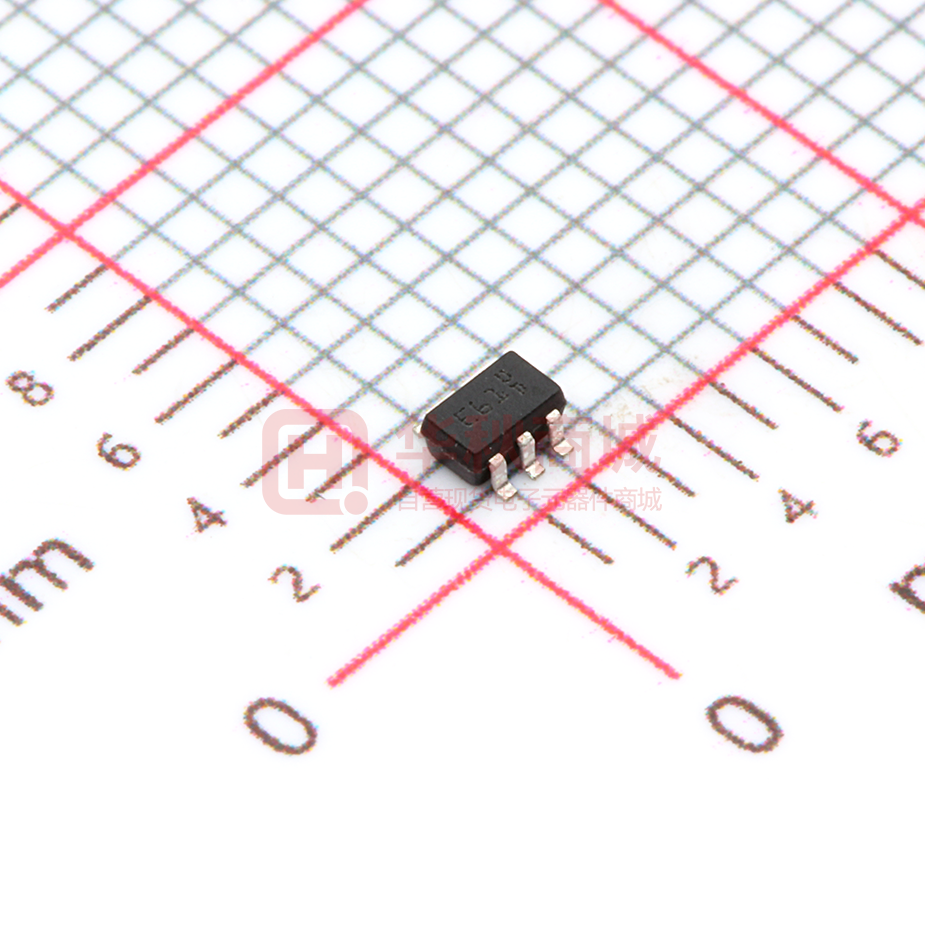

ESDA6V1W5
ESDA6V1W5
    STMICROELECTRONICS(意法半导体)
    SOT323-5L
    过渡式™阵列的数据保护 SOT323-5L
ESDA6V1W5 数据手册
ESDAxxxWx TRANSIL™ array for data protection Main applications Where transient overvoltage protection in ESD sensitive equipment is required, such as : ■ ■ ■ ■ ■ ■ Computers Printers Communication systems Cellular phones handsets and accessories Wireline and wireless telephone sets Set top boxes SOT323-3L Order codes SOT323-5L SOT323-6L Part Numbers ESDA6V1W5 ESDA6V1-5W6 Marking E61 E62 E25 E25 Features ■ ■ ■ ■ ESDA25W ESDA25W5 2 up to 5 Unidirectional Transil functions Breakdown voltage: VBR = 6.1 V min. and 25 V min. Low leakage current: < 1 µA Very small PCB area < 4.2 mm2 typically ESDA25W Functional diagram 1 3 Description The ESDAxxxWx are monolithic suppressors designed to protect components connected to data and transmission lines against ESD. These devices clamp the voltage just above the logic level supply for positive transients, and to a diode drop below ground for negative transients. 2 ESDA6V1W5/ESDA25W5 Functional diagram 1 2 3 4 5 Benefits ■ ■ High ESD protection level: up to 25 kV High integration Complies with the following standards IEC61000-4-2 Level 4 15 kV (air discharge) 8 kV(contact discharge) ESDA6V1-5W6 Functional diagram 1 2 3 6 5 4 MIL STD 883E - Method 3015-7 Class 3 25 kV HBM (Human Body Model) August 2005 Rev 2 1/11 www.st.com 11 1 Characteristics ESDAxxxWx 1 Characteristics Table 1. Symbol Absolute Ratings (Tamb = 25°C) Parameter ESDA25W Value 400 150 100 125 -55 to +150 260 -40 to +125 °C -40 to +125 °C °C °C W Unit PPP Peak pulse power (8/20 µs) ESDA25W5 / ESDA6V1W5 ESDA6V1-5W6 Tj Tstg TL Top Junction temperature Storage temperature range Maximum lead temperature for soldering during 10s range(1) ESDA25W / ESDA25W5 / ESDA6V1W5 ESDA6V1-5W6 Operating temperature 1. The values of the operating parameters versus temperature are given through curves and αT parameter. 1.1 Electrical Characteristics (Tamb = 25°C) Symbol VRM VBR VCL IRM IPP IR IF αT VF C Rd Parameter Stand-off voltage Breakdown voltage Clamping voltage Leakage current Peak pulse current Reverse leakage current Forward current Voltage temperature coefficient Forward voltage drop Capacitance Dynamic resistance I IF VF VCL VBR VRM IRM V Slope: 1/Rd IPP 2/11 ESDAxxxWx 1 Characteristics VBR @ IR Part Numbers min. max. IRM @ VRM VF max. @ IF Rd typ.(1) αT max.(2) C typ. 0V bias V ESDA25W ESDA25W5 ESDA6V1-5W6 ESDA6V1W5 25 25 6.1 6.1 V 30 30 7.2 7.2 mA 1 1 1 1 µA 1 1 1 1 V 24 24 3 3 V 1.2 1.2 1.25 1.25 mA 10 10 200 200 Ω 1.1 1.9 0.61 0.35 10-4/°C 10 10 6 6 pF 65 30 50 90 1. Square pulse lpp = 15 A, tp = 2.5 µs 2. VBR = aT* (Tamb - 25 °C) * VBR (25 °C) Figure 1. Peak power dissipation versus initial junction temperature Figure 2. Peak pulse power versus exponential pulse duration (Tj initial = 25°C) (ESDA25W) PPP[Tj initial] / PPP[Tj initial=25°C] 1.1 1.0 0.9 0.8 0.7 0.6 0.5 0.4 0.3 0.2 0.1 0.0 0 25 50 75 100 125 PPP(W) 10000 Tj initial = 25°C ESDA25W 1000 Tj initial (°C) 100 1 tp(µs) 10 100 Fig 1 3/11 1 Characteristics ESDAxxxWx Figure 4. Clamping voltage versus peak pulse current (Tj initial = 25°C, rectangular waveform, tp = 2.5 µs) (ESDA25W / ESDA25W5) Figure 3. Peak pulse power versus exponential pulse duration (Tj initial = 25°C) (ESDA25W5 / ESDA6V1W5 / ESDA6V1-5W6) PPP(W) 1000 ESDA6V1W5 / ESDA25W5 Tj initial = 25°C IPP(A) 100.0 tp = 2.5µs ESDA25W 10.0 100 ESDA6V1-5W6 ESDA25W5 1.0 10 1 tp(µs) 10 100 VCL(V) 0.1 20 25 30 35 40 45 50 55 60 65 70 75 80 Figure 5. Clamping voltage versus peak pulse Figure 6. current (Tj initial = 25°C, rectangular waveform, tp = 2.5 µs) (ESDA6V1W5 / ESDA6V1-5W6) Capacitance versus reverse applied voltage (typical values) (ESDA25W / ESDA25W5) IPP(A) 50.0 tp = 2.5µs ESDA6V1W5 C(pF) 50 45 40 ESDA6V1-5W6 F=1MHz VOSC=30mVRMS Tj=25°C 10.0 35 30 25 ESDA25W 1.0 20 15 10 ESDA25W5 0.1 0 5 10 15 VCL(V) 20 25 30 35 40 5 0 1 3 5 7 9 11 VR(V) 13 15 17 19 21 23 25 4/11 ESDAxxxWx Figure 7. Capacitance versus reverse applied Figure 8. voltage (typical values) (ESDA6V1W5 / ESDA6V1-5W6) 1 Characteristics Relative variation of leakage current versus junction temperature (typical values) C(pF) 80 70 60 100 50 40 30 ESDA6V1-5W6 ESDA6V1W5 F=1MHz VOSC=30mVRMS Tj=25°C IR[Tj] / IR[Tj=25°C] 1000 ESDA25W 10 ESDA25W5 ESDA6V1-5W6 20 10 0.5 VR(V) 1.0 1.5 2.0 2.5 3.0 3.5 4.0 4.5 5.0 1 25 50 75 Tj(°C) 100 ESDA6V1W5 125 Figure 9. Peak forward voltage drop versus peak forward current (typical values) (ESDA25W / ESDA25W5) Figure 10. Peak forward voltage drop versus peak forward current (typical values) (ESDA6V1W5 / ESDA6V1-5W6) IFM(A) 1E+0 IFM(A) 1E+0 Tj = 25°C ESDA25W / ESDA25W5 Tj = 25°C ESDA6V1W5 ESDA6V1-5W6 1E-1 1E-1 1E-2 1E-2 VFM(V) 1E-3 0.0 0.5 1.0 1.5 2.0 2.5 3.0 3.5 4.0 1E-3 0.6 0.7 0.8 0.9 VFM(V) 1.0 1.1 1.2 1.3 1.4 1.5 1.6 Figure 11. ESD response to IEC61000-4-2 (air discharge 15 kV, positive surge) 5/11 2 Ordering information scheme ESDAxxxWx 2 Ordering information scheme ESDA ESD Array Breakdown Voltage 25 = 25 Volts min. 6V1 = 6.1 Volts min Number of lines protected (optional) -5 = 5 lines Packages W = SOT323-3L W5 = SOT323-5L W6 = SOT323-6L 25 -5 Wx 6/11 ESDAxxxWx 3 Package mechanical data 3 3.1 Package mechanical data SOT323-3L package DIMENSIONS A E REF. Millimeters Min. Typ. Max. 1.1 0.1 0.4 0.26 2.0 1.25 0.65 1.8 0.1 0 2.1 0.2 2.4 0.3 30° 2.2 1.35 Min. 0.031 0.0 0.010 0.004 Inches Typ. Max. 0.043 0.004 0.016 0.010 A e b D 0.8 0.0 0.25 0.1 1.8 1.15 A1 b c A1 D E e 0.071 0.079 0.086 0.045 0.049 0.053 0.026 0.071 0.083 0.094 0.004 0.008 0.012 0 30° c θ H H L L q Figure 12. Footprint dimensions 0.95 1.0 2.9 0.8 0.50 Dimensions in mm 7/11 3 Package mechanical data ESDAxxxWx 3.2 SOT323-5L package DIMENSIONS A E REF. Millimeters Min. Max. 1.1 0.1 1 0.3 0.18 2.2 1.35 Inches Min. 0.031 0 0.031 0.006 0.004 0.071 0.045 Max. 0.043 0.004 0.039 0.012 0.007 0.086 0.053 e b e D A A1 A2 b A1 A2 0.8 0 0.8 0.15 0.1 1.8 1.15 c D E e Q1 c 0.65 Typ. 1.8 0.1 2.4 0.4 0.025 Typ. 0.071 0.004 0.094 0.016 L HE H Q1 Figure 13. Footprint dimensions 0.3 1.0 2.9 1.0 0.35 Dimensions in mm 8/11 ESDAxxxWx 3 Package mechanical data 3.3 SOT323-6L package DIMENSIONS A E REF. Millimeters Min. Max. 1.1 0.1 1 0.3 0.18 2.2 1.35 Inches Min. 0.031 0 0.031 0.006 0.004 0.071 0.045 Max. 0.043 0.004 0.039 0.012 0.007 0.086 0.053 e b e D A A1 A2 b A1 A2 0.8 0 0.8 0.15 0.1 1.8 1.15 c D E e Q1 c 0.65 Typ. 1.8 0.1 2.4 0.4 0.025 Typ. 0.071 0.004 0.094 0.016 L HE H Q Figure 14. Footprint dimensions 0.65 1.05 0.80 2.9 1.05 0.40 Dimensions in mm 9/11 4 Ordering information ESDAxxxWx 4 Ordering information Part Number ESDA6V1W5 ESDA6V1-5W6 ESDA25W ESDA25W5 Marking E61 E62 E25 E25 Package SOT323-5L SOT323-6L 6 mg SOT323-3L SOT323-5L 3000 Tape & reel Weight Base qty Delivery mode 5 Revision history Date 20-Jul-2005 29-Aug-2005 Revision 1 2 Initial release Added notes to table on page2, removed annotations in Figure 1. Changes 10/11 ESDAxxxWx 5 Revision history Information furnished is believed to be accurate and reliable. However, STMicroelectronics assumes no responsibility for the consequences of use of such information nor for any infringement of patents or other rights of third parties which may result from its use. No license is granted by implication or otherwise under any patent or patent rights of STMicroelectronics. Specifications mentioned in this publication are subject to change without notice. This publication supersedes and replaces all information previously supplied. STMicroelectronics products are not authorized for use as critical components in life support devices or systems without express written approval of STMicroelectronics. The ST logo is a registered trademark of STMicroelectronics. All other names are the property of their respective owners © 2005 STMicroelectronics - All rights reserved STMicroelectronics group of companies Australia - Belgium - Brazil - Canada - China - Czech Republic - Finland - France - Germany - Hong Kong - India - Israel - Italy - Japan Malaysia - Malta - Morocco - Singapore - Spain - Sweden - Switzerland - United Kingdom - United States of America www.st.com 11/11
