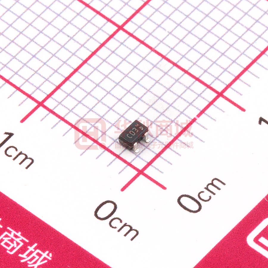

    汽车用双线TVS,SOT323-3L封装,用于CAN总线(12 V系统)
ESDCAN03-2BWY 数据手册
ESDCANxx-2BWY Datasheet Automotive dual-line TVS in SOT323-3L for CAN bus Features 1 3 2 Product status link ESDCAN02-2BWY, ESDCAN03-2BWY, ESDCAN04-2BWY, ESDCAN05-2BWY, ESDCAN06-2BWY • • • AEC-Q101 qualified Dual-line ESD and EOS protection Breakdown voltage, VBR: • • – ESDCAN02-2BWY: 28.5 V – ESDCAN03-2BWY: 26.5 V – ESDCAN04-2BWY: 27.5 V – ESDCAN05-2BWY: 39 V – ESDCAN06-2BWY: 38 V Max pulse power up to 170 W (8/20 μs) Low clamping factor VCL / VBR • ECOPACK2 ROHS compliant component Complies with the following standards • UL94, V0 • J-STD-020 MSL level 1 • IPC7531 footprint and JEDEC registered package • ISO 16750-2 (Jump start and reversed battery tests) • IEC 61000-4-4 (EFT) – 4 kV • ISO 10605 C = 150 pF, R = 330 Ω, exceeds level 4: – ±30 kV (contact and air discharge) • ISO 10605 C = 330 pF, R = 2 kΩ exceeds level 4: – ±30 kV (contact and air discharge) • ISO 10605 C = 330 pF, R = 330 Ω exceeds level 4: – ±30 kV (contact and air discharge) • ISO 7637-3: – Pulse 3a: -150 V – Pulse 3b: +150 V – Pulse 2a: +/- 85 V Description These dual-line CAN transceiver protection devices (TVS) protect both CAN H and CAN L signals of automotive CAN PHY against ISO 7637-3 transients and ESD (electrostatic discharge). ESDCAN series complies with all the physical layer constraints (jump start, reverse polarity, …) without compromising the low clamping voltage for an efficient CAN bus protection (controller area network) or LIN bus protection (local interconnect network). The low line capacitance versions make them compliant with CAN-FD and high speed buses like FlexRay, USB, and even the future CAN XL. DS12789 - Rev 3 - July 2022 For further information contact your local STMicroelectronics sales office. www.st.com ESDCANxx-2BWY Characteristics 1 Characteristics Table 1. Absolute ratings (Tamb = 25 °C) Symbol Parameter Value Unit ISO 10605 - C = 150 pF, R = 330 Ω: Contact and air discharge ISO 10605 - C = 330 pF, R = 330 Ω: 30 ESDCAN02-2BWY ESDCAN03-2BWY VPP Peak pulse voltage ESDCAN04-2BWY 30 Contact discharge ESDCAN05-2BWY 22 Air discharge ESDCAN06-2BWY 30 Contact and air discharge ISO 10605 - C = 330 pF, R = 330 Ω: kV ISO 10605 - C = 330 pF, R = 2 kΩ: Contact and air discharge 30 ESDCAN02-2BWY ESDCAN03-2BWY IPP ESDCAN04-2BWY Peak pulse current (8/20 μs) ESDCAN05-2BWY ESDCAN06-2BWY Tj Tstg 3.7 A 3 Operating junction temperature range -55 to +175 °C Storage temperature range -55 to +175 °C Figure 1. Electrical characteristics (definitions) Ipp Stand-off voltage DS12789 - Rev 3 page 2/14 ESDCANxx-2BWY Characteristics Table 2. Electrical characteristics (values, Tamb = 25 °C) IRM max. at VRM VBR at IR VCLPulse ISO7637-3 3a at -150 V min. Min. Max. Order code µA V V mA ESDCAN02-2BWY 0.01 26.5 28.5 31.7 1 -36 ESDCAN03-2BWY 0.01 24 26.5 29.7 1 ESDCAN04-2BWY 0.05 25.5 27.5 30.7 ESDCAN05-2BWY 0.1 36 39 ESDCAN06-2BWY 0.1 35 38 3b at +150 V max. V VCL at IPP (8/20 µs) Max. ΔC(1) αT (2) Typ. Max. Typ. Typ. C pF 10-4/°C 3.5 0.01 9 3 3.5 0.01 9 3 17 19 0.1 9 61 3 3 3.5 0.01 9 59 3 13 15 0.1 9 V A pF 36 44 3 3 -34 34 41 3 1 -35 35 43 43.3 1 -45 45 42.2 1 -44 44 1. ΔC : capacitance variation between IO1 and IO2 versus GND 2. to calculate VBR versus Tj: VBR at Tj = VBR at 25 °C x (1 + αT x (Tj - 25) ) DS12789 - Rev 3 page 3/14 ESDCANxx-2BWY Characteristics (curves) 1.1 Characteristics (curves) Figure 2. Maximum peak current versus initial junction temperature Ipp (A) 4 3 2 8/20 µs ESDCAN02-2BWY ESDCAN03-2BWY ESDCAN04-2BWY ESDCAN05-2BWY ESDCAN06-2BWY 1 Tj (°C) 0 0 25 50 Figure 3. Maximum peak pulse current versus exponential pulse duration 100 125 150 175 200 Figure 4. Peak pulse current versus clamping voltage Ipp (A) IPP (A) 10 75 10 Tj initial = 25 °C ESDCAN02-2BWY ESDCAN03-2BWY ESDCAN04-2BWY ESDCAN05-2BWY ESDCAN06-2BWY 1 1 8/20 µs ESDCAN02-2BWY ESDCAN03-2BWY ESDCAN04-2BWY ESDCAN05-2BWY ESDCAN06-2BWY tp (ms) 0.1 0.01 0.1 1 Figure 5. Junction capacitance versus reverse applied voltage VCL (V) 0.1 20 25 30 35 40 45 50 55 60 65 70 Figure 6. Leakage current versus junction temperature IR (nA) C (pF) 100.0 100 VR=VRM ESDCAN02-2BWY ESDCAN03-2BWY ESDCAN04-2BWY ESDCAN05-2BWY ESDCAN06-2BWY f = 1 MHz Vosc = 30 mVRMS Tj = 25 °C ESDCAN02-2BWY ESDCAN03-2BWY ESDCAN04-2BWY ESDCAN05-2BWY ESDCAN06-2BWY 10.0 10 1.0 VR (V) 1 0 DS12789 - Rev 3 5 10 15 20 25 30 35 Tj (°C) 0.1 25 50 75 100 125 150 175 40 page 4/14 ESDCANxx-2BWY Characteristics (curves) Figure 7. Response to ISO 10605 -C = 150 pF, R = 330 Ω (-8 kV contact) Figure 8. Response to ISO 10605 - C = 150 pF, R = 330 Ω (+8 kV contact ) Figure 9. Response to ISO 7637-3 Pulse 3a: -150 V DS12789 - Rev 3 page 5/14 ESDCANxx-2BWY Characteristics (curves) Figure 10. Response to ISO 7637-3 Pulse 3b : +150 V Figure 11. Response to ISO 7637-3 pulse 2a: -85 V Figure 12. Response to ISO 7637-3 pulse 2a: +85 V DS12789 - Rev 3 page 6/14 ESDCANxx-2BWY Characteristics (curves) Figure 13. S21 attenuation Figure 14. TLP 25 ESDCAN02-2BWY ESDCAN03-2BWY ESDCAN04-2BWY ESDCAN05-2BWY ESDCAN06-2BWY I (A) 20 15 10 5 0 -5 -10 -15 -20 V (V) -25 -60 DS12789 - Rev 3 -50 -40 -30 -20 -10 0 10 20 30 40 50 60 page 7/14 ESDCANxx-2BWY Package information 2 Package information In order to meet environmental requirements, ST offers these devices in different grades of ECOPACK packages, depending on their level of environmental compliance. ECOPACK specifications, grade definitions and product status are available at: www.st.com. ECOPACK is an ST trademark. 2.1 SOT323-3L package information Figure 15. SOT323-3L package outline c θ L H A E e D b A1 Table 3. SOT323-3L package mechanical data Dimensions Inches(1) Millimeters Ref. Min. Typ. Max. Min. Typ. Max. A 0.80 1.10 0.031 0.044 A1 0.00 0.10 0.000 0.004 b 0.25 0.40 0.009 0.016 c 0.10 0.26 0.003 0.011 D 1.80 2.00 2.20 0.070 0.079 0.087 E 1.15 1.25 1.35 0.045 0.049 0.054 e 0.60 0.65 0.70 0.023 0.026 0.028 H 1.80 2.10 2.40 0.070 0.083 0.095 L 0.10 0.20 0.30 0.004 0.008 0.012 0 30° 0 30° ϴ 1. Values in inches are converted from mm and rounded to 3 decimal digits DS12789 - Rev 3 page 8/14 ESDCANxx-2BWY Packing information 2.2 Packing information Figure 16. SOT323-3L footprint in mm Figure 17. SOT323-3L marking 1.72 0.65 0.44 XXX 1.30 2.70 0.65 0.70 0.42 Figure 18. Package orientation in reel Figure 19. Tape and reel orientation Pin 1 located according to EIA-481 Note: Pocket dimensions are not on scale Pocket shape may vary depending on package Figure 20. 7'' reel dimension values Figure 21. Inner box dimension values 30 Ø 180 max 14.4 2±0.5 Ø 13 Ø 60 Ø 20.2 min 205 205 DS12789 - Rev 3 page 9/14 ESDCANxx-2BWY Packing information Figure 22. Tape outline Table 4. Tape dimension values Dimensions Millimeters Ref. DS12789 - Rev 3 Min. Typ. Max. D0 1.50 1.55 1.6 D1 1.00 F 3.45 3.50 3.55 K0 1.12 1.22 1.32 P0 3.90 4.00 4.10 P1 3.90 4.00 4.10 P2 1.95 2.00 2.05 W 7.90 8.00 8.30 page 10/14 ESDCANxx-2BWY Reflow profile 3 Reflow profile Figure 23. ST ECOPACK® recommended soldering reflow profile for PCB mounting 250 240-245 °C Temperature (°C) -2 °C/s 2 - 3 °C/s 60 sec (90 max) 200 -3 °C/s 150 -6 °C/s 100 0.9 °C/s 50 Time (s) 0 Note: DS12789 - Rev 3 30 60 90 120 150 180 210 240 270 300 Minimize air convection currents in the reflow oven to avoid component movement. Maximum soldering profile corresponds to the latest IPC/JEDEC J-STD-020. page 11/14 ESDCANxx-2BWY Ordering information 4 Ordering information Figure 24. Ordering information scheme ESD CAN xx - 2 B W Y ESD protection CAN = Design for CAN bus xx = Version 2 = Dual line B = Bidirectional W = SOT323-3L Y = Automotive grade Table 5. Ordering information Order code Marking (1) ESDCAN02-2BWY C02 ESDCAN03-2BWY C03 ESDCAN04-2BWY C04 ESDCAN05-2BWY C05 ESDCAN06-2BWY C06 Package Weight Base qty. Delivery mode SOT323-3L 6.58 mg 3000 Tape and reel 1. The marking can be rotated by multiples of 90° to differentiate assembly location DS12789 - Rev 3 page 12/14 ESDCANxx-2BWY Revision history Table 6. Document revision history DS12789 - Rev 3 Date Revision Changes 17-Oct-2018 1 First issue. 13-Nov-2018 2 Updated product name on cover page. 19-Jul-2022 3 Updated Description, Features and Table 1. page 13/14 ESDCANxx-2BWY IMPORTANT NOTICE – READ CAREFULLY STMicroelectronics NV and its subsidiaries (“ST”) reserve the right to make changes, corrections, enhancements, modifications, and improvements to ST products and/or to this document at any time without notice. Purchasers should obtain the latest relevant information on ST products before placing orders. ST products are sold pursuant to ST’s terms and conditions of sale in place at the time of order acknowledgment. Purchasers are solely responsible for the choice, selection, and use of ST products and ST assumes no liability for application assistance or the design of purchasers’ products. No license, express or implied, to any intellectual property right is granted by ST herein. Resale of ST products with provisions different from the information set forth herein shall void any warranty granted by ST for such product. ST and the ST logo are trademarks of ST. For additional information about ST trademarks, refer to www.st.com/trademarks. All other product or service names are the property of their respective owners. Information in this document supersedes and replaces information previously supplied in any prior versions of this document. © 2022 STMicroelectronics – All rights reserved DS12789 - Rev 3 page 14/14
ESDCAN03-2BWY
物料型号:ESDCANxx-2BWY,其中“xx”代表不同版本的型号。
器件简介:这是一种用于汽车CAN总线的双线TVS(瞬态电压抑制二极管),提供ESD(静电放电)和EOS(电涌)保护。
引脚分配:文档中未明确提供引脚分配信息,但提到了SOT323-3L封装,通常这种封装有3个引脚。
参数特性: - 峰值脉冲电压(VPp):不同型号有不同的峰值电压,范围在22kV到30kV之间。 - 峰值脉冲电流(lpp):不同型号的峰值电流在3.7A到3A之间。 - 工作结温范围(T):-55°C 至 +175°C。 - 存储温度范围(Tsto):-55°C 至 +175°C。
功能详解:ESDCAN系列符合所有物理层约束(如跳线启动、反向极性等),在不牺牲低钳位电压的情况下,为CAN总线或LIN总线提供有效保护。低线路电容版本使其符合CAN-FD和高速总线如FlexRay、USB,甚至是未来的CAN XL。
应用信息:这些器件用于保护汽车CAN PHY的CAN H和CAN L信号免受ISO 7637-3瞬态和ESD的影响。
封装信息:提供SOT323-3L (Jedec SC-70)封装,符合ECOPACK2标准,是符合RoHS的组件。
