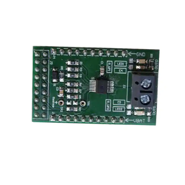

    VN7016AJ VIPower™ Series Power Management, High Side Driver (Internal FET) Evaluation Board
EV-VN7016AJ 数据手册
EV-VN7016AJ VN7016AJ evaluation board Data brief  Features Max transient supply voltage VCC 40 V Operating voltage range VCC 4 to 28 V Typ. on-state resistance (per Ch) RON 16 mΩ Current limitation (typ) ILIMH 77 A Stand-by current (max) ISTBY 0.5 µA     Simple single IC application board dedicated for VN7016AJ-E Provides electrical connectivity and thermal heat-sinking for easy prototyping General device features  Single channel smart high-side driver with MultiSense analog feedback  Very low standby current  Compatible with 3 V and 5 V CMOS outputs MultiSense diagnostic functions  Multiplexed analog feedback of: load current with high precision proportional June 2014 current mirror, VCC supply voltage and TCHIP device temperature  Overload and short to ground (power limitation) indication  Thermal shutdown indication  OFF-state open-load detection  Output short to VCC detection  Sense enable/disable Protections  Undervoltage shutdown  Overvoltage clamp  Load current limitation  Self limiting of fast thermal transients  Configurable latch-off on overtemperature or power limitation with dedicated fault reset pin  Loss of ground and loss of VCC  Reverse battery with external components  Electrostatic discharge protection Applications Typical applications are all types of automotive resistive, inductive and capacitive loads. Description This board provides you an easy way to connect ® ® STMicroelectronics VIPower M0-7 technology into your existing system. Table 1: Device summary Order code EV-VN7016AJ DocID026607 Rev 1 Reference VN7016AJ evaluation board 1/7 www.st.com Overview 1 EV-VN7016AJ Overview The board comes pre-assembled with VN7016AJ-E high-side driver. On board minimum set of electrical components (as for device datasheet recommendation) is enabling the user to directly connect the load, the power supply and the microcontroller without any additional effort in external component design and connection. The VN7016AJ-E is a single channel high-side driver manufactured using ST proprietary ® VIPower technology and housed in PowerSSO-16 package. The device is designed to drive 12 V automotive grounded loads through a 3 V and 5 V CMOS-compatible interface, providing protection and diagnostics. The device integrates advanced protective functions such as load current limitation, overload active management by power limitation and overtemperature shutdown with configurable latch-off. A FaultRST pin unlatches the output in case of fault or disables the latch-off functionality. A dedicated multifunction multiplexed analog output pin delivers sophisticated diagnostic functions including high precision proportional load current sense, supply voltage feedback and chip temperature sense, in addition to the detection of overload and short circuit to ground, short to VCC and OFF-state open-load. A sense enable pin allows OFF-state diagnosis to be disabled during the module low-power mode as well as external sense resistor sharing among similar devices. Figure 1: Evaluation board schematic 2/7 DocID026607 Rev 1 EV-VN7016AJ 2 Board connections Board connections Figure 2: "Evaluation board connections" shows the placement of the connectors to be used for supplying the evaluation board, connecting the load and controlling the functionality and diagnostic of the device. Figure 2: Evaluation board connections Table 2: J3 connector: pin functions Connector Pin number Pin name Pin function J3 1…4 N/A J3 5 IN_PullUP J3 6 +5V J3 7 FaultRST Active low compatible with 3 V and 5 V CMOS outputs pin; it unlatches the output in case of fault; If kept low, sets the outputs in auto-restart J3 8 MultiSense Multiplexed analog sense output pin; it delivers a current proportional to the selected diagnostic: load current, supply voltage or chip temperature J3 9 S_EN Active high compatible with 3 V and 5 V CMOS outputs pin; it enables the MultiSense diagnostic pin. J3 10 SEL0 Active high compatible with 3 V and 5 V CMOS outputs pin; together with SEL1, it addresses the MultiSense multiplexer J3 11 SEL1 Active high compatible with 3 V and 5 V CMOS outputs pin; together with SEL0, it addresses the MultiSense multiplexer J3 12 N/A J3 13 IN J3 14…18 N/A Not connected Connection to optional external pull-up resistor for open load detection in off-state. 5 V Power Supply Not connected Voltage controlled input pin with hysteresis, compatible with 3 V and 5 V CMOS outputs. It controls OUT switch state Not connected DocID026607 Rev 1 3/7 Board connections EV-VN7016AJ In case the user wishes to utilize the Current Sense/MultiSense function of the device, it is necessary to plug a sense resistor in RSENSE. The package includes a through-hole resistor, to be mounted on TP1-TP2 (see Figure 4: "Mounting through-hole sense resistor"). Different RSENSE values can be adopted based on user preference. Another option is soldering an SMD resistor on the dedicated PCB pad, as shown in Figure 5: "Pads for soldering SMD resistor". Figure 3: No sense resistor Figure 4: Mounting through-hole sense resistor Figure 5: Pads for soldering SMD resistor 4/7 DocID026607 Rev 1 EV-VN7016AJ 3 Thermal data Thermal data Table 3: Thermal data Symbol Rthj-amb Parameter Thermal resistance junction-ambient (MAX) Max Unit 39 °C/W Table 4: PCB specifications Parameter Value Board dimensions 25 mm x 41.5 mm Number of Cu layer 2 Layer Cu thickness 35 μm Board finish thickness 1.6 mm +/- 10% Board Material FR4 Thermal vias separation 1.1 mm Thermal vias diameter 0.5 mm DocID026607 Rev 1 5/7 Revision history 4 EV-VN7016AJ Revision history Table 5: Revision history 6/7 Date Revision 26-Jun-2014 1 DocID026607 Rev 1 Changes Initial release. EV-VN7016AJ Please Read Carefully Information in this document is provided solely in connection with ST products. STMicroelectronics NV and its subsidiaries ("ST") reserve the right to make changes, corrections, modifications or improvements, to this document, and the products and services described herein at any time, without notice. All ST products are sold pursuant to ST’s terms and conditions of sale. Purchasers are solely responsible for the choice, selection and use of the ST products and services described herein, and ST assumes no liability whatsoever relating to the choice, selection or use of the ST products and services described herein. No license, express or implied, by estoppel or otherwise, to any intellectual property rights is granted under this document. If any part of this document refers to any third party products or services it shall not be deemed a license grant by ST for the use of such third party products or services, or any intellectual property contained therein or considered as a warranty covering the use in any manner whatsoever of such third party products or services or any intellectual property contained therein. UNLESS OTHERWISE SET FORTH IN ST’S TERMS AND CONDITIONS OF SALE ST DISCLAIMS ANY EXPRESS OR IMPLIED WARRANTY WITH RESPECT TO THE USE AND/OR SALE OF ST PRODUCTS INCLUDING WITHOUT LIMITATION IMPLIED WARRANTIES OF MERCHANTABILITY, FITNESS FOR A PARTICULAR PURPOSE (AND THEIR EQUIVALENTS UNDER THE LAWS OF ANY JURISDICTION), OR INFRINGEMENT OF ANY PATENT, COPYRIGHT OR OTHER INTELLECTUAL PROPERTY RIGHT. ST PRODUCTS ARE NOT DESIGNED OR AUTHORIZED FOR USE IN: (A) SAFETY CRITICAL APPLICATIONS SUCH AS LIFE SUPPORTING, ACTIVE IMPLANTED DEVICES OR SYSTEMS WITH PRODUCT FUNCTIONAL SAFETY REQUIREMENTS; (B) AERONAUTIC APPLICATIONS; (C) AUTOMOTIVE APPLICATIONS OR ENVIRONMENTS, AND/OR (D) AEROSPACE APPLICATIONS OR ENVIRONMENTS. WHERE ST PRODUCTS ARE NOT DESIGNED FOR SUCH USE, THE PURCHASER SHALL USE PRODUCTS AT PURCHASER’S SOLE RISK, EVEN IF ST HAS BEEN INFORMED IN WRITING OF SUCH USAGE, UNLESS A PRODUCT IS EXPRESSLY DESIGNATED BY ST AS BEING INTENDED FOR "AUTOMOTIVE, AUTOMOTIVE SAFETY OR MEDICAL" INDUSTRY DOMAINS ACCORDING TO ST PRODUCT DESIGN SPECIFICATIONS. PRODUCTS FORMALLY ESCC, QML OR JAN QUALIFIED ARE DEEMED SUITABLE FOR USE IN AEROSPACE BY THE CORRESPONDING GOVERNMENTAL AGENCY. Resale of ST products with provisions different from the statements and/or technical features set forth in this document shall immediately void any warranty granted by ST for the ST product or service described herein and shall not create or extend in any manner whatsoever, any liability of ST. ST and the ST logo are trademarks or registered trademarks of ST in various countries. Information in this document supersedes and replaces all information previously supplied. The ST logo is a registered trademark of STMicroelectronics. All other names are the property of their respective owners. © 2014 STMicroelectronics - All rights reserved STMicroelectronics group of companies Australia - Belgium - Brazil - Canada - China - Czech Republic - Finland - France - Germany - Hong Kong - India - Israel - Italy - Japan Malaysia - Malta - Morocco - Philippines - Singapore - Spain - Sweden - Switzerland - United Kingdom - United States of America www.st.com DocID026607 Rev 1 7/7
