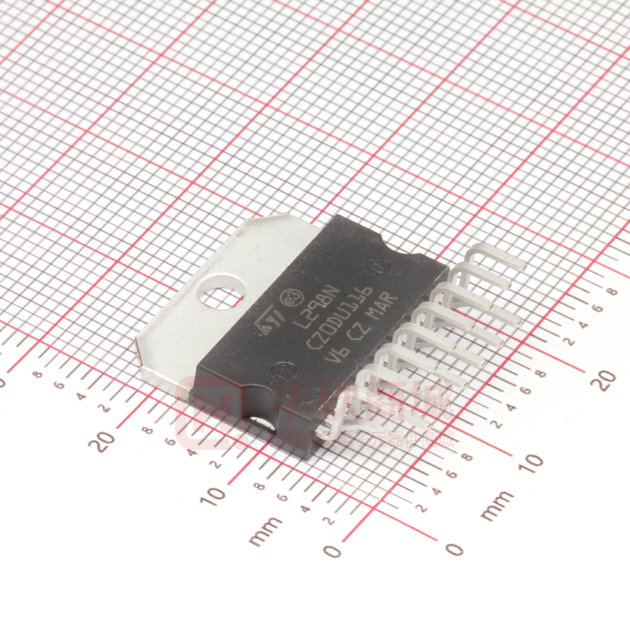

L298N 数据手册
L298 ® DUAL FULL-BRIDGE DRIVER .. .. . OPERATING SUPPLY VOLTAGE UP TO 46 V TOTAL DC CURRENT UP TO 4 A LOW SATURATION VOLTAGE OVERTEMPERATURE PROTECTION LOGICAL "0" INPUT VOLTAGE UP TO 1.5 V (HIGH NOISE IMMUNITY) DESCRIPTION The L298 is an integrated monolithic circuit in a 15lead Multiwatt and PowerSO20 packages. It is a high voltage, high current dual full-bridge driver designed to accept standard TTL logic levels and drive inductive loads such as relays, solenoids, DC and stepping motors. Two enable inputs are provided to enable or disable the device independently of the input signals. The emitters of the lower transistors of each bridge are connected together and the corresponding external terminal can be used for the con- Multiwatt15 PowerSO20 ORDERING NUMBERS : L298N (Multiwatt Vert.) L298HN (Multiwatt Horiz.) L298P (PowerSO20) nection of an external sensing resistor. An additional supply input is provided so that the logic works at a lower voltage. BLOCK DIAGRAM Jenuary 2000 1/13 L298 ABSOLUTE MAXIMUM RATINGS Symbol VS VSS VI,Ven IO Vsens Value Unit Power Supply Parameter 50 V Logic Supply Voltage 7 V –0.3 to 7 V 3 2.5 2 A A A Input and Enable Voltage Peak Output Current (each Channel) – Non Repetitive (t = 100µs) –Repetitive (80% on –20% off; ton = 10ms) –DC Operation Sensing Voltage –1 to 2.3 V 25 W Junction Operating Temperature –25 to 130 °C Storage and Junction Temperature –40 to 150 °C Ptot Total Power Dissipation (Tcase = 75°C) Top Tstg, Tj PIN CONNECTIONS (top view) Multiwatt15 15 CURRENT SENSING B 14 OUTPUT 4 13 OUTPUT 3 12 INPUT 4 11 ENABLE B 10 INPUT 3 9 LOGIC SUPPLY VOLTAGE VSS 8 GND 7 INPUT 2 6 ENABLE A 5 INPUT 1 4 SUPPLY VOLTAGE VS 3 OUTPUT 2 2 OUTPUT 1 1 CURRENT SENSING A TAB CONNECTED TO PIN 8 D95IN240A GND 1 20 GND Sense A 2 19 Sense B N.C. 3 18 N.C. Out 1 4 Out 2 5 PowerSO20 17 Out 4 16 Out 3 VS 6 15 Input 4 Input 1 7 14 Enable B Enable A 8 13 Input 3 Input 2 9 12 VSS 10 11 GND GND D95IN239 THERMAL DATA Symbol Parameter PowerSO20 Multiwatt15 Unit Rth j-case Thermal Resistance Junction-case Max. – 3 °C/W Rth j-amb Thermal Resistance Junction-ambient Max. 13 (*) 35 °C/W (*) Mounted on aluminum substrate 2/13 L298 PIN FUNCTIONS (refer to the block diagram) MW.15 PowerSO Name 1;15 2;19 Sense A; Sense B Function 2;3 4;5 Out 1; Out 2 4 6 VS 5;7 7;9 Input 1; Input 2 6;11 8;14 Enable A; Enable B 8 1,10,11,20 GND 9 12 VSS 10; 12 13;15 Input 3; Input 4 13; 14 16;17 Out 3; Out 4 – 3;18 N.C. Between this pin and ground is connected the sense resistor to control the current of the load. Outputs of the Bridge A; the current that flows through the load connected between these two pins is monitored at pin 1. Supply Voltage for the Power Output Stages. A non-inductive 100nF capacitor must be connected between this pin and ground. TTL Compatible Inputs of the Bridge A. TTL Compatible Enable Input: the L state disables the bridge A (enable A) and/or the bridge B (enable B). Ground. Supply Voltage for the Logic Blocks. A100nF capacitor must be connected between this pin and ground. TTL Compatible Inputs of the Bridge B. Outputs of the Bridge B. The current that flows through the load connected between these two pins is monitored at pin 15. Not Connected ELECTRICAL CHARACTERISTICS (VS = 42V; VSS = 5V, Tj = 25°C; unless otherwise specified) Symbol Parameter Test Conditions Supply Voltage (pin 4) Operative Condition IS Logic Supply Voltage (pin 9) Quiescent Supply Current (pin 4) Ven = H; IL = 0 ISS Ven = L Quiescent Current from VSS (pin 9) Ven = H; IL = 0 VS VSS ViH IiL IiH Ven = L Input Low Voltage (pins 5, 7, 10, 12) Input High Voltage (pins 5, 7, 10, 12) Low Voltage Input Current (pins 5, 7, 10, 12) High Voltage Input Current (pins 5, 7, 10, 12) Enable Low Voltage (pins 6, 11) Ven = H Ien = L Enable High Voltage (pins 6, 11) Low Voltage Enable Current (pins 6, 11) Ien = H High Voltage Enable Current (pins 6, 11) Source Saturation Voltage VCEsat (H) VCEsat (L) Sink Saturation Voltage VCEsat Total Drop Vsens Sensing Voltage (pins 1, 15) Max. Unit 46 V 5 13 50 7 22 70 V mA mA 24 7 4 36 12 mA mA mA –0.3 6 1.5 mA V 2.3 VSS V –10 µA 100 µA 4.5 Ven = L ViL Min. Typ. VIH +2.5 Vi = L Vi = H Vi = X Vi = L Vi = H Vi = X Vi = L Vi = H ≤ VSS –0.6V 30 –0.3 1.5 V 2.3 VSS –10 V µA 30 100 µA 1.35 2 1.2 1.7 1.7 2.7 1.6 2.3 3.2 4.9 V V V V V V 2 V Ven = L Ven = H ≤ VSS –0.6V IL = 1A IL = 2A IL = 1A IL = 2A IL = 1A IL = 2A 0.95 (5) (5) (5) (5) 0.85 1.80 –1 (1) 3/13 L298 ELECTRICAL CHARACTERISTICS (continued) Symbol Parameter Test Conditions Min. Typ. Max. Unit (2); (4) 1.5 µs 0.9 IL to 0.1 IL (2); (4) 0.2 µs 0.5 Vi to 0.1 IL (2); (4) 2 µs Source Current Rise Time 0.1 IL to 0.9 IL (2); (4) 0.7 µs T5 (Vi) Sink Current Turn-off Delay 0.5 Vi to 0.9 IL (3); (4) 0.7 µs T6 (Vi) Sink Current Fall Time 0.9 IL to 0.1 IL (3); (4) 0.25 µs T7 (Vi) Sink Current Turn-on Delay 0.5 Vi to 0.9 IL (3); (4) 1.6 µs T8 (Vi) Sink Current Rise Time 0.1 IL to 0.9 IL (3); (4) 0.2 µs T1 (Vi) Source Current Turn-off Delay 0.5 Vi to 0.9 IL T2 (Vi) Source Current Fall Time T3 (Vi) Source Current Turn-on Delay T4 (Vi) Commutation Frequency IL = 2A T1 (Ven) fc (Vi) Source Current Turn-off Delay 0.5 Ven to 0.9 IL 25 T2 (Ven) Source Current Fall Time 0.9 IL to 0.1 IL T3 (Ven) Source Current Turn-on Delay 0.5 Ven to 0.1 IL T4 (Ven) Source Current Rise Time 0.1 IL to 0.9 IL T5 (Ven) Sink Current Turn-off Delay 0.5 Ven to 0.9 IL T6 (Ven) Sink Current Fall Time 0.9 IL to 0.1 IL T7 (Ven) Sink Current Turn-on Delay 0.5 Ven to 0.9 IL T8 (Ven) Sink Current Rise Time 0.1 IL to 0.9 IL (2); (4) (2); (4) (2); (4) (2); (4) (3); (4) (3); (4) (3); (4) (3); (4) 40 µs 1 µs 0.3 µs 0.4 µs 2.2 µs 0.35 µs 0.25 µs 0.1 µs 1) 1)Sensing voltage can be –1 V for t ≤ 50 µsec; in steady state Vsens min ≥ – 0.5 V. 2) See fig. 2. 3) See fig. 4. 4) The load must be a pure resistor. Figure 1 : Typical Saturation Voltage vs. Output Current. Figure 2 : Switching Times Test Circuits. Note : For INPUT Switching, set EN = H For ENABLE Switching, set IN = H 4/13 KHz 3 L298 Figure 3 : Source Current Delay Times vs. Input or Enable Switching. Figure 4 : Switching Times Test Circuits. Note : For INPUT Switching, set EN = H For ENABLE Switching, set IN = L 5/13 L298 Figure 5 : Sink Current Delay Times vs. Input 0 V Enable Switching. Figure 6 : Bidirectional DC Motor Control. Inputs Ven = H Ven = L L = Low 6/13 C=H;D=L C=L;D=H C=D C=X;D=X H = High Function Forward Reverse Fast Motor Stop Free Running Motor Stop X = Don’t care L298 Figure 7 : For higher currents, outputs can be paralleled. Take care to parallel channel 1 with channel 4 and channel 2 with channel 3. APPLICATION INFORMATION (Refer to the block diagram) Each input must be connected to the source of the 1.1. POWER OUTPUT STAGE driving signals by means of a very short path. The L298 integrates two power output stages (A ; B). Turn-On and Turn-Off : Before to Turn-ON the SupThe power output stage is a bridge configuration ply Voltage and before to Turn it OFF, the Enable inand its outputs can drive an inductive load in comput must be driven to the Low state. mon or differenzial mode, depending on the state of the inputs. The current that flows through the load 3. APPLICATIONS comes out from the bridge at the sense output : an Fig 6 shows a bidirectional DC motor control Scheexternal resistor (RSA ; RSB.) allows to detect the inmatic Diagram for which only one bridge is needed. tensity of this current. The external bridge of diodes D1 to D4 is made by 1.2. INPUT STAGE four fast recovery elements (trr ≤ 200 nsec) that Each bridge is driven by means of four gates the inmust be chosen of a VF as low as possible at the put of which are In1 ; In2 ; EnA and In3 ; In4 ; EnB. worst case of the load current. The In inputs set the bridge state when The En input The sense output voltage can be used to control the is high ; a low state of the En input inhibits the bridge. current amplitude by chopping the inputs, or to proAll the inputs are TTL compatible. vide overcurrent protection by switching low the enable input. 2. SUGGESTIONS The brake function (Fast motor stop) requires that A non inductive capacitor, usually of 100 nF, must the Absolute Maximum Rating of 2 Amps must be foreseen between both Vs and Vss, to ground, never be overcome. as near as possible to GND pin. When the large capacitor of the power supply is too far from the IC, a When the repetitive peak current needed from the second smaller one must be foreseen near the load is higher than 2 Amps, a paralleled configuraL298. tion can be chosen (See Fig.7). The sense resistor, not of a wire wound type, must An external bridge of diodes are required when inbe grounded near the negative pole of Vs that must ductive loads are driven and when the inputs of the be near the GND pin of the I.C. IC are chopped ; Shottky diodes would be preferred. 7/13 L298 This solution can drive until 3 Amps In DC operation and until 3.5 Amps of a repetitive peak current. On Fig 8 it is shown the driving of a two phase bipolar stepper motor ; the needed signals to drive the inputs of the L298 are generated, in this example, from the IC L297. Fig 9 shows an example of P.C.B. designed for the application of Fig 8. Fig 10 shows a second two phase bipolar stepper motor control circuit where the current is controlled by the I.C. L6506. Figure 8 : Two Phase Bipolar Stepper Motor Circuit. This circuit drives bipolar stepper motors with winding currents up to 2 A. The diodes are fast 2 A types. RS1 = RS2 = 0.5 Ω D1 to D8 = 2 A Fast diodes 8/13 { VF ≤ 1.2 V @ I = 2 A trr ≤ 200 ns L298 Figure 9 : Suggested Printed Circuit Board Layout for the Circuit of fig. 8 (1:1 scale). Figure 10 : Two Phase Bipolar Stepper Motor Control Circuit by Using the Current Controller L6506. RR and Rsense depend from the load current 9/13 L298 mm DIM. MIN. TYP. inch MAX. MIN. TYP. MAX. A 5 0.197 B 2.65 0.104 C 1.6 D 0.063 1 0.039 E 0.49 0.55 0.019 0.022 F 0.66 0.75 0.026 0.030 G 1.02 1.27 1.52 0.040 0.050 0.060 G1 17.53 17.78 18.03 0.690 0.700 0.710 H1 19.6 0.772 H2 20.2 0.795 L 21.9 22.2 22.5 0.862 0.874 0.886 L1 21.7 22.1 22.5 0.854 0.870 0.886 L2 17.65 18.1 0.695 L3 17.25 17.5 17.75 0.679 0.689 0.699 L4 10.3 10.7 10.9 0.406 0.421 0.429 L7 2.65 2.9 0.104 0.713 0.114 M 4.25 4.55 4.85 0.167 0.179 0.191 M1 4.63 5.08 5.53 0.182 0.200 0.218 S 1.9 2.6 0.075 S1 1.9 2.6 0.075 0.102 Dia1 3.65 3.85 0.144 0.152 10/13 OUTLINE AND MECHANICAL DATA 0.102 Multiwatt15 V L298 mm DIM. MIN. TYP. inch MAX. MIN. TYP. MAX. A 5 0.197 B 2.65 0.104 C 1.6 0.063 E 0.49 0.55 0.019 0.022 F 0.66 0.75 0.026 0.030 G 1.14 1.27 1.4 0.045 0.050 0.055 G1 17.57 17.78 17.91 0.692 0.700 0.705 H1 19.6 0.772 H2 20.2 0.795 L 20.57 0.810 L1 18.03 0.710 L2 2.54 L3 17.25 L4 10.3 L5 0.100 17.5 17.75 0.679 0.689 0.699 10.7 10.9 0.406 0.421 0.429 5.28 L6 OUTLINE AND MECHANICAL DATA 0.208 2.38 0.094 L7 2.65 2.9 0.104 0.114 S 1.9 2.6 0.075 0.102 S1 1.9 2.6 0.075 0.102 Dia1 3.65 3.85 0.144 0.152 Multiwatt15 H 11/13 L298 DIM. A a1 a2 a3 b c D (1) D1 E e e3 E1 (1) E2 E3 G H h L N S T MIN. mm TYP. 0.1 0 0.4 0.23 15.8 9.4 13.9 MAX. 3.6 0.3 3.3 0.1 0.53 0.32 16 9.8 14.5 MIN. 0.004 0.000 0.016 0.009 0.622 0.370 0.547 1.27 11.43 10.9 inch TYP. 0.050 0.450 11.1 0.429 2.9 6.2 0.228 0.1 0.000 15.9 0.610 1.1 1.1 0.031 10˚ (max.) 8˚ (max.) 5.8 0 15.5 0.8 OUTLINE AND MECHANICAL DATA MAX. 0.142 0.012 0.130 0.004 0.021 0.013 0.630 0.386 0.570 10 0.437 0.114 0.244 0.004 0.626 0.043 0.043 JEDEC MO-166 0.394 PowerSO20 (1) "D and F" do not include mold flash or protrusions. - Mold flash or protrusions shall not exceed 0.15 mm (0.006"). - Critical dimensions: "E", "G" and "a3" N R N a2 b A e DETAIL A c a1 DETAIL B E e3 H DETAIL A lead D slug a3 DETAIL B 20 11 0.35 Gage Plane -C- S SEATING PLANE L G E2 E1 BOTTOM VIEW T E3 1 h x 45 12/13 10 PSO20MEC C (COPLANARITY) D1 L298 Information furnished is believed to be accurate and reliable. However, STMicroelectronics assumes no responsibility for the consequences of use of such information nor for any infringement of patents or other rights of third parties which may result from its use. No license is granted by implication or otherwise under any patent or patent rights of STMicroelectronics. Specification mentioned in this publication are subject to change without notice. This publication supersedes and replaces all information previously supplied. STMicroelectronics products are not authorized for use as critical components in life support devices or systems without express written approval of STMicroelectronics. The ST logo is a registered trademark of STMicroelectronics © 2000 STMicroelectronics – Printed in Italy – All Rights Reserved STMicroelectronics GROUP OF COMPANIES Australia - Brazil - China - Finland - France - Germany - Hong Kong - India - Italy - Japan - Malaysia - Malta - Morocco Singapore - Spain - Sweden - Switzerland - United Kingdom - U.S.A. http://www.st.com 13/13
