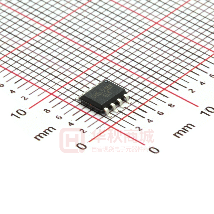

LM193, LM193A, LM293, LM293A, LM393, LM393A Low Power Dual Voltage Comparators ■ ■ ■ ■ ■ ■ ■ ■ ■ Wide single-supply voltage range or dual supplies: +2V to +36V or ±1V to ±18V Very low supply current (0.4mA) independent of supply voltage (1mW/comparator at +5V) Low input bias current: 25nA typ. Low input offset current: ±5nA typ. Low input offset voltage: ±1mV typ. Input common-mode voltage range includes ground Low output saturation voltage: 250mV typ. (Io = 4mA) Differential input voltage range equal to the supply voltage TTL, DTL, ECL, MOS, CMOS compatible outputs N DIP8 (Plastic Package) D SO-8 (Plastic Micropackage) P TSSOP8 (Thin Shrink Small Outline Package) S Mini SO-8 (Plastic Micropackage) Description These devices consist of two independent low voltage comparators designed specifically to operate from a single supply over a wide range of voltages. Operation from split power supplies is also possible. These comparators also have a unique characteristic in that the input common-mode voltage range includes ground even though operated from a single power supply voltage. Pin connections (top view) 1 - Output 1 2 - Inverting input 1 3 - Non-inverting input 1 4 - VCC5 - Non-inverting input 2 6 - Inverting input 2 7 - Output 2 8 - VCC+ 1 2 3 4 + + 8 7 6 5 February 2006 Rev. 6 1/15 www.st.com 15 Order Codes LM193, LM193A, LM293, LM293A, LM393, LM393A 1 Order Codes Part Number Temperature Range Package SO-8 DIP8 -55°C, +125°C SO-8 DIP8 SO-8 DIP8 SO-8 -40°C, +105°C DIP8 TSSOP8 (Thin Shrink Outline Package) Mini SO-8 SO-8 SO-8 DIP8 0°C, +70°C TSSOP8 (Thin Shrink Outline Package) Mini SO-8 -40°C, +125°C SO-8 (automotive grade level) Packing Tube or Tape & Reel Tube Tube or Tape & Reel Tube Tube or Tape & Reel Tube Tube or Tape & Reel Tube Tape & Reel Tape & Reel Tube or Tape & Reel Tube or Tape & Reel Tube Tape & Reel Tape & Reel Tube or Tape & Reel Marking LM193AD/LM193ADT LM193AN LM193D/LM193DT LM193N LM293AD/LM293ADT LM293AN LM293D/LM293DT LM293N LM293PT LM293ST LM393AD/LM393ADT LM393D/LM393DT LM393N LM393PT LM393ST LM393YDT/YD 2/15 LM193, LM193A, LM293, LM293A, LM393, LM393A Schematic Diagram (1/2 LM193) 2 Schematic Diagram (1/2 LM193) VCC 3.5µA 100µA 3.5µA 100µA Non-inverting Input VCC Inverting Input VCC VO VCC 3/15 Absolute Maximum Ratings LM193, LM193A, LM293, LM293A, LM393, LM393A 3 Absolute Maximum Ratings Table 1. Symbol VCC Vid Vi Supply Voltage Differential Input Voltage Input Voltage Output Short-circuit to Ground - note (1) Power Dissipation DIP-8 SO-8 TSSOP8 Mini SO-8 (2) Key parameters and their absolute maximum ratings Parameter Value ±18 or 36 ±36 -0.3 to +36 Infinite 1250 710 625 580 -65 to +150 Unit V V V Pd mW Tstg Storage Temperature Range + °C 1. Short-circuits from the output to VCC can cause excessive heating and eventual destruction. The maximum output current is approximately 20mA independent of the magnitude of V CC +. 2. Pd is calculated with Tamb = +25°C, Tj = +150°C and Rthja = 100°C/W for DIP8 package Rthja = 175°C/W for SO-8 package Rthja = 200°C/W for TSSOP8 package Rthja = 215°C/W for Mini SO-8 package Table 2. Symbol Vicm Operating conditions Parameter Common Mode Input Voltage Range Operating Free-Air Temperature range LM193, A LM293, A LM393, A Value 0 to VCC + -1.5 -55 to +125 -40 to +105 0 to +70 Unit V Toper °C 4/15 LM193, LM193A, LM293, LM293A, LM393, LM393A Electrical Characteristics 4 Table 3. Symbol Electrical Characteristics VCC+ = +5V, VCC-= 0V, Tamb = +25°C (unless otherwise specified) Parameter Input Offset Voltage - note (1) Tamb = +25°C Tmin ≤ T amb ≤ T max Input Offset Current Tamb = +25°C Tmin ≤ T amb ≤ T max Input Bias Current (I+ or I-) - note (2) Tamb = +25°C Tmin ≤ T amb ≤ T max Large Signal Voltage Gain VCC = 15V, RL = 15kΩ, Vo = 1V to 11V Supply Current (all comparators) VCC = +5V, no load VCC = +30V, no load Input Common Mode Voltage Range - note (3) VCC = 30V Tamb = +25°C Tmin ≤ T amb ≤ T max Differential Input Voltage -note (4) Low Level Output Voltage Vid = -1V, Isink = 4mA Tamb = +25°C Tmin ≤ T amb ≤ T max High Level Output Current (Vid = 1V) VCC = Vo = 30V Tamb = +25°C Tmin ≤ T amb ≤ T max Output Sink Current Vid = 1V, Vo = 1.5V Response Time - note (5) RL= 5.1kΩ connected to VCC+ Large Signal Response Time RL= 5.1kΩ connected to VCC+, el = TTL, V(ref) = +1.4v 6 50 LM193A - LM293A LM393A Min. Vio Typ. 1 Max. 2 4 25 100 100 300 50 1 2.5 LM193- LM293 LM393 Min Typ. 1 Max. 5 9 50 150 250 400 mV Unit Iio 3 5 nA Iib Avd ICC 25 25 nA 200 0.4 1 200 0.4 1 1 2.5 V/mV mA Vicm Vid VOL 0 0 VCC+ -1.5 VCC+ -2 VCC+ 0 0 VCC+ -1.5 VCC+ -2 VCC+ V 250 400 700 250 400 700 mV IOH 0.1 1 16 1.3 6 0.1 1 16 1.3 nA µA mA µs ns ISINK tre trel 300 300 1. At output switch point, Vo ≈ 1.4V, Rs = 0 with VCC+ from 5V to 30V, and over the full common-mode range (0V to VCC + 1.5V). 2. The direction of the input current is out of the IC due to the PNP input stage. This current is essentially constant, independent of the state of the output, so no loading charge exists on the reference of input lines. 3. The input common-mode voltage of either input signal voltage should not be allowed to go negative by more than 0.3V. The upper end of the common-mode voltage range is VCC+ -1.5V, but either or both inputs can go to +30V without damage. 4. The response time specified is for a 100mV input step with 5mV overdrive. For larger overdrive signals 300ns can be obtained. 5. Positive excursions of input voltage may exceed the power supply level. As long as the other voltage remains within the common-mode range, the comparator will provide a proper output state. The low input voltage state must not be less than 0.3V (or 0.3V bellow the negative power supply, if used). 5/15 Electrical Characteristics LM193, LM193A, LM293, LM293A, LM393, LM393A Figure 1. Supply current vs. supply voltage Figure 2. 80 Input current vs. supply voltage 1 SUPPLY CURRENT (mA) INPUT CURRENT (nA) Tamb = -55°C Vi = 0V 60 40 20 Tamb = +125°C Tamb = +70°C 0 10 20 30 SUPPLY VOLTAGE (V) 40 R = 10 9 Ω i 0.8 0.6 0.4 Tamb = 0°C Tamb= +25°C Tamb = +70°C Tamb = -55°C Tamb = 0°C Tamb= +25°C Tamb = +125°C 0.2 R= 0 10 20 30 SUPPLY VOLTAGE (V) 40 Figure 3. Output saturation voltage vs. frequency Figure 4. Response time for various input overdrives - negative transition SATURATION VOLTAGE (V) 10 10 10 10 10 1 OUTPUT VOLTAGE (V) INPUT VOLTAGE (mV) Out of saturation 0 Tamb = +125°C -1 Tamb = -55°C -2 Tamb= +25°C -3 -2 -1 0 1 2 6 5 4 3 2 1 0 0 -50 -100 Input overdrive : 5mV 20mV eI 5V 5.1kΩ eo 100mV Tamb= +25°C 0 0.5 1 1.5 TIME (µs) 2 10 10 10 10 10 OUTPUT SINK CURRENT (mA) Figure 5. Response time for various input overdrives - positive transition 6 15 4 3 2 1 0 00 50 0 OUTPUT VOLTAGE (V) INPUT VOLTAGE (mV) Input overdrive : 100mV 5mV 20mV eI eo 5V 5.1kΩ Tamb = +25°C 0 0.5 1 1.5 TIME (µ s) 2 6/15 LM193, LM193A, LM293, LM293A, LM393, LM393A Electrical Characteristics 4.1 Figure 6. Typical applications Basic comparator Figure 7. Driving TTL VCC = 5V 15kΩ +V(ref) -V(ref) +V(ref) 5V 10k W 1/2 LM193 1/2 LM193 & & VO -V(ref) Figure 8. Low frequency op-amp 5V Figure 9. Driving CMOS (e o = 0V for e I = 0V) 5V 15k W 1/2 LM193 ~ 2N 2222 0.5mF 100k W +V(ref) 1/2 LM193 eI & 100kW 1kW eo A V = 100 -V(ref) Figure 10. Low frequency op-amp 5V Figure 11. Transducer amplifier 5V 15kW 1/2 LM193 ~ Magnetic pick-up 10kW 3kW eI 100kW 1kW A V = 100 1/2 LM193 eo eo 0.5mF 10kW 20MW 7/15 Electrical Characteristics LM193, LM193A, LM293, LM293A, LM393, LM393A Figure 12. Low frequency op-amp with offset adjust 5V Offset Adjust 100kW 5V R2 Rs RI 1MW 1MW 15kW 1/2 LM193 Figure 13. Zero crossing detector (single power supply) 5V 100kW eI 2N 2222 100kW 5.1kW 5.1kW 5.1kW 1/2 LM193 eI ~ 0.5m F R1 100kW 1kW 1N4148 20MW 10kW eo Figure 14. Limit comparator VCC (12V) Figure 15. Crystal controlled oscillator V = 15V CC 2R S V(ref) high 10kW 1/2 LM193 200k W 100kW 2kW RS Lamp 0.1mF 1/2 LM193 V CC 0 eo eI ~ 2R S V(ref) low 1/2 LM193 f = 100kHz 2N 2222 200kW Figure 16. Split-supply applications - zero crossing detector 15V Figure 17. Comparator with a negative reference 15V 5.1k W 1/2 LM193 1/2 LM193 5.1k W eo eI ~ eo eI ~ 5V 15V 15V 8/15 LM193, LM193A, LM293, LM293A, LM393, LM393A Figure 18. Two-decade high-frequency VCO Electrical Characteristics V CC 100kW 100k W V CC 500pF 1/2 LM193 3k W 5.1k W 0.01m F 1/2 LM193 3k W Frequency control voltage input vcontrol 0.1m F 20kW 50kW 20k W Output 1 VCC /2 Output 2 1/2 LM193 VCC /2 V = +30V CC +250mV V control +50V 700 Hz fo 100kHz 9/15 Package Mechanical Data LM193, LM193A, LM293, LM293A, LM393, LM393A 5 Package Mechanical Data In order to meet environmental requirements, ST offers these devices in ECOPACK® packages. These packages have a Lead-free second level interconnect. The category of second level interconnect is marked on the package and on the inner box label, in compliance with JEDEC Standard JESD97. The maximum ratings related to soldering conditions are also marked on the inner box label. ECOPACK is an ST trademark. ECOPACK specifications are available at: www.st.com. 5.1 DIP8 package Plastic DIP-8 MECHANICAL DATA mm. DIM. MIN. A a1 B B1 b b1 D E e e3 e4 F I L Z 0.44 3.3 1.6 0.017 8.8 2.54 7.62 7.62 7.1 4.8 0.130 0.063 0.38 0.7 1.39 0.91 0.5 0.5 9.8 0.346 0.100 0.300 0.300 0.280 0.189 0.015 1.65 1.04 TYP 3.3 0.028 0.055 0.036 0.020 0.020 0.386 0.065 0.041 MAX. MIN. TYP. 0.130 MAX. inch P001F 10/15 LM193, LM193A, LM293, LM293A, LM393, LM393A Package Mechanical Data 5.2 SO8 package SO-8 MECHANICAL DATA DIM. A A1 A2 B C D E e H h L k ddd 0.1 5.80 0.25 0.40 mm. MIN. 1.35 0.10 1.10 0.33 0.19 4.80 3.80 1.27 6.20 0.50 1.27 8˚ (max.) 0.04 0.228 0.010 0.016 TYP MAX. 1.75 0.25 1.65 0.51 0.25 5.00 4.00 MIN. 0.053 0.04 0.043 0.013 0.007 0.189 0.150 0.050 0.244 0.020 0.050 inch TYP. MAX. 0.069 0.010 0.065 0.020 0.010 0.197 0.157 0016023/C 11/15 Package Mechanical Data LM193, LM193A, LM293, LM293A, LM393, LM393A 5.3 TSSOP8 package TSSOP8 MECHANICAL DATA mm. DIM. MIN. A A1 A2 b c D E E1 e K L L1 0˚ 0.45 0.60 1 0.05 0.80 0.19 0.09 2.90 6.20 4.30 3.00 6.40 4.40 0.65 8˚ 0.75 0˚ 0.018 0.024 0.039 1.00 TYP MAX. 1.2 0.15 1.05 0.30 0.20 3.10 6.60 4.50 0.002 0.031 0.007 0.004 0.114 0.244 0.169 0.118 0.252 0.173 0.0256 8˚ 0.030 0.039 MIN. TYP. MAX. 0.047 0.006 0.041 0.012 0.008 0.122 0.260 0.177 inch 0079397/D 12/15 LM193, LM193A, LM293, LM293A, LM393, LM393A Package Mechanical Data 5.4 MiniSO8 package 13/15 Revision History LM193, LM193A, LM293, LM293A, LM393, LM393A 6 Revision History Table 4. Date July 2002 Jan. 2005 May 2005 July 2005 Nov. 2005 Feb. 2006 Document revision history Revision 1 2 3 4 5 6 First Release Class A of the product included in the datasheet. PPAP references inserted in the datasheet see Table 1 on page 2 . Modification on PPAP references - Errors on part numbers see Table 1 on page 2. Modification on Table 3 on page 5. LM293,A must be 40/+105°C instead of -40/+125°C. Unit error for Vol parameter see Table 3 on page 5. Changes 14/15 LM193, LM193A, LM293, LM293A, LM393, LM393A Revision History Please Read Carefully: Information in this document is provided solely in connection with ST products. STMicroelectronics NV and its subsidiaries (“ST”) reserve the right to make changes, corrections, modifications or improvements, to this document, and the products and services described herein at any time, without notice. All ST products are sold pursuant to ST’s terms and conditions of sale. Purchasers are solely responsible for the choice, selection and use of the ST products and services described herein, and ST assumes no liability whatsoever relating to the choice, selection or use of the ST products and services described herein. No license, express or implied, by estoppel or otherwise, to any intellectual property rights is granted under this document. If any part of this document refers to any third party products or services it shall not be deemed a license grant by ST for the use of such third party products or services, or any intellectual property contained therein or considered as a warranty covering the use in any manner whatsoever of such third party products or services or any intellectual property contained therein. UNLESS OTHERWISE SET FORTH IN ST’S TERMS AND CONDITIONS OF SALE ST DISCLAIMS ANY EXPRESS OR IMPLIED WARRANTY WITH RESPECT TO THE USE AND/OR SALE OF ST PRODUCTS INCLUDING WITHOUT LIMITATION IMPLIED WARRANTIES OF MERCHANTABILITY, FITNESS FOR A PARTICULAR PURPOSE (AND THEIR EQUIVALENTS UNDER THE LAWS OF ANY JURISDICTION), OR INFRINGEMENT OF ANY PATENT, COPYRIGHT OR OTHER INTELLECTUAL PROPERTY RIGHT. UNLESS EXPRESSLY APPROVED IN WRITING BY AN AUTHORIZE REPRESENTATIVE OF ST, ST PRODUCTS ARE NOT DESIGNED, AUTHORIZED OR WARRANTED FOR USE IN MILITARY, AIR CRAFT, SPACE, LIFE SAVING, OR LIFE SUSTAINING APPLICATIONS, NOR IN PRODUCTS OR SYSTEMS, WHERE FAILURE OR MALFUNCTION MAY RESULT IN PERSONAL INJURY, DEATH, OR SEVERE PROPERTY OR ENVIRONMENTAL DAMAGE. Resale of ST products with provisions different from the statements and/or technical features set forth in this document shall immediately void any warranty granted by ST for the ST product or service described herein and shall not create or extend in any manner whatsoever, any liability of ST. ST and the ST logo are trademarks or registered trademarks of ST in various countries. Information in this document supersedes and replaces all information previously supplied. The ST logo is a registered trademark of STMicroelectronics. All other names are the property of their respective owners. © 2006 STMicroelectronics - All rights reserved STMicroelectronics group of companies Australia - Belgium - Brazil - Canada - China - Czech Republic - Finland - France - Germany - Hong Kong - India - Israel - Italy - Japan Malaysia - Malta - Morocco - Singapore - Spain - Sweden - Switzerland - United Kingdom - United States of America www.st.com 15/15
