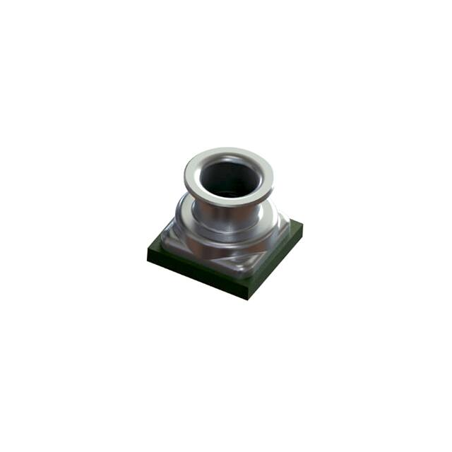

LPS33W MEMS pressure sensor: 260-1260 hPa absolute digital output barometer with potted gel package Datasheet - production data Applications  Wearable devices  Altimeters and barometers for portable devices  GPS applications  Weather station equipment  e-cigarettes Description Features  Pressure sensor with potted gel package  260 to 1260 hPa absolute pressure range  Current consumption down to 3 μA  High overpressure capability: 20x full scale  Embedded temperature compensation  24-bit pressure data output  16-bit temperature data output  ODR from 1 Hz to 75 Hz  SPI and I²C interfaces  Embedded FIFO  Interrupt functions: data-ready, FIFO flags, pressure thresholds The LPS33W is an ultra-compact piezoresistive pressure sensor which functions as a digital output barometer. The device comprises a sensing element and an IC interface which communicates through I2C or SPI from the sensing element to the application. The sensing element, which detects absolute pressure, consists of a suspended membrane manufactured using a dedicated process developed by ST. The LPS33W is available in a ceramic LGA package with metal lid. It is guaranteed to operate over a temperature range extending from -40 °C to +85 °C. The package is holed to allow external pressure to reach the sensing element. Gel inside the IC protects the electrical components from harsh environmental conditions.  Supply voltage: 1.7 to 3.6 V  ECOPACK® lead-free compliant Table 1. Device summary Order codes LPS33WTR LPS33W Temperature range [°C] Package -40 to +85°C CCLGA-10L January 2019 This is information on a product in full production. DocID032364 Rev 1 Packing Tape and reel Tray 1/52 www.st.com Contents LPS33W Contents 1 Block diagram and pin description . . . . . . . . . . . . . . . . . . . . . . . . . . . . . 7 2 Mechanical and electrical specifications . . . . . . . . . . . . . . . . . . . . . . . . 9 2.1 Mechanical characteristics . . . . . . . . . . . . . . . . . . . . . . . . . . . . . . . . . . . . . 9 2.2 Electrical characteristics . . . . . . . . . . . . . . . . . . . . . . . . . . . . . . . . . . . . . . 10 2.3 Communication interface characteristics . . . . . . . . . . . . . . . . . . . . . . . . . 11 2.4 3 4 5 2.3.2 I2C - inter-IC control interface . . . . . . . . . . . . . . . . . . . . . . . . . . . . . . . . 12 Absolute maximum ratings . . . . . . . . . . . . . . . . . . . . . . . . . . . . . . . . . . . . 13 3.1 Sensing element . . . . . . . . . . . . . . . . . . . . . . . . . . . . . . . . . . . . . . . . . . . . 14 3.2 IC interface . . . . . . . . . . . . . . . . . . . . . . . . . . . . . . . . . . . . . . . . . . . . . . . . 14 3.3 Factory calibration . . . . . . . . . . . . . . . . . . . . . . . . . . . . . . . . . . . . . . . . . . 14 3.4 Device structure . . . . . . . . . . . . . . . . . . . . . . . . . . . . . . . . . . . . . . . . . . . . 15 3.5 Interpreting pressure readings . . . . . . . . . . . . . . . . . . . . . . . . . . . . . . . . . 16 FIFO . . . . . . . . . . . . . . . . . . . . . . . . . . . . . . . . . . . . . . . . . . . . . . . . . . . . . 17 4.1 Bypass mode . . . . . . . . . . . . . . . . . . . . . . . . . . . . . . . . . . . . . . . . . . . . . . 17 4.2 FIFO mode . . . . . . . . . . . . . . . . . . . . . . . . . . . . . . . . . . . . . . . . . . . . . . . . 18 4.3 Stream mode . . . . . . . . . . . . . . . . . . . . . . . . . . . . . . . . . . . . . . . . . . . . . . 19 4.4 Dynamic-Stream mode . . . . . . . . . . . . . . . . . . . . . . . . . . . . . . . . . . . . . . . 20 4.5 Stream-to-FIFO mode . . . . . . . . . . . . . . . . . . . . . . . . . . . . . . . . . . . . . . . 21 4.6 Bypass-to-Stream mode . . . . . . . . . . . . . . . . . . . . . . . . . . . . . . . . . . . . . . 22 4.7 Bypass-to-FIFO mode . . . . . . . . . . . . . . . . . . . . . . . . . . . . . . . . . . . . . . . 23 4.8 Retrieving data from FIFO . . . . . . . . . . . . . . . . . . . . . . . . . . . . . . . . . . . . 23 Application hints . . . . . . . . . . . . . . . . . . . . . . . . . . . . . . . . . . . . . . . . . . . 24 Soldering information . . . . . . . . . . . . . . . . . . . . . . . . . . . . . . . . . . . . . . . . 25 Digital interfaces . . . . . . . . . . . . . . . . . . . . . . . . . . . . . . . . . . . . . . . . . . . 26 6.1 2/52 SPI - serial peripheral interface . . . . . . . . . . . . . . . . . . . . . . . . . . . . . . . 11 Functionality . . . . . . . . . . . . . . . . . . . . . . . . . . . . . . . . . . . . . . . . . . . . . . 14 5.1 6 2.3.1 IC serial interface . . . . . . . . . . . . . . . . . . . . . . . . . . . . . . . . . . . . . . . . . . . 26 DocID032364 Rev 1 LPS33W Contents 6.2 I2C serial interface (CS = High) . . . . . . . . . . . . . . . . . . . . . . . . . . . . . . . . 26 6.2.1 6.3 I2C operation . . . . . . . . . . . . . . . . . . . . . . . . . . . . . . . . . . . . . . . . . . . . . 27 SPI bus interface . . . . . . . . . . . . . . . . . . . . . . . . . . . . . . . . . . . . . . . . . . . 29 6.3.1 SPI read . . . . . . . . . . . . . . . . . . . . . . . . . . . . . . . . . . . . . . . . . . . . . . . . . 30 6.3.2 SPI write . . . . . . . . . . . . . . . . . . . . . . . . . . . . . . . . . . . . . . . . . . . . . . . . 31 6.3.3 SPI read in 3-wire mode . . . . . . . . . . . . . . . . . . . . . . . . . . . . . . . . . . . . 32 7 Register mapping . . . . . . . . . . . . . . . . . . . . . . . . . . . . . . . . . . . . . . . . . . 33 8 Register description . . . . . . . . . . . . . . . . . . . . . . . . . . . . . . . . . . . . . . . . 35 8.1 INTERRUPT_CFG (0Bh) . . . . . . . . . . . . . . . . . . . . . . . . . . . . . . . . . . . . . 35 8.2 THS_P_L (0Ch) . . . . . . . . . . . . . . . . . . . . . . . . . . . . . . . . . . . . . . . . . . . . 36 8.3 THS_P_H (0Dh) . . . . . . . . . . . . . . . . . . . . . . . . . . . . . . . . . . . . . . . . . . . . 37 8.4 WHO_AM_I (0Fh) . . . . . . . . . . . . . . . . . . . . . . . . . . . . . . . . . . . . . . . . . . . 37 8.5 CTRL_REG1 (10h) . . . . . . . . . . . . . . . . . . . . . . . . . . . . . . . . . . . . . . . . . . 37 8.6 CTRL_REG2 (11h) . . . . . . . . . . . . . . . . . . . . . . . . . . . . . . . . . . . . . . . . . . 39 8.7 CTRL_REG3 (12h) . . . . . . . . . . . . . . . . . . . . . . . . . . . . . . . . . . . . . . . . . . 40 8.8 FIFO_CTRL (14h) . . . . . . . . . . . . . . . . . . . . . . . . . . . . . . . . . . . . . . . . . . 41 8.9 REF_P_XL (15h) . . . . . . . . . . . . . . . . . . . . . . . . . . . . . . . . . . . . . . . . . . . 42 8.10 REF_P_L (16h) . . . . . . . . . . . . . . . . . . . . . . . . . . . . . . . . . . . . . . . . . . . . 42 8.11 REF_P_H (17h) . . . . . . . . . . . . . . . . . . . . . . . . . . . . . . . . . . . . . . . . . . . . 42 8.12 RPDS_L (18h) . . . . . . . . . . . . . . . . . . . . . . . . . . . . . . . . . . . . . . . . . . . . . 43 8.13 RPDS_H (19h) . . . . . . . . . . . . . . . . . . . . . . . . . . . . . . . . . . . . . . . . . . . . . 43 8.14 RES_CONF (1Ah) . . . . . . . . . . . . . . . . . . . . . . . . . . . . . . . . . . . . . . . . . . 43 8.15 INT_SOURCE (25h) . . . . . . . . . . . . . . . . . . . . . . . . . . . . . . . . . . . . . . . . . 44 8.16 FIFO_STATUS (26h) . . . . . . . . . . . . . . . . . . . . . . . . . . . . . . . . . . . . . . . . 44 8.17 STATUS (27h) . . . . . . . . . . . . . . . . . . . . . . . . . . . . . . . . . . . . . . . . . . . . . 45 8.18 PRESS_OUT_XL (28h) . . . . . . . . . . . . . . . . . . . . . . . . . . . . . . . . . . . . . . 45 8.19 PRESS_OUT_L (29h) . . . . . . . . . . . . . . . . . . . . . . . . . . . . . . . . . . . . . . . 46 8.20 PRESS_OUT_H (2Ah) . . . . . . . . . . . . . . . . . . . . . . . . . . . . . . . . . . . . . . . 46 8.21 TEMP_OUT_L (2Bh) . . . . . . . . . . . . . . . . . . . . . . . . . . . . . . . . . . . . . . . . 46 8.22 TEMP_OUT_H (2Ch) . . . . . . . . . . . . . . . . . . . . . . . . . . . . . . . . . . . . . . . . 46 8.23 LPFP_RES (33h) . . . . . . . . . . . . . . . . . . . . . . . . . . . . . . . . . . . . . . . . . . . 47 DocID032364 Rev 1 3/52 52 Contents 9 10 4/52 LPS33W Package information . . . . . . . . . . . . . . . . . . . . . . . . . . . . . . . . . . . . . . . . 48 9.1 CCLGA 10L package information . . . . . . . . . . . . . . . . . . . . . . . . . . . . . . . 48 9.2 CCLGA 10L packing information . . . . . . . . . . . . . . . . . . . . . . . . . . . . . . . 49 Revision history . . . . . . . . . . . . . . . . . . . . . . . . . . . . . . . . . . . . . . . . . . . 51 DocID032364 Rev 1 LPS33W List of tables List of tables Table 1. Table 2. Table 3. Table 4. Table 5. Table 6. Table 7. Table 8. Table 9. Table 10. Table 11. Table 12. Table 13. Table 14. Table 15. Table 16. Table 17. Table 18. Table 19. Table 20. Table 21. Table 22. Table 23. Table 24. Device summary . . . . . . . . . . . . . . . . . . . . . . . . . . . . . . . . . . . . . . . . . . . . . . . . . . . . . . . . . . 1 Pin description . . . . . . . . . . . . . . . . . . . . . . . . . . . . . . . . . . . . . . . . . . . . . . . . . . . . . . . . . . . 8 Pressure and temperature sensor characteristics . . . . . . . . . . . . . . . . . . . . . . . . . . . . . . . . 9 Electrical characteristics . . . . . . . . . . . . . . . . . . . . . . . . . . . . . . . . . . . . . . . . . . . . . . . . . . . 10 DC characteristics. . . . . . . . . . . . . . . . . . . . . . . . . . . . . . . . . . . . . . . . . . . . . . . . . . . . . . . . 10 SPI slave timing values. . . . . . . . . . . . . . . . . . . . . . . . . . . . . . . . . . . . . . . . . . . . . . . . . . . . 11 I2C slave timing values . . . . . . . . . . . . . . . . . . . . . . . . . . . . . . . . . . . . . . . . . . . . . . . . . . . . 12 Absolute maximum ratings . . . . . . . . . . . . . . . . . . . . . . . . . . . . . . . . . . . . . . . . . . . . . . . . . 13 Potting gel properties . . . . . . . . . . . . . . . . . . . . . . . . . . . . . . . . . . . . . . . . . . . . . . . . . . . . . 15 Serial interface pin description . . . . . . . . . . . . . . . . . . . . . . . . . . . . . . . . . . . . . . . . . . . . . . 26 I2C terminology . . . . . . . . . . . . . . . . . . . . . . . . . . . . . . . . . . . . . . . . . . . . . . . . . . . . . . . . . . 26 SAD+Read/Write patterns . . . . . . . . . . . . . . . . . . . . . . . . . . . . . . . . . . . . . . . . . . . . . . . . . 27 Transfer when master is writing one byte to slave . . . . . . . . . . . . . . . . . . . . . . . . . . . . . . . 27 Transfer when master is writing multiple bytes to slave . . . . . . . . . . . . . . . . . . . . . . . . . . . 28 Transfer when master is receiving (reading) one byte of data from slave . . . . . . . . . . . . . 28 Transfer when master is receiving (reading) multiple bytes of data from slave . . . . . . . . . 28 Registers address map . . . . . . . . . . . . . . . . . . . . . . . . . . . . . . . . . . . . . . . . . . . . . . . . . . . . 33 Output data rate bit configurations . . . . . . . . . . . . . . . . . . . . . . . . . . . . . . . . . . . . . . . . . . . 38 Low-pass filter configurations . . . . . . . . . . . . . . . . . . . . . . . . . . . . . . . . . . . . . . . . . . . . . . . 38 Interrupt configurations . . . . . . . . . . . . . . . . . . . . . . . . . . . . . . . . . . . . . . . . . . . . . . . . . . . . 40 FIFO mode selection. . . . . . . . . . . . . . . . . . . . . . . . . . . . . . . . . . . . . . . . . . . . . . . . . . . . . . 41 FIFO_STATUS example: OVR/FSS details . . . . . . . . . . . . . . . . . . . . . . . . . . . . . . . . . . . . 44 Reel dimensions for carrier tape of CCLGA 10L package . . . . . . . . . . . . . . . . . . . . . . . . . 50 Document revision history. . . . . . . . . . . . . . . . . . . . . . . . . . . . . . . . . . . . . . . . . . . . . . . . . . 51 DocID032364 Rev 1 5/52 52 List of figures LPS33W List of figures Figure 1. Figure 2. Figure 3. Figure 4. Figure 5. Figure 6. Figure 7. Figure 8. Figure 9. Figure 10. Figure 11. Figure 12. Figure 13. Figure 14. Figure 15. Figure 16. Figure 17. Figure 18. Figure 19. Figure 20. Figure 21. Figure 22. Figure 23. Figure 24. Figure 25. Figure 26. Figure 27. 6/52 Block diagram . . . . . . . . . . . . . . . . . . . . . . . . . . . . . . . . . . . . . . . . . . . . . . . . . . . . . . . . . . . . 7 Pin connections (bottom view) . . . . . . . . . . . . . . . . . . . . . . . . . . . . . . . . . . . . . . . . . . . . . . . 8 SPI slave timing diagram . . . . . . . . . . . . . . . . . . . . . . . . . . . . . . . . . . . . . . . . . . . . . . . . . . 11 I2C slave timing diagram. . . . . . . . . . . . . . . . . . . . . . . . . . . . . . . . . . . . . . . . . . . . . . . . . . . 12 LPS33W internal structure . . . . . . . . . . . . . . . . . . . . . . . . . . . . . . . . . . . . . . . . . . . . . . . . . 15 Pressure readings. . . . . . . . . . . . . . . . . . . . . . . . . . . . . . . . . . . . . . . . . . . . . . . . . . . . . . . . 16 Bypass mode . . . . . . . . . . . . . . . . . . . . . . . . . . . . . . . . . . . . . . . . . . . . . . . . . . . . . . . . . . . 17 FIFO mode . . . . . . . . . . . . . . . . . . . . . . . . . . . . . . . . . . . . . . . . . . . . . . . . . . . . . . . . . . . . . 18 Stream mode . . . . . . . . . . . . . . . . . . . . . . . . . . . . . . . . . . . . . . . . . . . . . . . . . . . . . . . . . . . 19 Dynamic-Stream mode . . . . . . . . . . . . . . . . . . . . . . . . . . . . . . . . . . . . . . . . . . . . . . . . . . . . 20 Stream-to-FIFO mode. . . . . . . . . . . . . . . . . . . . . . . . . . . . . . . . . . . . . . . . . . . . . . . . . . . . . 21 Bypass-to-Stream mode . . . . . . . . . . . . . . . . . . . . . . . . . . . . . . . . . . . . . . . . . . . . . . . . . . . 22 Bypass-to-FIFO mode. . . . . . . . . . . . . . . . . . . . . . . . . . . . . . . . . . . . . . . . . . . . . . . . . . . . . 23 LPS33W electrical connections (top view) . . . . . . . . . . . . . . . . . . . . . . . . . . . . . . . . . . . . . 24 LPS33W power-off sequence . . . . . . . . . . . . . . . . . . . . . . . . . . . . . . . . . . . . . . . . . . . . . . . 25 Read and write protocol . . . . . . . . . . . . . . . . . . . . . . . . . . . . . . . . . . . . . . . . . . . . . . . . . . . 29 SPI read protocol . . . . . . . . . . . . . . . . . . . . . . . . . . . . . . . . . . . . . . . . . . . . . . . . . . . . . . . . 30 Multiple byte SPI read protocol (2-byte example) . . . . . . . . . . . . . . . . . . . . . . . . . . . . . . . . 30 SPI write protocol . . . . . . . . . . . . . . . . . . . . . . . . . . . . . . . . . . . . . . . . . . . . . . . . . . . . . . . . 31 Multiple byte SPI write protocol (2-byte example). . . . . . . . . . . . . . . . . . . . . . . . . . . . . . . . 31 SPI read protocol in 3-wire mode . . . . . . . . . . . . . . . . . . . . . . . . . . . . . . . . . . . . . . . . . . . . 32 “Threshold-based” interrupt event. . . . . . . . . . . . . . . . . . . . . . . . . . . . . . . . . . . . . . . . . . . . 36 Interrupt events on INT_DRDY pin . . . . . . . . . . . . . . . . . . . . . . . . . . . . . . . . . . . . . . . . . . . 41 CCLGA - 10L (3.3 x 3.3 x max 2.9 mm) package outline and mechanical data . . . . . . . . . 48 Carrier tape information for CCLGA 10L package . . . . . . . . . . . . . . . . . . . . . . . . . . . . . . . 49 Package orientation in carrier tape . . . . . . . . . . . . . . . . . . . . . . . . . . . . . . . . . . . . . . . . . . . 49 Reel information carrier tape CCLGA 10L . . . . . . . . . . . . . . . . . . . . . . . . . . . . . . . . . . . . . 50 DocID032364 Rev 1 LPS33W Block diagram and pin description MUX Sensing element ADC + digital filter p DSP for Temperature Compensation Figure 1. Block diagram Low noise analog front end 1 Block diagram and pin description I2C SPI Temperature sensor Voltage and current bias Clock and timing Sensor bias DocID032364 Rev 1 7/52 52 Block diagram and pin description LPS33W *1'  *1'  6&/63&  *1'   &6   ,17B'5'< 9'' 9GGB,2 Figure 2. Pin connections (bottom view)  5(6  6'$6',6'2  6'26$ Table 2. Pin description 8/52 Pin number Name Function 1 Vdd_IO 2 SCL SPC 3 Reserved Connect to GND 4 SDA SDI SDI/SDO I2C serial data (SDA) 4-wire SPI serial data input (SDI) 3-wire serial data input/output (SDI/SDO) 5 SDO SA0 Power supply for I/O pins I2C serial clock (SCL) SPI serial port clock (SPC) 4-wire SPI serial data output (SDO) I2C less significant bit of the device address (SA0) SPI enable I2C/SPI mode selection (1: SPI idle mode / I2C communication enabled; 0: SPI communication mode / I2C disabled) 6 CS 7 INT_DRDY 8 GND 0 V supply 9 GND 0 V supply 10 VDD Power supply Interrupt or data-ready DocID032364 Rev 1 LPS33W Mechanical and electrical specifications 2 Mechanical and electrical specifications 2.1 Mechanical characteristics VDD = 1.8 V, T = 25 °C, unless otherwise noted. Table 3. Pressure and temperature sensor characteristics Symbol Parameter Test condition Min. Typ.(1) Max. Unit -40 +85 °C 0 +65 °C 260 1260 hPa Pressure sensor characteristics PTop Operating temperature range PTfull Full accuracy temperature range Pop Operating pressure range Pbits Pressure output data Psens Pressure sensitivity PAccRel PAccT Pnoise ODRPres Relative accuracy over pressure(2) Absolute accuracy over temperature RMS pressure noise(4) P = 800 - 1100 hPa T = 25 °C 24 bits 4096 LSB/ hPa ±0.1 hPa Pop = 360 ~ 1260 T = 0 ~ 65 °C Before OPC(3) ±3 Pop = 360 ~ 1260 T = 0 ~ 65 °C After OPC(3) ±1.5 Without embedded filtering 0.02 With embedded filtering (ODR/20) 0.008 hPa Pressure output data rate(5) P_longterm Pressure accuracy long-term stability hPa RMS 1 10 25 50 75 Hz ±1 hPa/ year Temperature sensor characteristics Top Tsens ODRT Operating temperature range -40 +85 °C Temperature sensitivity 100 LSB/°C Temperature output data rate(5) 1 10 25 50 75 Hz DocID032364 Rev 1 9/52 52 Mechanical and electrical specifications LPS33W 1. Typical specifications are not guaranteed. 2. By design. 3. OPC: One-Point Calibration, see registers RPDS_L (18h), RPDS_H (19h). 4. Pressure noise RMS evaluated in a controlled environment, based on the average standard deviation of 32 measurements at highest ODR and LC_EN bit = 0, EN_LPFP = 1, LPFP_CFG = 1 for "with embedded filter (ODR/20)" and LC_EN bit = 0, EN_LPFP = 0, LPFP_CFG = x for "without embedded filter". 5. Output data rate is configured acting on ODR[2:0] in CTRL_REG1 (10h). 2.2 Electrical characteristics VDD = 1.8 V, T = 25 °C, unless otherwise noted. Table 4. Electrical characteristics Symbol VDD Vdd_IO Idd IddPdn Parameter Test condition Min. Typ.(1) Max. Unit Supply voltage 1.7 3.6 V IO supply voltage 1.7 Vdd+0.1 V Supply current @ ODR 1 Hz LC_EN bit = 0 15 @ ODR 1 Hz LC_EN bit = 1 3 μA Supply current in power-down mode 1 μA 1. Typical specifications are not guaranteed. Table 5. DC characteristics Symbol Parameter Condition Min. Typ. Max. Unit DC input characteristics Vil Low-level input voltage (Schmitt buffer) - - - 0.2 * Vdd_IO V Vih High-level input voltage (Schmitt buffer) - 0.8 * Vdd_IO - - V DC output characteristics 10/52 Vol Low-level output voltage - - 0.2 V Voh High-level output voltage Vdd_IO - 0.2 - - V DocID032364 Rev 1 LPS33W Mechanical and electrical specifications 2.3 Communication interface characteristics 2.3.1 SPI - serial peripheral interface Subject to general operating conditions for Vdd and TOP. Table 6. SPI slave timing values Value(1) Symbol Parameter Unit Min tc(SPC) SPI clock cycle fc(SPC) SPI clock frequency tsu(CS) CS setup time 6 th(CS) CS hold time 8 tsu(SI) SDI input setup time 5 th(SI) SDI input hold time 15 tv(SO) SDO valid output time th(SO) SDO output hold time tdis(SO) SDO output disable time Max 100 ns 10 MHz ns 50 9 50 1. Values are guaranteed at 10 MHz clock frequency for SPI with both 4 and 3 wires, based on characterization results, not tested in production. Figure 3. SPI slave timing diagram Note: Measurement points are done at 0.2·Vdd_IO and 0.8·Vdd_IO, for both ports. DocID032364 Rev 1 11/52 52 Mechanical and electrical specifications LPS33W I2C - inter-IC control interface 2.3.2 Subject to general operating conditions for Vdd and TOP. Table 7. I2C slave timing values I²C standard mode(1) Parameter (1) Symbol f(SCL) SCL clock frequency I²C fast mode(1) Min Max Min Max Unit 0 100 0 400 kHz tw(SCLL) SCL clock low time 4.7 1.3 tw(SCLH) SCL clock high time 4.0 0.6 tsu(SDA) SDA setup time 250 100 th(SDA) SDA data hold time 0 th(ST) START condition hold time 4 0.6 tsu(SR) Repeated START condition setup time 4.7 0.6 tsu(SP) STOP condition setup time 4 0.6 4.7 1.3 Bus free time between STOP and START condition tw(SP:SR) 3.45 μs ns 0 0.9 μs μs 1. Data based on standard I2C protocol requirement, not tested in production. Figure 4. I2C slave timing diagram 5(3($7(' 67$57 67$57 WVX 65  WZ 6365  6'$ WVX 6'$  WK 6'$ WVX 63  6&/ WK 67  Note: 12/52 WZ 6&//  67$57 WZ 6&/+  Measurement points are done at 0.2·Vdd_IO and 0.8·Vdd_IO, for both ports. DocID032364 Rev 1 6723 LPS33W 2.4 Mechanical and electrical specifications Absolute maximum ratings Stress above those listed as “Absolute maximum ratings” may cause permanent damage to the device. This is a stress rating only and functional operation of the device under these conditions is not implied. Exposure to maximum rating conditions for extended periods may affect device reliability. Table 8. Absolute maximum ratings Symbol Vdd Vdd_IO Vin Note: Ratings Maximum value Unit Supply voltage -0.3 to 4.8 V I/O pins supply voltage -0.3 to 4.8 V -0.3 to Vdd_IO +0.3 V 2 MPa -40 to +125 °C 2 (HBM) kV Input voltage on any control pin P(air) Overpressure TSTG Storage temperature range ESD Electrostatic discharge protection Supply voltage on any pin should never exceed 4.8 V. This device is sensitive to mechanical shock, improper handling can cause permanent damage to the part. This device is sensitive to electrostatic discharge (ESD), improper handling can cause permanent damage to the part. DocID032364 Rev 1 13/52 52 Functionality 3 LPS33W Functionality The LPS33W is a high-resolution, digital output pressure sensor packaged in a CCLGA package with metal lid. The complete device includes a sensing element based on a piezoresistive Wheatstone bridge approach, and an IC interface which communicates a digital signal from the sensing element to the application. 3.1 Sensing element An ST proprietary process is used to obtain a silicon membrane for MEMS pressure sensors. When pressure is applied, the membrane deflection induces an imbalance in the Wheatstone bridge piezoresistances whose output signal is converted by the IC interface. 3.2 IC interface The complete measurement chain is composed of a low-noise amplifier which converts the resistance unbalance of the MEMS sensors (pressure and temperature) into an analog voltage using an analog-to-digital converter. The pressure and temperature data may be accessed through an I²C/SPI interface thus making the device particularly suitable for direct interfacing with a microcontroller. The LPS33W features a data-ready signal which indicates when a new set of measured pressure and temperature data are available, thus simplifying data synchronization in the digital system that uses the device. 3.3 Factory calibration The trimming values are stored inside the device in a non-volatile structure. When the device is turned on, the trimming parameters are downloaded into the registers to be employed during the normal operation which allows the device to be used without requiring any further calibration. 14/52 DocID032364 Rev 1 LPS33W 3.4 Functionality Device structure The LPS33W has a unique cylindrical package solution with a full metal lid assembled on ceramic substrate and this cylindrical package provides an easy assembly with O-rings in the end user’s application. Figure 5. LPS33W internal structure This structure (Figure 5) is to show the inner structure of the LPS33W with a metal lid and potting gel. This structure is designed for and proven to protect electronic components from long-term exposure to harsh environments such as water mixed with chlorine, bromine, commercial washing detergent and fuels, solvents and chemicals. It also provides excellent low-stress encapsulation performance for sensitive electronic components from severe environmental conditions such as high temperature and humidity, refer to the properties of the gel which are given in the following table. Table 9. Potting gel properties Properties Potting gel Permeability g/m2·24 hr 7 Hardness (penetration) based on ASTM D1403 70 Ultra-low Young's modulus Less than 0.01 GPa TCE (Thermal Coefficient of Expansion) DocID032364 Rev 1 300 ppm/°C 15/52 52 Functionality 3.5 LPS33W Interpreting pressure readings The pressure data are stored 3 registers: PRESS_OUT_H (2Ah), PRESS_OUT_L (29h), and PRESS_OUT_XL (28h). The value is expressed as 2’s complement. To obtain the pressure in hPa, take the two’s complement of the complete word and then divide by 4096 LSB/hPa. Figure 6. Pressure readings 16/52 DocID032364 Rev 1 LPS33W 4 FIFO FIFO The LPS33W embeds 32 slots of 40-bit data FIFO to store the pressure and temperature output values. This allows consistent power saving for the system since the host processor does not need to continuously poll data from the sensor, but it can wake up only when needed and burst the significant data out from the FIFO. This buffer can work according to seven different modes: Bypass mode, FIFO mode, Stream mode, Dynamic-Stream mode, Stream-to-FIFO mode, Bypass-to-Stream and Bypass-to-FIFO mode. The FIFO buffer is enabled when the FIFO_EN bit in CTRL_REG2 (11h) is set to '1' and each mode is selected by the FIFO_MODE[2:0] bits in FIFO_CTRL (14h). Programmable FIFO threshold status, FIFO overrun events and the number of unread samples stored are available in the FIFO_STATUS (26h)register and can be set to generate dedicated interrupts on the INT_DRDY pad using the CTRL_REG3 (12h) register. FIFO_STATUS (26h)(FTH_FIFO) goes to '1' when the number of unread samples (FIFO_STATUS (26h)(FSS5:0)) is greater than or equal to WTM[4:0] in FIFO_CTRL (14h). If FIFO_CTRL (14h)(WTM4:0) is equal to 0, FIFO_STATUS (26h)(FTH_FIFO) goes to '0'. FIFO_STATUS (26h)(OVRN) is equal to '1' if a FIFO slot is overwritten. FIFO_STATUS (26h)(FSS5:0) contains stored data levels of unread samples; when FSS[5:0] is equal to '000000' FIFO is empty, when FSS[5:0] is equal to '100000' FIFO is full and the unread samples are 32. To guarantee the switching into and out of FIFO mode, discard the first sample acquired. 4.1 Bypass mode In Bypass mode (FIFO_CTRL (14h)(FMODE2:0)=000), the FIFO is not operational and it remains empty. Bypass mode is also used to reset the FIFO when in FIFO mode. As described in the next figure, for each channel only the first address is used. When new data is available, the older data is overwritten. Figure 7. Bypass mode DocID032364 Rev 1 17/52 52 FIFO 4.2 LPS33W FIFO mode In FIFO mode (FIFO_CTRL (14h)(FMODE2:0) = 001) data from the output PRESS_OUT_H (2Ah), PRESS_OUT_L (29h), PRESS_OUT_XL (28h) and TEMP_OUT_H (2Ch), TEMP_OUT_L (2Bh) are stored in the FIFO until it is overwritten. To reset FIFO content, Bypass mode the value '000' must be written in FIFO_CTRL (14h)(FMODE2:0). After this reset command it is possible to restart FIFO mode writing the value '001' in FIFO_CTRL (14h)(FMODE2:0). FIFO buffer memorizes 32 levels of data but the depth of the FIFO can be resized by setting the CTRL_REG2 (11h)(STOP_ON_FTH) bit. If the STOP_ON_FTH bit is set to '1', FIFO depth is limited to FIFO_CTRL (14h)(WTM4:0) + 1 data. A FIFO threshold interrupt can be enabled (F_OVR bit in CTRL_REG3 (12h) in order to be raised when the FIFO is filled to the level specified by the WTM4:0 bits of FIFO_CTRL (14h). When a FIFO threshold interrupt occurs, the first data has been overwritten and the FIFO stops collecting data from the input pressure and temperature. Figure 8. FIFO mode 18/52 DocID032364 Rev 1 LPS33W 4.3 FIFO Stream mode Stream mode (FIFO_CTRL (14h)(FMODE2:0) = 010) provides continuous FIFO update: as new data arrive, the older is discarded. Once the entire FIFO has been read, the last data read still remains in the FIFO and hence once a new sample is acquired, the FIFO_STATUS (26h)(FSS5:0) value rises from 0 to 2. An overrun interrupt can be enabled, CTRL_REG3 (12h)(F_OVR) = '1', in order to inform when the FIFO is full and eventually read its content all at once. If an overrun occurs, the oldest sample in FIFO is overwritten, so if the FIFO was empty, the lost sample has already been read. Figure 9. Stream mode In the latter case reading all FIFO content before an overrun interrupt has occurred, the first data read is equal to the last already read in the previous burst, so the number of new data available in FIFO depends on the previous reading. DocID032364 Rev 1 19/52 52 FIFO 4.4 LPS33W Dynamic-Stream mode In Dynamic-Stream mode (FIFO_CTRL (14h)(FMODE2:0) = 110) after emptying the FIFO, the first new sample that arrives becomes the first to be read in a subsequent read burst. In this way the number of new data available in FIFO does not depend on the previous reading. In Dynamic-Stream mode FIFO_STATUS (26h)(FSS5:0) is the number of new pressure and temperature samples available in the FIFO buffer. Stream Mode is intended to be used to read all 32 samples of FIFO within an ODR after receiving an overrun signal. Dynamic-Stream is intended to be used to read FIFO_STATUS (26h)(FSS5:0) samples when it is not possible to guarantee reading data within an ODR. Also, a FIFO threshold interrupt on the INT_DRDY pad through CTRL_REG3 (12h)(F_FTH) can be enabled in order to read data from the FIFO and leave free memory slots for incoming data. Figure 10. Dynamic-Stream mode 20/52 DocID032364 Rev 1 LPS33W 4.5 FIFO Stream-to-FIFO mode In Stream-to-FIFO mode (FIFO_CTRL (14h)(FMODE2:0) = 011), FIFO behavior changes according to the INT_SOURCE (25h)(IA) bit. When INT_SOURCE (25h)(IA) bit is equal to '1', FIFO operates in FIFO mode. When the INT_SOURCE (25h)(IA) bit is equal to '0', FIFO operates in Stream mode. An interrupt generator can be set to the desired configuration through INTERRUPT_CFG (0Bh). The INTERRUPT_CFG (0Bh)(LIR) bit should be set to '1' in order to have latched interrupt. Figure 11. Stream-to-FIFO mode DocID032364 Rev 1 21/52 52 FIFO 4.6 LPS33W Bypass-to-Stream mode In Bypass-to-Stream mode (FIFO_CTRL (14h)(FMODE2:0) = '100'), data measurement storage inside FIFO operates in Stream mode when INT_SOURCE (25h)(IA) is equal to '1',otherwise FIFO content is reset (Bypass mode). An interrupt generator can be set to the desired configuration through INTERRUPT_CFG (0Bh). The INTERRUPT_CFG (0Bh)(LIR) bit should be set to '1' in order to have latched interrupt. Figure 12. Bypass-to-Stream mode 22/52 DocID032364 Rev 1 LPS33W 4.7 FIFO Bypass-to-FIFO mode In Bypass-to-FIFO mode (FIFO_CTRL (14h)(FMODE2:0) = '111'), data measurement storage inside FIFO operates in FIFO mode when INT_SOURCE (25h)(IA) is equal to '1', otherwise FIFO content is reset (Bypass mode). An interrupt generator can be set to the desired configuration through INTERRUPT_CFG (0Bh). The INTERRUPT_CFG (0Bh)(LIR) bit should be set to '1' in order to have latched interrupt. Figure 13. Bypass-to-FIFO mode 4.8 Retrieving data from FIFO FIFO data is read from PRESS_OUT_H (2Ah), PRESS_OUT_L (29h), PRESS_OUT_XL (28h) and TEMP_OUT_H (2Ch), TEMP_OUT_L (2Bh). Each time data is read from the FIFO, the oldest data are placed in the PRESS_OUT_H (2Ah), PRESS_OUT_L (29h), PRESS_OUT_XL (28h), TEMP_OUT_H (2Ch) and TEMP_OUT_L (2Bh) registers and both single-read and read-burst operations can be used. The reading address is automatically updated by the device and it rolls back to 28h when register 2Ch is reached. In order to read all FIFO levels in a multiple byte reading, 160 bytes (5 output registers by 32 levels) must be read. DocID032364 Rev 1 23/52 52 Application hints 5 LPS33W Application hints Figure 14. LPS33W electrical connections (top view) 9'' *1' *1' &    ,17B'5'<   &6    *1' 6'26$ 6&/63&  6'$6',6'2 9GGB,2  The device power supply must be provided through the VDD line; a power supply decoupling capacitor C1 (100 nF) must be placed as near as possible to the supply pads of the device. Depending on the application, an additional capacitor of 4.7 μF could be placed on the VDD line. The functionality of the device and the measured data outputs are selectable and accessible through the I²C/SPI interface. When using the I2C, CS must be tied to Vdd_IO. All the voltage and ground supplies must be present at the same time to have proper behavior of the IC (refer to Figure 14). 24/52 DocID032364 Rev 1 LPS33W Application hints Figure 15. LPS33W power-off sequence 9'' 9 0LQPV 7LPH ƒ ƒ 5.1 9''5LVLQJ)DOOLQJWLPH—VaPV 9''PXVWEHORZHUWKDQ9IRUDWOHDVWPVGXULQJSRZHURIIVHTXHQFHIRUFRUUHFW325 Soldering information The CCLGA package is compliant with the ECOPACK® standard and it is qualified for soldering heat resistance according to JEDEC J-STD-020. DocID032364 Rev 1 25/52 52 Digital interfaces LPS33W 6 Digital interfaces 6.1 IC serial interface The registers embedded in the LPS33W may be accessed through both the I²C and SPI serial interfaces. The latter may be SW configured to operate either in 3-wire or 4-wire interface mode. The serial interfaces are mapped onto the same pads. To select/exploit the I²C interface, the CS line must be tied high (i.e. connected to Vdd_IO). Table 10. Serial interface pin description Pin name SPI enable I²C/SPI mode selection (1: SPI idle mode / I2C communication enabled; 0: SPI communication mode / I2C disabled) CS SCL/SPC I²C serial clock (SCL) SPI serial port clock (SPC) SDA SDI SDI/SDO I²C serial data (SDA) 4-wire SPI serial data input (SDI) 3-wire serial data input /output (SDI/SDO) SDO SAO 6.2 Pin description SPI serial data output (SDO) I²C less significant bit of the device address (SA0) I2C serial interface (CS = High) The LPS33W I²C is a bus slave. The I²C is employed to write data into registers whose content can also be read back. The relevant I²C terminology is given in Table 11. Table 11. I2C terminology Term Description Transmitter The device which sends data to the bus Receiver The device which receives data from the bus Master The device which initiates a transfer, generates clock signals and terminates a transfer Slave The device addressed by the master There are two signals associated with the I²C bus: the serial clock line (SCL) and the serial data line (SDA). The latter is a bidirectional line used for sending and receiving the data to/from the interface. Both lines have to be connected to Vdd_IO through pull-up resistors. The I²C interface is compliant with fast mode (400 kHz) I²C standards as well as with the normal mode. 26/52 DocID032364 Rev 1 LPS33W 6.2.1 Digital interfaces I2C operation The transaction on the bus is started through a START (ST) signal. A start condition is defined as a HIGH-to-LOW transition on the data line while the SCL line is held HIGH. After this has been transmitted by the master, the bus is considered busy. The next data byte transmitted after the start condition contains the address of the slave in the first 7 bits and the eighth bit tells whether the master is receiving data from the slave or transmitting data to the slave. When an address is sent, each device in the system compares the first seven bits after a start condition with its address. If they match, the device considers itself addressed by the master. The slave address (SAD) associated to the LPS33W is 101110xb. The SDO/SA0 pad can be used to modify the less significant bit of the device address. If the SA0 pad is connected to voltage supply, LSb is ‘1’ (address 1011101b), otherwise if the SA0 pad is connected to ground, the LSb value is ‘0’ (address 1011100b). This solution permits to connect and address two different LPS33W devices to the same I²C lines. Data transfer with acknowledge is mandatory. The transmitter must release the SDA line during the acknowledge pulse. The receiver must then pull the data line LOW so that it remains stable low during the HIGH period of the acknowledge clock pulse. A receiver which has been addressed is obliged to generate an acknowledge after each byte of data received. The I2C embedded inside the ASIC behaves like a slave device and the following protocol must be adhered to. After the start condition (ST) a slave address is sent, once a slave acknowledge has been returned (SAK), an 8-bit sub-address will be transmitted (SUB): the 7 LSB represent the actual register address while the MSB has no meaning. The IF_ADD_INC bit in CTRL_REG2 (11h) enables sub-address auto increment (IF_ADD_INC is '1' by default), so if IF_ADD_INC = '1' the SUB (sub-address) will be automatically increased to allow multiple data read/write. The slave address is completed with a Read/Write bit. If the bit is ‘1’ (Read), a repeated START (SR) condition must be issued after the two sub-address bytes; if the bit is ‘0’ (Write) the master will transmit to the slave with direction unchanged. Table 12 explains how the SAD+read/write bit pattern is composed, listing all the possible configurations. Table 12. SAD+Read/Write patterns Command SAD[6:1] SAD[0] = SA0 R/W SAD+R/W Read 101110 0 1 10111001 (B9h) Write 101110 0 0 10111000 (B8h) Read 101110 1 1 10111011 (BBh) Write 101110 1 0 10111010 (BAh) Table 13. Transfer when master is writing one byte to slave Master Slave ST SAD + W SUB SAK DocID032364 Rev 1 DATA SAK SP SAK 27/52 52 Digital interfaces LPS33W Table 14. Transfer when master is writing multiple bytes to slave Master ST SAD + W SUB Slave SAK DATA DATA SAK SAK SP SAK Table 15. Transfer when master is receiving (reading) one byte of data from slave Master ST SAD + W Slave SUB SAK SR SAD + R SAK NMAK SAK SP DATA Table 16. Transfer when master is receiving (reading) multiple bytes of data from slave Master Slave ST SAD+W SUB SAK SR SAD+R SAK MAK SAK DATA MAK DATA NMAK SP DATA Data are transmitted in byte format (DATA). Each data transfer contains 8 bits. The number of bytes transferred per transfer is unlimited. Data is transferred with the most significant bit (MSb) first. If a receiver can’t receive another complete byte of data until it has performed some other functions, it can hold the clock line, SCL LOW to force the transmitter into a wait state. Data transfer only continues when the receiver is ready for another byte and releases the data line. If a slave receiver does not acknowledge the slave address (i.e. it is not able to receive because it is performing some real-time function) the data line must be kept HIGH by the slave. The master can then abort the transfer. A LOW-to-HIGH transition on the SDA line while the SCL line is HIGH is defined as a STOP condition. Each data transfer must be terminated by the generation of a STOP (SP) condition. In order to read multiple bytes incrementing the register address, it is necessary to assert the most significant bit of the sub-address field. In other words, SUB(7) must be equal to 1 while SUB(6-0) represents the address of the first register to be read. In the presented communication format MAK is Master acknowledge and NMAK is no master acknowledge. 28/52 DocID032364 Rev 1 LPS33W 6.3 Digital interfaces SPI bus interface The LPS33W SPI is a bus slave. The SPI allows writing to and reading from the registers of the device. The serial interface interacts with the application using 4 wires: CS, SPC, SDI and SDO. Figure 16. Read and write protocol &6 63& 6', ', ', ', ', ', ', ', ', 5: $' $' $' $' $' $' $' 6'2 '2 '2 '2 '2 '2 '2 '2 '2 CS is the serial port enable and it is controlled by the SPI master. It goes low at the start of the transmission and returns to high at the end. SPC is the serial port clock and it is controlled by the SPI master. It is stopped high when CS is high (no transmission). SDI and SDO are respectively the serial port data input and output. Those lines are driven at the falling edge of SPC and should be captured at the rising edge of SPC. Both the read register and write register commands are completed in 16 clock pulses or in multiples of 8 in the case of multiple read/write bytes. Bit duration is the time between two falling edges of SPC. The first bit (bit 0) starts at the first falling edge of SPC after the falling edge of CS while the last bit (bit 15, bit 23,...) starts at the last falling edge of SPC just before the rising edge of CS. bit 0: RW bit. When 0, the data DI(7:0) is written into the device. When 1, the data DO(7:0) from the device is read. In the latter case, the chip will drive SDO at the start of bit 8. bit 1-7: address AD(6:0). This is the address field of the indexed register. bit 8-15: data DI(7:0) (write mode). This is the data that is written into the device (MSb first). bit 8-15: data DO(7:0) (read mode). This is the data that is read from the device (MSb first). In multiple read/write commands further blocks of 8 clock periods are added. When the IF_ADD_INC bit is 0, the address used to read/write data remains the same for every block. When the IF_ADD_INC bit is 1, the address used to read/write data is incremented at every block. The function and the behavior of SDI and SDO remain unchanged. DocID032364 Rev 1 29/52 52 Digital interfaces 6.3.1 LPS33W SPI read Figure 17. SPI read protocol &6 63& 6', 5: $' $' $' $' $' $' $' 6'2 '2 '2 '2 '2 '2 '2 '2 '2 The SPI read command is performed with 16 clock pulses. The multiple byte read command is performed by adding blocks of 8 clock pulses to the previous one. bit 0: READ bit. The value is 1. bit 1-7: address AD(6:0). This is the address field of the indexed register. bit 8-15: data DO(7:0) (read mode). This is the data that is read from the device (MSb first). bit 16-...: data DO(...-8). Further data in multiple byte reads. Figure 18. Multiple byte SPI read protocol (2-byte example) $4 41$ 4%* 4%0 30/52 DocID032364 Rev 1 LPS33W 6.3.2 Digital interfaces SPI write Figure 19. SPI write protocol &6 63& 6', ', ', ', ', ', ', ', ', 5: $' $' $' $' $' $' $' The SPI write command is performed with 16 clock pulses. The multiple byte write command is performed by adding blocks of 8 clock pulses to the previous one. bit 0: WRITE bit. The value is 0. bit 1-7: address AD(6:0). This is the address field of the indexed register. bit 8-15: data DI(7:0) (write mode). This is the data that is written in the device (MSb first). bit 16-...: data DI(...-8). Further data in multiple byte writes. Figure 20. Multiple byte SPI write protocol (2-byte example) &6 63& 6', ', ', ', ', ', ', ', ', ',',',',',',', ', 5: $' $' $' $' $' $' $' DocID032364 Rev 1 31/52 52 Digital interfaces 6.3.3 LPS33W SPI read in 3-wire mode A 3-wire mode is entered by setting bit SIM to ‘1’ (SPI serial interface mode selection) in CTRL_REG1 (10h). Figure 21. SPI read protocol in 3-wire mode &6 63& 6',2 '2 '2 '2 '2 '2 '2 '2 '2 5: $' $' $' $' $' $' $' The SPI read command is performed with 16 clock pulses: bit 0: READ bit. The value is 1. bit 1-7: address AD(6:0). This is the address field of the indexed register. bit 8-15: data DO(7:0) (read mode). This is the data that is read from the device (MSb first). A multiple read command is also available in 3-wire mode. 32/52 DocID032364 Rev 1 LPS33W 7 Register mapping Register mapping Table 17 provides a quick overview of the 8-bit registers embedded in the device. Table 17. Registers address map Register Name Type Reserved Address Default Function and comment Hex Binary 00 - 0A - Reserved Interrupt register INTERRUPT_CFG R/W 0B 00000000 THS_P_L R/W 0C 00000000 THS_P_H R/W 0D 00000000 Reserved - 0E - Reserved WHO_AM_I R 0F 10110001 Who am I CTRL_REG1 R/W 10 00000000 CTRL_REG2 R/W 11 00010000 CTRL_REG3 R/W 12 00000000 Reserved - 13 - Reserved FIFO_CTRL R/W 14 00000000 FIFO configuration register REF_P_XL R/W 15 00000000 REF_P_L R/W 16 00000000 REF_P_H R/W 17 00000000 RPDS_L R/W 18 00000000 RPDS_H R/W 19 00000000 RES_CONF R/W 1A 00000000 Resolution register Reserved - 1B - 24 - Reserved INT_SOURCE R 25 Output Interrupt register FIFO_STATUS R 26 Output FIFO status register STATUS R 27 Output Status register PRESS_OUT_XL R 28 Output PRESS_OUT_L R 29 Output PRESS_OUT_H R 2A Output TEMP_OUT_L R 2B Output TEMP_OUT_H R 2C Output Reserved - 2D - 32 - Reserved LPFP_RES R 33 Output Filter reset register DocID032364 Rev 1 Pressure threshold registers Control registers Reference pressure registers Pressure offset registers Pressure output registers Temperature output registers 33/52 52 Register mapping LPS33W Registers marked as Reserved must not be changed. Writing to those registers may cause permanent damage to the device. To guarantee the proper behavior of the device, all register addresses not listed in the above table must not be accessed and the content stored in those registers must not be changed. The content of the registers that are loaded at boot should not be changed. They contain the factory calibration values. Their content is automatically restored when the device is powered up. 34/52 DocID032364 Rev 1 LPS33W 8 Register description Register description The device contains a set of registers which are used to control its behavior and to retrieve pressure and temperature data. The register address, made up of 7 bits, is used to identify them and to read/write the data through the serial interface. 8.1 INTERRUPT_CFG (0Bh) Interrupt configuration 7 6 5 4 3 2 1 0 AUTORIFP RESET_ARP AUTOZERO RESET_AZ DIFF_EN LIR PLE PHE AUTORIFP AUTORIFP: Enable AutoRifP function. Default value: 0 (0: normal mode; 1: AutoRifP enabled) RESET_ARP Reset AutoRifP function. Default value: 0 (0: normal mode; 1: reset AutoRifP function) AUTOZERO Enable Autozero. Default value: 0 (0: normal mode; 1: Autozero enabled) RESET_AZ Reset Autozero function. Default value: 0 (0: normal mode; 1: reset Autozero function) DIFF_EN Enable interrupt generation. Default value: 0 (0: interrupt generation disabled; 1: interrupt generation enabled) LIR Latch interrupt request to the INT_SOURCE register. Default value: 0 (0: interrupt request not latched; 1: interrupt request latched) PLE Enable interrupt generation on differential pressure low event. Default value: 0 (0: disable interrupt request; 1: enable interrupt request on measured differential pressure value lower than preset threshold) PHE Enable interrupt generation on differential pressure high event. Default value: 0 (0: disable interrupt request; 1: enable interrupt request on measured differential pressure value higher than preset threshold) To generate an interrupt event based on a user-defined threshold, the DIFF_EN bit must be set to '1' and the threshold values stored in THS_P_L (0Ch) and THS_P_H (0Dh). When DIFF_EN = '1', the PHE bit or PLE bit (or both bits) has to be enabled. The PHE and PLE bits enable the interrupt generation on the positive or negative event respectively. When DIFF_EN is enabled and AUTOZERO or AUTORIFP is enabled, the defined pressure threshold values in THS_P (0Ch, 0Dh) is compared with: P_DIFF_IN = measured pressure - pressure reference The value of the pressure reference is assigned depending on the AUTOZERO and AUTORIFP modes given in the next two paragraphs. DocID032364 Rev 1 35/52 52 Register description LPS33W Figure 22. “Threshold-based” interrupt event 7KUHVKROGSRVLWLYHYDOXH 3RVLWLYH 3B',))B,1 1HJDWLYH 7KUHVKROGQHJDWLYHYDOXH If the AUTOZERO bit is set to '1', the measured pressure is used as a reference on the register REF_P (15h, 16h and 17h). From that point on, the output pressure registers PRESS_OUT (PRESS_OUT_H (2Ah), PRESS_OUT_L (29h) and PRESS_OUT_XL (28h)) are updated and the same value is also used for the interrupt generation: – PRESS_OUT = measured pressure - REF_P After the first conversion the AUTOZERO bit is automatically set to '0'. To return back to normal mode, the RESET_AZ bit has to be set to '1'. This resets also the content of the REF_P registers. If the AUTORIFP bit is set to '1', the measured pressure is used as a reference on the register REF_P (15h, 16h and 17h). The output registers PRESS_OUT (PRESS_OUT_H (2Ah), PRESS_OUT_L (29h) and PRESS_OUT_XL (28h)) show the difference between the measured pressure and the content of the RPDS registers (18h and 19h): – PRESS_OUT = measured pressure - RPDS*256 After the first conversion the AUTORIFP bit is automatically set to '0'. To return back to normal mode, the RESET_ARP bit has to be set to '1'. 8.2 THS_P_L (0Ch) Least significant bits of the threshold value for pressure interrupt generation. 7 6 5 4 3 2 1 0 THS7 THS6 THS5 THS4 THS3 THS2 THS1 THS0 THS[7:0] This register contains the low part of threshold value for pressure interrupt generation. The threshold value for pressure interrupt generation is a 16-bit unsigned right-justified value composed of THS_P_H (0Dh) and THS_P_L (0Ch). The value is expressed as: Interrupt threshold (hPA) = (THS_P) / 16. To enable the interrupt event based on this user-defined threshold, the DIFF_EN bit in INTERRUPT_CFG (0Bh) must be set to '1', the PHE bit or PLE bit (or both bits) in INTERRUPT_CFG (0Bh) has to be enabled. 36/52 DocID032364 Rev 1 LPS33W 8.3 Register description THS_P_H (0Dh) Most significant bits of the threshold value for pressure interrupt generation. 7 6 5 4 3 2 1 0 THS15 THS14 THS13 THS12 THS11 THS10 THS9 THS8 THS[15:8] 8.4 This register contains the high part of threshold value for pressure interrupt generation. Refer to THS_P_L (0Ch). WHO_AM_I (0Fh) Device Who am I 7 6 5 4 3 2 1 0 1 0 1 1 0 0 0 1 8.5 CTRL_REG1 (10h) Control register 1 7 6 5 4 3 2 1 0 0(1) ODR2 ODR1 ODR0 EN_LPFP LPFP_CFG BDU SIM 1. This bit must be set to ‘0’ for proper operation of the device. ODR[2:0] Output data rate selection. Default value: 000 Refer to Table 18. EN_LPFP Enable low-pass filter on pressure data. Default value: 0 (0: Low-pass filter disabled; 1: Low-pass filter enabled) LPFP_CFG Low-pass configuration register. Default value: 0 Refer to Table 19. BDU(1) Block data update. Default value: 0 (0: continuous update; 1: output registers not updated until MSB and LSB have been read) SIM SPI Serial Interface Mode selection. Default value: 0 (0: 4-wire interface; 1: 3-wire interface) 1. To guarantee the correct behavior of the BDU feature, PRESS_OUT_H (2Ah) must be the last address read. DocID032364 Rev 1 37/52 52 Register description LPS33W Table 18. Output data rate bit configurations ODR2 ODR1 ODR0 Pressure (Hz) Temperature (Hz) 0 0 0 0 0 1 1 Hz 1 Hz 0 1 0 10 Hz 10 Hz 0 1 1 25 Hz 25 Hz 1 0 0 50 Hz 50 Hz 1 0 1 75 Hz 75 Hz Power-down / One-shot mode enabled When the ODR bits are set to '000' the device is in Power-down mode. When the device is in power-down mode, almost all internal blocks of the device are switched off to minimize power consumption. The I2C interface is still active to allow communication with the device. The content of the configuration registers is preserved and output data registers are not updated, therefore keeping the last data sampled in memory before going into power-down mode. If the ONE_SHOT bit in CTRL_REG2 (11h) is set to '1', One-shot mode is triggered and a new acquisition starts when it is required. Enabling this mode is possible only if the device was previously in power-down mode (ODR bits set to '000'). Once the acquisition is completed and the output registers updated, the device automatically enters in powerdown mode. The ONE_SHOT bit self-clears itself. When the ODR bits are set to a value different than '000', the device is in Continuous mode and automatically acquires a set of data (pressure and temperature) at the frequency selected through the ODR[2:0] bits. Once the additional low-pass filter has been enabled through the EN_LPFP bit, it is possible to configure the device bandwidth acting on the LPFP_CFG bit. See Table 19 for low-pass filter configurations. Table 19. Low-pass filter configurations EN_LPFP LPFP_CFG Additional low-pass filter status Device bandwidth 0 x Disabled ODR/2 1 0 Enabled ODR/9 1 1 Enabled ODR/20 The BDU bit is used to inhibit the update of the output registers between the reading of the upper and lower register parts. In default mode (BDU = ‘0’), the lower and upper register parts are updated continuously. When the BDU is activated (BDU = ‘1’), the content of the output registers is not updated until PRESS_OUT_H (2Ah) is read, avoiding the reading of values related to different samples. 38/52 DocID032364 Rev 1 LPS33W 8.6 Register description CTRL_REG2 (11h) Control register 2 7 6 5 4 3 2 BOOT FIFO_EN STOP_ON_FTH IF_ADD_INC I2C_DIS SWRESET 1 (1) 0 0 ONE_SHOT 1. This bit must be set to ‘0’ for proper operation of the device BOOT Reboot memory content. Default value: 0 (0: normal mode; 1: reboot memory content). The bit is self-cleared when the BOOT is completed. FIFO_EN FIFO enable. Default value: 0 (0: disable; 1: enable) STOP_ON_FTH Stop on FIFO threshold. Enable FIFO watermark level use. Default value: 0 (0: disable; 1: enable) IF_ADD_INC(1) Register address automatically incremented during a multiple byte access with a serial interface (I2C or SPI). Default value: 1 (0: disable; 1: enable) I2C_DIS Disable I2C interface. Default value: 0 (0: I2C enabled;1: I2C disabled) SWRESET Software reset. Default value: 0 (0: normal mode; 1: software reset). The bit is self-cleared when the reset is completed. ONE_SHOT One-shot enable. Default value: 0 (0: idle mode; 1: a new dataset is acquired) 1. It is recommend to use a single-byte read (with IF_ADD_INC = 0) when output data registers are acquired without using the FIFO. If a read of the data occurs during the refresh of the output data register, it is recommended to set the BDU bit to ‘1’ in CTRL_REG1 (10h) in order to avoid mixing data. The BOOT bit is used to refresh the content of the internal registers stored in the Flash memory block. At device power-up the content of the Flash memory block is transferred to the internal registers related to the trimming functions to allow correct behavior of the device itself. If for any reason the content of the trimming registers is modified, it is sufficient to use this bit to restore the correct values. When the BOOT bit is set to ‘1’, the content of the internal Flash is copied inside the corresponding internal registers and is used to calibrate the device. These values are factory trimmed and they are different for every device. They allow correct behavior of the device and normally they should not be changed. At the end of the boot process the BOOT bit is set again to ‘0’ by hardware. The BOOT bit takes effect after one ODR clock cycle. SWRESET is the software reset bit. The following device registers (INTERRUPT_CFG (0Bh), THS_P_L (0Ch), THS_P_H (0Dh), CTRL_REG1 (10h), CTRL_REG2 (11h), CTRL_REG3 (12h), FIFO_CTRL (14h), REF_P_XL (15h), REF_P_L (16h), REF_P_H (17h)) are reset to the default value if the SWRESET bit is set to '1'. The SWRESET bit returns back to '0' by hardware. The ONE_SHOT bit is used to start a new conversion when the ODR[2,0] bits in CTRL_REG1 (10h) are set to ‘000’. Writing a ‘1’ in ONE_SHOT triggers a single measurement of pressure and temperature. Once the measurement is done, the ONE_SHOT bit will self-clear, the new data are available in the output registers, and the STATUS (27h) bits are updated. DocID032364 Rev 1 39/52 52 Register description 8.7 LPS33W CTRL_REG3 (12h) Control register 3 - INT_DRDY pin control register 7 6 5 4 3 2 1 0 INT_H_L PP_OD F_FSS5 F_FTH F_OVR DRDY INT_S2 INT_S1 INT_H_L Interrupt active-high/low. Default value: 0 (0: active high; 1: active low) PP_OD Push-pull/open-drain selection on interrupt pads. Default value: 0 (0: push-pull; 1: open drain) F_FSS5 FIFO full flag on INT_DRDY pin. Default value: 0 (0: disable; 1: enable) F_FTH FIFO threshold (watermark) status on INT_DRDY pin. Default value: 0 (0: disable; 1: enable) F_OVR FIFO overrun interrupt on INT_DRDY pin. Default value: 0 (0: disable; 1: enable) DRDY Data-ready signal on INT_DRDY pin. Default value: 0 (0: disable; 1: enable) INT_S[2:1] Data signal on INT_DRDY pin control bits. Default value: 00 Refer to Table 20. Table 20. Interrupt configurations 40/52 INT_S2 INT_S1 INT_DRDY pin configuration 0 0 Data signal (in order of priority: DRDY or F_FTH or F_OVR or F_FSS5 0 1 Pressure high (P_high) 1 0 Pressure low (P_low) 1 1 Pressure low OR high DocID032364 Rev 1 LPS33W Register description Figure 23. Interrupt events on INT_DRDY pin 8.8 FIFO_CTRL (14h) FIFO control register 7 6 5 4 3 2 1 0 F_MODE2 F_MODE1 F_MODE0 WTM4 WTM3 WTM2 WTM1 WTM0 F_MODE[2:0] FIFO mode selection. Default value: 000 Refer to Table 21 and Section 4 for additional details. WTM[4:0] FIFO watermark level selection. Table 21. FIFO mode selection F_MODE2 F_MODE1 F_MODE0 FIFO mode selection 0 0 0 Bypass mode 0 0 1 FIFO mode 0 1 0 Stream mode 0 1 1 Stream-to-FIFO mode 1 0 0 Bypass-to-Stream mode 1 0 1 Reserved 1 1 0 Dynamic-Stream mode 1 1 1 Bypass-to-FIFO mode DocID032364 Rev 1 41/52 52 Register description 8.9 LPS33W REF_P_XL (15h) Reference pressure (LSB data) 7 6 5 4 3 2 1 0 REFL7 REFL6 REFL5 REFL4 REFL3 REFL2 REFL1 REFL0 REFL[7:0] This register contains the low part of the reference pressure value. The reference pressure value is 24-bit data and is composed of REF_P_H (17h), REF_P_L (16h) and REF_P_XL (15h). The value is expressed as 2’s complement. The reference pressure value is used when the AUTOZERO or AUTORIFP function is enabled (refer to CTRL_REG3 (12h)) and for the Autozero function (refer to the INTERRUPT_CFG (0Bh)). 8.10 REF_P_L (16h) Reference pressure (middle part) 7 6 5 4 3 2 1 0 REFL15 REFL14 REFL13 REFL12 REFL11 REFL10 REFL9 REFL8 REFL[15:8] 8.11 This register contains the mid part of the reference pressure value. Refer to REF_P_XL (15h). REF_P_H (17h) Reference pressure (MSB part) 7 6 5 4 3 2 1 0 REFL23 REFL22 REFL21 REFL20 REFL19 REFL18 REFL17 REFL16 REFL[23:16] 42/52 This register contains the high part of the reference pressure value. Refer to REF_P_XL (15h). DocID032364 Rev 1 LPS33W 8.12 Register description RPDS_L (18h) Pressure offset (LSB data) 7 6 5 4 3 2 1 0 RPDS7 RPDS6 RPDS5 RPDS4 RPDS3 RPDS2 RPDS1 RPDS0 RPDS[7:0] This register contains the low part of the pressure offset value. If, after the soldering of the component, a residual offset is still present, it can be removed with a one-point calibration. After soldering, the measured offset can be stored in the RPDS_H (19h) and RPDS_L (18h) registers and automatically subtracted from the pressure output registers: the output pressure register PRESS_OUT (28h, 29h and 2Ah) is provided as the difference between the measured pressure and the content of the register 256*RPDS (18h, 19h)*. *DIFF_EN = '0', AUTOZERO = '0', AUTORIFP = '0' 8.13 RPDS_H (19h) Pressure offset (MSB data) 7 6 5 4 3 2 1 0 RPDS15 RPDS14 RPDS13 RPDS12 RPDS11 RPDS10 RPDS9 RPDS8 RPDS[15:8] 8.14 This register contains the high part of the pressure offset value. Refer to RPDS_L (18h). RES_CONF (1Ah) Low-power mode configuration 7 6 5 4 3 2 1 0 0(1) 0(1) 0(1) 0(1) 0(1) 0(1) reserved(2) LC_EN 1. These bits must be set to ‘0’ for proper operation of the device. 2. The content of this bit must not be modified for proper operation of the device LC_EN(1) Low-current mode enable. Default: 0 (0: normal mode (low-noise mode); 1: low-current mode). 1. The LC_EN bit must be changed only with the device in power down and not during operation. Once the LC_EN bit is configured, it affects both One-shot mode and Continuous mode. DocID032364 Rev 1 43/52 52 Register description 8.15 LPS33W INT_SOURCE (25h) Interrupt source 7 6 5 4 3 2 1 0 BOOT_STATUS 0 0 0 0 IA PL PH 8.16 BOOT_STATUS If ‘1’ indicates that the Boot (Reboot) phase is running. IA Interrupt active. (0: no interrupt has been generated; 1: one or more interrupt events have been generated). PL Differential pressure Low. (0: no interrupt has been generated; 1: Low differential pressure event has occurred). PH Differential pressure High. (0: no interrupt has been generated; 1: High differential pressure event has occurred). FIFO_STATUS (26h) FIFO status 7 6 5 4 3 2 1 0 FTH_FIFO OVR FSS5 FSS4 FSS3 FSS2 FSS1 FSS0 FTH_FIFO FIFO threshold status. (0: FIFO filling is lower than the threshold level, 1: FIFO filling is equal or higher than the threshold level). OVR FIFO overrun status. (0: FIFO is not completely full; 1: FIFO is full and at least one sample in the FIFO has been overwritten). FSS[5:0] FIFO stored data level. (000000: FIFO empty, 100000: FIFO is full and has 32 unread samples). Table 22. FIFO_STATUS example: OVR/FSS details FTH 0 OVRN FSS5 FSS4 FSS3 FSS2 FSS1 FSS0 Description 0 0 0 0 0 0 0 FIFO empty 0 0 0 0 0 0 1 1 unread sample --(1) 0 1 0 0 0 0 0 32 unread samples 1 1 1 0 0 0 0 0 At least one sample has been overwritten (1) -- ... 1. When the number of unread samples in FIFO is greater than the threshold level set in register FIFO_CTRL (14h), FTH value is ‘1’. 44/52 DocID032364 Rev 1 LPS33W 8.17 Register description STATUS (27h) Status register 7 6 5 4 3 2 1 0 -- -- T_OR P_OR -- -- T_DA P_DA T_OR Temperature data overrun. (0: no overrun has occurred; 1: a new data for temperature has overwritten the previous one) P_OR Pressure data overrun. (0: no overrun has occurred; 1: new data for pressure has overwritten the previous one) T_DA Temperature data available. (0: new data for temperature is not yet available; 1: new data for temperature is available) P_DA Pressure data available. (0: new data for pressure is not yet available; 1: new data for pressure is available) This register is updated every ODR cycle. 8.18 PRESS_OUT_XL (28h) Pressure output value (LSB) 7 6 5 4 3 2 1 0 POUT7 POUT6 POUT5 POUT4 POUT3 POUT2 POUT1 POUT0 POUT[7:0] This register contains the low part of the pressure output value. The pressure output value is 24-bit data that contains the measured pressure. It is composed of PRESS_OUT_H (2Ah), PRESS_OUT_L (29h) and PRESS_OUT_XL (28h). The value is expressed as 2’s complement. The output pressure register PRESS_OUT is provided as the difference between the measured pressure and the content of the register RPDS (18h, 19h)*. Please refer to Section 3.5: Interpreting pressure readings for additional info. *DIFF_EN = '0', AUTOZERO = '0', AUTORIFP = '0' DocID032364 Rev 1 45/52 52 Register description 8.19 LPS33W PRESS_OUT_L (29h) Pressure output value (mid part) 7 6 5 4 3 2 1 0 POUT15 POUT14 POUT13 POUT12 POUT11 POUT10 POUT9 POUT8 POUT[15:8] 8.20 This register contains the mid part of the pressure output value. Refer to PRESS_OUT_XL (28h) PRESS_OUT_H (2Ah) Pressure output value (MSB) 7 6 5 4 3 2 1 0 POUT23 POUT22 POUT21 POUT20 POUT19 POUT18 POUT17 POUT16 POUT[23:16] 8.21 This register contains the high part of the pressure output value. Refer to PRESS_OUT_XL (28h) TEMP_OUT_L (2Bh) Temperature output value (LSB) 7 6 5 4 3 2 1 0 TOUT7 TOUT6 TOUT5 TOUT4 TOUT3 TOUT2 TOUT1 TOUT0 TOUT[7:0] This register contains the low part of the temperature output value. The temperature output value is 16-bit data that contains the measured temperature. It is composed of TEMP_OUT_H (2Ch), and TEMP_OUT_L (2Bh). The value is expressed as 2’s complement. 8.22 TEMP_OUT_H (2Ch) Temperature output value (MSB) 7 6 5 4 3 2 1 0 TOUT15 TOUT14 TOUT13 TOUT12 TOUT11 TOUT10 TOUT9 TOUT8 TOUT[15:8] This register contains the high part of the temperature output value. The temperature output value is 16-bit data that contains the measured temperature. It is composed of TEMP_OUT_H (2Ch) and TEMP_OUT_L (2Bh). The value is expressed as 2’s complement. 46/52 DocID032364 Rev 1 LPS33W 8.23 Register description LPFP_RES (33h) Low-pass filter reset register. If the LPFP is active, in order to avoid the transitory phase, the filter can be reset by reading this register before generating pressure measurements. DocID032364 Rev 1 47/52 52 Package information 9 LPS33W Package information In order to meet environmental requirements, ST offers these devices in different grades of ECOPACK® packages, depending on their level of environmental compliance. ECOPACK® specifications, grade definitions and product status are available at: www.st.com. ECOPACK® is an ST trademark. 9.1 CCLGA 10L package information Figure 24. CCLGA - 10L (3.3 x 3.3 x max 2.9 mm) package outline and mechanical data  :  % ‘ “ $     “  “  ‘  “ &  “   “  [ 7K ‘ URXJ KKR OH  ‘ “  “ / ‘ 64  “  “  [ +   & $ % &  'LPHQVLRQVDUHLQPLOOLPHWHUXQOHVVRWKHUZLVHVSHFLILHG *HQHUDO7ROHUDQFHLVPPXQOHVVRWKHUZLVHVSHFLILHG  ,7(0 /HQJWK>/@ :LGWK>:@ +HLJKW>+@ 287(5',0(16,216   ',0(16,21>PP@    0$; 72/(5$1&(>PP@  “ “  '0B 48/52 DocID032364 Rev 1 LPS33W 9.2 Package information CCLGA 10L packing information Figure 25. Carrier tape information for CCLGA 10L package Figure 26. Package orientation in carrier tape DocID032364 Rev 1 49/52 52 Package information LPS33W Figure 27. Reel information carrier tape CCLGA 10L 7 PPPLQ $FFHVVKROHDW VORWORFDWLRQ % & $ 1 ' )XOOUDGLXV *PHDVXUHGDWKXE  7DSHVORW LQFRUHIRU WDSHVWDUW PPPLQZLGWK Table 23. Reel dimensions for carrier tape of CCLGA 10L package Reel dimensions (mm) 50/52 A (max) 330 B (min) 1.5 C 13 ±0.25 D (min) 20.2 N (min) 60 G 12.4 +2/-0 T (max) 18.4 DocID032364 Rev 1 LPS33W 10 Revision history Revision history Table 24. Document revision history Date Revision 15-Jan-2019 1 Changes Initial release DocID032364 Rev 1 51/52 52 LPS33W IMPORTANT NOTICE – PLEASE READ CAREFULLY STMicroelectronics NV and its subsidiaries (“ST”) reserve the right to make changes, corrections, enhancements, modifications, and improvements to ST products and/or to this document at any time without notice. Purchasers should obtain the latest relevant information on ST products before placing orders. ST products are sold pursuant to ST’s terms and conditions of sale in place at the time of order acknowledgement. Purchasers are solely responsible for the choice, selection, and use of ST products and ST assumes no liability for application assistance or the design of Purchasers’ products. No license, express or implied, to any intellectual property right is granted by ST herein. Resale of ST products with provisions different from the information set forth herein shall void any warranty granted by ST for such product. ST and the ST logo are trademarks of ST. All other product or service names are the property of their respective owners. Information in this document supersedes and replaces information previously supplied in any prior versions of this document. © 2019 STMicroelectronics – All rights reserved 52/52 DocID032364 Rev 1
