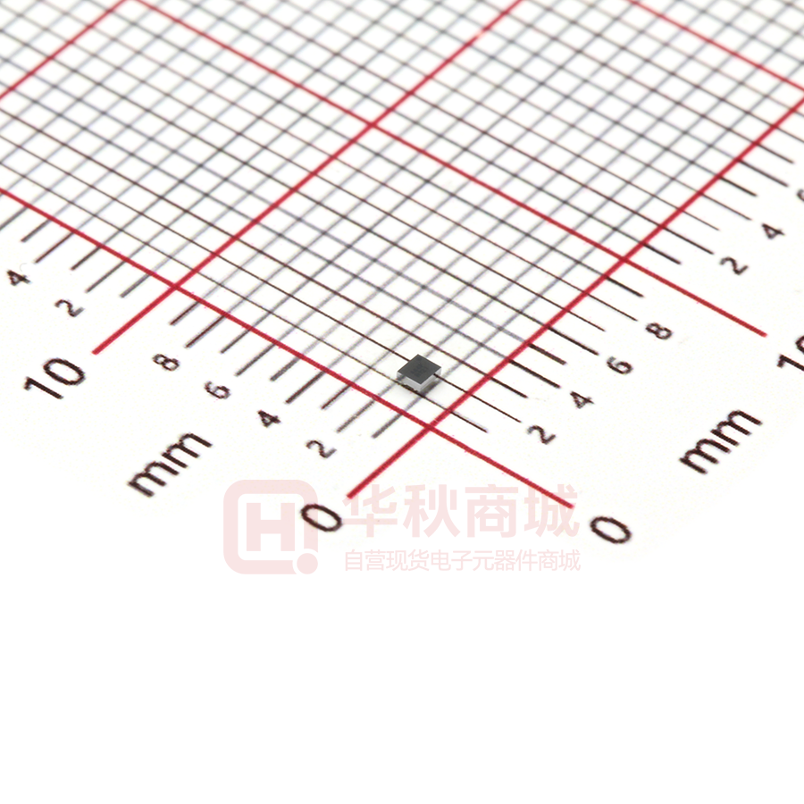

M24C64-FCS6TP/K
M24C64-FCS6TP/K
    STMICROELECTRONICS(意法半导体)
    WLCSP5_0.96X1.07MM
    EEPROM 存储器 IC 64Kb(8K x 8) I²C 1 MHz 450 ns WLCSP5_0.96X1.07MM
