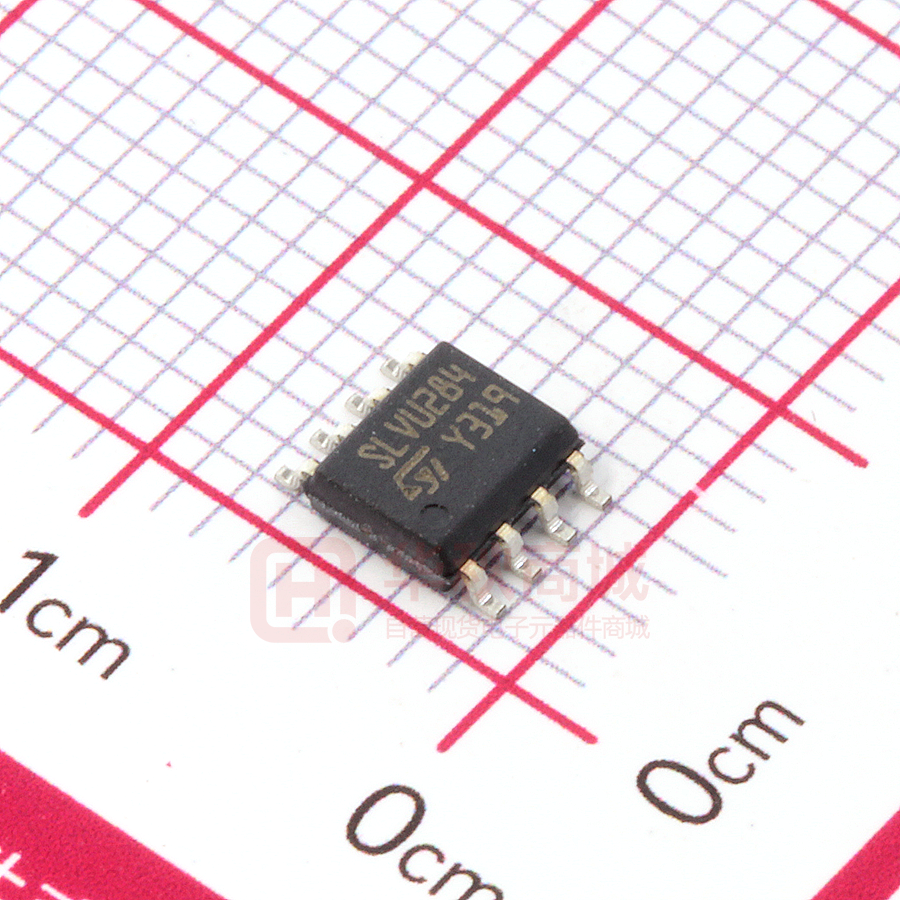

SLVU2.8
Low voltage unit for Gigabit Ethernet protection
Features
Peak pulse current : IPP = 30 A 8/20 µs
Low capacitance : Ctyp = 1.5 pF
Stand-off voltage : VR = 2.8 V
Low leakage current : IRmax = 0.2 µA
ECOPACK®2 compliant component
IEC 61000-4-5 (1kV 42 Ω 24 A) compliant at
Tj = 150 °C
SO-8 package
Complies with the following standards
IEC 61000-4-2 level 4
– 15 kV (air discharge)
– 8 kV (contact discharge)
IEC 61000-4-4 level 4
– ± 2 kV - 40 A (5/50 ns)
IEC 61000-4-5 level 2
– ± 1 kV - 42 Ω
Description
IEEE 802.3ab and 802.3at compatible on both
receiver (4 Vmax ) and driver side ( 3.6 Vmax)
The SLVU2.8 series has been designed to protect
Ethernet line. Its low capacitance makes it
compatible with Gigabit Ethernet.
MIL STD 883G - Method 3015-7
– 25 kV (human body model)
SLVU2.8-4A1
SLVU2.8-8A1
SLVU2.8-4A1 is designed to be compatible with
Gigabiit Ethernet and Gigabit PoE by using two
SO-8 packages and can be used on
10/100 Mbps Ethernet by using a single device.
SLVU2.8-8A1 is designed to be compatible with
Gigabiit Ethernet and Gigabit PoE by using a
single SO-8 package.
