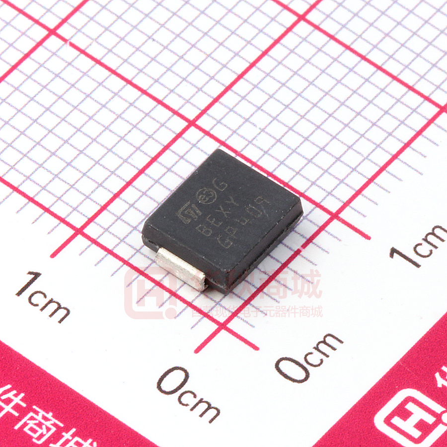

SM15T39CAY
SM15T39CAY
    STMICROELECTRONICS(意法半导体)
    SMC(DO-214AB)
    双向TVS 33.3V截止 峰值浪涌电流:28A@8/20US
SM15T39CAY 数据手册
SM15TY Automotive 1500 W Transil™ Datasheet − production data Features ■ Peak pulse power: – 1500 W (10/1000 µs) – 10 kW (8/20 µs) ■ Stand-off voltage range: from 5.8 V to 70 V ■ Unidirectional and bidirectional types ■ Low leakage current: – 0.2 µA at 25 °C – 1 µA at 85 °C ■ Operating Tj max: 150 °C ■ High power capability at Tjmax: – 1250 W (10/1000 µs) ■ JEDEC registered package outline ■ Resin meets UL 94, V0 ■ AEC-Q101 qualified A Unidirectional ISO 10605, C = 150 pF - R = 330 Ω: – 30 kV (air discharge) – 30 kV (contact discharge) ■ ISO 10605 - C = 330 pF, R = 330 Ω: – 30 kV (air discharge) – 30 kV (contact discharge) ■ ISO 7637-2(a) – Pulse 1: VS = -100 V – Pulse 2a: VS = +50 V – Pulse 3a: VS = -150 V – Pulse 3b: VS = +100 V Description The SM15TY Transil series has been designed to protect sensitive automotive circuits against surges defined in ISO 7637-2 and against electrostatic discharges according to ISO 10605. a. Not applicable to parts with stand-off voltage lower than the average battery voltage (13.5 V) March 2012 This is information on a product in full production. Bidirectional SMC (JEDEC DO-214AB) Complies with the following standards ■ K The Planar technology makes it compatible with high-end circuits where low leakage current and high junction temperature are required to provide reliability and stability over time. SM15TY are packaged in SMC (SMC footprint in accordance with IPC 7531 standard). TM: Transil is a trademark of STMicroelectronics Doc ID 17865 Rev 3 1/12 www.st.com 12 Characteristics SM15TY 1 Characteristics Table 1. Absolute maximum ratings (Tamb = 25 °C) Symbol VPP Parameter Value ISO 10605 (C = 330 pF, R = 330 Ω): Contact discharge Air discharge ISO 10605 (C = 150 pF, R = 330 Ω): Contact discharge Air discharge Peak pulse voltage PPP Peak pulse power dissipation(1) Tstg Unit 30 30 kV 30 30 Tj initial = Tamb 1500 W Storage temperature range -65 to + 150 °C Tj Operating junction temperature range -40 to + 150 °C TL Maximum lead temperature for soldering during 10 s. 260 °C 1. For a surge greater than the maximum values, the diode will fail in short-circuit. Figure 1. Electrical characteristics - definitions Symbol VRM VBR VCL IRM IPP αT VF RD Figure 2. Parameter Stand-off voltage Breakdown voltage Clamping voltage Leakage current @ VRM Peak pulse current Voltage temperature coefficient Forward voltage drop Dynamic resistance Unidirectional I I IF IPP VF VCL VBR VRM V VCLVBR VRM IRM IR IPP IPP %IPP 100 0 Pulse waveform tr = rise time (µs) tp = pulse duration time (µs) 2/12 tr V IRM IR Pulse definition for electrical characteristics 50 IR IRM tp Doc ID 17865 Rev 3 t VRMVBR VCL Bidirectional SM15TY Table 2. Characteristics Electrical characteristics, typical values unless otherwise stated (Tamb = 25 °C) Order code 25 °C 85 °C µA RD VCL @IPP VCL @IPP 10/1000 10/1000 µs 8/20 µs µs VBR @IR (1) IRM max@VRM min typ max V V max RD 8/20 µs max mA V(3) A(4) Ω V(3) αT (2) max A(4) Ω 10-4/ °C SM15T6V8AY/CAY 500 2000 5.8 6.45 6.8 7.14 10 10.5 143 0.023 13.4 746 0.008 5.7 SM15T7V5AY/CAY 250 1000 6.4 7.13 7.5 7.88 10 11.3 132 0.026 14.5 690 0.01 6.1 SM15T10AY/CAY 10 50 8.55 9.5 10 10.5 1 14.5 103 0.039 18.6 538 0.015 7.3 SM15T12AY/CAY 0.2 1 10.2 11.4 12 12.6 1 16.7 90 0.046 21.7 461 0.02 7.8 SM15T15AY/CAY 0.2 1 12.8 14.3 15 15.8 1 21.2 71 0.076 27.2 368 0.031 8.4 SM15T18AY/CAY 0.2 1 15.3 17.1 18 18.9 1 25.2 59.5 0.106 32.5 308 0.044 8.8 SM15T22AY/CAY 0.2 1 18.8 20.9 22 23.1 1 30.6 49 0.153 39.3 254 0.064 9.2 SM15T24AY/CAY 0.2 1 20.5 22.8 24 25.2 1 33.2 45 0.178 42.8 234 0.075 9.4 SM15T27AY/CAY 0.2 1 23.1 25.7 27 28.4 1 37.5 40 0.228 48.3 207 0.096 9.6 SM15T30AY/CAY 0.2 1 25.6 28.5 30 31.5 1 41.5 36 0.278 53.5 187 0.12 9.7 SM15T33AY/CAY 0.2 1 28.2 31.4 33 34.7 1 45.7 33 0.333 169 0.14 9.8 SM15T36AY/CAY 0.2 1 30.8 34.2 36 37.8 1 49.9 30 0.403 64.3 156 0.17 9.9 SM15T39AY/CAY 0.2 1 33.3 37.1 39 41.0 1 53.9 28 0.461 69.7 143 0.2 10 SM15T47AY/CAY 0.2 1 40.2 44.7 47 49.4 1 64.5 23.2 0.653 84 119 0.291 10.1 SM15T56AY/CAY 0.2 1 53.3 56 58.9 1 77.4 20 0.925 100 100 0.411 10.3 SM15T68AY/CAY 0.2 1 58.1 64.6 68 71.4 1 92 16.3 1.26 121 83 0.6 10.4 SM15T75AY/CAY 0.2 1 64.1 71.3 75 78.8 1 103 14.6 1.66 134 75 0.74 10.5 SM15T82AY/CAY 0.2 1 82 86.0 1 113 13.9 1.94 146 69 0.87 10.5 48 70 77.8 59 1. Pulse test: tp < 50 ms 2. To calculate maximum clamping voltage at other surge level, use the following formula: VCLmax = VCL - RD x (IPP - IPPappli) where IPPappli is the surge current in the application 3. To calculate VBR or VCL versus junction temperature, use the following formulas: VBR @ TJ = VBR @ 25 °C x (1 + αT x (TJ - 25)) VCL @ TJ = VCL @ 25 °C x (1 + αT x (TJ - 25)) 4. Surge capability given for both directions for unidirectional and bidirectional types. Doc ID 17865 Rev 3 3/12 Characteristics Figure 3. SM15TY Peak pulse power dissipation versus initial junction temperature (typical values) PPP(W) 2000 Figure 4. 100.0 Peak pulse power versus exponential pulse duration (Tj initial = 25 °C) PPP(kW) 10/1000 µs 1500 10.0 1000 1.0 500 Tj(°C) 0 0 25 Figure 5. 50 75 100 125 150 175 Clamping voltage versus peak pulse current (exponential waveform, maximum values) Figure 6. IPP(A) 1000.0 0.1 1.0E-03 10000 tp (ms) 1.0E-02 1.0E-01 1.0E+00 Junction capacitance versus reverse applied voltage for unidirectional types (typical values) C(pF) Tj initial = 25 °C F = 1 MHz VOSC = 30 mVRMS Tj = 25 °C SM15T6V8AY 100.0 1.0E+01 8/20 µs 10/1000 µs 10.0 1000 1 Figure 7. 10000 10 SM15T82AY/CAY 0.1 SM15T30AY/CAY SM15T6V8AY/CAY 1.0 SM15T30AY SM15T82AY VCL(V) 100 1000 Junction capacitance versus reverse applied voltage for bidirectional types (typical values) 1 SM15T6V8CAY 10 Figure 8. C(pF) F = 1 MHz VOSC = 30 mVRMS Tj = 25 °C VR(V) 100 100 100 1000 Thermal resistance junction to ambient versus copper surface under each lead Rth(j-a)(°C/W) Printed circuit board FR4, copper thickness = 35 µm 90 80 70 60 SM15T30CAY 1000 50 40 30 SM15T82CAY 20 10 VR(V) 100 1 4/12 10 100 1000 0 0.0 SCu(cm²) 0.5 Doc ID 17865 Rev 3 1.0 1.5 2.0 2.5 3.0 3.5 4.0 4.5 5.0 SM15TY Figure 9. 1.E+04 Characteristics Leakage current versus junction temperature (typical values) IR(nA) Figure 10. Peak forward voltage drop versus peak forward current (typical values) 100.0 IFM(A) VR = VRM VRM < 10 V 1.E+03 10.0 1.E+02 Tj = 125 °C Tj = 25 °C 1.0 1.E+01 VRM ≥ 10 V Tj(°C) 1.E+00 25 50 75 100 125 0.1 0.0 150 VFM(V) 0.5 1.0 1.5 2.0 2.5 Figure 11. Relative variation of thermal impedance junction to ambient versus pulse duration 1.00 Zth(j-a)/Rth(j-a) Recommended pad layout printed circuit board, copper thickness = 35 µm 0.10 Single pulse 0.01 1.E-03 tp(s) 1.E-02 1.E-01 1.E+00 1.E+01 Doc ID 17865 Rev 3 1.E+02 1.E+03 5/12 Characteristics SM15TY Figure 12. ISO7637-2 pulse 1 response (VS = -100 V) Voltage (V) Voltage 10 0 -10 -20 -30 SM15T39AY -40 SM15T39CAY -50 -0.5 0.0 0.5 1.0 1.5 2.0 2.5 Time (ms) 5 Current (A) Current 0 SM15T39AY -5 SM15T39CAY -10 -15 -0.5 0.0 0.5 1.0 1.5 2.0 2.5 Time (ms) Figure 13. ISO7637-2 pulse 2 response (VS = 50 V) Voltage (V) 50 Voltage 40 SM15T39AY 30 SM15T39CAY 20 10 0 -20 0 20 40 60 80 100 Time (µs) 12 Current (A) Current 8 SM15T39AY 4 SM15T39CAY 0 -4 -20 0 20 40 Time (µs) 6/12 Doc ID 17865 Rev 3 60 80 100 SM15TY Characteristics Figure 14. ISO7637-2 pulse 3a response (VS = -150 V) Voltage (V) Voltage 20 0.0 SM15T39AY -20 SM15T39CAY -40 -60 -0.5 0.0 1.0 0.5 1.5 2.0 Time (µs) 1 Current (A) Current 0.0 SM15T39AY SM15T39CAY -1 -2 -0.2 0.8 0.0 1.8 0.0 0.0 Time (µs) Figure 15. ISO7637-2 pulse 3b response (VS = 100 V) 50 Voltage (V) Voltage 40 SM15T39AY 30 SM15T39CAY 20 10 0 -0.2 0.8 1.8 Time (µs) 1.2 Current (A) Current 0.8 SM15T39AY 0.4 SM15T39CAY 0 -0.4 -0.2 0.8 1.8 Time (µs) Note: ISO7637-2 pulses responses are not applicable for product with a stand off voltage lower than the average battery voltage (13.5 V). Doc ID 17865 Rev 3 7/12 Application and design guidelines 2 SM15TY Application and design guidelines More information is available in the Application note AN2689 “Protection of automotive electronics from electrical hazards, guidelines for design and component selection”. 3 Ordering information scheme Figure 16. Ordering information scheme SM Surface mount Surge rating 15 = 1500 W Transil in SMC Bre a k down v olta ge Types CA = Bidirectional A = Unidirectional Automotive grade 8/12 Doc ID 17865 Rev 3 15T XX CA Y SM15TY 4 Package information Package information ● Case: JEDEC DO-214AB molded plastic over planar junction ● Terminals: solder plated, solderable as per MIL-STD-750, Method 2026 ● Polarity: for unidirectional types the band indicates cathode ● Flammability: epoxy is rated UL 94, V0 ● RoHS package In order to meet environmental requirements, ST offers these devices in different grades of ECOPACK® packages, depending on their level of environmental compliance. ECOPACK® specifications, grade definitions and product status are available at: www.st.com. ECOPACK® is an ST trademark. Table 3. SMC dimensions Dimensions Ref. E1 D Max. Min. Max. A1 1.90 2.45 0.075 0.096 A2 0.05 0.20 0.002 0.008 b 2.90 3.20 0.114 0.126 c 0.15 0.40 0.006 0.016 D 5.55 6.25 0.218 0.246 E 7.75 8.15 0.305 0.321 E1 6.60 7.15 0.260 0.281 E2 4.40 4.70 0.173 0.185 L 0.75 1.50 0.030 0.059 A1 A2 E2 L b Inches Min. E C Millimeters Figure 17. SMC footprint dimensions in Figure 18. Marking layout(1) mm (inches) 1.54 (0.061) 5.11 (0.201) 1.54 (0.061) Cathode bar (unidirectional devices only ) 3.14 (0.124) x x x z y ww ECOPACK compliance XXX: Marking Z: Manufacturing location Y: Year WW: week 8.19 (0.322) 1. Marking layout can vary according to assembly location. Doc ID 17865 Rev 3 9/12 Package information Table 4. SM15TY Marking Order code 10/12 Marking Order code Marking SM15T6V8AY MDEY SM15T6V8CAY BDEY SM15T7V5AY MDGY SM15T7V5CAY BDGY SM15T10AY MDPY SM15T10CAY BDPY SM15T12AY MDTY SM15T12CAY BDTY SM15T15AY MDXY SM15T15CAY BDXY SM15T18AY MEEY SM15T18CAY BEEY SM15T22AY MEKY SM15T22CAY BEKY SM15T24AY MEMY SM15T24CAY BEMY SM15T27AY MEPY SM15T27CAY BEPY SM15T30AY MERY SM15T30CAY BERY SM15T33AY METY SM15T33CAY BETY SM15T36AY MEVY SM15T36CAY BEVY SM15T39AY MEXY SM15T39CAY BEXY SM15T47AY MFAY SM15T47CAY BFAY SM15T56AY MFBY SM15T56CAY BFBY SM15T68AY MFPY SM15T68CAY BFPY SM15T75AY MFOY SM15T75CAY BFOY SM15T82AY MFRY SM15T82CAY BFRY Doc ID 17865 Rev 3 SM15TY 5 Ordering information Ordering information Table 5. Ordering information Order code Marking Package Weight Base qty Delivery mode SM15TxxxAY/CAY(1) See Table 4 on page 10 SMC 0.25 g 2500 Tape and reel 1. Where xxx is nominal value of VBR and A or CA indicates unidirectional or bidirectional version. See Table 2 for list of available devices and their order codes 6 Revision history Table 6. Document revision history Date Revision Changes 15-Sep-2010 1 Initial release. 09-Nov-2011 2 Added order codes in Table 2 and Table 4. Updated Figure 5, 6, 7, and Table 1. Added Figure 11. Deleted old Table 2. Thermal parameter. Updated ISO 10605, C = 150 pF - R = 330 Ω: on page 1 27-Mar-2012 3 Added footnote on page 1. Doc ID 17865 Rev 3 11/12 SM15TY Please Read Carefully: Information in this document is provided solely in connection with ST products. STMicroelectronics NV and its subsidiaries (“ST”) reserve the right to make changes, corrections, modifications or improvements, to this document, and the products and services described herein at any time, without notice. All ST products are sold pursuant to ST’s terms and conditions of sale. Purchasers are solely responsible for the choice, selection and use of the ST products and services described herein, and ST assumes no liability whatsoever relating to the choice, selection or use of the ST products and services described herein. No license, express or implied, by estoppel or otherwise, to any intellectual property rights is granted under this document. If any part of this document refers to any third party products or services it shall not be deemed a license grant by ST for the use of such third party products or services, or any intellectual property contained therein or considered as a warranty covering the use in any manner whatsoever of such third party products or services or any intellectual property contained therein. UNLESS OTHERWISE SET FORTH IN ST’S TERMS AND CONDITIONS OF SALE ST DISCLAIMS ANY EXPRESS OR IMPLIED WARRANTY WITH RESPECT TO THE USE AND/OR SALE OF ST PRODUCTS INCLUDING WITHOUT LIMITATION IMPLIED WARRANTIES OF MERCHANTABILITY, FITNESS FOR A PARTICULAR PURPOSE (AND THEIR EQUIVALENTS UNDER THE LAWS OF ANY JURISDICTION), OR INFRINGEMENT OF ANY PATENT, COPYRIGHT OR OTHER INTELLECTUAL PROPERTY RIGHT. UNLESS EXPRESSLY APPROVED IN WRITING BY TWO AUTHORIZED ST REPRESENTATIVES, ST PRODUCTS ARE NOT RECOMMENDED, AUTHORIZED OR WARRANTED FOR USE IN MILITARY, AIR CRAFT, SPACE, LIFE SAVING, OR LIFE SUSTAINING APPLICATIONS, NOR IN PRODUCTS OR SYSTEMS WHERE FAILURE OR MALFUNCTION MAY RESULT IN PERSONAL INJURY, DEATH, OR SEVERE PROPERTY OR ENVIRONMENTAL DAMAGE. ST PRODUCTS WHICH ARE NOT SPECIFIED AS "AUTOMOTIVE GRADE" MAY ONLY BE USED IN AUTOMOTIVE APPLICATIONS AT USER’S OWN RISK. Resale of ST products with provisions different from the statements and/or technical features set forth in this document shall immediately void any warranty granted by ST for the ST product or service described herein and shall not create or extend in any manner whatsoever, any liability of ST. ST and the ST logo are trademarks or registered trademarks of ST in various countries. Information in this document supersedes and replaces all information previously supplied. The ST logo is a registered trademark of STMicroelectronics. All other names are the property of their respective owners. © 2012 STMicroelectronics - All rights reserved STMicroelectronics group of companies Australia - Belgium - Brazil - Canada - China - Czech Republic - Finland - France - Germany - Hong Kong - India - Israel - Italy - Japan Malaysia - Malta - Morocco - Philippines - Singapore - Spain - Sweden - Switzerland - United Kingdom - United States of America www.st.com 12/12 Doc ID 17865 Rev 3
