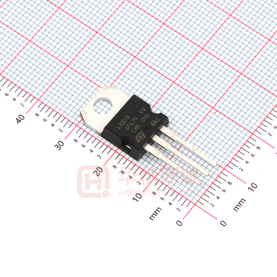

ST13007 High voltage fast-switching NPN power transistor Features ■ DC current gain classification ■ High voltage capability ■ Low spread of dynamic parameters ■ Very high switching speed TAB Applications 3 ■ Electronic ballast for fluorescent lighting ■ Switch mode power supplies 1 2 TO-220 Description Figure 1. Internal schematic diagram The device is manufactured using high voltage multi-epitaxial planar technology for high switching speeds and high voltage capability. It uses a cellular emitter structure with planar edge termination to enhance switching speeds while maintaining the wide RBSOA. Table 1. Device summary Order code Marking (1) Package Packaging TO-220 Tube ST13007A ST13007 ST13007B 1. The product is classified in DC current gain group A and group B, see Table 5: hFE classification. STMicroelectronics reserves the right to ship from any group according to production availability. December 2009 Doc ID 5263 Rev 4 1/11 www.st.com 11 Electrical ratings 1 Electrical ratings Table 2. Absolute maximum ratings Symbol Parameter Value Unit VCES Collector-emitter voltage (VBE = 0) 700 V VCEO Collector-emitter voltage (IB = 0) 400 V VEBO Emitter-base voltage (IC = 0) 9 V Collector current 8 A Collector peak current (tP < 5 ms) 16 A Base current 4 A IBM Base peak current (tP < 5 ms) 8 A PTOT Total dissipation at Tc = 25 °C 80 W TSTG Storage temperature - 65 to 150 °C 150 °C Value Unit 1.56 °C/W IC ICM IB TJ Table 3. Symbol RthJC 2/11 ST13007 Max. operating junction temperature Thermal data Parameter Thermal resistance junction-case Doc ID 5263 Rev 4 __max ST13007 2 Electrical characteristics Electrical characteristics Tcase = 25 °C unless otherwise specified. Table 4. Symbol Electrical characteristics Parameter Test conditions ICES Collector cut-off current VCE = 700 V (VBE = 0) VCE = 700 V IEBO Emitter cut-off current (IC = 0) Collector-emitter VCEO(sus) (1) sustaining voltage (IB = 0) Typ. TC = 125 °C VEB = 9 V IC = 10 mA Max. Unit 10 0.5 µA mA 100 µA 400 V IC = 2 A IB = 0.4 A IB = 1 A IC = 5 A _ IB = 2 A IC = 8 A _ _ IC = 5 A, IB = 1 A, TC = 100 °C VCE(sat) (1) Collector-emitter saturation voltage VBE(sat) (1) IB = 0.4 A IC = 2 A Base-emitter saturation IC = 5 A _ IB = 1 A voltage IC = 5 A, IB = 1 A, TC = 100°C DC current gain IC = 2 A IC = 5 A ts tf Resistive load Storage time Fall time IC = 2 A VCC = 300 V IB(on) = - IB(off) = 400 mA TP = 30 µs ts tf Inductive load Storage time Fall time IC = 5 A IB(on) = 1 A L = 200 µH VClamp = 250 V IB(off) = - 2 A ts tf Inductive load Storage time Fall time IC = 5 A IB(on) = 1 A L = 200 µH VClamp = 250 V IB(off) = - 2 A TC = 125 °C hFE Min. VCE = 5 V VCE = 5 V 1 2 3 3 V V V V 1.2 1.6 1.5 V V V 16 5 40 30 3 4.5 350 µs ns 2.5 110 µs ns 1.5 40 2 70 µs ns 1. Pulse test: pulse duration ≤ 300 µs, duty cycle ≤ 2 % Table 5. hFE classification Symbol hFE Parameter DC current gain IC = 2 A, VCE = 5 V Doc ID 5263 Rev 4 Group Min. Max. A 16 30 B 26 40 Unit 3/11 Electrical characteristics 2.1 4/11 ST13007 Electrical characteristics (curves) Figure 2. Safe operating area Figure 3. Derating curve Figure 4. DC current gain (VCE = 2 V) Figure 5. DC current gain (VCE = 5 V) Figure 6. Collector-emitter saturation voltage Figure 7. Base-emitter saturation voltage Doc ID 5263 Rev 4 ST13007 Electrical characteristics Figure 8. Inductive fall time Figure 9. Inductive storage time Figure 10. Reverse biased SOA Doc ID 5263 Rev 4 5/11 Electrical characteristics 2.2 ST13007 Test circuits Figure 11. Resistive load switching test circuit 1. Fast electronic switch 2. Non-inductive resistor Figure 12. Inductive load switching test circuit 1. Fast electronic switch 2. Non-inductive resistor 3. Fast recovery rectifier 6/11 Doc ID 5263 Rev 4 ST13007 3 Package mechanical data Package mechanical data In order to meet environmental requirements, ST offers these devices in different grades of ECOPACK® packages, depending on their level of environmental compliance. ECOPACK® specifications, grade definitions and product status are available at: www.st.com. ECOPACK® is an ST trademark. Doc ID 5263 Rev 4 7/11 Package mechanical data ST13007 TO-220 type A mechanical data mm Dim Min A b b1 c D D1 E e e1 F H1 J1 L L1 L20 L30 ∅P Q Typ 4.40 0.61 1.14 0.48 15.25 Max 4.60 0.88 1.70 0.70 15.75 1.27 10 2.40 4.95 1.23 6.20 2.40 13 3.50 10.40 2.70 5.15 1.32 6.60 2.72 14 3.93 16.40 28.90 3.75 2.65 3.85 2.95 0015988_Rev_S 8/11 Doc ID 5263 Rev 4 ST13007 Package mechanical data TO-220 type E mechanical data DIM. mm. MIN. TYP MAX. A 4.47 b 0.70 4.67 0.91 b1 1.17 1.37 c 0.31 0.53 D 14.60 15.70 E 9.96 10.36 e 2.54 e1 4.98 F 1.17 5.08 5.18 1.37 H1 6.10 6.80 J1 2.52 2.82 L 12.70 13.80 L1 3.20 3.96 L20 15.21 16.77 øP 3.73 3.94 Q 2.59 2.89 7655923_B Doc ID 5263 Rev 4 9/11 Revision history 4 ST13007 Revision history Table 6. 10/11 Document revision history Date Revision Changes 21-Jun-2004 3 Document migration, no content change. 16-Dec-2009 4 Updated TO-220 package mechanical data. Doc ID 5263 Rev 4 ST13007 Please Read Carefully: Information in this document is provided solely in connection with ST products. STMicroelectronics NV and its subsidiaries (“ST”) reserve the right to make changes, corrections, modifications or improvements, to this document, and the products and services described herein at any time, without notice. All ST products are sold pursuant to ST’s terms and conditions of sale. Purchasers are solely responsible for the choice, selection and use of the ST products and services described herein, and ST assumes no liability whatsoever relating to the choice, selection or use of the ST products and services described herein. No license, express or implied, by estoppel or otherwise, to any intellectual property rights is granted under this document. If any part of this document refers to any third party products or services it shall not be deemed a license grant by ST for the use of such third party products or services, or any intellectual property contained therein or considered as a warranty covering the use in any manner whatsoever of such third party products or services or any intellectual property contained therein. UNLESS OTHERWISE SET FORTH IN ST’S TERMS AND CONDITIONS OF SALE ST DISCLAIMS ANY EXPRESS OR IMPLIED WARRANTY WITH RESPECT TO THE USE AND/OR SALE OF ST PRODUCTS INCLUDING WITHOUT LIMITATION IMPLIED WARRANTIES OF MERCHANTABILITY, FITNESS FOR A PARTICULAR PURPOSE (AND THEIR EQUIVALENTS UNDER THE LAWS OF ANY JURISDICTION), OR INFRINGEMENT OF ANY PATENT, COPYRIGHT OR OTHER INTELLECTUAL PROPERTY RIGHT. UNLESS EXPRESSLY APPROVED IN WRITING BY AN AUTHORIZED ST REPRESENTATIVE, ST PRODUCTS ARE NOT RECOMMENDED, AUTHORIZED OR WARRANTED FOR USE IN MILITARY, AIR CRAFT, SPACE, LIFE SAVING, OR LIFE SUSTAINING APPLICATIONS, NOR IN PRODUCTS OR SYSTEMS WHERE FAILURE OR MALFUNCTION MAY RESULT IN PERSONAL INJURY, DEATH, OR SEVERE PROPERTY OR ENVIRONMENTAL DAMAGE. ST PRODUCTS WHICH ARE NOT SPECIFIED AS "AUTOMOTIVE GRADE" MAY ONLY BE USED IN AUTOMOTIVE APPLICATIONS AT USER’S OWN RISK. Resale of ST products with provisions different from the statements and/or technical features set forth in this document shall immediately void any warranty granted by ST for the ST product or service described herein and shall not create or extend in any manner whatsoever, any liability of ST. ST and the ST logo are trademarks or registered trademarks of ST in various countries. Information in this document supersedes and replaces all information previously supplied. The ST logo is a registered trademark of STMicroelectronics. All other names are the property of their respective owners. © 2009 STMicroelectronics - All rights reserved STMicroelectronics group of companies Australia - Belgium - Brazil - Canada - China - Czech Republic - Finland - France - Germany - Hong Kong - India - Israel - Italy - Japan Malaysia - Malta - Morocco - Philippines - Singapore - Spain - Sweden - Switzerland - United Kingdom - United States of America www.st.com Doc ID 5263 Rev 4 11/11
