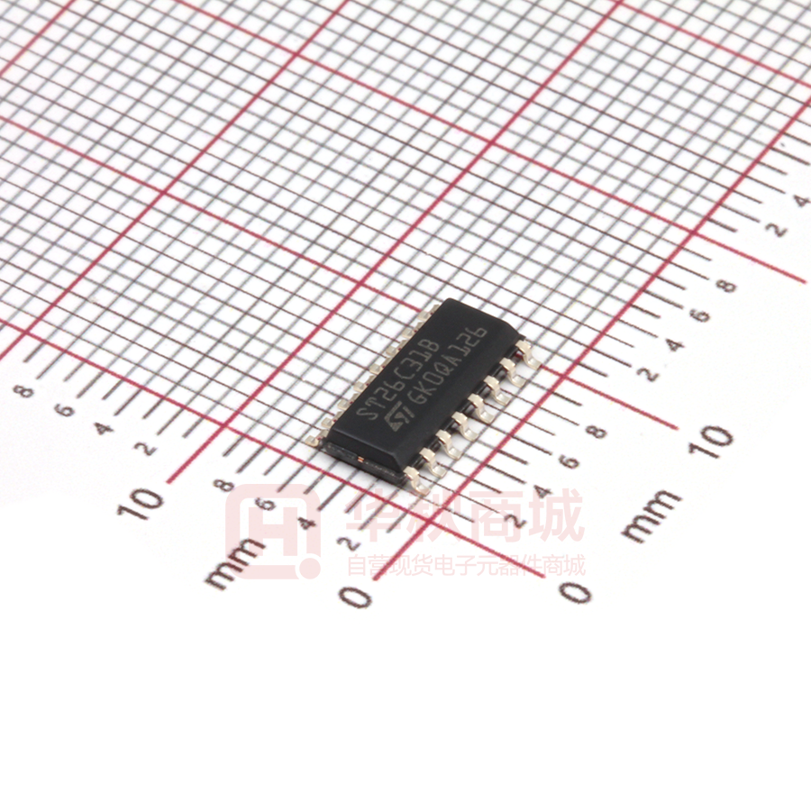

ST26C31B CMOS quad 3-state differential line driver Features ■ TTL input compatible ■ Typical propagation delay: 6 ns ■ Typical output skew: 0.5 ns ■ Output will not load line when VCC = 0 V ■ Meets the requirements of EIA standard RS-422 ■ Operation from single 5 V supply ■ 3-state outputs for connection to system buses ■ Low quiescent current ■ Available in surface mount DIP-16 SO-16 TSSOP16 Description The ST26C31B is a quad differential line driver designed for digital data transmission over balanced lines and meets all the requirements of EIA standard RS-422 while retaining the low power characteristics of CMOS. The ST26C31B accepts TTL or CMOS input levels and translates these to RS-422 output levels. This part uses special outputs circuitry common to all four drivers. All outputs are protected against damage due to electrostatic discharge by diode to VCC and ground. Table 1. Device summary Order codes Temperature range Package Packaging ST26C31BN -40 to 85 °C DIP-16 25 parts per tube / 40 tube per box ST26C31BDR -40 to 85 °C SO-16 (tape and reel) 2500 parts per reel ST26C31BTR -40 to 85 °C TSSOP16 (tape and reel) 2500 parts per reel June 2008 Rev 8 1/15 www.st.com 15 Contents ST26C31B Contents 1 Pin configuration . . . . . . . . . . . . . . . . . . . . . . . . . . . . . . . . . . . . . . . . . . . 3 2 Maximum ratings . . . . . . . . . . . . . . . . . . . . . . . . . . . . . . . . . . . . . . . . . . . . 5 3 Electrical characteristics . . . . . . . . . . . . . . . . . . . . . . . . . . . . . . . . . . . . . 6 4 Package mechanical data . . . . . . . . . . . . . . . . . . . . . . . . . . . . . . . . . . . . . 8 5 Revision history . . . . . . . . . . . . . . . . . . . . . . . . . . . . . . . . . . . . . . . . . . . 14 2/15 ST26C31B Pin configuration 1 Pin configuration Figure 1. Pin connections Table 2. Pin description Pin n° Symbol Name and function 1 AIN 2 AOUT Channel A output 3 AOUT Channel A output 4 EN 5 BOUT Channel B output 6 BOUT Channel B output 7 BIN Input B 8 GND Ground 9 CIN Input C 10 COUT Channel C output 11 COUT Channel C output 12 EN 13 DOUT Channel D output 14 DOUT Channel D output 15 DIN Input D 16 VCC Supply voltage Input A ENABLE ENABLE 3/15 Pin configuration Table 3. ST26C31B Truth table Enable Enable Input Output Output L H X Z Z L L H H H L All other combinations of enable inputs Note: 4/15 L = Low voltage state H = High logic state X = Don’t care Z = High impedance ST26C31B Maximum ratings 2 Maximum ratings Table 4. Absolute maximum ratings (1) (2) Symbol Parameter Value Unit -0.5 to 7 V -0.5 to (VCC + 0.5) V -0.5 to 7 V Clamp diode current ± 20 mA IOUT DC output current per pin ± 150 mA ICC DC VCC or gnd current ± 150 mA -65 to +150 °C VCC Supply voltage VIN DC input voltage VOUT IIK TSTG DC output voltage (high or low state) Storage temperature range 1. Absolute maximum ratings are those values beyond which the safety of the device cannot be guaranteed. They are not meant to imply that the device should be operated at these limits. The table of electrical characteristics provide conditions for actual device operation. 2. Unless otherwise specified, all voltage are referenced to ground. All currents into the device pins are positive; all currents out of the device pins are negative. Table 5. Recommended operating conditions Symbol Parameter Value Unit VCC Supply voltage 4.5 to 5.5 V VIN DC input voltage 0 to VCC V VOUT DC output voltage (high or low state) 0 to VCC V VOUT DC output voltage (VCC = 0 V or high impedance) 0 to 5 V -40 to +85 °C 500 ns TA Operating temperature range tr, tf Maximum enable input rise or fall times 5/15 Electrical characteristics ST26C31B 3 Electrical characteristics Table 6. Electrical characteristics (VCC = 5 V ± 10 %, unless otherwise specified (1)) Value Symbol Parameter Test conditions Unit Min. VIH High level input voltage VIL Low level input voltage VOH High level output voltage VIN = VIH or VIL, IOUT = -20mA VOL Low level output voltage VIN = VIH or VIL, IOUT = +20mA VT Differential output voltage RL = 100 Ω 2.5 VOS Common mode output voltage RL = 100 Ω (2) VOSVOS Difference in common mode output voltage Input current 2 V 3.4 0.3 (2) RL = 100 Ω (2) Quiescent supply current V 0.8 Difference in differential output voltage ICC Max. 2 VT-VT IIN Typ. V 0.5 V 3.1 V 0.4 V 3 V RL = 100 Ω (2) 0.4 V VIN = VCC, GND, VIH or VIL ±1 µA 200 500 µA 0.8 2 mA ±0.5 ±5 µA -150 mA VOUT = 6 V 100 µA VOUT = -0.25 V -100 µA 1.8 VIN = VCC or GND (2) IOUT = 0 µA IOZ 3-state output leakage current VOUT = VCC or GND ENABLE = VIH ENABLE = VIL ISC Output short circuit current VIN = (2) (4) IOFF Power off output leakage current (2) VCC = 0 V VIN = 2.4 or 0.5 V VCC or GND (3) -30 1. Unless otherwise specified, min./max. limits apply across the recommended operating temperature range. All typical are given for VCC = 5 V and TA = 25 °C 2. See EIA Specification RS422 for exact test conditions. 3. Measured per pin input. All other input at VCC or GND. 4. This is the current sourced when a high output is shorted to ground. Only one output at time should be shorted. 6/15 ST26C31B Table 7. Electrical characteristics Switching characteristics (VCC = 5 V ± 10 %, tr = tf ≤ 6 ns (1)) Value Symbol tPLH tPHL Parameter Test conditions Unit Min. Typ. Max. 2 6 11 ns Propagation delay input to output S1 Open (2) S1 Open 0.5 2 ns tTLH tTHL Differential output rise and fall times S1 Open 6 10 ns tPZH Output enable time S1 Closed 11 19 ns tPZL Output enable time Skew S1 Closed 13 21 ns Output disable time (3) S1 Closed 5 9 ns tPLZ Output disable time (3) S1 Closed 7 11 ns CPD Power dissipation capacitance (4) 50 pF CIN Input capacitance 6 pF tPHZ 1. Unless otherwise specified, min./max. limits apply across the recommended operating temperature range. All typical are given for VCC = 5 V and TA = 25 °C 2. Skew is defined as the difference in propagation delays between complementary outputs at the 50 % point. 3. Output disable time is the delay from the control input being switched to the output transistors tuning off. The actual disable times are less than indicated due to the delay added by RC time constant of the load. 4. CPD determines the no load dynamic power consumption, PD = CPDVCC2, f = ICCVCC, and the no load dynamic current consumption, PD = CPD VCCf + ICC . 7/15 Package mechanical data 4 ST26C31B Package mechanical data In order to meet environmental requirements, ST offers these devices in ECOPACK® packages. These packages have a lead-free second level interconnect. The category of second level interconnect is marked on the package and on the inner box label, in compliance with JEDEC Standard JESD97. The maximum ratings related to soldering conditions are also marked on the inner box label. ECOPACK is an ST trademark. ECOPACK specifications are available at: www.st.com 8/15 ST26C31B Package mechanical data Plastic DIP-16 (0.25) mechanical data mm. inch. Dim. Min. a1 0.51 B 0.77 Typ. Max. Min. Typ. Max. 0.020 1.65 0.030 0.065 b 0.5 0.020 b1 0.25 0.010 D 20 0.787 E 8.5 0.335 e 2.54 0.100 e3 17.78 0.700 F 7.1 0.280 I 5.1 0.201 L Z 3.3 0.130 1.27 0.050 P001C 9/15 Package mechanical data ST26C31B SO-16 mechanical data Dim. mm. Min. Typ. A a1 inch. Max. Min. Typ. 1.75 0.1 0.068 0.25 a2 Max. 0.004 0.010 1.64 0.063 b 0.35 0.46 0.013 0.018 b1 0.19 0.25 0.007 0.010 C 0.5 0.019 c1 45° (typ.) D 9.8 10 0.385 0.393 E 5.8 6.2 0.228 0.244 e 1.27 0.050 e3 8.89 0.350 F 3.8 4.0 0.149 0.157 G 4.6 5.3 0.181 0.208 L 0.5 1.27 0.019 0.050 M S 0.62 0.024 8° (max.) 0016020D 10/15 ST26C31B Package mechanical data TSSOP16 mechanical data mm. inch. Dim. Min. Typ. A Max. Min. Typ. Max. 1.2 A1 0.05 A2 0.8 b 0.047 0.15 0.002 0.004 0.006 1.05 0.031 0.039 0.041 0.19 0.30 0.007 0.012 c 0.09 0.20 0.004 0.0079 D 4.9 5 5.1 0.193 0.197 0.201 E 6.2 6.4 6.6 0.244 0.252 0.260 E1 4.3 4.4 4.48 0.169 0.173 0.176 1 e 0.65 BSC K 0° L 0.45 A 0.60 0.0256 BSC 8° 0° 0.75 0.018 8° 0.024 0.030 A2 A1 b e K c L E D E1 PIN 1 IDENTIFICATION 1 0080338D 11/15 Package mechanical data ST26C31B Tape & reel SO-16 mechanical data mm. inch. Dim. Min. A Max. Min. 330 13.2 Typ. Max. 12.992 C 12.8 D 20.2 0.795 N 60 2.362 T 12/15 Typ. 0.504 22.4 0.519 0.882 Ao 6.45 6.65 0.254 0.262 Bo 10.3 10.5 0.406 0.414 Ko 2.1 2.3 0.082 0.090 Po 3.9 4.1 0.153 0.161 P 7.9 8.1 0.311 0.319 ST26C31B Package mechanical data Tape & reel TSSOP16 mechanical data mm. inch. Dim. Min. A Typ. Max. Min. 330 Max. 12.992 C 12.8 D 20.2 0.795 N 60 2.362 T 13.2 Typ. 0.504 22.4 0.519 0.882 Ao 6.7 6.9 0.264 0.272 Bo 5.3 5.5 0.209 0.217 Ko 1.6 1.8 0.063 0.071 Po 3.9 4.1 0.153 0.161 P 7.9 8.1 0.311 0.319 13/15 Revision history ST26C31B 5 Revision history Table 8. Document revision history Date Revision 02-May-2006 7 Order codes updated. 12-Jun-2008 8 Added: Table 1 on page 1. 14/15 Changes ST26C31B Please Read Carefully: Information in this document is provided solely in connection with ST products. STMicroelectronics NV and its subsidiaries (“ST”) reserve the right to make changes, corrections, modifications or improvements, to this document, and the products and services described herein at any time, without notice. All ST products are sold pursuant to ST’s terms and conditions of sale. Purchasers are solely responsible for the choice, selection and use of the ST products and services described herein, and ST assumes no liability whatsoever relating to the choice, selection or use of the ST products and services described herein. No license, express or implied, by estoppel or otherwise, to any intellectual property rights is granted under this document. If any part of this document refers to any third party products or services it shall not be deemed a license grant by ST for the use of such third party products or services, or any intellectual property contained therein or considered as a warranty covering the use in any manner whatsoever of such third party products or services or any intellectual property contained therein. UNLESS OTHERWISE SET FORTH IN ST’S TERMS AND CONDITIONS OF SALE ST DISCLAIMS ANY EXPRESS OR IMPLIED WARRANTY WITH RESPECT TO THE USE AND/OR SALE OF ST PRODUCTS INCLUDING WITHOUT LIMITATION IMPLIED WARRANTIES OF MERCHANTABILITY, FITNESS FOR A PARTICULAR PURPOSE (AND THEIR EQUIVALENTS UNDER THE LAWS OF ANY JURISDICTION), OR INFRINGEMENT OF ANY PATENT, COPYRIGHT OR OTHER INTELLECTUAL PROPERTY RIGHT. UNLESS EXPRESSLY APPROVED IN WRITING BY AN AUTHORIZED ST REPRESENTATIVE, ST PRODUCTS ARE NOT RECOMMENDED, AUTHORIZED OR WARRANTED FOR USE IN MILITARY, AIR CRAFT, SPACE, LIFE SAVING, OR LIFE SUSTAINING APPLICATIONS, NOR IN PRODUCTS OR SYSTEMS WHERE FAILURE OR MALFUNCTION MAY RESULT IN PERSONAL INJURY, DEATH, OR SEVERE PROPERTY OR ENVIRONMENTAL DAMAGE. ST PRODUCTS WHICH ARE NOT SPECIFIED AS "AUTOMOTIVE GRADE" MAY ONLY BE USED IN AUTOMOTIVE APPLICATIONS AT USER’S OWN RISK. Resale of ST products with provisions different from the statements and/or technical features set forth in this document shall immediately void any warranty granted by ST for the ST product or service described herein and shall not create or extend in any manner whatsoever, any liability of ST. ST and the ST logo are trademarks or registered trademarks of ST in various countries. Information in this document supersedes and replaces all information previously supplied. The ST logo is a registered trademark of STMicroelectronics. All other names are the property of their respective owners. © 2008 STMicroelectronics - All rights reserved STMicroelectronics group of companies Australia - Belgium - Brazil - Canada - China - Czech Republic - Finland - France - Germany - Hong Kong - India - Israel - Italy - Japan Malaysia - Malta - Morocco - Singapore - Spain - Sweden - Switzerland - United Kingdom - United States of America www.st.com 15/15
