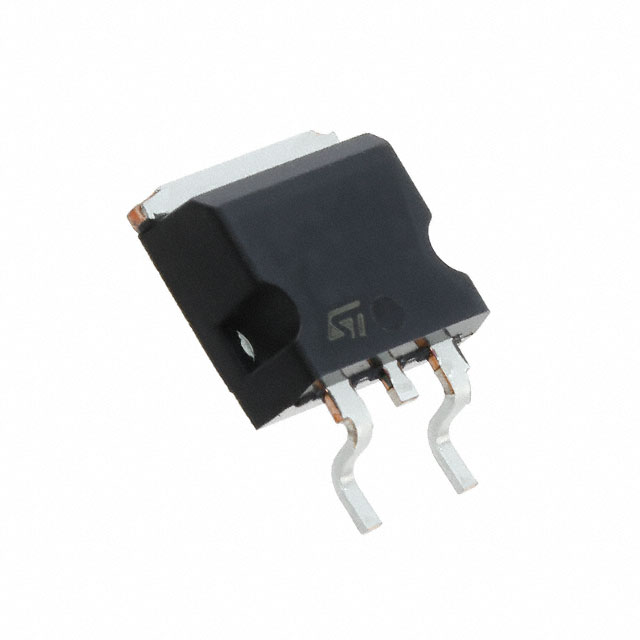

    N沟道60 V、4.7 mOhm典型值、100 A STripFET F7功率MOSFET,D2PAK封装
STB100N6F7 数据手册
STB100N6F7 N-channel 60 V, 4.7 mΩ typ.,100 A STripFET™ F7 Power MOSFET in a D²PAK package Datasheet - production data Features 7$% Order code VDS RDS(on) max. STB100N6F7 60 V 5.6 mΩ ID PTOT 100A 125 W • Among the lowest RDS(on) on the market  • Excellent figure of merit (FoM)  • Low Crss/Ciss ratio for EMI immunity • High avalanche ruggedness '3$. Applications • Switching applications Figure 1. Internal schematic diagram Description This N-channel Power MOSFET utilizes STripFET™ F7 technology with an enhanced trench gate structure that results in very low onstate resistance, while also reducing internal capacitance and gate charge for faster and more efficient switching. ' 7$% *  6  $0Y Table 1. Device summary Order code Marking Package Packaging STB100N6F7 100N6F7 D²PAK Tape and Reel January 2015 This is information on a product in full production. DocID027210 Rev 2 1/15 www.st.com Contents STB100N6F7 Contents 1 Electrical ratings . . . . . . . . . . . . . . . . . . . . . . . . . . . . . . . . . . . . . . . . . . . . 3 2 Electrical characteristics . . . . . . . . . . . . . . . . . . . . . . . . . . . . . . . . . . . . . 4 2.1 Electrical characteristics (curves) . . . . . . . . . . . . . . . . . . . . . . . . . . . . . . . . 6 3 Test circuits 4 Package mechanical data . . . . . . . . . . . . . . . . . . . . . . . . . . . . . . . . . . . . . 9 5 Packing mechanical data . . . . . . . . . . . . . . . . . . . . . . . . . . . . . . . . . . . . 12 6 Revision history . . . . . . . . . . . . . . . . . . . . . . . . . . . . . . . . . . . . . . . . . . . 14 2/15 .............................................. 8 DocID027210 Rev 2 STB100N6F7 1 Electrical ratings Electrical ratings Table 2. Absolute maximum ratings Symbol Parameter Value Unit VDS Drain-source voltage 60 V VGS Gate-source voltage ± 20 V ID Drain current (continuous) at TC = 25 °C 100 A ID Drain current (continuous) at TC = 100 °C 75 A Drain current (pulsed) 400 A Total dissipation at TC = 25 °C 125 W EAS Single pulse avalanche energy 200 mJ Tj Operating junction temperature - 55 to 175 °C Value Unit IDM (1) PTOT (2) Tstg Storage temperature 1. Pulse width is limited by safe operating area 2. Starting Tj =25 °C, ID = 20 A, VDD = 30 V Table 3. Thermal data Symbol Parameter Rthj-case Thermal resistance junction-case 1.2 °C/W Rthj-pcb(1) thermal resistance junction-pcb 30 °C/W 1. When mounted on FR-4 board of 1inch², 2oz Cu DocID027210 Rev 2 3/15 15 Electrical characteristics 2 STB100N6F7 Electrical characteristics (TCASE = 25 °C unless otherwise specified) Table 4. On/off states Symbol Parameter Test conditions V(BR)DSS Drain-source breakdown voltage VGS = 0 V, ID = 1 mA Min. Typ. Max. 60 Unit V VGS = 0 V, VDS = 60 V 1 µA VGS = 0 V, VDS = 60 V, TJ = 125 °C 100 µA 100 nA 4 V 4.7 5.6 mΩ Min. Typ. Max. Unit - 1980 - pF - 970 - pF - 86 - pF - 30 - nC - 12.6 - nC - 5.9 - nC Min. Typ. Max. Unit - 21.6 - ns - 55.5 - ns - 28.6 - ns - 15 - ns IDSS Zero gate voltage Drain current IGSS Gate-source leakage current VDS = 0 V, VGS = 20 V VGS(th) Gate threshold voltage VDS = VGS, ID = 250 µA RDS(on) Static drain-source on-resistance VGS =10 V, ID = 50 A 2 Table 5. Dynamic Symbol Parameter Ciss Input capacitance Coss Output capacitance Crss Reverse transfer capacitance Qg Total gate charge Qgs Gate-source charge Qgd Gate-drain charge Test conditions VGS = 0 V, VDS = 25V, f = 1 MHz VDD = 30 V, ID = 100 A, VGS = 10 V Table 6. Switching times Symbol td(on) tr td(off) tf 4/15 Parameter Test conditions Turn-on delay time Rise time Turn-off-delay time VDD = 30 V, ID = 50 A, RG = 4.7 Ω, VGS = 10 V Fall time DocID027210 Rev 2 STB100N6F7 Electrical characteristics Table 7. Source drain diode Symbol VSD (1) trr Parameter Test conditions Forward on voltage VGS = 0 V, ISD = 100A Reverse recovery time Qrr Reverse recovery charge IRRM Reverse recovery current ISD = 100 A, di/dt = 100 A/µs, VDD = 48 V Min. Typ. Max. - 1.2 Unit V - 48.4 ns - 47 nC - 2.0 A 1. Pulse test: pulse duration = 300 µs, duty cycle 1.5% DocID027210 Rev 2 5/15 15 Electrical characteristics 2.1 STB100N6F7 Electrical characteristics (curves) Figure 2. Safe operating area ,' $ Figure 3. Thermal impedance *,3*$/6 *,3*$/6 . į   2 D SH P UHD UDWL D[ LV RQ 5 / LQ LP W ' 6 LWH KLV RQ G  E\      —V —V    7M ƒ& 7F ƒ& 6LQJOHSXOVH  6LQJOHSXOVH PV 9'6 9  ,' $ =WK . 5 WK-F į W SϨ  PV Figure 4. Output characteristics   *,3*$/6 9*6 9 9*6 9 WS        Ϩ  WS 6 Figure 5. Transfer characteristics ,' $ *,3*$/6  9*6 9   9*6 9  9'6 9   9*6 9   9*6 9       Figure 6. Gate charge vs gate-source voltage 9*6 9 *,3*$/6      9*6 9 Figure 7. Static drain-source on-resistance 5'6 RQ Pȍ *,3*$/6  9'6 9 ,' $    9'6 9    9*6 9        6/15      4J Q&  DocID027210 Rev 2       ,' $ STB100N6F7 Electrical characteristics Figure 8. Capacitance variations Figure 9. Normalized gate threshold voltage vs temperature 9*6 WK QRUP *,3*$/6 & S) *,3*$/6  &LVV  ,' —$   &RVV     &UVV    9'6 9  Figure 10. Normalized on-resistance vs temperature 5'6 RQ QRUP *,3*$/6  9*6 9        7- ƒ& Figure 11. Source-drain diode forward characteristics 96' 9    *,3*$/6 7- ƒ&  7- ƒ&    7- ƒ&            7- ƒ&             ,6' $ Figure 12. Normalized V(BR)DSS vs temperature 9 %5 '66 QRUP *,3*$/6   ,' P$          7- ƒ& DocID027210 Rev 2 7/15 15 Test circuits 3 STB100N6F7 Test circuits Figure 13. Switching times test circuit for resistive load Figure 14. Gate charge test circuit VDD 12V 47kΩ 1kΩ 100nF 3.3 μF 2200 RL μF IG=CONST VDD VGS 100Ω Vi=20V=VGMAX VD RG 2200 μF D.U.T. D.U.T. VG 2.7kΩ PW 47kΩ 1kΩ PW AM01468v1 Figure 15. Test circuit for inductive load switching and diode recovery times A A AM01469v1 Figure 16. Unclamped inductive load test circuit L A D G D.U.T. FAST DIODE B B VD L=100μH S 3.3 μF B 25 Ω 1000 μF D VDD 2200 μF 3.3 μF VDD ID G RG S Vi D.U.T. Pw AM01470v1 AM01471v1 Figure 17. Unclamped inductive waveform Figure 18. Switching time waveform ton V(BR)DSS tdon VD toff tr tdoff tf 90% 90% IDM 10% ID VDD 10% 0 VDD VDS 90% VGS AM01472v1 8/15 0 DocID027210 Rev 2 10% AM01473v1 STB100N6F7 4 Package mechanical data Package mechanical data In order to meet environmental requirements, ST offers these devices in different grades of ECOPACK® packages, depending on their level of environmental compliance. ECOPACK® specifications, grade definitions and product status are available at: www.st.com. ECOPACK® is an ST trademark. Figure 19. D²PAK (TO-263) drawing B9 DocID027210 Rev 2 9/15 15 Package mechanical data STB100N6F7 Table 8. D²PAK (TO-263) mechanical data mm Dim. Min. Typ. A 4.40 4.60 A1 0.03 0.23 b 0.70 0.93 b2 1.14 1.70 c 0.45 0.60 c2 1.23 1.36 D 8.95 9.35 D1 7.50 7.75 8.00 D2 1.10 1.30 1.50 E 10 E1 8.50 8.70 8.90 E2 6.85 7.05 7.25 10.40 e 2.54 e1 4.88 5.28 H 15 15.85 J1 2.49 2.69 L 2.29 2.79 L1 1.27 1.40 L2 1.30 1.75 R V2 10/15 Max. 0.4 0° 8° DocID027210 Rev 2 STB100N6F7 Package mechanical data Figure 20. D²PAK footprint(a) )RRWSULQW a. All dimension are in millimeters DocID027210 Rev 2 11/15 15 Packing mechanical data 5 STB100N6F7 Packing mechanical data Figure 21. Tape SLWFKHVFXPXODWLYH WROHUDQFHRQWDSHPP 7 3 7RSFRYHU WDSH 3 ' ( ) % . )RUPDFKLQHUHIRQO\ LQFOXGLQJGUDIWDQG UDGLLFRQFHQWULFDURXQG% : % $ 3 ' 8VHUGLUHFWLRQRIIHHG 5 %HQGLQJUDGLXV 8VHUGLUHFWLRQRIIHHG $0Y 12/15 DocID027210 Rev 2 STB100N6F7 Packing mechanical data Figure 22. Reel PPPLQ $FFHVVKROH $WVORWORFDWLRQ 7 % ' & 1 $ *PHDVXUHG DWKXE 7DSHVORW LQFRUHIRU WDSHVWDUWPP PLQZLGWK )XOOUDGLXV $0Y Table 9. D²PAK (TO-263) tape and reel mechanical data Tape Reel mm mm Dim. Dim. Min. Max. A0 10.5 10.7 A B0 15.7 15.9 B 1.5 D 1.5 1.6 C 12.8 D1 1.59 1.61 D 20.2 E 1.65 1.85 G 24.4 F 11.4 11.6 N 100 K0 4.8 5.0 T P0 3.9 4.1 P1 11.9 12.1 Base qty 1000 P2 1.9 2.1 Bulk qty 1000 R 50 T 0.25 0.35 W 23.7 24.3 DocID027210 Rev 2 Min. Max. 330 13.2 26.4 30.4 13/15 15 Revision history 6 STB100N6F7 Revision history Table 10. Document revision history Date Revision 26-Nov-2014 1 First release. 2 Text amendments throughout document On cover page: Changed title description Changed features and descriptions Updated Table 2: Absolute maximum ratings Updated Table 4: On/off states Updated Table 5: Dynamic Updated Table 6: Switching times Updated Table 7: Source drain diode Added Section 2.1: Electrical characteristics (curves) Updated Section 4: Package mechanical data 14-Jan-2015 14/15 Changes DocID027210 Rev 2 STB100N6F7 IMPORTANT NOTICE – PLEASE READ CAREFULLY STMicroelectronics NV and its subsidiaries (“ST”) reserve the right to make changes, corrections, enhancements, modifications, and improvements to ST products and/or to this document at any time without notice. Purchasers should obtain the latest relevant information on ST products before placing orders. ST products are sold pursuant to ST’s terms and conditions of sale in place at the time of order acknowledgement. Purchasers are solely responsible for the choice, selection, and use of ST products and ST assumes no liability for application assistance or the design of Purchasers’ products. No license, express or implied, to any intellectual property right is granted by ST herein. Resale of ST products with provisions different from the information set forth herein shall void any warranty granted by ST for such product. ST and the ST logo are trademarks of ST. All other product or service names are the property of their respective owners. Information in this document supersedes and replaces information previously supplied in any prior versions of this document. © 2015 STMicroelectronics – All rights reserved DocID027210 Rev 2 15/15 15
