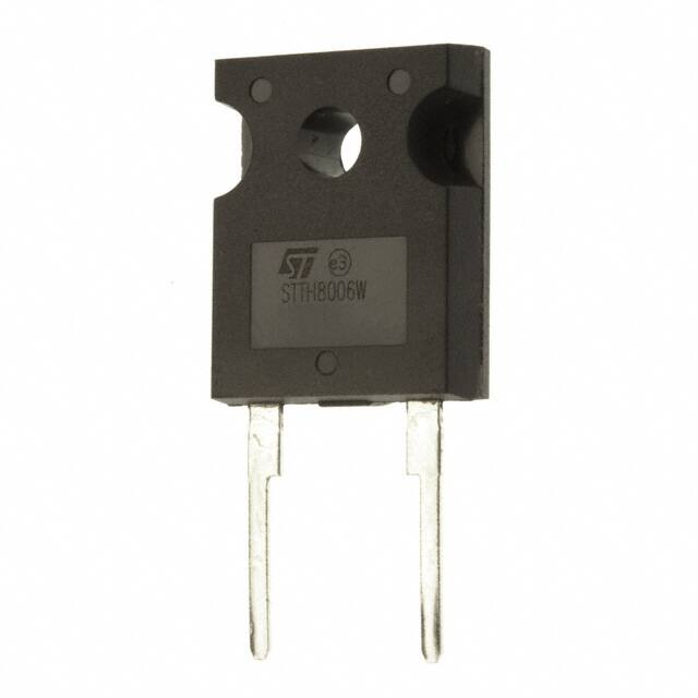

    汽车用800V桥式整流二极管,具备超低导通和反向损耗、高结温能力
STBR6008WY 数据手册
STBR6008-Y Datasheet Automotive 800 V, 60 A bridge rectifier diode A Features K A K DO-247 • • • • • AEC-Q101 qualified Ultra low conduction losses Ultra-low reverse losses High junction temperature capability (+175 °C) VRRM guaranteed from -40 to +175 °C • • PPAP capable ECOPACK2 compliant Applications • • • On board charger (OBC) Charging stations Bridge function Description The high quality design of this diode has produced a device with consistently reproducible characteristics and intrinsic ruggedness. These characteristics make it ideal for heavy duty applications that demand long term reliability like automotive applications. Product status link STBR6008-Y Thanks to its ultra-low conduction losses, the STBR6008-Y is especially suitable for use as input bridge diode in battery chargers and charging stations. Product summary Symbol Value IF(AV) 60 A VRRM 800 V Tj -40 to +175 °C VF (typ.) 1.00 V DS13045 - Rev 1 - June 2019 For further information contact your local STMicroelectronics sales office. www.st.com STBR6008-Y Characteristics 1 Characteristics Table 1. Absolute ratings (limiting values at 25 °C, unless otherwise specified) Symbol Parameter Value Unit VRRM Repetitive peak reverse voltage Tj = -40 °C to +175 °C 800 V VRSM Non-repetitive surge reverse voltage tp = 10 ms square 900 V 90 A IF(RMS) Forward rms current IF(AV) Average forward current TC = 160 °C, δ = 0.5 square wave 60 A IFSM Surge non repetitive forward current tp = 10 ms sinusoidal 500 A Tstg Storage temperature range -65 to +175 °C Operating junction temperature -40 to +175 °C Tj Table 2. Thermal parameters Symbol Rth(j-c) Parameter Junction to case Typ. value Unit 0.20 °C/W Max. Unit For more information, please refer to the following application note : • AN5088 : Rectifiers thermal management, handling and mounting recommendations Table 3. Static electrical characteristics Symbol Parameter IR Reverse leakage current VF Forward voltage drop Test conditions Tj = 25 °C Tj = 150 °C Tj = 25 °C Tj = 150 °C VR = VRRM IF = 60 A Min. Typ. - 5 - 25 250 - 1.00 1.10 - 0.88 0.97 µA V 1. Pulse test: tp = 5 ms, δ < 2% 2. Pulse test: tp = 380 µs, δ < 2% To evaluate the conduction losses, use the following equation: P = 0.75 x IF(AV) + 0.0036 x IF2(RMS) For more information, please refer to the following application notes related to the power losses: • AN604: Calculation of conduction losses in a power rectifier • AN4021: Calculation of reverse losses in a power diode DS13045 - Rev 1 page 2/9 STBR6008-Y Characteristics (curves) 1.1 Characteristics (curves) Figure 1. Average forward power dissipation versus average forward current Figure 2. Forward voltage drop versus forward current (typical values) IF (A) P(W) 100 1.0E+03 δ = 0.5 80 1.0E+02 δ = 0.2 60 Tj=150 °C 1.0E+01 δ = 0.1 δ=1 δ = 0.05 40 Tj=25 °C 1.0E+00 T 1.0E-01 20 IF(AV)(A) δ =tp/T VF (V) tp 1.0E-02 0 0 10 20 30 40 50 60 70 0.0 80 Figure 3. Forward voltage drop versus forward current (maximum values) 0.2 0.4 0.6 0.8 1.0 1.2 1.4 Figure 4. Relative variation of thermal impedance junction to case versus pulse duration Zth(j-c) /Rth(j-c) IF (A) 1.0 1.0E+03 0.9 0.8 1.0E+02 Tj=150 °C 0.7 0.6 1.0E+01 0.5 Tj=25 °C 0.4 1.0E+00 0.3 0.2 1.0E-01 0.1 VF (V) DS13045 - Rev 1 t p (s) 0.0 1.0E-02 0.0 Single pulse 0.4 0.8 1.2 1.6 1.E-03 1.E-02 1.E-01 1.E+00 page 3/9 STBR6008-Y Characteristics (curves) Figure 5. Junction capacitance versus reverse voltage applied (typical values) Figure 6. Relative variation of non-repetitive peak surge forward current versus pulse duration (sinusoidal waveform) C(pF) 1000 F=1 MHz VOSC=30 mVRMS Tj=25 °C IFSM(t p ) / IFSM(10ms) 4.0 3.5 3.0 100 2.5 2.0 1.5 VR(V) 10 1 10 100 1000 10000 Figure 7. Relative variation of non-repetitive peak surge forward current versus initial junction temperature (sinusoidal waveform) t p (ms) 1.0 0.1 1.0 10.0 Figure 8. Non repetitive surge peak forward current versus number of cycles IFSM( A) 1.2 IFSM(T j) / IFSM(25°C) 600 F = 50 Hz T initial = 25 °C j 500 1.0 400 0.8 300 0.6 200 0.4 100 0.2 T j(°C) 0.0 25 DS13045 - Rev 1 50 75 100 125 150 175 tp=10ms One cycle 0 1 Number of cycles 10 100 page 4/9 STBR6008-Y Package information 2 Package information In order to meet environmental requirements, ST offers these devices in different grades of ECOPACK packages, depending on their level of environmental compliance. ECOPACK specifications, grade definitions and product status are available at: www.st.com. ECOPACK is an ST trademark. 2.1 DO-247 package information • • • • Epoxy meets UL94, V0 Cooling method: by conduction (C) Recommended torque value: 0.8 N·m (DO-247) Maximum torque value: 1.0 N·m (DO-247) Figure 9. DO-247 package outline V Dia V A H 0.10 L5 L L2 L4 F2 L1 F3 L3 D V2 F G DS13045 - Rev 1 M E page 5/9 STBR6008-Y DO-247 package information Table 4. DO-247 package mechanical data Dimensions Ref. Millimeters Min. Max. Min. Max. A 4.85 5.15 0.191 0.203 D 2.20 2.60 0.086 0.102 E 0.40 0.80 0.015 0.031 F 1.00 1.40 0.039 0.055 F2 F3 2.00 typ. 2.00 G 0.078 typ. 2.40 0.078 10.90 typ. 0.094 0.429 typ. H 15.45 15.75 0.608 0.620 L 19.85 20.15 0.781 0.793 L1 3.70 4.30 0.145 0.169 L2 L3 18.50 typ. 14.20 0.728 typ. 14.80 0.559 0.582 L4 34.60 typ. 1.362 typ. L5 5.50 typ. 0.216 typ. M 2.00 3.00 0.078 0.118 V 5° 5° V2 60° 60° Dia. DS13045 - Rev 1 Inches 3.55 3.65 0.139 0.143 page 6/9 STBR6008-Y Ordering information 3 Ordering information Table 5. Ordering information DS13045 - Rev 1 Order code Marking Package Weight Base qty. Delivery mode STBR6008WY STBR6008WY DO-247 4.4 g 30 Tube page 7/9 STBR6008-Y Revision history Table 6. Document revision history DS13045 - Rev 1 Date Revision 10-Jun-2019 1 Changes First issue. page 8/9 STBR6008-Y IMPORTANT NOTICE – PLEASE READ CAREFULLY STMicroelectronics NV and its subsidiaries (“ST”) reserve the right to make changes, corrections, enhancements, modifications, and improvements to ST products and/or to this document at any time without notice. Purchasers should obtain the latest relevant information on ST products before placing orders. ST products are sold pursuant to ST’s terms and conditions of sale in place at the time of order acknowledgement. Purchasers are solely responsible for the choice, selection, and use of ST products and ST assumes no liability for application assistance or the design of Purchasers’ products. No license, express or implied, to any intellectual property right is granted by ST herein. Resale of ST products with provisions different from the information set forth herein shall void any warranty granted by ST for such product. ST and the ST logo are trademarks of ST. For additional information about ST trademarks, please refer to www.st.com/trademarks. All other product or service names are the property of their respective owners. Information in this document supersedes and replaces information previously supplied in any prior versions of this document. © 2019 STMicroelectronics – All rights reserved DS13045 - Rev 1 page 9/9
