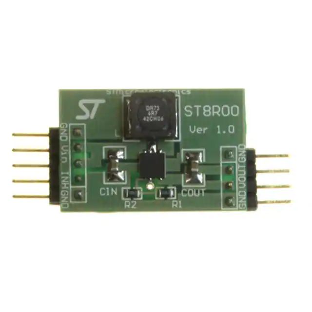

STEVAL-ISA048V2 1 A adjustable Vout PWM synchronous step-up DC-DC converter demonstration board based on the ST8R00W Data brief Features ■ Very low supply current: 500 µA (typ) ■ Output voltage adjustable from 6 V to 12 V ■ Output voltage accuracy: ±2% ■ Output current up to 1 A ■ Low ripple voltage: 5 mV (typ) ■ Synchronous rectification ■ High 90% efficiency: VO = 9 V (typ) ■ Few external components ■ RoHS compliant Description STEVAL-ISA048V2 This demonstration board is based on the ST8R00W family of synchronous step-up DC-DC converters with current output cut-off function that provide up to 1 A over an input voltage range of 4 V to 6 V and an output voltage range of 6 V to 12 V. The ST8R00W is the continuous mode version, that guarantees the lowest switching ripple when the device is used at light load conditions. The high switching frequency (1.2 MHz) allows the use of tiny surface-mount components. Along with the resistor divider to set the output voltage value, an inductor and two capacitors are required. A low output ripple is guaranteed by the current mode PWM topology and by the use of low ESR surface-mounted ceramic capacitors. July 2009 Doc ID 15975 Rev 1 For further information contact your local STMicroelectronics sales office. 1/4 www.st.com 4 Circuit schematic 1 STEVAL-ISA048V2 Circuit schematic Figure 1. Schematic diagram ,—( 6IN ). #IN—& ).( ,8 /54 342  2 &" (6 '.$ 6OU T 0'.$ #OUT—& 2 ".W 2/4 Doc ID 15975 Rev 1 STEVAL-ISA048V2 2 Revision history Revision history Table 1. Document revision history Date Revision 01-Jul-2009 1 Changes Initial release. Doc ID 15975 Rev 1 3/4 STEVAL-ISA048V2 Please Read Carefully: Information in this document is provided solely in connection with ST products. STMicroelectronics NV and its subsidiaries (“ST”) reserve the right to make changes, corrections, modifications or improvements, to this document, and the products and services described herein at any time, without notice. All ST products are sold pursuant to ST’s terms and conditions of sale. Purchasers are solely responsible for the choice, selection and use of the ST products and services described herein, and ST assumes no liability whatsoever relating to the choice, selection or use of the ST products and services described herein. No license, express or implied, by estoppel or otherwise, to any intellectual property rights is granted under this document. If any part of this document refers to any third party products or services it shall not be deemed a license grant by ST for the use of such third party products or services, or any intellectual property contained therein or considered as a warranty covering the use in any manner whatsoever of such third party products or services or any intellectual property contained therein. UNLESS OTHERWISE SET FORTH IN ST’S TERMS AND CONDITIONS OF SALE ST DISCLAIMS ANY EXPRESS OR IMPLIED WARRANTY WITH RESPECT TO THE USE AND/OR SALE OF ST PRODUCTS INCLUDING WITHOUT LIMITATION IMPLIED WARRANTIES OF MERCHANTABILITY, FITNESS FOR A PARTICULAR PURPOSE (AND THEIR EQUIVALENTS UNDER THE LAWS OF ANY JURISDICTION), OR INFRINGEMENT OF ANY PATENT, COPYRIGHT OR OTHER INTELLECTUAL PROPERTY RIGHT. UNLESS EXPRESSLY APPROVED IN WRITING BY AN AUTHORIZED ST REPRESENTATIVE, ST PRODUCTS ARE NOT RECOMMENDED, AUTHORIZED OR WARRANTED FOR USE IN MILITARY, AIR CRAFT, SPACE, LIFE SAVING, OR LIFE SUSTAINING APPLICATIONS, NOR IN PRODUCTS OR SYSTEMS WHERE FAILURE OR MALFUNCTION MAY RESULT IN PERSONAL INJURY, DEATH, OR SEVERE PROPERTY OR ENVIRONMENTAL DAMAGE. ST PRODUCTS WHICH ARE NOT SPECIFIED AS "AUTOMOTIVE GRADE" MAY ONLY BE USED IN AUTOMOTIVE APPLICATIONS AT USER’S OWN RISK. Resale of ST products with provisions different from the statements and/or technical features set forth in this document shall immediately void any warranty granted by ST for the ST product or service described herein and shall not create or extend in any manner whatsoever, any liability of ST. ST and the ST logo are trademarks or registered trademarks of ST in various countries. Information in this document supersedes and replaces all information previously supplied. The ST logo is a registered trademark of STMicroelectronics. All other names are the property of their respective owners. © 2009 STMicroelectronics - All rights reserved STMicroelectronics group of companies Australia - Belgium - Brazil - Canada - China - Czech Republic - Finland - France - Germany - Hong Kong - India - Israel - Italy - Japan Malaysia - Malta - Morocco - Philippines - Singapore - Spain - Sweden - Switzerland - United Kingdom - United States of America www.st.com 4/4 Doc ID 15975 Rev 1
