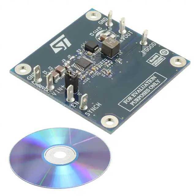

STEVAL-ISA152V1 3.3 V/3 A high efficiency step down DC-DC converter (VIN= 4.5 to 60 V) based on the L7987 Data brief Description The STEVAL-ISA152V1 product evaluation board is a step-down switching power supply based on the L7987 regulator in an HTSSOP16 package. The output voltage can be set starting from 0.8 V. Low drop-out operation, with almost 100% duty cycle, can be achieved. The L7987 is a 61 V, 3 A step-down asynchronous switching regulator with embedded power MOSFET caable of delivering up to 3 A of current, depending on the application conditions. Features • • • • • • • • • • 3.3 V output voltage 3 A DC output current 4.5 V to 60 V input voltage 500 kHz switching frequency 3.5 ms programmed soft-start VBIAS switch-over for improved efficiency at light load 180° out of phase synchronization available Open drain PGOOD available Auto recovery overcurrent and thermal protection RoHS compliant May 2014 The embedded switch-over feature on the VBIAS pin and the light load management (pulse skipping) are intended to maximize power conversion efficiency across the entire load range. The soft-start, current limit threshold and the switching frequency are adjustable for application optimization. The device includes an internal 250 kHz oscillator that can be externally adjusted up to 1.5 MHz; two L7987 regulators can be synchronized in a 180° out-of-phase configuration for reduced total input RMS current. DocID025489 Rev 1 For further information contact your local STMicroelectronics sales office 1/4 www.st.com DocID025489 Rev 1 GND EN TP6 TP5 J1 R4 0 4.7uF 100V C1 VIN 4.7uF 100V C2 TP3 1uF 100V C3 TP2 1uF 100V C4 SYNCH 22nF C10 R9 NM R8 47k 11 10 6 5 4 2 3 7 U1 ILIM FSW SS EN VCC VIN VIN SYNCH GND 16 TP 17 L7987 NM COMP FB LX LX BOOT VBIAS PGOOD D1 100nF C7 R3 0 STPS3L60 8 9 13 14 15 1 12 C11 power GND R10 N.M. 1nF 620 C9 L1 signal GND R6 J3 33nF 10uH R2 R7 R11 2.2k R5 J2 100k 68 6.8k C8 10nF 47uF 2/4 C5 GSPG08112013DI1045 NM TP7 TP4 TP1 GND VOUT PGOOD 1 C6 R1 Schematic diagram STEVAL-ISA152V1 Schematic diagram Figure 1: Schematic diagram STEVAL-ISA152V1 2 Revision history Revision history Table 1: Document revision history Date Rev 09-May-2014 1 DocID025489 Rev 1 Changes First release. 3/4 STEVAL-ISA152V1 Please Read Carefully Information in this document is provided solely in connection with ST products. STMicroelectronics NV and its subsidiaries ("ST") reserve the right to make changes, corrections, modifications or improvements, to this document, and the products and services described herein at any time, without notice. All ST products are sold pursuant to ST’s terms and conditions of sale. Purchasers are solely responsible for the choice, selection and use of the ST products and services described herein, and ST assumes no liability whatsoever relating to the choice, selection or use of the ST products and services described herein. No license, express or implied, by estoppel or otherwise, to any intellectual property rights is granted under this document. If any part of this document refers to any third party products or services it shall not be deemed a license grant by ST for the use of such third party products or services, or any intellectual property contained therein or considered as a warranty covering the use in any manner whatsoever of such third party products or services or any intellectual property contained therein. UNLESS OTHERWISE SET FORTH IN ST’S TERMS AND CONDITIONS OF SALE ST DISCLAIMS ANY EXPRESS OR IMPLIED WARRANTY WITH RESPECT TO THE USE AND/OR SALE OF ST PRODUCTS INCLUDING WITHOUT LIMITATION IMPLIED WARRANTIES OF MERCHANTABILITY, FITNESS FOR A PARTICULAR PURPOSE (AND THEIR EQUIVALENTS UNDER THE LAWS OF ANY JURISDICTION), OR INFRINGEMENT OF ANY PATENT, COPYRIGHT OR OTHER INTELLECTUAL PROPERTY RIGHT. ST PRODUCTS ARE NOT DESIGNED OR AUTHORIZED FOR USE IN: (A) SAFETY CRITICAL APPLICATIONS SUCH AS LIFE SUPPORTING, ACTIVE IMPLANTED DEVICES OR SYSTEMS WITH PRODUCT FUNCTIONAL SAFETY REQUIREMENTS; (B) AERONAUTIC APPLICATIONS; (C) AUTOMOTIVE APPLICATIONS OR ENVIRONMENTS, AND/OR (D) AEROSPACE APPLICATIONS OR ENVIRONMENTS. WHERE ST PRODUCTS ARE NOT DESIGNED FOR SUCH USE, THE PURCHASER SHALL USE PRODUCTS AT PURCHASER’S SOLE RISK, EVEN IF ST HAS BEEN INFORMED IN WRITING OF SUCH USAGE, UNLESS A PRODUCT IS EXPRESSLY DESIGNATED BY ST AS BEING INTENDED FOR "AUTOMOTIVE, AUTOMOTIVE SAFETY OR MEDICAL" INDUSTRY DOMAINS ACCORDING TO ST PRODUCT DESIGN SPECIFICATIONS. PRODUCTS FORMALLY ESCC, QML OR JAN QUALIFIED ARE DEEMED SUITABLE FOR USE IN AEROSPACE BY THE CORRESPONDING GOVERNMENTAL AGENCY. Resale of ST products with provisions different from the statements and/or technical features set forth in this document shall immediately void any warranty granted by ST for the ST product or service described herein and shall not create or extend in any manner whatsoever, any liability of ST. ST and the ST logo are trademarks or registered trademarks of ST in various countries. Information in this document supersedes and replaces all information previously supplied. The ST logo is a registered trademark of STMicroelectronics. All other names are the property of their respective owners. © 2014 STMicroelectronics - All rights reserved STMicroelectronics group of companies Australia - Belgium - Brazil - Canada - China - Czech Republic - Finland - France - Germany - Hong Kong - India - Israel - Italy - Japan Malaysia - Malta - Morocco - Philippines - Singapore - Spain - Sweden - Switzerland - United Kingdom - United States of America www.st.com 4/4 DocID025489 Rev 1
