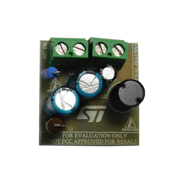

STEVAL-ISA178V1 is a compact and efficient
solution for AC-DC power supplies, and performs
voltage conversion from the main line down to 5
V output voltage.
The low current consumption of the VIPer01 and
its low VCC voltage allows extremely low input
power consumption under no load and light load
conditions.
The pulse skip feature embedded in our IC
reduces the peak current typically present during
the startup phase of a buck converter.
