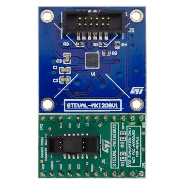

STEVAL-MKI208V1K Data brief 3-axis digital accelerometer sensor kit based on IIS3DWB Features • • • • • User friendly IIS3DWB board Complete IIS3DWB pinout for a standard DIL 24 socket Fully compatible with STEVAL-MKI109V3 motherboard Double-sided adhesives included for easy mounting on equipment to be measured RoHS and WEEE compliant Description The STEVAL-MKI208V1K evaluation board has an embedded IIS3DWB 3D accelerometer sensor, which is connected via cable to a simple adapter board (STEVAL-MKIGIBV2) to render it compatible with STEVAL-MKI109V3 motherboards. The sensor is soldered precisely in the center of the board and double-sided adhesives are provided to allow users to conveniently mount the board on equipment destined for vibration analysis. Alternatively, you can mount the board using the holes located in each corner of the PCB. The STEVAL-MKIGIBV2 can be plugged into a standard DIL 24 socket. The kit provides the complete IIS3DWB pin-out and comes ready-to-use with the required decoupling capacitors on the VDD power supply line. Product summary iNemo inertial module kit based on IIS3DWB The STEVAL-MKI109V3 motherboards feature a high performance 32-bit microcontroller functioning as a bridge between the sensor and a PC running the free Unico GUI graphical user interface or dedicated software routines for customized applications. STEVALMKI208V1K Ultra-wide bandwidth (up to 6 kHz), low-noise, IIS3DWB 3-axis digital vibration sensor ST MEMS adapter motherboard based on STM32F401VE compatible ST MEMS adapters STEVALMKI109V3 Application IoT for Smart Things DB4012 - Rev 3 - November 2020 For further information contact your local STMicroelectronics sales office. www.st.com STEVAL-MKI208V1K Schematic diagrams 1 Schematics Figure 1. STEVAL-MKI208V1 board schematic CS SCL SDA GND 12 13 RES INT2 INT1 VDD 10 VDD 9 INT1 INT2 J1 1 3 5 7 9 11 2 4 6 8 10 12 R2 R3 R1 33 SDO SDA R4 33 SCL CS INT2 33 33 GND Header 6x2 8 VDD VDD VDDIO GND VDDIO 4 NC 11 7 INT1 NC RES VDDIO 3 SDO GND 2 6 1 5 SDO VDD VDDIO IIS3DWB CS SCL SDA 14 U1 GND C1 C2 C3 100nF 1mF 100nF GND GND GND GND Figure 2. STEVAL-MKIGIBV2 board schematic VDDIO VDD VDDIO VDD OCS CSX SDX OSDO J1 CSX SDX OSDO INT1 1 2 3 4 5 6 7 8 9 10 11 12 Header 6X2 SDO-SAO SDA SCL CS R1 DNM R2 0R DB4012 - Rev 3 OCS 0R INT2 JP1 1 2 3 4 5 6 7 8 9 10 11 12 Header 12 JP2 24 23 22 21 20 19 18 17 16 15 14 13 SDO-SAO SDA SCL CS INT2 INT1 Header 12 page 2/4 STEVAL-MKI208V1K Revision history Table 1. Document revision history DB4012 - Rev 3 Date Version Changes 10-Dec-2019 1 Initial release. 11-Mar-2020 2 Updated description. 05-Nov-2020 3 Updated title. page 3/4 STEVAL-MKI208V1K IMPORTANT NOTICE – PLEASE READ CAREFULLY STMicroelectronics NV and its subsidiaries (“ST”) reserve the right to make changes, corrections, enhancements, modifications, and improvements to ST products and/or to this document at any time without notice. Purchasers should obtain the latest relevant information on ST products before placing orders. ST products are sold pursuant to ST’s terms and conditions of sale in place at the time of order acknowledgement. Purchasers are solely responsible for the choice, selection, and use of ST products and ST assumes no liability for application assistance or the design of Purchasers’ products. No license, express or implied, to any intellectual property right is granted by ST herein. Resale of ST products with provisions different from the information set forth herein shall void any warranty granted by ST for such product. ST and the ST logo are trademarks of ST. For additional information about ST trademarks, please refer to www.st.com/trademarks. All other product or service names are the property of their respective owners. Information in this document supersedes and replaces information previously supplied in any prior versions of this document. © 2020 STMicroelectronics – All rights reserved DB4012 - Rev 3 page 4/4

1. 物料型号:STEVAL-MKI208V1K,这是一个评估板,内嵌有IIS3DWB 3D加速度传感器。 2. 器件简介:STEVAL-MKI208V1K评估板通过电缆连接到一个简单的适配器板(STEVAL-MKIGIBV2),使其与STEVAL-MKI109V3主板兼容。传感器精确地焊接在板的中心位置,提供了双面胶带,方便用户将评估板安装在用于振动分析的设备上。 3. 引脚分配:文档提供了STEVAL-MKI208V1和STEVAL-MKIGIBV2的电路图,展示了各引脚的分配和连接方式。 4. 参数特性:文档提到了传感器的超宽带宽(高达6kHz)、低噪声特性,适用于3轴数字振动传感器。 5. 功能详解:STEVAL-MKI109V3主板上有一个高性能的32位微控制器,作为传感器和运行免费Unico GUI图形用户界面的PC之间的桥梁,或者用于定制应用的专用软件例程。 6. 应用信息:适用于物联网智能设备,3轴数字加速度传感器套件基于IIS3DWB。 7. 封装信息:STEVAL-MKI208V1K评估板完全符合RoHS和WEEE标准,提供了完整的IIS3DWB引脚配置,适用于标准DIL 24插座。
