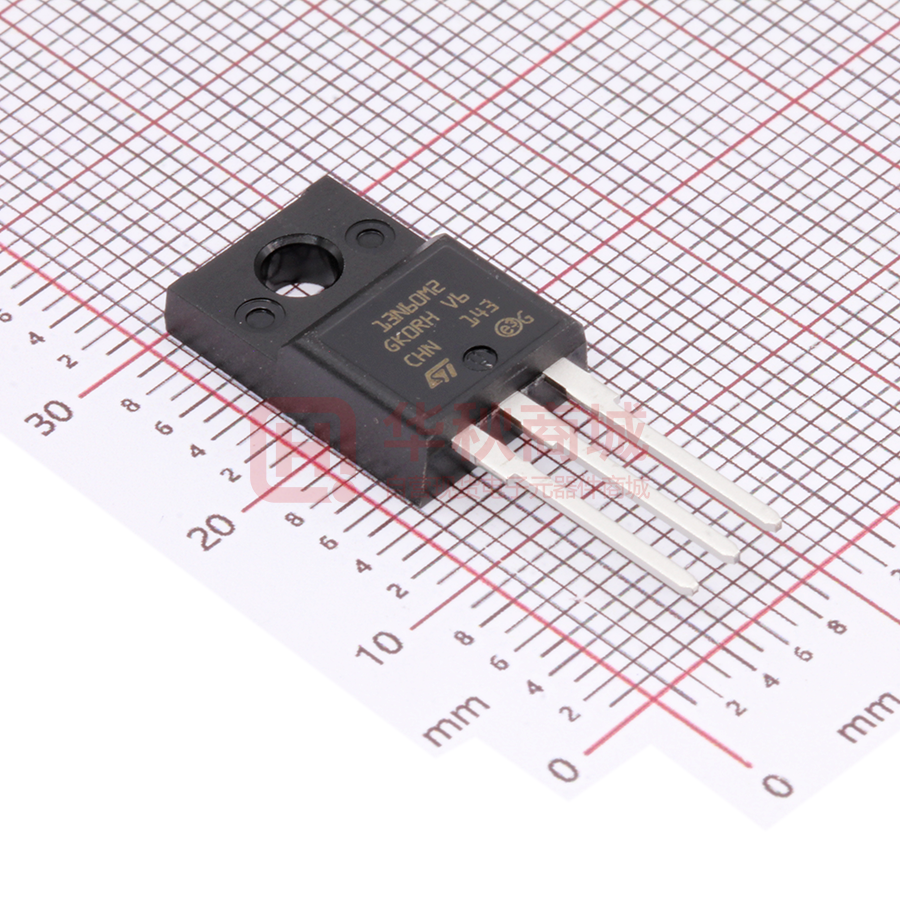

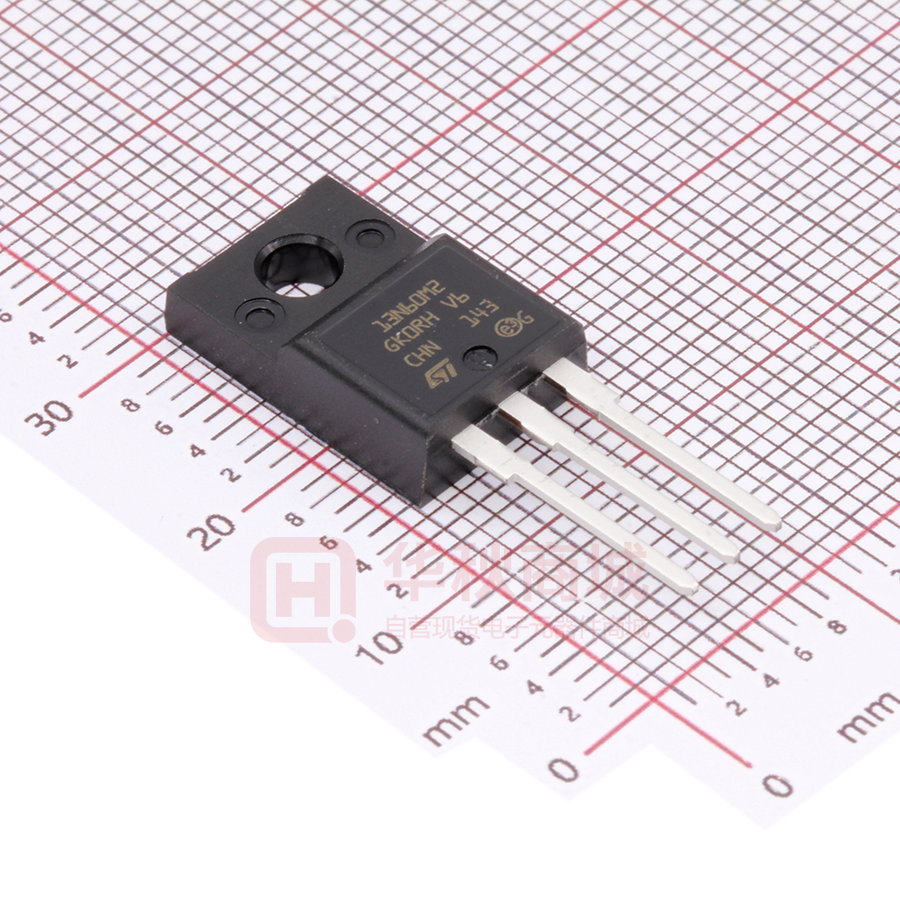

    通孔 N 通道 600 V 11A(Tc) 25W(Tc) TO-220FP
STF13N60M2 数据手册
STF13N60M2, STFI13N60M2 N-channel 600 V, 0.35 Ω typ., 11 A MDmesh II Plus™ low Qg Power MOSFETs in TO-220FP and I2PAKFP packages Datasheet − production data Features Order codes VDS @ TJmax RDS(on) max ID 650 V 0.38 Ω 11 A STF13N60M2 STFI13N60M2 • Extremely low gate charge 3 2 1 TO-220FP 1 2 • Lower RDS(on) x area vs previous generation 3 I2PAKFP (TO-281) • Low gate input resistance • 100% avalanche tested • Zener-protected Figure 1. Internal schematic diagram Applications • Switching applications Description These devices are N-channel Power MOSFETs developed using a new generation of MDmesh™ technology: MDmesh II Plus™ low Qg. These revolutionary Power MOSFETs associate a vertical structure to the company's strip layout to yield one of the world's lowest on-resistance and gate charge. They are therefore suitable for the most demanding high efficiency converters. AM15572v1 Table 1. Device summary Order codes Marking Package STF13N60M2 TO-220FP 13N60M2 STFI13N60M2 March 2014 This is information on a product in full production. Packaging Tube I2PAKFP (TO-281) DocID023939 Rev 4 1/14 www.st.com 14 Contents STF13N60M2, STFI13N60M2 Contents 1 Electrical ratings . . . . . . . . . . . . . . . . . . . . . . . . . . . . . . . . . . . . . . . . . . . . 3 2 Electrical characteristics . . . . . . . . . . . . . . . . . . . . . . . . . . . . . . . . . . . . . 4 2.1 Electrical characteristics (curves) . . . . . . . . . . . . . . . . . . . . . . . . . . . . . . . . 6 3 Test circuits 4 Package mechanical data . . . . . . . . . . . . . . . . . . . . . . . . . . . . . . . . . . . . . 9 5 Revision history . . . . . . . . . . . . . . . . . . . . . . . . . . . . . . . . . . . . . . . . . . . 13 2/14 .............................................. 8 DocID023939 Rev 4 STF13N60M2, STFI13N60M2 1 Electrical ratings Electrical ratings Table 2. Absolute maximum ratings Symbol VGS ID Parameter Gate-source voltage Drain current (continuous) at TC = 25 °C ID Unit ± 25 V (1) A 11 Drain current (continuous) at TC = 100 °C IDM (2) Drain current (pulsed) PTOT dv/dt Value (3) dv/dt(4) A 44 (1) A Total dissipation at TC = 25 °C 25 W Peak diode recovery voltage slope 15 V/ns MOSFET dv/dt ruggedness 50 V/ns 2500 V - 55 to 150 °C Value Unit 5 °C/W 62.5 °C/W Value Unit VISO Insulation withstand voltage (RMS) from all three leads to external heat sink (t = 1 s; TC = 25 °C) Tstg Storage temperature Tj 7 (1) Max. operating junction temperature 1. Limited by maximum junction temperature. 2. Pulse width limited by safe operating area. 3. ISD ≤ 11 A, di/dt ≤ 400 A/μs; VDS peak < V(BR)DSS, VDD=400 V. 4. VDS ≤ 480 V Table 3. Thermal data Symbol Parameter Rthj-case Thermal resistance junction-case max Rthj-amb Thermal resistance junction-ambient max Table 4. Avalanche characteristics Symbol Parameter IAR Avalanche current, repetetive or not repetetive (pulse width limited by Tjmax) 2.8 A EAS Single pulse avalanche energy (starting Tj=25°C, ID= IAR; VDD=50) 125 mJ DocID023939 Rev 4 3/14 Electrical characteristics 2 STF13N60M2, STFI13N60M2 Electrical characteristics (TC = 25 °C unless otherwise specified) Table 5. On /off states Symbol V(BR)DSS Parameter Drain-source breakdown voltage Test conditions ID = 1 mA, VGS = 0 Min. Typ. Max. Unit 600 V IDSS Zero gate voltage VDS = 600 V drain current (VGS = 0) VDS = 600 V, TC=125 °C 1 100 μA μA IGSS Gate-body leakage current (VDS = 0) ±10 μA 3 4 V 0.35 0.38 Ω Min. Typ. Max. Unit - 580 - pF - 32 - pF - 1.1 - pF VGS = ± 25 V VGS(th) Gate threshold voltage VDS = VGS, ID = 250 μA RDS(on) Static drain-source on-resistance 2 VGS = 10 V, ID = 5.5 A Table 6. Dynamic Symbol Parameter Test conditions Ciss Input capacitance Coss Output capacitance Crss Reverse transfer capacitance Coss eq.(1) Equivalent output capacitance VDS = 0 to 480 V, VGS = 0 - 120 - pF RG Intrinsic gate resistance f = 1 MHz open drain - 6.6 - Ω Qg Total gate charge - 17 - nC - 2.5 - nC - 9 - nC Qgs Gate-source charge Qgd Gate-drain charge VDS = 100 V, f = 1 MHz, VGS = 0 VDD = 480 V, ID = 11 A, VGS = 10 V (see Figure 15) 1. Coss eq. is defined as a constant equivalent capacitance giving the same charging time as Coss when VDS increases from 0 to 80% VDSS Table 7. Switching times Symbol td(on) tr td(off) tf 4/14 Parameter Test conditions Turn-on delay time Rise time Turn-off delay time VDD = 300 V, ID = 5.5 A, RG = 4.7 Ω, VGS = 10 V (see Figure 14 and 19) Fall time DocID023939 Rev 4 Min. Typ. Max. Unit - 11 - ns - 10 - ns - 41 - ns - 9.5 - ns STF13N60M2, STFI13N60M2 Electrical characteristics Table 8. Source drain diode Symbol Parameter Test conditions Min. Typ. Max. Unit Source-drain current - 11 A ISDM (1) Source-drain current (pulsed) - 44 A VSD (2) Forward on voltage - 1.6 V ISD trr ISD = 11 A, VGS = 0 Reverse recovery time Qrr Reverse recovery charge IRRM Reverse recovery current trr Reverse recovery time Qrr Reverse recovery charge IRRM Reverse recovery current ISD = 11 A, di/dt = 100 A/μs VDD = 60 V (see Figure 16) ISD = 11 A, di/dt = 100 A/μs VDD = 60 V, Tj=150 °C (see Figure 16) - 297 ns - 2.8 μC - 18.5 A - 394 ns - 3.8 μC - 19 A 1. Pulse width limited by safe operating area 2. Pulsed: pulse duration = 300 μs, duty cycle 1.5% DocID023939 Rev 4 5/14 Electrical characteristics 2.1 STF13N60M2, STFI13N60M2 Electrical characteristics (curves) Figure 2. Safe operating area Figure 3. Thermal impedance AM15735v1 ID (A) 10 in th is n m tio y ra d b e e p O imit L 1 ar ax ea R D is S( on ) 10µs 100 µS 1ms 10ms 0.1 Tj=150°C Tc=25°C Single pulse 0.01 0.1 10 1 VDS(V) 100 Figure 4. Output characteristics Figure 5. Transfer characteristics AM15712v1 ID (A) AM15713v1 ID (A) VGS=7, 8, 9, 10V 20 20 VDS=18V 6V 16 16 12 12 5V 8 8 4 4 4V 0 0 4 12 8 16 Figure 6. Normalized V(BR)DSS vs temperature AM15714v1 V(BR)DSS (norm) 0 0 VDS(V) ID=1 mA 2 4 8 6 VGS(V) Figure 7. Static drain-source on-resistance AM15715v1 RDS(on) (Ω) VGS=10V 1.1 0.370 1.06 0.360 1.02 0.350 0.98 0.340 0.94 0.9 -50 6/14 0.330 0 50 100 TJ(°C) DocID023939 Rev 4 0 2 4 6 8 10 ID(A) STF13N60M2, STFI13N60M2 Electrical characteristics Figure 8. Gate charge vs gate-source voltage AM15716v1 VDS VGS (V) 10 (V) VDD=480V ID=11A VDS 500 Figure 9. Capacitance variations AM15717v1 C (pF) 1000 Ciss 400 8 100 300 6 Coss 10 4 200 2 100 0 0 8 4 12 0 Qg(nC) 16 Figure 10. Normalized gate threshold voltage vs temperature AM15718v1 VGS(th) (norm) 1 Crss 0.1 0.1 1 10 100 VDS(V) Figure 11. Normalized on-resistance vs temperature AM15719v1 RDS(on) (norm) 1.1 ID=250µA ID=5.5 A VGS=10V 2.1 1.0 1.7 0.9 1.3 0.8 0.9 0.7 0.6 -50 100 50 0 0.5 -50 TJ(°C) Figure 12. Source-drain diode forward characteristics AM15720v1 VSD (V) 100 50 0 TJ(°C) Figure 13. Output capacitance stored energy AM15721v1 Eoss(µJ) TJ=-50°C 1 4 TJ=25°C 0.9 3 0.8 2 0.7 TJ=150°C 1 0.6 0.5 0 2 4 6 8 10 ISD(A) DocID023939 Rev 4 0 0 100 200 300 400 500 VDS(V) 7/14 Test circuits 3 STF13N60M2, STFI13N60M2 Test circuits Figure 14. Switching times test circuit for resistive load Figure 15. Gate charge test circuit VDD 12V 47kΩ 1kΩ 100nF 3.3 μF 2200 RL μF IG=CONST VDD VGS 100Ω Vi=20V=VGMAX VD RG 2200 μF D.U.T. D.U.T. VG 2.7kΩ PW 47kΩ 1kΩ PW AM01468v1 Figure 16. Test circuit for inductive load switching and diode recovery times A A AM01469v1 Figure 17. Unclamped inductive load test circuit L A D G D.U.T. FAST DIODE B B VD L=100μH S 3.3 μF B 25 Ω 1000 μF D VDD 2200 μF 3.3 μF VDD ID G RG S Vi D.U.T. Pw AM01470v1 AM01471v1 Figure 18. Unclamped inductive waveform Figure 19. Switching time waveform ton V(BR)DSS tdon VD toff tr tdoff tf 90% 90% IDM 10% ID VDD 10% 0 VDD VDS 90% VGS AM01472v1 8/14 0 DocID023939 Rev 4 10% AM01473v1 STF13N60M2, STFI13N60M2 4 Package mechanical data Package mechanical data In order to meet environmental requirements, ST offers these devices in different grades of ECOPACK® packages, depending on their level of environmental compliance. ECOPACK® specifications, grade definitions and product status are available at: www.st.com. ECOPACK® is an ST trademark. DocID023939 Rev 4 9/14 Package mechanical data STF13N60M2, STFI13N60M2 Figure 20. TO-220FP drawing 7012510_Rev_K_B 10/14 DocID023939 Rev 4 STF13N60M2, STFI13N60M2 Package mechanical data Table 9. TO-220FP mechanical data mm Dim. Min. Typ. Max. A 4.4 4.6 B 2.5 2.7 D 2.5 2.75 E 0.45 0.7 F 0.75 1 F1 1.15 1.70 F2 1.15 1.70 G 4.95 5.2 G1 2.4 2.7 H 10 10.4 L2 16 L3 28.6 30.6 L4 9.8 10.6 L5 2.9 3.6 L6 15.9 16.4 L7 9 9.3 Dia 3 3.2 DocID023939 Rev 4 11/14 Package mechanical data STF13N60M2, STFI13N60M2 Figure 21. I2PAKFP (TO-281) drawing REV! Table 10. I2PAKFP (TO-281) mechanical data mm Dim. Min. Typ. A 4.40 4.60 B 2.50 2.70 D 2.50 2.75 D1 0.65 0.85 E 0.45 0.70 F 0.75 1.00 F1 12/14 Max. 1.20 G 4.95 H 10.00 10.40 L1 21.00 23.00 L2 13.20 14.10 L3 10.55 10.85 L4 2.70 3.20 L5 0.85 1.25 L6 7.30 7.50 - DocID023939 Rev 4 5.20 STF13N60M2, STFI13N60M2 5 Revision history Revision history Table 11. Document revision history Date Revision Changes 18-Dec-2012 1 First release. 17-Apr-2013 2 – Added: note 4 on Table 2 – Modified: ID value on Table 2, IAR, IAS on Table 4, RDS(on) on Table 5 – Updated: typical values for Table 6, 7 and 8 – Modified: Figure 1 21-Jun-2013 3 – Document status promoted from preliminary data to production data – Minor text changes 03-Mar-2014 4 – Modified: Figure 11 – Minor text changes DocID023939 Rev 4 13/14 STF13N60M2, STFI13N60M2 Please Read Carefully: Information in this document is provided solely in connection with ST products. STMicroelectronics NV and its subsidiaries (“ST”) reserve the right to make changes, corrections, modifications or improvements, to this document, and the products and services described herein at any time, without notice. All ST products are sold pursuant to ST’s terms and conditions of sale. Purchasers are solely responsible for the choice, selection and use of the ST products and services described herein, and ST assumes no liability whatsoever relating to the choice, selection or use of the ST products and services described herein. No license, express or implied, by estoppel or otherwise, to any intellectual property rights is granted under this document. If any part of this document refers to any third party products or services it shall not be deemed a license grant by ST for the use of such third party products or services, or any intellectual property contained therein or considered as a warranty covering the use in any manner whatsoever of such third party products or services or any intellectual property contained therein. UNLESS OTHERWISE SET FORTH IN ST’S TERMS AND CONDITIONS OF SALE ST DISCLAIMS ANY EXPRESS OR IMPLIED WARRANTY WITH RESPECT TO THE USE AND/OR SALE OF ST PRODUCTS INCLUDING WITHOUT LIMITATION IMPLIED WARRANTIES OF MERCHANTABILITY, FITNESS FOR A PARTICULAR PURPOSE (AND THEIR EQUIVALENTS UNDER THE LAWS OF ANY JURISDICTION), OR INFRINGEMENT OF ANY PATENT, COPYRIGHT OR OTHER INTELLECTUAL PROPERTY RIGHT. ST PRODUCTS ARE NOT DESIGNED OR AUTHORIZED FOR USE IN: (A) SAFETY CRITICAL APPLICATIONS SUCH AS LIFE SUPPORTING, ACTIVE IMPLANTED DEVICES OR SYSTEMS WITH PRODUCT FUNCTIONAL SAFETY REQUIREMENTS; (B) AERONAUTIC APPLICATIONS; (C) AUTOMOTIVE APPLICATIONS OR ENVIRONMENTS, AND/OR (D) AEROSPACE APPLICATIONS OR ENVIRONMENTS. WHERE ST PRODUCTS ARE NOT DESIGNED FOR SUCH USE, THE PURCHASER SHALL USE PRODUCTS AT PURCHASER’S SOLE RISK, EVEN IF ST HAS BEEN INFORMED IN WRITING OF SUCH USAGE, UNLESS A PRODUCT IS EXPRESSLY DESIGNATED BY ST AS BEING INTENDED FOR “AUTOMOTIVE, AUTOMOTIVE SAFETY OR MEDICAL” INDUSTRY DOMAINS ACCORDING TO ST PRODUCT DESIGN SPECIFICATIONS. PRODUCTS FORMALLY ESCC, QML OR JAN QUALIFIED ARE DEEMED SUITABLE FOR USE IN AEROSPACE BY THE CORRESPONDING GOVERNMENTAL AGENCY. Resale of ST products with provisions different from the statements and/or technical features set forth in this document shall immediately void any warranty granted by ST for the ST product or service described herein and shall not create or extend in any manner whatsoever, any liability of ST. ST and the ST logo are trademarks or registered trademarks of ST in various countries. Information in this document supersedes and replaces all information previously supplied. The ST logo is a registered trademark of STMicroelectronics. All other names are the property of their respective owners. © 2014 STMicroelectronics - All rights reserved STMicroelectronics group of companies Australia - Belgium - Brazil - Canada - China - Czech Republic - Finland - France - Germany - Hong Kong - India - Israel - Italy - Japan Malaysia - Malta - Morocco - Philippines - Singapore - Spain - Sweden - Switzerland - United Kingdom - United States of America www.st.com 14/14 DocID023939 Rev 4
