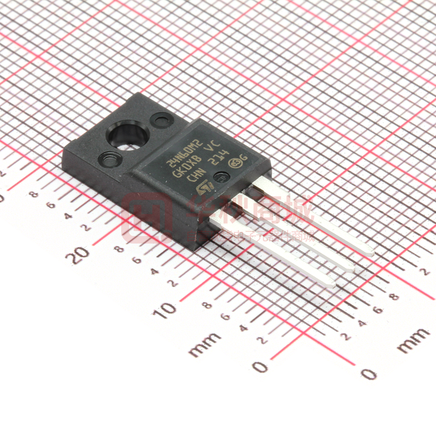

STF24N60M2 Datasheet N-channel 600 V, 168 mΩ typ., 18 A MDmesh M2 Power MOSFET in a TO-220FP package Features 1 2 3 TO-220FP Order code VDS @TJmax RDS(on) max. ID STF24N60M2 650 V 190 mΩ 18 A • • Extremely low gate charge Excellent output capacitance (Coss) profile • • 100% avalanche tested Zener-protected D(2) Applications • • • G(1) Switching applications LCC converters Resonant converters Description S(3) AM15572v1_no_tab This device is an N-channel Power MOSFET developed using MDmesh M2 technology. Thanks to its strip layout and an improved vertical structure, the device exhibits low on-resistance and optimized switching characteristics, rendering it suitable for the most demanding high efficiency converters. Product status link STF24N60M2 Product summary Order code STF24N60M2 Marking 24N60M2 Package TO-220FP Packing Tube DS9402 - Rev 7 - February 2020 For further information contact your local STMicroelectronics sales office. www.st.com STF24N60M2 Electrical ratings 1 Electrical ratings Table 1. Absolute maximum ratings Symbol Value Unit Gate-source voltage ±25 V Drain current (continuous) at TC = 25 °C 18 A Drain current (continuous) at TC = 100 °C 12 A Drain current (pulsed) 72 A Total power dissipation at TC = 25 °C 30 W Peak diode recovery voltage slope 15 V/ns MOSFET dv/dt ruggedness 50 V/ns VISO Insulation withstand voltage (RMS) from all three leads to external heat sink (t = 1 s; TC = 25 °C) 2.5 kV Tstg Storage temperature range -55 to 150 °C Value Unit VGS ID (1) IDM (2) PTOT dv/dt (3) dv/dt (4) Tj Parameter Operating junction temperature range 1. Limited by maximum junction temperature. 2. Pulse width limited by safe operating area. 3. ISD ≤ 18 A, di/dt ≤ 400 A/µs; VDS(peak) < V(BR)DSS, VDD = 400 V 4. VDS ≤ 480 V Table 2. Thermal data Symbol Parameter Rthj-case Thermal resistance junction-case 4.2 °C/W Rthj-amb Thermal resistance junction-ambient 62.5 °C/W Value Unit 3.5 A 180 mJ Table 3. Avalanche characteristics Symbol IAR EAS DS9402 - Rev 7 Parameter Avalanche current, repetitive or not repetitive (pulse width limited by Tjmax) Single pulse avalanche energy (starting Tj=25 °C, ID= IAR, VDD=50 V) page 2/12 STF24N60M2 Electrical characteristics 2 Electrical characteristics (TC = 25 °C unless otherwise specified). Table 4. On /off states Symbol V(BR)DSS IDSS IGSS VGS(th) RDS(on) Parameter Drain-source breakdown voltage Zero gate voltage drain current Gate-body leakage current Gate threshold voltage Static drain-source on-resistance Test conditions ID = 1 mA, VGS = 0 V Min. Typ. Max. 600 Unit V VGS = 0 V, VDS = 600 V 1 µA VGS = 0 V, VDS = 600 V, TC = 125 °C (1) 100 µA VDS = 0 V, VGS = ± 25 V ±10 µA 3 4 V 168 190 mΩ Min. Typ. Max. Unit - 1060 - pF - 55 - pF - 2.2 - pF - 258 - pF VDS = VGS, ID = 250 µA 2 VGS = 10 V, ID = 9 A 1. Defined by design, not subject to production test. Table 5. Dynamic Symbol Parameter Ciss Input capacitance Coss Output capacitance Crss Reverse transfer capacitance Coss eq. (1) Test conditions VDS = 100 V, f = 1 MHz, VGS = 0 V Equivalent output capacitance VDS = 0 to 480 V, VGS = 0 V RG Intrinsic gate resistance f = 1 MHz, ID = 0 A - 7 - Ω Qg Total gate charge VDD = 480 V, ID = 18 A, - 29 - nC Qgs Gate-source charge - 6 - nC Qgd Gate-drain charge VGS = 0 to 10 V (see Figure 14. Test circuit for gate charge behavior) - 12 - nC 1. Coss eq. is defined as a constant equivalent capacitance giving the same charging time as Coss when VDS increases from 0 to 80% VDSS. Table 6. Switching times Symbol td(on) tr td(off) tf DS9402 - Rev 7 Parameter Test conditions Min. Typ. Max. Unit Turn-on delay time VDD = 300 V, ID = 9 A, - 14 - ns Rise time RG = 4.7 Ω, VGS = 10 V - 9 - ns Turn-off delay time (see Figure 13. Test circuit for resistive load switching times and Figure 18. Switching time waveform) - 60 - ns - 15 - ns Fall time page 3/12 STF24N60M2 Electrical characteristics Table 7. Source-drain diode Symbol ISD (1) ISDM (2) VSD (3) Parameter Test conditions Min. Typ. Max. Unit Source-drain current - 18 A Source-drain current (pulsed) - 72 A 1.6 V Forward on voltage ISD = 18 A, VGS = 0 V - trr Reverse recovery time ISD = 18 A, di/dt = 100 A/µs - 332 ns Qrr Reverse recovery charge - 4 µC IRRM Reverse recovery current VDD = 60 V (see Figure 15. Test circuit for inductive load switching and diode recovery times) - 24 A trr Reverse recovery time ISD = 18 A, di/dt = 100 A/µs - 450 ns Qrr Reverse recovery charge VDD = 60 V, Tj = 150 °C - 5.5 µC Reverse recovery current (see Figure 15. Test circuit for inductive load switching and diode recovery times) - 25 A IRRM 1. Limited by maximum junction temperature. 2. Pulse width limited by safe operating area. 3. Pulsed: pulse duration = 300 μs, duty cycle 1.5%. DS9402 - Rev 7 page 4/12 STF24N60M2 Electrical characteristics (curves) 2.1 Electrical characteristics (curves) Figure 1. Safe operating area Figure 2. Thermal impedance AM15462v1 ) on D S( 10 O Li per m at ite io d ni by n m this ax a R rea is ID (A) 1 10µs 100µs 1ms 10ms Tj=150°C Tc=25°C 0.1 Single pulse 0.01 0.1 10 1 VDS(V) 100 Figure 3. Output characteristics Figure 4. Transfer characteristics AM15470v1 ID (A) VGS= 8, 9, 10 V VGS= 7 V 40 35 35 30 25 VGS= 6 V 20 20 15 15 10 10 VGS= 5 V 5 5 0 VGS= 4 V 0 10 5 20 15 VDS(V) Figure 5. Gate charge vs gate-source voltage AM15471v1 VDS VGS (V) 12 VDS DS9402 - Rev 7 (V) 600 VDD=480 V ID=18 A 10 500 8 400 6 300 4 200 2 100 0 VDS= 17 V 40 30 25 AM15469v1 ID (A) 0 5 10 15 20 25 0 30 Qg (nC) 0 0 4 2 8 6 10 VGS(V) Figure 6. Static drain-source on-resistance RDS(on) (mΩ) AM15465v1 VGS=10V 176 172 168 164 160 0 4 8 12 16 ID(A) page 5/12 STF24N60M2 Electrical characteristics (curves) Figure 7. Capacitance variations Figure 8. Output capacitance stored energy AM15665v1 C (pF) Ciss 1000 AM15472v1 Eoss (µJ) 8 7 6 5 100 Coss 10 4 3 2 1 Crss 1 0.1 1 100 10 VDS(V) Figure 9. Normalized gate threshold voltage vs temperature AM15473v1 VGS(th) (norm) ID = 250 µA 1.1 0 0 100 200 300 400 500 600 VDS(V) Figure 10. Normalized on-resistance vs temperature AM15464v1 RDS(on) (norm) 2.3 ID = 9 A VGS = 10 V 2.1 1.9 1.0 1.7 1.5 0.9 1.3 0.8 1.1 0.9 0.7 0.7 0.6 -50 -25 25 0 50 75 100 TJ(°C) Figure 11. Source-drain diode forward characteristics AM15468v1 VSD (V) 1.4 25 50 75 100 TJ(°C) Figure 12. Normalized V(BR)DSS vs temperature AM15466v1 V(BR)DSS 1.11 ID = 1mA 1.09 TJ=-50°C 1.07 1 1.05 0.8 1.03 1.01 0.6 TJ=150°C 0.4 TJ=25°C 0.99 0.97 0.2 0 0 (norm) 1.2 DS9402 - Rev 7 0.5 -50 -25 0.95 0 2 4 6 8 10 12 14 16 ISD(A) 0.93 -50 -25 0 25 50 75 100 TJ(°C) page 6/12 STF24N60M2 Test circuits 3 Test circuits Figure 13. Test circuit for resistive load switching times Figure 14. Test circuit for gate charge behavior VDD 12 V 2200 + μF 3.3 μF VDD VD VGS 1 kΩ 100 nF RL IG= CONST VGS RG 47 kΩ + pulse width D.U.T. 2.7 kΩ 2200 μF pulse width D.U.T. 100 Ω VG 47 kΩ 1 kΩ AM01469v1 AM01468v1 Figure 15. Test circuit for inductive load switching and diode recovery times D G A D.U.T. S 25 Ω A L A B B 3.3 µF D G + VD 100 µH fast diode B Figure 16. Unclamped inductive load test circuit RG 1000 + µF 2200 + µF VDD 3.3 µF VDD ID D.U.T. S D.U.T. Vi _ pulse width AM01471v1 AM01470v1 Figure 18. Switching time waveform Figure 17. Unclamped inductive waveform ton V(BR)DSS td(on) VD toff td(off) tr tf 90% 90% IDM VDD 10% 0 ID VDD AM01472v1 VGS 0 VDS 10% 90% 10% AM01473v1 DS9402 - Rev 7 page 7/12 STF24N60M2 Package information 4 Package information In order to meet environmental requirements, ST offers these devices in different grades of ECOPACK packages, depending on their level of environmental compliance. ECOPACK specifications, grade definitions and product status are available at: www.st.com. ECOPACK is an ST trademark. 4.1 TO-220FP package information Figure 19. TO-220FP package outline 7012510_Rev_13_B DS9402 - Rev 7 page 8/12 STF24N60M2 TO-220FP package information Table 8. TO-220FP package mechanical data Dim. mm Min. Max. A 4.40 4.60 B 2.50 2.70 D 2.50 2.75 E 0.45 0.70 F 0.75 1.00 F1 1.15 1.70 F2 1.15 1.70 G 4.95 5.20 G1 2.40 2.70 H 10.00 10.40 L2 DS9402 - Rev 7 Typ. 16.00 L3 28.60 30.60 L4 9.80 10.60 L5 2.90 3.60 L6 15.90 16.40 L7 9.00 9.30 Dia 3.00 3.20 page 9/12 STF24N60M2 Revision history Table 9. Document revision history Date Revision Changes 10-Dec-2012 1 First release. 20-Dec-2012 2 Added MOSFET dv/dt ruggedness in Table 2: Absolute maximum ratings. 14-Jan-2013 3 Modified: Figure 16, 17 28-May-2013 4 – Modified: Figure 16, 17, 18 and 19 – Minor text changes – Modified: Rthj-case value in Table 3 28-Feb-2014 5 – Modified: Figure 12 – Minor text changes – Added: TO-3PF package 07-Apr-2014 6 – Added: Section 4.3: TO-3PF, STFW24N60M2 – Minor text changes The part numbers STFI24N60M2 and STFW24N60M2 have been moved to a separate datasheet. 19-Feb-2020 7 Removed maturity status indication from cover page. The document status is production data. Minor text changes. DS9402 - Rev 7 page 10/12 STF24N60M2 Contents Contents 1 Electrical ratings . . . . . . . . . . . . . . . . . . . . . . . . . . . . . . . . . . . . . . . . . . . . . . . . . . . . . . . . . . . . . . . . . .2 2 Electrical characteristics. . . . . . . . . . . . . . . . . . . . . . . . . . . . . . . . . . . . . . . . . . . . . . . . . . . . . . . . . . . 3 2.1 Electrical characteristics (curves) . . . . . . . . . . . . . . . . . . . . . . . . . . . . . . . . . . . . . . . . . . . . . . . . . 5 3 Test circuits . . . . . . . . . . . . . . . . . . . . . . . . . . . . . . . . . . . . . . . . . . . . . . . . . . . . . . . . . . . . . . . . . . . . . . .7 4 Package information. . . . . . . . . . . . . . . . . . . . . . . . . . . . . . . . . . . . . . . . . . . . . . . . . . . . . . . . . . . . . . .8 4.1 TO-220FP package information . . . . . . . . . . . . . . . . . . . . . . . . . . . . . . . . . . . . . . . . . . . . . . . . . . 8 Revision history . . . . . . . . . . . . . . . . . . . . . . . . . . . . . . . . . . . . . . . . . . . . . . . . . . . . . . . . . . . . . . . . . . . . . . .10 DS9402 - Rev 7 page 11/12 STF24N60M2 IMPORTANT NOTICE – PLEASE READ CAREFULLY STMicroelectronics NV and its subsidiaries (“ST”) reserve the right to make changes, corrections, enhancements, modifications, and improvements to ST products and/or to this document at any time without notice. Purchasers should obtain the latest relevant information on ST products before placing orders. ST products are sold pursuant to ST’s terms and conditions of sale in place at the time of order acknowledgement. Purchasers are solely responsible for the choice, selection, and use of ST products and ST assumes no liability for application assistance or the design of Purchasers’ products. No license, express or implied, to any intellectual property right is granted by ST herein. Resale of ST products with provisions different from the information set forth herein shall void any warranty granted by ST for such product. ST and the ST logo are trademarks of ST. For additional information about ST trademarks, please refer to www.st.com/trademarks. All other product or service names are the property of their respective owners. Information in this document supersedes and replaces information previously supplied in any prior versions of this document. © 2020 STMicroelectronics – All rights reserved DS9402 - Rev 7 page 12/12
