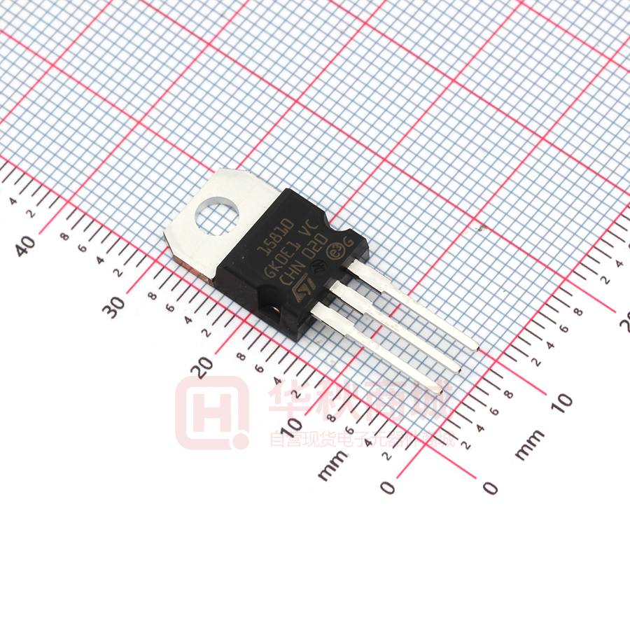

STP15810 N-channel 100 V, 0.0036 Ω typ., 110 A, STripFET™ F7 Power MOSFET in a TO-220 package Datasheet - production data Features TAB Order code VDS RDS(on)max ID PTOT STP15810 100 V 0.0042 Ω 110 A 250 W • 100% avalanche tested • Ultra low on-resistance 3 1 2 Applications TO-220 • Switching applications Description Figure 1. Internal schematic diagram ' 7$% This N-channel Power MOSFETs utilizes STripFET™ F7 technology with an enhanced trench gate structure that results in very low onstate resistance, while also reducing internal capacitance and gate charge for faster and more efficient switching. *  6  $0Y Table 1. Device summary Order code Marking Package Packaging STP15810 15810 TO-220 Tube August 2014 This is information on a product in full production. DocID024972 Rev 4 1/13 www.st.com Contents STP15810 Contents 1 Electrical ratings . . . . . . . . . . . . . . . . . . . . . . . . . . . . . . . . . . . . . . . . . . . . 3 2 Electrical characteristics . . . . . . . . . . . . . . . . . . . . . . . . . . . . . . . . . . . . . 4 2.1 Electrical characteristics (curves) ............................ 6 3 Test circuits 4 Package mechanical data . . . . . . . . . . . . . . . . . . . . . . . . . . . . . . . . . . . . . 9 5 Revision history . . . . . . . . . . . . . . . . . . . . . . . . . . . . . . . . . . . . . . . . . . . 12 2/13 .............................................. 8 DocID024972 Rev 4 STP15810 1 Electrical ratings Electrical ratings Table 2. Absolute maximum ratings Symbol Parameter Value Unit VDS Drain-source voltage 100 V VGS Gate- source voltage ±20 V ID Drain current (continuous) at TC = 25 °C 110 A ID Drain current (continuous) at TC = 100 °C 110 A Drain current (pulsed) TC = 25 °C 440 A Total dissipation at TC = 25 °C 250 W EAS Single pulse avalanche energy 495 mJ TJ Operating junction temperature Tstg Storage temperature IDM (1) PTOT (2) °C -55 to 175 °C 1. Pulse width is limited by safe operating area 2. Starting Tj=25 °C, ID=30 A, VDD=50 V Table 3. Thermal data Symbol Parameter Value Unit Rthj-case Thermal resistance junction-case max 0.6 °C/W Rthj-amb Thermal resistance junction-ambient max 62.5 °C/W DocID024972 Rev 4 3/13 13 Electrical characteristics 2 STP15810 Electrical characteristics (TC = 25 °C unless otherwise specified) Table 4. On /off states Symbol V(BR)DSS Parameter Drain-source breakdown voltage IDSS Zero gate voltage drain current IGSS Gate-body leakage current Test conditions VGS = 0, ID = 250 µA Min. Typ. Max. 100 Unit V VGS = 0, VDS = 100 V 1 µA VGS = 0, VDS = 100 V, TC=125 °C 100 µA VDS = 0, VGS = +20 V 100 nA 4.5 V VGS(th) Gate threshold voltage VDS = VGS, ID = 250 µA RDS(on) Static drain-source onVGS = 10 V, ID = 55 A resistance 2.5 0.0036 0.0042 Ω Table 5. Dynamic Symbol Parameter Ciss Input capacitance Coss Output capacitance Crss Reverse transfer capacitance Qg Total gate charge Qgs Gate-source charge Qgd Gate-drain charge Test conditions VDS = 55 V, f = 1 MHz, VGS = 0 VDD = 55 V, ID = 90 A, VGS = 10 V (see Figure 14) Min. Typ. Max. Unit - 8115 - pF - 1510 - pF - 67 - pF - 117 - nC - 47 - nC - 26 - nC Min. Typ. Max. Unit - 33 - ns - 57 - ns - 72 - ns - 33 - ns Table 6. Switching times Symbol td(on) tr td(off) tf 4/13 Parameter Test conditions Turn-on delay time Rise time Turn-off delay time VDD = 50 V, ID = 55 A, RG = 4.7 Ω, VGS = 10 V (see Figure 13) Fall time DocID024972 Rev 4 STP15810 Electrical characteristics Table 7. Source drain diode Symbol Parameter Test conditions Min. Typ. Max. Unit Source-drain current - 110 A ISDM (1) Source-drain current (pulsed) - 440 A VSD (2) Forward on voltage - 1.2 V ISD ISD = 110 A, VGS = 0 trr Reverse recovery time Qrr Reverse recovery charge IRRM Reverse recovery current ISD = 110 A, di/dt = 100 A/µs VDD = 80 V, TJ=150 °C (see Figure 15) - 70 ns - 165 nC - 4.7 A 1. Pulse width limited by safe operating area 2. Pulsed: pulse duration = 300 µs, duty cycle 1.5%. DocID024972 Rev 4 5/13 13 Electrical characteristics 2.1 STP15810 Electrical characteristics (curves) Figure 2. Safe operating area Figure 3. Thermal impedance AM18051v1 ID (A) AM18052v1 K δ=0.5 0.2 100 th in n tio by m ra pe ited O m Li 10 is ea a r (on) S RD ax 0.1 0.05 is 100µs 10 -1 0.02 c 0.01 1ms 1 Tj=175°C Tc=25°C Single pulse 0.1 0.1 1 VDS(V) 10 Figure 4. Output characteristics VGS=10V 400 10 -2 10 -5 10 -4 10 -3 10 -2 10 -1 10 0 tp(s) Figure 5. Transfer characteristics AM18042v1 ID (A) Single pulse 10ms 8V AM18043v1 ID (A) VDS=4V 300 350 7V 300 250 200 250 200 150 6V 150 100 100 50 50 5V 0 0 4 2 6 8 Figure 6. Gate charge vs gate-source voltage AM18044v1 VGS (V) VDD=50V ID=110A 12 0 0 VDS(V) 2 4 8 6 VGS(V) Figure 7. Static drain-source on-resistance AM18054v1 RDS(on) (mΩ) VGS=10V 3.62 10 3.61 8 3.60 6 3.59 3.58 4 3.57 2 3.56 3.55 0 0 6/13 40 80 120 Qg(nC) DocID024972 Rev 4 0 20 40 60 80 100 ID(A) STP15810 Electrical characteristics Figure 8. Capacitance variations Figure 9. Normalized gate threshold voltage vs temperature AM18046v1 C (pF) AM18047v1 VGS(th) (norm) ID=250µA 1.1 Ciss 8000 1 7000 6000 0.9 5000 0.8 4000 0.7 3000 0.6 2000 0.5 1000 Coss Crss 100 VDS(V) 0 0 20 60 40 80 Figure 10. Normalized on-resistance vs temperature AM18048v1 RDS(on) 0.4 -75 -25 25 75 125 TJ(°C) Figure 11. Normalized VDS vs temperature AM18049v1 VDS (norm) (norm) ID=55A 2 1.04 1.8 1.03 1.6 1.02 1.4 1.01 1.2 1 1 0.99 0.8 0.98 0.6 0.97 0.4 -75 -25 25 75 125 TJ(°C) 0.96 -75 ID=1mA -25 25 75 125 TJ(°C) Figure 12. Source-drain diode forward characteristics AM18055v1 VSD (V) TJ=-55°C 1 0.9 TJ=25°C 0.8 0.7 TJ=175°C 0.6 0.5 0.4 0.3 0 20 40 60 80 100 ISD(A) DocID024972 Rev 4 7/13 13 Test circuits 3 STP15810 Test circuits Figure 13. Switching times test circuit for resistive load Figure 14. Gate charge test circuit VDD 12V 47kΩ 1kΩ 100nF 3.3 μF 2200 RL μF IG=CONST VDD VGS 100Ω Vi=20V=VGMAX VD RG 2200 μF D.U.T. D.U.T. VG 2.7kΩ PW 47kΩ 1kΩ PW AM01468v1 Figure 15. Test circuit for inductive load switching and diode recovery times A A AM01469v1 Figure 16. Unclamped inductive load test circuit L A D G D.U.T. FAST DIODE B B VD L=100μH S 3.3 μF B 25 Ω 1000 μF D VDD 2200 μF 3.3 μF VDD ID G RG S Vi D.U.T. Pw AM01470v1 AM01471v1 Figure 17. Unclamped inductive waveform Figure 18. Switching time waveform ton V(BR)DSS tdon VD toff tr tdoff tf 90% 90% IDM 10% ID VDD 10% 0 VDD VDS 90% VGS AM01472v1 8/13 0 DocID024972 Rev 4 10% AM01473v1 STP15810 4 Package mechanical data Package mechanical data In order to meet environmental requirements, ST offers these devices in different grades of ECOPACK® packages, depending on their level of environmental compliance. ECOPACK® specifications, grade definitions and product status are available at: www.st.com. ECOPACK® is an ST trademark. DocID024972 Rev 4 9/13 13 Package mechanical data STP15810 Figure 19. TO-220 type A drawing BW\SH$B5HYB7 10/13 DocID024972 Rev 4 STP15810 Package mechanical data Table 8. TO-220 type A mechanical data mm Dim. Min. Typ. Max. A 4.40 4.60 b 0.61 0.88 b1 1.14 1.70 c 0.48 0.70 D 15.25 15.75 D1 1.27 E 10 10.40 e 2.40 2.70 e1 4.95 5.15 F 1.23 1.32 H1 6.20 6.60 J1 2.40 2.72 L 13 14 L1 3.50 3.93 L20 16.40 L30 28.90 ∅P 3.75 3.85 Q 2.65 2.95 DocID024972 Rev 4 11/13 13 Revision history 5 STP15810 Revision history Table 9. Document revision history Date Revision 10-Jul-2013 1 First release. 2 – The part number STH15810-2 has been moved to a separate datasheet – Modified: Figure 1 – Modified: ID and IDM values in Table 2 – Modified: Rthj-case value in Table 3 – Modified: RDS(on) values in Table 4 – Modified: VSD, ID and the entire typical values in Table 5, 6 and 7 – Updated: Figure 13, 14, 15 and 16 – Updated: Section 4: Package mechanical data – Added: Section 2.1: Electrical characteristics (curves) – Minor text changes 29-Jan-2013 3 – Document status promoted from preliminary data to production data – Modified: title – Modified: RDS(on) typical value in Table 4 – Minor text changes 20-Aug-2014 4 Updated title in cover page. Added EAS parameter in Table 2: Absolute maximum ratings. 21-Jan-2013 12/13 Changes DocID024972 Rev 4 STP15810 IMPORTANT NOTICE – PLEASE READ CAREFULLY STMicroelectronics NV and its subsidiaries (“ST”) reserve the right to make changes, corrections, enhancements, modifications, and improvements to ST products and/or to this document at any time without notice. Purchasers should obtain the latest relevant information on ST products before placing orders. ST products are sold pursuant to ST’s terms and conditions of sale in place at the time of order acknowledgement. Purchasers are solely responsible for the choice, selection, and use of ST products and ST assumes no liability for application assistance or the design of Purchasers’ products. No license, express or implied, to any intellectual property right is granted by ST herein. Resale of ST products with provisions different from the information set forth herein shall void any warranty granted by ST for such product. ST and the ST logo are trademarks of ST. All other product or service names are the property of their respective owners. Information in this document supersedes and replaces information previously supplied in any prior versions of this document. © 2014 STMicroelectronics – All rights reserved DocID024972 Rev 4 13/13 13
