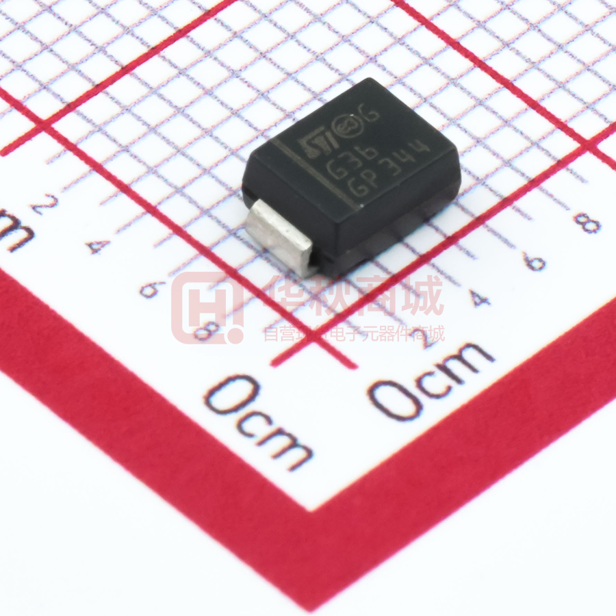

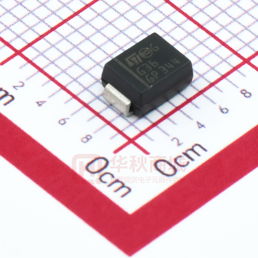

    SMB(DO-214AA)
    60 V、3 A低压降轴向和SMB(flat) 低压降功率肖特基整流器
STPS3L60U 数据手册
® STPS3L60/Q/U POWER SCHOTTKY RECTIFIER MAIN PRODUCT CHARACTERISTICS IF(AV) VRRM Tj (max) VF (max) 3A 60 V 150°C 0.61 V DO-201AD STPS3L60 DO-15 STPS3L60Q FEATURES AND BENEFITS NEGLIGIBLE SWITCHING LOSSES LOW THERMAL RESISTANCE AVALANCHE CAPABILITY SPECIFIED s s s DESCRIPTION Axial and Surface Mount Power Schottky rectifier suited for Switch Mode Power Supplies and high frequency DC to DC converters. Packaged in DO-201AD, DO-15 and SMB, this device is intended for use in low voltage, high frequency inverters and small battery chargers. For applications where there are space constraints, e.g Telecom battery charger. ABSOLUTE RATINGS (limiting values) Symbol VRRM IF(RMS) IF(AV) RMS forward current Average forward current TL = 105°C δ = 0.5 (DO-201AD, SMB) TL = 75°C δ = 0.5 (DO-15) IFSM PARM Tstg Tj dV/dt *: Surge non repetitive forward current Repetitive peak avalanche power Storage temperature range Maximum operating junction temperature * Critical rate of rise of reverse voltage tp = 10 ms Sinusoidal tp = 1µs Tj = 25°C Parameter Repetitive peak reverse voltage SMB STPS3L60U Value 60 10 3 Unit V A A 100 2000 - 65 to + 150 150 10000 A W °C °C V/µs dPtot 1 thermal runaway condition for a diode on its own heatsink < dTj Rth( j − a ) 1/6 July 2003 - Ed: 5A STPS3L60/Q/U THERMAL RESISTANCES Symbol Rth(j-l) Junction to leads Parameter Lead length = 10 mm DO-201AD SMB DO-15 STATIC ELECTRICAL CHARACTERISTICS Symbol IR * Parameter Reverse leakage current Tests conditions Tj = 25°C Tj = 100°C Tj = 125°C VF * Forward voltage drop Tj = 25°C Tj = 100°C Tj = 125°C Tj = 25°C Tj = 100°C Tj = 125°C Pulse test : * tp = 380 µs, δ < 2% Value 20 20 35 Unit °C/W Min. Typ. 4 14 VR = VRRM Max. 150 15 30 0.62 Unit µA mA V IF = 3 A 0.53 0.51 IF = 6 A 0.62 0.6 0.61 0.59 0.79 0.71 0.69 To evaluate the maximum conduction losses use the following equation: P = 0.44 x IF(AV) + 0.05 x IF2(RMS) Fig. 1: Average forward power dissipation versus average forward current. PF(AV)(W) 2.5 Fig. 2-1: Average forward current versus ambient temperature (δ = 0.5) (DO-201AD, SMB). IF(AV)(A) δ = 0.05 2.0 δ = 0.1 3.5 δ = 0.2 δ = 0.5 Rth(j-a)=Rth(j-I) 3.0 1.5 δ=1 2.5 2.0 1.0 1.5 T Rth(j-a)=80°C/W 1.0 0.5 tp 0.5 T 0.0 0.0 0.5 1.0 1.5 IF(AV)(A) 2.0 2.5 δ=tp/T 3.0 3.5 4.0 0.0 0 δ=tp/T 25 tp 50 Tamb(°C) 75 100 125 150 2/6 STPS3L60/Q/U Fig. 2-2: Average forward current versus ambient temperature (δ = 0.5) (DO-15). IF(AV)(A) 3.5 Rth(j-a)=Rth(j-I) Fig. 3: Normalized avalanche power derating versus pulse duration. PARM(tp) PARM(1µs) 1 3.0 2.5 0.1 2.0 1.5 1.0 Rth(j-a)=100°C/W 0.01 T 0.5 0.0 0 δ=tp/T 25 tp 50 Tamb(°C) 75 100 125 150 0.001 0.01 0.1 1 tp(µs) 10 100 1000 Fig. 4: Normalized avalanche power derating versus junction temperature. PARM(tp) PARM(25°C) Fig. 5-1: Non repetitive surge peak forward current versus overload duration (maximum values) (DO-201AD, SMB). IM(A) 12 10 1.2 1 0.8 0.6 0.4 0.2 8 6 4 Ta=25°C Ta=50°C Ta=100°C 2 IM t Tj(°C) 0 0 25 50 75 100 125 150 0 1E-3 δ=0.5 t(s) 1E-2 1E-1 1E+0 Fig. 5-2: Non repetitive surge peak forward current versus overload duration (maximum values) (DO-15). IM(A) 11 10 9 8 7 6 Ta=25°C Fig. 6-1: Relative variation of thermal impedance junction to ambient versus pulse duration (DO-201AD, SMB). Zth(j-a)/Rth(j-a) 1.0 0.9 0.8 0.7 0.6 0.5 δ = 0.5 5 Ta=50°C 0.4 0.3 δ = 0.2 δ = 0.1 Single pulse 4 3 2 1 0 1.E-03 1.E-02 1.E-01 IM t T Ta=100°C 0.2 0.1 δ=0.5 t(s) tp(s) 1E+1 0.0 1E-1 δ=tp/T 1E+2 tp 1E+3 1E+0 3/6 STPS3L60/Q/U Fig. 6-2: Relative variation of thermal impedance junction to ambient versus pulse duration (DO-15). Zth(j-a)/Rth(j-a) 1.0 0.9 0.8 0.7 0.6 0.5 0.4 0.3 0.2 0.1 Single pulse δ = 0.2 Fig. 7: Reverse leakage current versus reverse voltage applied (typical values). IR(mA) 5E+1 1E+1 Tj=125°C Tj=100°C 1E+0 δ = 0.5 1E-1 T δ = 0.1 1E-2 Tj=25°C tp(s) 1.E+01 0.0 1.E-01 1.E+00 δ=tp/T 1.E+02 tp 1.E+03 1E-3 0 5 10 15 20 25 VR(V) 30 35 40 45 50 55 60 Fig. 8: Junction capacitance versus reverse voltage applied (typical values). C(pF) 500 F=1MHz Tj=25°C Fig. 9-1: Forward voltage drop versus forward current (high level, maximum values). IFM(A) 30 Tj=100°C (maximum values) 200 10 Tj=100°C (typical values) Tj=25°C 100 50 20 VR(V) 10 1 10 100 1 0.0 0.5 1.0 VFM(V) 1.5 2.0 2.5 Fig. 9-2: Forward voltage drop versus forward current (low level, maximum values). IFM(A) 5 Fig. 10: Thermal resistance junction to ambient versus copper surface under each lead (Epoxy printed circuit board FR4, Cu: 35µm) (SMB). Rth(j-)(°C/W) 120 4 Tj=100°C (maximum values) Tj=25°C 100 80 60 40 3 Tj=100°C (typical values) 2 1 20 VFM(V) 0 0.0 0.1 0.2 0.3 0.4 0.5 0.6 0.7 0.8 0.9 1.0 S(Cu)(cm²) 0 0.0 0.5 1.0 1.5 2.0 2.5 3.0 3.5 4.0 4.5 5.0 4/6 STPS3L60/Q/U PACKAGE MECHANICAL DATA DO-15 plastic C A C D B DIMENSIONS REF. Min. A B C D 6.05 2.95 26 0.71 Millimeters Max. 6.75 3.53 31 0.88 Inches Min. 0.238 0.116 1.024 0.028 Max. 0.266 0.139 1.220 0.035 PACKAGE MECHANICAL DATA DO-201AD plastic B A B ØC note 1 E E note 1 ØD ØD note 2 DIMENSIONS REF. A B ∅C ∅D E 25.40 5.30 1.30 1.25 Millimeters Min. Max. 9.50 Inches Min. 1.000 0.209 0.051 0.049 NOTES 1 - The lead diameter ∅ D is not controlled over zone E 2 - The minimum axial length within which the device may be placed with its leads bent at right angles is 0.59"(15 mm) Max. 0.374 5/6 STPS3L60/Q/U PACKAGE MECHANICAL DATA SMB (JEDEC DO-214AA) DIMENSIONS E1 REF. Millimeters Min. Max. 2.45 0.20 2.20 0.41 5.60 4.60 3.95 1.60 Inches Min. 0.075 0.002 0.077 0.006 0.201 0.159 0.130 0.030 Max. 0.096 0.008 0.087 0.016 0.220 0.181 0.156 0.063 D A1 A2 b 1.90 0.05 1.95 0.15 5.10 4.05 3.30 0.75 E c A1 E E1 C L A2 D b L FOOT PRINT DIMENSIONS (in millimeters) 2.3 1.52 2.75 1.52 s s Ordering type Marking STPS3L60 STPS3L60 STPS3L60RL STPS3L60 STPS3L60Q STPS3L60 STPS3L60QRL STPS3L60 STPS3L60U G36 White band indicates cathode Epoxy meets UL94,V0 Package DO-201AD DO-201AD DO-15 DO-15 SMB Weight 1.12g 1.12g 0.4 g 0.4 g 0.107 g Base qty 600 1900 1000 6000 2500 Delivery mode Ammopack Tape & Reel Ammopack Tape & Reel Tape & Reel Information furnished is believed to be accurate and reliable. However, STMicroelectronics assumes no responsibility for the consequences of use of such information nor for any infringement of patents or other rights of third parties which may result from its use. No license is granted by implication or otherwise under any patent or patent rights of STMicroelectronics. Specifications mentioned in this publication are subject to change without notice. This publication supersedes and replaces all information previously supplied. STMicroelectronics products are not authorized for use as critical components in life support devices or systems without express written approval of STMicroelectronics. The ST logo is a registered trademark of STMicroelectronics © 2003 STMicroelectronics - Printed in Italy - All rights reserved. STMicroelectronics GROUP OF COMPANIES Australia - Brazil - Canada - China - Finland - France - Germany Hong Kong - India - Israel - Italy - Japan - Malaysia - Malta - Morocco - Singapore Spain - Sweden - Switzerland - United Kingdom - United States. http://www.st.com 6/6
