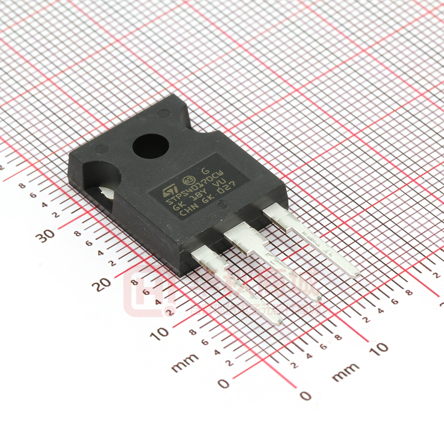

This dual center tab Schottky rectifier is suited for high frequency switched mode
power supplies.
Product status link
Packaged in TO-247, D²PAK and TO-247, the STPS40170C is optimized for use to
enhance the reliability in applications.
