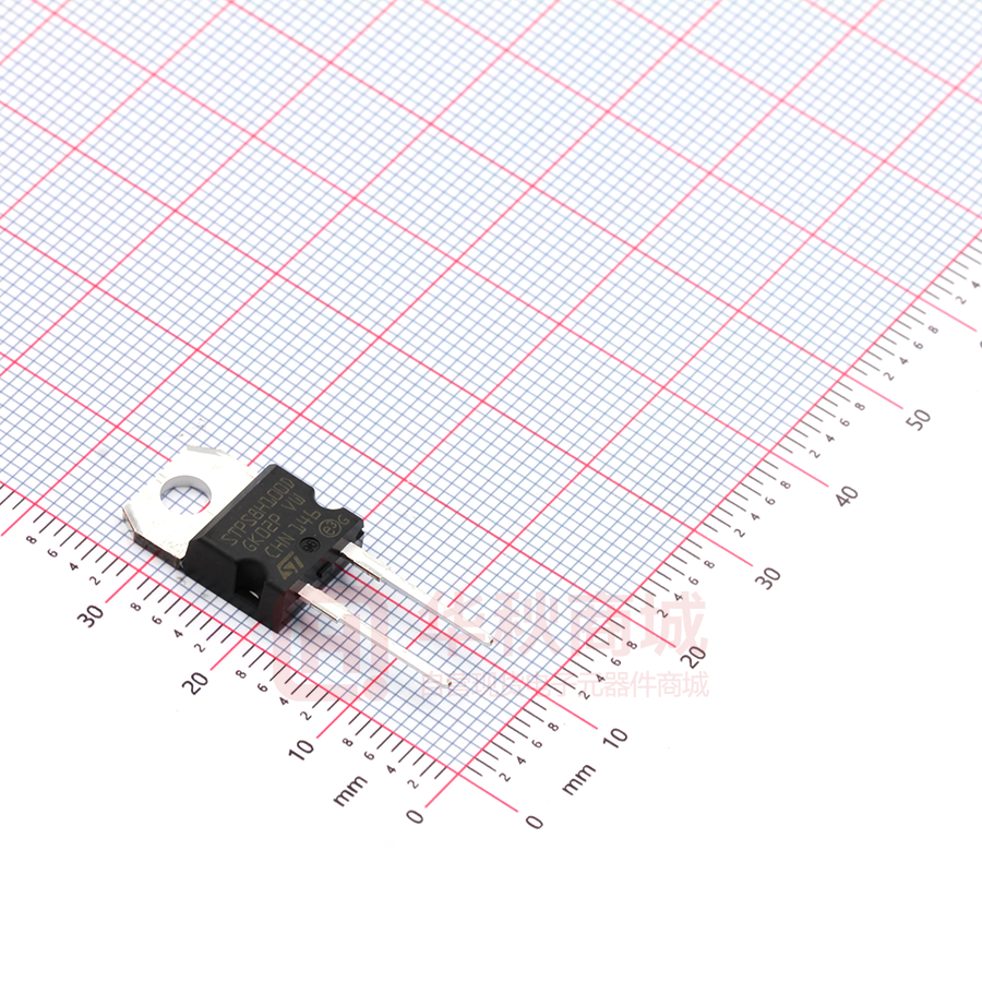

    肖特基二极管 Single VRRM=100V IF=8A IR=4.5μA TO220AC
STPS8H100D 数据手册
® STPS8H100D/F/G/R/FP HIGH VOLTAGE POWER SCHOTTKY RECTIFIER MAIN PRODUCT CHARACTERISTICS IF(AV) VRRM Tj (max) VF (max) FEATURES AND BENEFITS s 8A 100 V 175 °C 0.58 V A K TO-220AC STPS8H100D K K A s s s s Negligible switching losses High junction temperature capability Low leakage current Good trade off between leakage current and forward voltage drop Insulated package: ISOWATT220AC, TO-220FPAC Insulating voltage = 2000V DC Capacitance = 12pF ISOWATT220AC STPS8H100F A NC D2PAK STPS8 DESCRIPTION Schottky barrier rectifier designed for high frequency compact Switched Mode Power Supplies such as adaptators and on board DC/DC converters. A NC K K A I2PAK STPS8H100R TO-220FPAC STPS8H100FP ABSOLUTE RATINGS (limiting values) Symbol VRRM IF(RMS) IF(AV) RMS forward current Average forward current δ = 0.5 TO-220AC / I2PAK / D2PAK ISOWATT220AC TO-220FPAC IFSM IRRM IRSM Tstg Tj dV/dt Surge non repetitive forward current Repetitive peak reverse current Non repetitive peak reverse current Storage temperature range Maximum operating junction temperature Critical rate of rise of rise voltage Tc= 165°C Tc = 150°C 250 1 3 - 65 to + 175 175 10000 A A A °C °C V/µs 1/8 Parameter Repetitive peak reverse voltage Value 100 30 8 Unit V A A tp = 10 ms sinusoidal tp = 2 µs F = 1kHz square tp = 100 µs square January 2002 - Ed: 5D STPS8H100D/F/G/R/FP THERMAL RESISTANCES Symbol Rth (j-c) Rth (j-c) Junction to case Junction to case Parameter TO-220AC / I PAK / D PAK ISOWATT220AC / TO-220FPAC 2 2 Value 1.6 4 Unit °C/W °C/W STATIC ELECTRICAL CHARACTERISTICS Symbol IR * VF ** Parameter Reverse leakage current Forward voltage drop Tests Conditions Tj = 25°C Tj = 125°C Tj = 25°C Tj = 25°C Tj = 25°C Tj = 125°C Tj = 125°C Tj = 125°C Pulse test : * tp = 5 ms, δ < 2% ** tp = 380 µs, δ < 2% Min. Typ. 2 Max. 4.5 6 0.71 0.77 0.81 Unit µA mA V VR = VRRM IF = 8 A IF = 10 A IF = 16 A IF = 8 A IF = 10 A IF = 16 A 0.56 0.59 0.65 0.58 0.64 0.68 To evaluate the maximum conduction losses use the following equation : P = 0.48 x IF(AV) + 0.0125 x IF2(RMS) Fig. 1: Average forward power dissipation versus average forward current. (TO-220AC / ISOWATT220AC / I2PAK / D2PAK) PF(av)(W) 6.0 5.5 5.0 4.5 4.0 3.5 3.0 2.5 2.0 1.5 1.0 0.5 0.0 δ = 0.1 δ = 0.05 δ = 0.2 δ = 0.5 Fig. 2-1: Average forward current versus ambient temperature (δ=0.5) (TO-220AC / I2PAK / D2PAK). IF(av)(A) 10 Rth(j-a)=Rth(j-c) 8 δ=1 6 4 T T Rth(j-a)=15°C/W 2 IF(av) (A) 0 1 2 3 4 5 6 7 δ=tp/T tp δ=tp/T tp Tamb(°C) 60 80 100 120 140 160 180 8 9 10 0 0 20 40 2/8 STPS8H100D/F/G/R/FP Fig. 2-2: Average forward current versus ambient temperature (δ=0.5) (ISOWATT220AC, TO-220FPAC). IF(av)(A) Fig. 3-1: Non repetitive surge peak forward current versus overload duration (maximum values) (TO-220AC / I2PAK / D2PAK). IM(A) 160 10 Rth(j-a)=Rth(j-c) 8 6 Rth(j-a)=50°C/W 140 120 100 80 60 40 Tc=100°C IM t Tc=75°C 4 T 2 δ=tp/T tp Tc=125°C δ=0.5 Tamb(°C) 20 t(s) 1E-2 1E-1 1E+0 0 0 20 40 60 80 100 120 140 160 180 0 1E-3 Fig. 3-2: Non repetitive surge peak forward current versus overload duration (maximum values) (ISOWATT220AC, TO-220FPAC). IM(A) Fig. 4-1: Relative variation of thermal impedance junction to case versus pulse duration (TO-220AC / I2PAK / D2PAK). Zth(j-c)/Rth(j-c) 1.0 0.8 100 90 80 70 60 50 40 30 20 IM 10 0 1E-3 Tc=75°C 0.6 0.4 δ = 0.5 Tc=100°C Tc=125°C t δ = 0.2 T Single pulse 0.2 δ = 0.1 δ=0.5 t(s) tp(s) 1E-1 1E+0 1E-2 0.0 1E-4 δ=tp/T tp 1E-3 1E-2 1E-1 1E+0 Fig. 4-2: Relative variation of thermal impedance junction to case versus pulse duration (ISOWATT220AC, TO-220FPAC). Zth(j-c)/Rth(j-c) Fig. 5: Reverse leakage current versus reverse voltage applied (typical values). IR(µA) 5E+3 1E+3 Tj=125°C 1.0 0.8 1E+2 0.6 0.4 δ = 0.2 δ = 0.5 1E+1 T Single pulse 1E+0 Tj=25°C 0.2 δ = 0.1 1E-1 tp(s) δ=tp/T tp 0.0 1E-3 1E-2 1E-1 1E+0 1E+1 1E-2 VR(V) 0 10 20 30 40 50 60 70 80 90 100 3/8 STPS8H100D/F/G/R/FP Fig. 6: Junction capacitance versus reverse voltage applied (typical values). C(nF) 1000 F=1MHz Tj=25°C Fig. 7: Forward voltage drop versus forward current (maximum values). IFM(A) 50.0 10.0 Tj=125°C 500 Tj=25°C 200 VR(V) 100 1 10 100 1.0 VFM(V) 0.1 0 0.2 0.4 0.6 0.8 1 1.2 1.4 1.6 Fig. 8: Thermal resistance junction to ambient versus copper surface under tab (Epoxy printed circuit board FR4, copper thickness: 35µm)(D2PAK). Rth(j-a) (°C/W) 80 70 60 50 40 30 20 10 0 0 4 8 12 S(Cu) (cm²) 16 20 24 28 32 36 40 4/8 STPS8H100D/F/G/R/FP PACKAGE MECHANICAL DATA TO-220AC DIMENSIONS REF. H2 C L5 ØI L6 L2 D L7 A Millimeters Min. Max. 4.40 4.60 1.23 1.32 2.40 2.72 0.49 0.70 0.61 0.88 1.14 1.70 4.95 5.15 10.00 10.40 16.40 typ. 13.00 14.00 2.65 2.95 15.25 15.75 6.20 6.60 3.50 3.93 2.6 typ. 3.75 3.85 Inches Min. Max. 0.173 0.181 0.048 0.051 0.094 0.107 0.019 0.027 0.024 0.034 0.044 0.066 0.194 0.202 0.393 0.409 0.645 typ. 0.511 0.551 0.104 0.116 0.600 0.620 0.244 0.259 0.137 0.154 0.102 typ. 0.147 0.151 L9 F1 L4 F G M E A C D E F F1 G H2 L2 L4 L5 L6 L7 L9 M Diam. I PACKAGE MECHANICAL DATA ISOWATT220AC A H B DIMENSIONS REF. A B D E F F1 G H L2 L3 L6 L7 Diam Millimeters Min. 4.40 2.50 2.40 0.40 0.75 1.15 4.95 10.00 16.00 28.60 15.90 9.00 3.00 30.60 16.40 9.30 3.20 1.125 0.626 0.354 0.118 Typ. Max. 4.60 2.70 2.75 0.70 1.00 1.70 5.20 10.40 Min. 0.173 0.098 0.094 0.016 0.030 0.045 0.195 0.394 0.630 1.205 0.646 0.366 0.126 Inches Typ. Max. 0.181 0.106 0.108 0.028 0.039 0.067 0.205 0.409 L6 L2 L3 L7 F1 F G Diam D E 5/8 STPS8H100D/F/G/R/FP PACKAGE MECHANICAL DATA TO-220FPAC REF. A H B DIMENSIONS Millimeters Inches Min. Max. 0.173 0.181 0.098 0.106 0.098 0.108 0.018 0.027 0.030 0.039 0.045 0.067 0.195 0.205 0.094 0.106 0.393 0.409 0.63 Typ. 1.126 1.205 0.386 0.417 0.114 0.142 0.626 0.646 0.354 0.366 0.118 0.126 Min. Max. 4.4 4.6 2.5 2.7 2.5 2.75 0.45 0.70 0.75 1 1.15 1.70 4.95 5.20 2.4 2.7 10 10.4 16 Typ. 28.6 30.6 9.8 10.6 2.9 3.6 15.9 16.4 9.00 9.30 3.00 3.20 Dia L6 L2 L3 L5 D F1 L4 L7 F G1 G E A B D E F F1 G G1 H L2 L3 L4 L5 L6 L7 Dia. 6/8 STPS8H100D/F/G/R/FP PACKAGE MECHANICAL DATA D2PAK DIMENSIONS A E L2 C2 REF. A A1 A2 B B2 C C2 D E G L L2 L3 R V2 Millimeters Min. 4.30 2.49 0.03 0.70 1.40 0.45 1.21 8.95 10.00 4.88 15.00 1.27 1.40 0.40 0° 8° 0° 0.60 1.36 9.35 10.28 5.28 15.85 1.40 1.75 0.017 0.047 0.352 0.393 0.192 0.590 0.050 0.055 Typ. Max. Min. 4.60 2.69 0.23 0.93 0.169 0.098 0.001 0.027 Inches Typ. Max. 0.181 0.106 0.009 0.037 0.055 0.024 0.054 0.368 0.405 0.208 0.624 0.055 0.069 0.016 8° D L L3 A1 B2 B G A2 2.0 MIN. FLAT ZONE V2 C R FOOTPRINT (in millimeters)D2PAK 16.90 10.30 1.30 5.08 3.70 8.90 7/8 STPS8H100D/F/G/R/FP PACKAGE MECHANICAL DATA I2PAK DIMENSIONS REF. A A1 b b1 b2 C C2 D e E L L1 L2 Millimeters Min. 4.30 2.49 0.70 1.20 1.25 0.45 1.21 8.95 2.44 10.00 13.10 3.48 1.27 1.40 Typ. Max. Min. 4.60 0.169 2.69 0.098 0.93 0.028 1.38 0.047 0.049 0.055 0.60 0.018 1.36 0.048 9.35 0.352 2.64 0.096 10.28 0.394 13.60 0.516 3.78 0.137 1.40 0.050 0.024 0.054 0.368 0.104 0.405 0.535 0.149 0.055 Inches Typ. Max. 0.181 0.106 0.037 0.054 Ordering type STPS8H100D STPS8H100F STPS8H100FP STPS8H100R STPS8H100G STPS8H100G-TR s Marking STPS8H100D STPS8H100F STPS8H100FP STPS8H100R STPS8H100G STPS8H100G Package TO-220AC ISOWATT220AC TO-220FPAC I2PAK D PAK D PAK 2 2 Weight 1.86g 2.00g 1.9 g 1.49g 1.48g 1.48g Base qty 50 50 50 50 50 500 Delivery mode Tube Tube Tube Tube Tube Tape & reel Epoxy meets UL94,V0 Information furnished is believed to be accurate and reliable. However, STMicroelectronics assumes no responsibility for the consequences of use of such information nor for any infringement of patents or other rights of third parties which may result from its use. No license is granted by implication or otherwise under any patent or patent rights of STMicroelectronics. Specifications mentioned in this publication are subject to change without notice. This publication supersedes and replaces all information previously supplied. STMicroelectronics products are not authorized for use as critical components in life support devices or systems without express written approval of STMicroelectronics. The ST logo is a registered trademark of STMicroelectronics © 2002 STMicroelectronics - Printed in Italy - All rights reserved. STMicroelectronics GROUP OF COMPANIES Australia - Brazil - Canada - China - Finland - France - Germany Hong Kong - India - Israel - Italy - Japan - Malaysia - Malta - Morocco - Singapore Spain - Sweden - Switzerland - United Kingdom - United States. http://www.st.com 8/8
