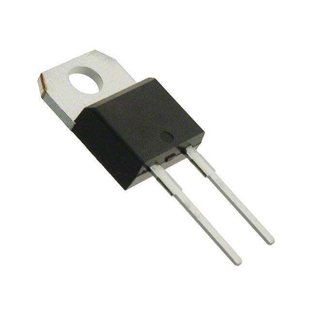

STPSC20065 650 V power Schottky silicon carbide diode Datasheet - production data A Description K K NC A TO-220AC A K TO-220AC Ins K A Especially suited for use in PFC applications, this ST SiC diode will boost performance in hard switching conditions. Its high forward surge capability ensures good robustness during transient phases. K DO-247 Features        The SiC diode is an ultra high performance power Schottky diode. It is manufactured using a silicon carbide substrate. The wide band gap material allows the design of a Schottky diode structure with a 650 V rating. Due to the Schottky construction, no recovery is shown at turn-off and ringing patterns are negligible. The minimal capacitive turn-off behavior is independent of temperature. No reverse recovery charge in application current range Switching behavior independent of temperature Dedicated to PFC applications Insulated package TO-220AC ins:  Insulated voltage: 2500 V rms  Typical package capacitance: 7 pF High forward surge capability ECOPACK®2 compliant component Maximum operating: Tj 175 °C July 2017 DocID029246 Rev 2 This is information on a product in full production. Table 1: Device summary Symbol Value IF(AV) 20 A VRRM 650 V Tj (max.) 175 °C VF (typ.) 1.30 V 1/13 www.st.com Characteristics 1 STPSC20065 Characteristics Table 2: Absolute ratings (limiting values at 25 °C, unless otherwise specified) Symbol Parameter Value Unit VRRM Repetitive peak reverse voltage 650 V IF(RMS) Forward rms current 40 A IF(AV) Average forward current 20 A IFRM Repetitive peak forward current Surge non repetitive forward current IFSM Tstg Tj TO-220AC, DO-247 TC = 140 °C, DC current TO-220AC Ins TC = 85 °C, DC current TO-220AC, DO-247 TC = 140 °C, Tj = 175 °C, δ = 0.1 87 TO-220AC Ins TC = 85 °C, Tj = 175 °C, δ = 0.1 83 tp = 10 ms sinusoidal TC = 25 °C 90 tp = 10 ms sinusoidal TC = 125 °C 70 tp = 10 µs square TC = 25 °C 400 A A Storage temperature range -55 to +175 °C Operating junction temperature range(1) -40 to +175 °C Notes: (1)(dP tot/dTj) < (1/Rth(j-a)) condition to avoid thermal runaway for a diode on its own heatsink. Table 3: Thermal parameters Symbol Rth(j-c) Parameter Junction to case Value Package Unit Typ. Max. TO-220AC DO-247 0.60 0.90 TO-220AC Ins 1.60 °C/W 2.50 Table 4: Static electrical characteristics Symbol Parameter Test conditions Tj = 25 °C IR(1) Reverse leakage current Tj = 150 °C Tj = 25 °C VR = VRRM Forward voltage drop Tj = 150 °C Tj = 175 °C Notes: 2/13 (1)Pulse test: tp = 5 ms, δ < 2% (2)Pulse test: tp = 500 µs, δ < 2% DocID029246 Rev 2 Typ. Max. - 30 300 - 280 2000 15 150 - 1.30 1.45 - 1.45 1.65 - 1.5 VR = 600 V Tj = 25 °C VF(2) Min. IF = 20 A Unit µA V STPSC20065 To evaluate the conduction losses use the following equation: Characteristics P = 1.02 x IF(AV) + 0.039 x IF2(RMS) Table 5: Dynamic electrical characteristics Symbol Parameter QCj(1) Total capacitive charge Cj Total capacitance Test conditions Min. Typ. Max. Unit VR = 400 V - 62 - nC VR = 0 V, Tc = 25 °C, F = 1 MHz - 1250 - VR = 400 V, Tc = 25 °C, F = 1 MHz - 100 - pF Notes: (1)Most 𝑉 accurate value for the capacitive charge: 𝑄𝑐𝑗 = ∫0 𝑂𝑈𝑇 𝐶𝐽 (𝑉𝑅 ) .𝑑𝑉𝑅 DocID029246 Rev 2 3/13 Characteristics 1.1 STPSC20065 Characteristics (curves) Figure 1: Forward voltage drop versus forward current (typical values) Figure 2: Reverse leakage current versus reverse voltage applied (typical values) IF(A) 40 IR(µA) 1.E+03 Pulse test : tp =500µs Tj=175 °C 35 30 1.E+02 Ta =25 °C Tj=150 °C Ta =150 °C Ta =100 °C 25 1.E+01 Ta =175 °C 20 1.E+00 15 10 Tj=25 °C 1.E-01 5 VR(V) VF(V) 1.E-02 0 0.0 0.2 0.4 0.6 0.8 1.0 1.2 1.4 1.6 1.8 2.0 2.2 0 2.4 Figure 3: Peak forward current versus case temperature (TO-220AC and DO-247) 140 T δ=0.1 100 150 200 250 300 350 400 450 500 550 600 650 Figure 4: Peak forward current versus case temperature (TO-220AC Ins) IM (A) 140 50 IM (A) T δ=0.1 120 δ=tp/T tp 100 120 δ=tp/T tp 100 δ=0.3 80 80 δ=0.3 δ=0.5 60 60 δ=0.5 40 40 δ=1 δ=0.7 20 20 δ=1 TC(°C) δ=0.7 TC(°C) 0 0 0 25 50 75 100 125 150 Figure 5: Junction capacitance versus reverse voltage applied (typical values) 1400 Cj (pF) F=1 MHz VO SC =30 mVRMS Tj=25 °C 1200 0 175 25 50 75 100 125 150 175 Figure 6: Relative variation of thermal impedance junction to case versus pulse duration (TO-220AC, DO-247) 1.0 Zth(j-c) /Rth(j-c) 0.9 0.8 1000 0.7 800 0.6 0.5 600 0.4 400 0.3 0.2 200 Single pulse 0.1 VR(V) 0 0.1 4/13 1.0 10.0 100.0 1000.0 t p(s) 0.0 1.E-05 DocID029246 Rev 2 1.E-04 1.E-03 1.E-02 1.E-01 1.E+00 STPSC20065 Characteristics Figure 8: Non-repetitive peak surge forward current versus pulse duration (sinusoidal waveform) Figure 7: Relative variation of thermal impedance junction to case versus pulse duration (TO-220AC Ins) 1.0 Zth(j-c) /Rth(j-c) 1.E+03 IFSM(A) 0.9 Ta =25 °C 0.8 0.7 0.6 Ta =125 °C 0.5 1.E+02 0.4 0.3 0.2 Single pulse 0.1 t p(s) 0.0 1.E-04 1.E-03 1.E-02 1.E-01 1.E+00 1.E+01 t p (s) 1.E+01 1.E-05 1.E-04 1.E-03 1.E-02 Figure 9: Total capacitive charges versus reverse voltage applied ( typical values) QCj (nC) 70 60 50 40 30 20 10 VR(V) 0 0 50 100 150 200 DocID029246 Rev 2 250 300 350 400 5/13 Package information 2 STPSC20065 Package information In order to meet environmental requirements, ST offers these devices in different grades of ECOPACK® packages, depending on their level of environmental compliance. ECOPACK® specifications, grade definitions and product status are available at: www.st.com. ECOPACK® is an ST trademark.       2.1 Cooling method: by conduction (C) Epoxy meets UL 94,V0 Recommended torque value: 0.55 N·m for TO-220AC and TO-220AC Ins Maximum torque value: 0.7 N·m for TO-220AC and TO-220AC Ins Recommended torque value: 0.8 N·m for DO-247 Maximum torque value: 1 N·m for DO-247 TO-220AC package information Figure 10: TO-220AC package outline 6/13 DocID029246 Rev 2 Package information STPSC20065 Table 6: TO-220AC package mechanical data Dimensions Ref. Millimeters Inches Min. Max. Min. Max. A 4.40 4.60 0.173 0.181 C 1.23 1.32 0.048 0.051 D 2.40 2.72 0.094 0.107 E 0.49 0.70 0.019 0.027 F 0.61 0.88 0.024 0.034 F1 1.14 1.70 0.044 0.066 G 4.95 5.15 0.194 0.202 H2 10.00 10.40 0.393 0.409 L2 16.40 typ. 0.645 typ. L4 13.00 14.00 0.511 0.551 L5 2.65 2.95 0.104 0.116 L6 15.25 15.75 0.600 0.620 L7 6.20 6.60 0.244 0.259 L9 3.50 3.93 0.137 0.154 M ØI 2.6 typ. 3.75 0.102 typ. 3.85 DocID029246 Rev 2 0.147 0.151 7/13 Package information 2.2 STPSC20065 TO-220AC Ins package information Figure 11: TO-220AC Ins package outline 8/13 DocID029246 Rev 2 Package information STPSC20065 Table 7: TO-220AC Ins package mechanical data Dimensions Ref. Millimeters Min. A Typ. 15.20 a1 Inches Max. Min. 15.90 0.598 3.75 Typ. Max. 0.625 0.147 a2 13.00 14.00 0.511 0.551 B 10.00 10.40 0.393 0.409 b1 0.61 0.88 0.024 0.034 b2 1.23 1.32 0.048 0.051 C 4.40 4.60 0.173 0.181 c1 0.49 0.70 0.019 0.027 c2 2.40 2.72 0.094 0.107 e 4.80 5.40 0.189 0.212 F 6.20 6.60 0.244 0.259 L 2.65 2.95 0.104 0.116 I2 1.14 1.70 0.044 0.066 I4 15.80 16.80 0.622 M ØI 16.40 2.60 3.75 0.645 0.661 0.102 3.85 DocID029246 Rev 2 0.147 0.151 9/13 Package information 2.3 STPSC20065 DO-247 package information Figure 12: DO-247 package outline 10/13 DocID029246 Rev 2 Package information STPSC20065 Table 8: DO-247 package mechanical data Dimensions Ref. Millimeters Inches Min. Max. Min. Max. A 4.85 5.15 0.191 0.203 D 2.20 2.60 0.086 0.102 E 0.40 0.80 0.015 0.031 F 1.00 1.40 0.039 0.055 F2 F3 2.00 typ. 2.00 G 0.078 typ. 2.40 0.078 10.90 typ. 0.094 0.429 typ. H 15.45 15.75 0.608 0.620 L 19.85 20.15 0.781 0.793 L1 3.70 4.30 0.145 0.169 L2 L3 18.50 typ. 14.20 0.728 typ. 14.80 0.559 0.582 L4 34.60 typ. 1.362 typ. L5 5.50 typ. 0.216 typ. M 2.00 V 0.078 5° V2 Dia. 3.00 5° 60° 3.55 0.118 60° 3.65 DocID029246 Rev 2 0.139 0.143 11/13 Ordering information 3 STPSC20065 Ordering information Table 9: Ordering information Order code 4 Marking Package Weight Base qty. Delivery mode STPSC20065D PSC20065D TO-220AC 1.86 g 50 Tube STPSC20065DI PSC20065DI TO-220AC Ins 2.12 g 50 Tube STPSC20065W PSC20065W DO-247 4.4 g 30 Tube Revision history Table 10: Document revision history 12/13 Date Revision Changes 02-May-2016 1 First issue 21-Jul-2017 2 Updated Table 6: "TO-220AC package mechanical data". DocID029246 Rev 2 STPSC20065 IMPORTANT NOTICE – PLEASE READ CAREFULLY STMicroelectronics NV and its subsidiaries (“ST”) reserve the right to make changes, corrections, enhancements, modifications, and improvements to ST products and/or to this document at any time without notice. Purchasers should obtain the latest relevant information on ST products before placing orders. ST products are sold pursuant to ST’s terms and conditions of sale in place at the time of order acknowledgement. Purchasers are solely responsible for the choice, selection, and use of ST products and ST assumes no liability for application assistance or the design of Purchasers’ products. No license, express or implied, to any intellectual property right is granted by ST herein. Resale of ST products with provisions different from the information set forth herein shall void any warranty granted by ST for such product. ST and the ST logo are trademarks of ST. All other product or service names are the property of their respective owners. Information in this document supersedes and replaces information previously supplied in any prior versions of this document. © 2017 STMicroelectronics – All rights reserved DocID029246 Rev 2 13/13
