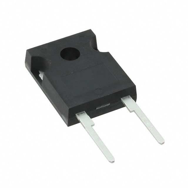

STTH6006W 数据手册
STTH6006W Turbo 2 ultrafast - high voltage rectifier Table 1. Main product characteristics IF(AV) 60 A VRRM 600 V Tj 175° C VF (typ) 1.1 V trr (max) 60 ns A K A K Features and benefits DO-247 STTH6006W ■ Ultrafast switching ■ Low reverse current ■ Low thermal resistance ■ Reduces conduction and switching losses Description The STTH6006W uses ST Turbo 2 600 V technology. This device is specially suited for use in switching power supplies, and industrial applications. The VF / Trr trade-off has been specially established to increase the performance in welding applications. Table 3. Order code Part number Marking STTH6006W STTH6006W Absolute ratings (limiting values per diode at 25° C, unless otherwise specified) Symbol Parameter Value Unit VRRM Repetitive peak reverse voltage 600 V IF(RMS) RMS forward current 90 A 60 A 400 A -65 to + 175 °C 175 °C IF(AV) Average forward current, δ = 0.5 IFSM Surge non repetitive forward current tp = 10 ms Sinusoidal Tstg Storage temperature range Tj 1. Table 2. Maximum operating junction temperature(1) dP tot 1 --------------- < -------------------------dT j R th ( j – a ) July 2007 Tc = 95° C to avoid thermal runaway for a diode on its own heatsink Rev 2 1/7 www.st.com Characteristics 1 STTH6006W Characteristics Table 4. Thermal parameters Symbol Parameter Symbol Unit 0.75 °C/W Junction to case Rth(j-c) Table 5. Value Static electrical characteristics Parameter IR(1) Reverse leakage current VF(2) Forward voltage drop Test conditions Tj = 25° C Tj = 125° C Tj = 25° C Tj = 150° C Min. Typ Max. Unit 50 VR = VRRM µA 160 1600 1.85 IF = 60 A V 1.10 1.40 1. Pulse test: tp = 5 ms, δ < 2 % 2. Pulse test: tp = 380 µs, δ < 2 % To evaluate the conduction losses use the following equation: P = 1.07 x IF(AV) + 0.006 IF2(RMS) Table 6. Symbol trr IRM tfr VFP 2/7 Dynamic characteristics Parameter Reverse recovery time Test conditions Min. Typ Max. IF = 0.5 A, Irr = 0.25 A, IR = 1 A, Tj = 25° C IF = 1 A, dIF/dt = -50 A/µs, VR = 30 V, Tj = 25° C Reverse recovery current IF = 60 A, dIF/dt = -100 A/µs, VR = 400 V, Tj = 150° C Forward recovery time IF = 60 A dIF/dt = 200 A/µs VFR = 1.1 x VFmax, Tj = 25° C Forward recovery voltage dIF/dt = 200 A/µs IF = 60 A VFR = 1.1 x VFmax, Tj = 25° C Unit 60 ns 60 85 10.5 14 500 3 ns V STTH6006W Figure 1. 110 Characteristics Conduction losses versus average current Figure 2. PF(AV)(W) 180 δ = 0.5 δ = 0.2 δ = 0.1 90 80 IFM(A) 200 100 Forward voltage drop versus forward current 160 Tj=150°C (maximum values) 140 δ = 0.05 70 120 δ=1 60 Tj=150°C (typical values) 100 50 80 40 60 30 40 10 IF(AV)(A) 0 5 10 Figure 3. 15 20 25 30 35 20 δ=tp/T 0 1.0 40 45 50 55 VFM(V) tp 0 60 65 70 0.0 0.2 Relative variation of thermal Figure 4. impedance junction to case versus pulse duration Zth(j-c)/Rth(j-c) 50 Single pulse 0.9 40 0.7 35 0.6 30 0.5 25 0.4 20 0.3 15 0.2 10 0.1 0.4 0.6 0.8 1.2 1.4 1.6 1.8 2.0 2.2 2.4 Peak reverse recovery current versus dIF/dt (typical values) VR=400V Tj=125°C IF=2 x IF(AV) IF=IF(AV) IF=0.5 x IF(AV) IF=0.25 x IF(AV) 5 tp(s) 1.0 IRM(A) 45 0.8 dIF/dt(A/µs) 0 0.0 1.E-03 1.E-02 Figure 5. 500 Tj=25°C (maximum values) T 20 1.E-01 1.E+00 Reverse recovery time versus dIF/dt (typical values) 0 Figure 6. trr(ns) 3000 VR=400V Tj=125°C 450 50 100 150 200 250 300 350 400 450 500 Reverse recovery charges versus dIF/dt (typical values) Qrr(nC) VR=400V Tj=125°C 2750 2500 400 IF=2 x IF(AV) 2250 350 2000 IF=2 x IF(AV) 300 1750 250 IF=IF(AV) 1500 IF=IF(AV) 200 1250 IF=0.5 x IF(AV) IF=0.5 x IF(AV) 1000 150 750 100 500 50 250 dIF/dt(A/µs) 0 50 100 150 200 250 300 dIF/dt(A/µs) 0 0 350 400 450 500 0 50 100 150 200 250 300 350 400 450 500 3/7 Characteristics Figure 7. 0.6 STTH6006W Softness factor versus dIF/dt (typical values) Figure 8. S factor Relative variations of dynamic parameters versus junction temperature 1.25 IF ≤ 2 x IF(AV) VR = 400 V Tj = 125° C 0.5 1.00 0.4 tRR 0.75 0.3 IRM 0.50 QRR 0.2 IF=IF(AV) VR=400V Reference: Tj=125°C 0.25 0.1 Tj(°C) dIF/dt(A/µs) 0.00 25 0.0 0 50 Figure 9. 8.0 7.5 7.0 6.5 6.0 5.5 5.0 4.5 4.0 3.5 3.0 2.5 2.0 1.5 1.0 0.5 0.0 100 150 200 250 300 350 400 450 Transient peak forward voltage versus dIF/dt (typical values) VFP(V) 75 100 125 Figure 10. Forward recovery time versus dIF/dt (typical values) 1000 IF=IF(AV) Tj=125°C tfr(ns) IF=IF(AV) VFR=1.1 x VF max. Tj=125°C 900 800 700 600 500 400 300 200 dIF/dt(A/µs) 100 dIF/dt(A/µs) 0 0 100 200 300 400 500 Figure 11. Junction capacitance versus reverse voltage applied (typical values) 1000 C(pF) F=1MHz VOSC=30mVRMS Tj=25°C 100 VR(V) 10 1 4/7 50 500 10 100 1000 0 100 200 300 400 500 STTH6006W 2 Package mechanical data Package mechanical data ● Epoxy meets UL94, V0 ● Cooling method: by conduction (C) ● Recommended torque value: 0.80 Nm ● Maximum torque value: 1.0 Nm Table 7. DO-247 dimensions Dimensions Ref. Millimeters Min. V Typ. Max. Inches Min. Typ. Max. A 4.85 5.15 0.191 0.203 D 2.20 2.60 0.086 0.102 E 0.40 0.80 0.015 0.031 F 1.00 1.40 0.039 0.055 Dia V F2 2.00 0.078 A H F3 2.00 G 2.40 0.078 10.90 0.094 0.429 L5 L L2 L4 F2 L3 L1 15.45 15.75 0.608 0.620 L 19.85 20.15 0.781 0.793 L1 3.70 4.30 0.145 0.169 L2 F3 D V2 L3 F G H M E 18.50 14.20 0.728 14.80 0.559 0.582 L4 34.60 1.362 L5 5.50 0.216 M 2.00 3.00 0.078 0.118 V 5° 5° V2 60° 60° Dia. 3.55 3.65 0.139 0.143 In order to meet environmental requirements, ST offers these devices in ECOPACK® packages. These packages have a lead-free second level interconnect. The category of second level interconnect is marked on the package and on the inner box label, in compliance with JEDEC Standard JESD97. The maximum ratings related to soldering conditions are also marked on the inner box label. ECOPACK is an ST trademark. ECOPACK specifications are available at: www.st.com. 5/7 Ordering information 3 Ordering information Table 8. 4 Ordering information Part Number Marking Package Weight Base qty Delivery mode STTH6006W STTH6006W DO-247 4.40 g 30 Tube Revision history Table 9. 6/7 STTH6006W Revision history Date Revision Changes 18-May-2006 1 First issue. 11-Jul-2007 2 Reformatted to current standards. Updated Table 7. STTH6006W Please Read Carefully: Information in this document is provided solely in connection with ST products. STMicroelectronics NV and its subsidiaries (“ST”) reserve the right to make changes, corrections, modifications or improvements, to this document, and the products and services described herein at any time, without notice. All ST products are sold pursuant to ST’s terms and conditions of sale. Purchasers are solely responsible for the choice, selection and use of the ST products and services described herein, and ST assumes no liability whatsoever relating to the choice, selection or use of the ST products and services described herein. No license, express or implied, by estoppel or otherwise, to any intellectual property rights is granted under this document. If any part of this document refers to any third party products or services it shall not be deemed a license grant by ST for the use of such third party products or services, or any intellectual property contained therein or considered as a warranty covering the use in any manner whatsoever of such third party products or services or any intellectual property contained therein. UNLESS OTHERWISE SET FORTH IN ST’S TERMS AND CONDITIONS OF SALE ST DISCLAIMS ANY EXPRESS OR IMPLIED WARRANTY WITH RESPECT TO THE USE AND/OR SALE OF ST PRODUCTS INCLUDING WITHOUT LIMITATION IMPLIED WARRANTIES OF MERCHANTABILITY, FITNESS FOR A PARTICULAR PURPOSE (AND THEIR EQUIVALENTS UNDER THE LAWS OF ANY JURISDICTION), OR INFRINGEMENT OF ANY PATENT, COPYRIGHT OR OTHER INTELLECTUAL PROPERTY RIGHT. UNLESS EXPRESSLY APPROVED IN WRITING BY AN AUTHORIZED ST REPRESENTATIVE, ST PRODUCTS ARE NOT RECOMMENDED, AUTHORIZED OR WARRANTED FOR USE IN MILITARY, AIR CRAFT, SPACE, LIFE SAVING, OR LIFE SUSTAINING APPLICATIONS, NOR IN PRODUCTS OR SYSTEMS WHERE FAILURE OR MALFUNCTION MAY RESULT IN PERSONAL INJURY, DEATH, OR SEVERE PROPERTY OR ENVIRONMENTAL DAMAGE. ST PRODUCTS WHICH ARE NOT SPECIFIED AS "AUTOMOTIVE GRADE" MAY ONLY BE USED IN AUTOMOTIVE APPLICATIONS AT USER’S OWN RISK. Resale of ST products with provisions different from the statements and/or technical features set forth in this document shall immediately void any warranty granted by ST for the ST product or service described herein and shall not create or extend in any manner whatsoever, any liability of ST. ST and the ST logo are trademarks or registered trademarks of ST in various countries. Information in this document supersedes and replaces all information previously supplied. The ST logo is a registered trademark of STMicroelectronics. All other names are the property of their respective owners. © 2007 STMicroelectronics - All rights reserved STMicroelectronics group of companies Australia - Belgium - Brazil - Canada - China - Czech Republic - Finland - France - Germany - Hong Kong - India - Israel - Italy - Japan Malaysia - Malta - Morocco - Singapore - Spain - Sweden - Switzerland - United Kingdom - United States of America www.st.com 7/7
