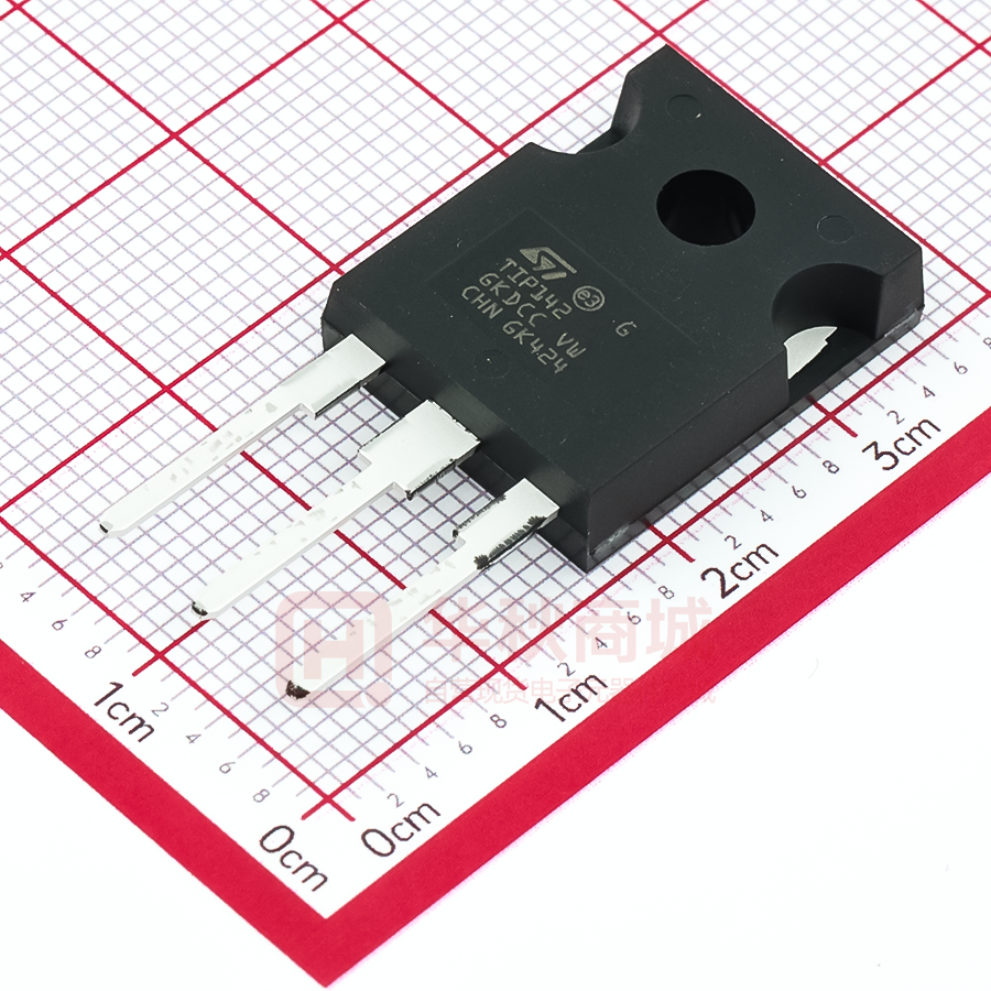

TIP142
TIP142
    STMICROELECTRONICS(意法半导体)
    TO-247-3
    互补功率达林顿晶体管
TIP142 数据手册
TIP142, TIP147 Complementary power Darlington transistors Datasheet — production data Features ■ Monolithic Darlington configuration ■ Integrated antiparallel collector-emitter diode Applications 2 ■ Linear and switching industrial equipment TO-247 Description The devices are manufactured in planar technology with “base island” layout and monolithic Darlington configuration. The resulting transistors show exceptional high gain performance coupled with very low saturation voltage. Table 1. 3 1 Figure 1. Internal schematic diagrams R1 typ. = 5 kΩ R1 typ. = 8 kΩ R2 typ. = 60 Ω R2 typ. = 100 Ω Device summary Part number Marking Polarity TIP142 TIP142 NPN TIP147 TIP147 PNP April 2012 This is information on a product in full production. Doc ID 4132 Rev 8 Package Packaging TO-247 Tube 1/10 www.st.com 10 Absolute maximum ratings 1 Absolute maximum ratings Table 2. Absolute maximum ratings Symbol Value Unit Collector-base voltage (IE = 0) 100 V VCEO Collector-emitter voltage (IB = 0) 100 V VEBO Emitter-base voltage (IC = 0) 5 V Collector current 10 A Collector peak current 20 A Base current 0.5 A PTOT Total dissipation at Tcase = 25 °C 125 W TSTG Storage temperature -65 to 150 °C 150 °C ICM IB TJ Max. operating junction temperature For PNP type voltage and current are negative. Table 3. Symbol RthJC 2/10 Parameter VCBO IC Note: TIP142, TIP147 Thermal data Parameter Thermal resistance junction-case Doc ID 4132 Rev 8 __max Value Unit 1 °C/W TIP142, TIP147 2 Electrical characteristics Electrical characteristics Tcase = 25 °C; unless otherwise specified. Table 4. Symbol Electrical characteristics Parameter Test conditions Typ. Max. Unit ICBO Collector cut-off current (IE = 0) VCB = 100 V 1 mA ICEO Collector cut-off current (IB = 0) VCE = 50 V 2 mA IEBO Emitter cut-off current (IC = 0) VEB = 5 V 2 mA Collector-emitter VCEO(sus)(1) sustaining voltage (IB = 0) IC = 30 mA 100 V VCE(sat)(1) Collector-emitter saturation voltage IC = 5 A IC = 10 A IB = 10 mA IB = 40 mA 2 3 V V VBE(on)(1) Base-emitter on voltage IC = 10 A VCE = 4 V 3 V DC current gain IC = 5 A IC = 10 A VCE = 4 V VCE = 4 V hFE(1) ton toff 1. Min. Resistive load Turn-on time Turn-off time IC = 10 A RL = 3 Ω IB1 = -IB2 = 40 mA 1000 500 0.9 4 µs µs Pulse test: pulse duration ≤300 µs, duty cycle ≤2 %. For PNP type voltage and current are negative. Doc ID 4132 Rev 8 3/10 Electrical characteristics (curve) 3 TIP142, TIP147 Electrical characteristics (curve) Figure 2. Safe operating area )! #   ) # -!8#/.4     $#/0%2!4)/.             66 #% !-V 4/10 Doc ID 4132 Rev 8 TIP142, TIP147 4 Test circuits Test circuits Figure 3. Resistive load switching test circuit (NPN type) 1. Fast electronic switch 2. Non-inductive resistor Figure 4. Resistive load switching test circuit (PNP type) 1. Fast electronic switch 2. Non-inductive resistor Doc ID 4132 Rev 8 5/10 Package mechanical data 5 TIP142, TIP147 Package mechanical data In order to meet environmental requirements, ST offers these devices in different grades of ECOPACK® packages, depending on their level of environmental compliance. ECOPACK® specifications, grade definitions and product status are available at: www.st.com. ECOPACK® is an ST trademark. 6/10 Doc ID 4132 Rev 8 TIP142, TIP147 Package mechanical data Table 5. TO-247 mechanical data mm. Dim. Min. Typ. Max. A 4.85 5.15 A1 2.20 2.60 b 1.0 1.40 b1 2.0 2.40 b2 3.0 3.40 c 0.40 0.80 D 19.85 20.15 E 15.45 15.75 e 5.30 L 14.20 14.80 L1 3.70 4.30 5.45 L2 5.60 18.50 ∅P 3.55 3.65 ∅R 4.50 5.50 S 5.30 5.50 Doc ID 4132 Rev 8 5.70 7/10 Package mechanical data Figure 5. TIP142, TIP147 TO-247 drawing 0075325_G 8/10 Doc ID 4132 Rev 8 TIP142, TIP147 6 Revision history Revision history Table 6. Document revision history Date Revision Changes 15-Oct-2007 6 Package change from SOT-93 to TO-247. 12-May-2010 7 Technology change from epitaxial base to planar base island. 19-Apr-2012 8 Added: Figure 2: Safe operating area Updated: mechanical data Doc ID 4132 Rev 8 9/10 TIP142, TIP147 Please Read Carefully: Information in this document is provided solely in connection with ST products. STMicroelectronics NV and its subsidiaries (“ST”) reserve the right to make changes, corrections, modifications or improvements, to this document, and the products and services described herein at any time, without notice. All ST products are sold pursuant to ST’s terms and conditions of sale. Purchasers are solely responsible for the choice, selection and use of the ST products and services described herein, and ST assumes no liability whatsoever relating to the choice, selection or use of the ST products and services described herein. No license, express or implied, by estoppel or otherwise, to any intellectual property rights is granted under this document. If any part of this document refers to any third party products or services it shall not be deemed a license grant by ST for the use of such third party products or services, or any intellectual property contained therein or considered as a warranty covering the use in any manner whatsoever of such third party products or services or any intellectual property contained therein. UNLESS OTHERWISE SET FORTH IN ST’S TERMS AND CONDITIONS OF SALE ST DISCLAIMS ANY EXPRESS OR IMPLIED WARRANTY WITH RESPECT TO THE USE AND/OR SALE OF ST PRODUCTS INCLUDING WITHOUT LIMITATION IMPLIED WARRANTIES OF MERCHANTABILITY, FITNESS FOR A PARTICULAR PURPOSE (AND THEIR EQUIVALENTS UNDER THE LAWS OF ANY JURISDICTION), OR INFRINGEMENT OF ANY PATENT, COPYRIGHT OR OTHER INTELLECTUAL PROPERTY RIGHT. UNLESS EXPRESSLY APPROVED IN WRITING BY TWO AUTHORIZED ST REPRESENTATIVES, ST PRODUCTS ARE NOT RECOMMENDED, AUTHORIZED OR WARRANTED FOR USE IN MILITARY, AIR CRAFT, SPACE, LIFE SAVING, OR LIFE SUSTAINING APPLICATIONS, NOR IN PRODUCTS OR SYSTEMS WHERE FAILURE OR MALFUNCTION MAY RESULT IN PERSONAL INJURY, DEATH, OR SEVERE PROPERTY OR ENVIRONMENTAL DAMAGE. ST PRODUCTS WHICH ARE NOT SPECIFIED AS "AUTOMOTIVE GRADE" MAY ONLY BE USED IN AUTOMOTIVE APPLICATIONS AT USER’S OWN RISK. Resale of ST products with provisions different from the statements and/or technical features set forth in this document shall immediately void any warranty granted by ST for the ST product or service described herein and shall not create or extend in any manner whatsoever, any liability of ST. ST and the ST logo are trademarks or registered trademarks of ST in various countries. Information in this document supersedes and replaces all information previously supplied. The ST logo is a registered trademark of STMicroelectronics. All other names are the property of their respective owners. © 2012 STMicroelectronics - All rights reserved STMicroelectronics group of companies Australia - Belgium - Brazil - Canada - China - Czech Republic - Finland - France - Germany - Hong Kong - India - Israel - Italy - Japan Malaysia - Malta - Morocco - Philippines - Singapore - Spain - Sweden - Switzerland - United Kingdom - United States of America www.st.com 10/10 Doc ID 4132 Rev 8
