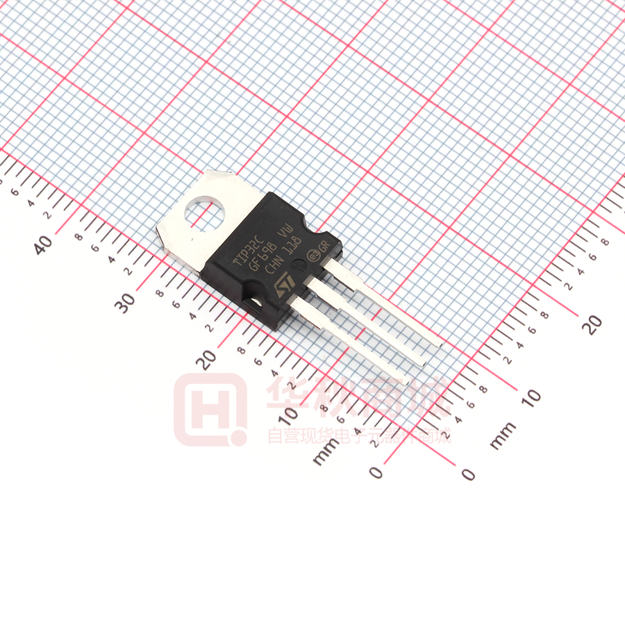

TIP32C
TIP32C
    STMICROELECTRONICS(意法半导体)
    TO-220-3
    互补硅功率晶体管
TIP32C 数据手册
TIP32C Power transistor Applications ■ . Linear and swithing industrial equipment Description The TIP32C is a silicon Epitaxial-base PNP power transistor in Jedec TO-220 plastic package. It is intented for use in medium power linear and switching applications. 1 2 3 TO-220 The complementary NPN type is TIP31C. Internal schematic diagram Order codes Part number Marking Package Packing TIP32C TIP32C TO-220 Tube November 2006 Rev 2 1/8 www.st.com 8 Absolute maximum ratings 1 Absolute maximum ratings Table 1. Absolute maximum ratings Symbol Parameter Value Unit VCBO Collector-base voltage (IE = 0) -100 V VCEO Collector-emitter voltage (IB = 0) -100 V VEBO Emitte-base voltage (IC = 0) -5 V Collector current -3 A Collector peak current (tP < 5ms) -5 A Base current -1 A PTOT Total dissipation at Tcase = 25°C Tamb = 25°C 40 2 W W Tstg Storage temperature -65 to 150 °C 150 °C IC ICM IB TJ 2/8 TIP32C Max. operating junction temperature TIP32C 2 Electrical characteristics Electrical characteristics (Tcase = 25°C; unless otherwise specified) Table 2. Electrical characteristics Symbol Parameter ICEO Collector cut-off current (IB = 0) ICES IEBO Max. Unit VCB =-60V -0.3 mA Collector cut-off current (VBE = 0) VCB =-100V -0.2 mA Emitter cut-off current (IC = 0) VEB =-5V -1 mA (1) Collector-emitter sustaining voltage (IB = 0) IC = -30mA VCE(sat)(1) Collector-emitter saturation voltage IC = -3A _ IB = 375mA -1.2 V IC = -3A_ VCE =-4V -1.8 V IC = -1A VCE =-4V IC = -3A _ VCE =-4V VCEO(sus VBE(on)(1) Base-emitter voltage hFE(1) DC current gain Test Conditions Min. Typ. -100 25 10 V 50 1. Pulsed duration = 300 ms, duty cycle ≥1.5%. 3/8 Electrical characteristics 2.1 4/8 TIP32C Typical characteristic Figure 1. Safe operating area Figure 2. Derating Curves Figure 3. DC current gain Figure 4. Collector-emitter saturation voltage Figure 5. Base-emitter saturation voltage TIP32C Package Mechanical Data 3 Package Mechanical Data In order to meet environmental requirements, ST offers these devices in ECOPACK® packages. These packages have a Lead-free second level interconnect . The category of second level interconnect is marked on the package and on the inner box label, in compliance with JEDEC Standard JESD97. The maximum ratings related to soldering conditions are also marked on the inner box label. ECOPACK is an ST trademark. ECOPACK specifications are available at: www.st.com 5/8 Package Mechanical Data TIP32C TO-220 MECHANICAL DATA DIM. mm. MIN. inch MAX. MIN. TYP. MAX. A 4.40 4.60 0.173 0.181 b 0.61 0.88 0.024 0.034 b1 1.15 1.70 0.045 0.066 c 0.49 0.70 0.019 0.027 D 15.25 15.75 0.60 0.620 E 10 10.40 0.393 0.409 e 2.40 2.70 0.094 0.106 e1 4.95 5.15 0.194 0.202 F 1.23 1.32 0.048 0.052 H1 6.20 6.60 0.244 0.256 J1 2.40 2.72 0.094 0.107 0.551 L 13 14 0.511 L1 3.50 3.93 0.137 L20 16.40 L30 6/8 TYP 0.154 0.645 28.90 1.137 øP 3.75 3.85 0.147 0.151 Q 2.65 2.95 0.104 0.116 TIP32C Revision History 4 Revision History Table 3. Revision history Date Revision Changes 10-Oct-1999 1 Initial Release 15-Nov-2006 2 The document has been reformatted 7/8 TIP32C Please Read Carefully: Information in this document is provided solely in connection with ST products. STMicroelectronics NV and its subsidiaries (“ST”) reserve the right to make changes, corrections, modifications or improvements, to this document, and the products and services described herein at any time, without notice. All ST products are sold pursuant to ST’s terms and conditions of sale. Purchasers are solely responsible for the choice, selection and use of the ST products and services described herein, and ST assumes no liability whatsoever relating to the choice, selection or use of the ST products and services described herein. No license, express or implied, by estoppel or otherwise, to any intellectual property rights is granted under this document. If any part of this document refers to any third party products or services it shall not be deemed a license grant by ST for the use of such third party products or services, or any intellectual property contained therein or considered as a warranty covering the use in any manner whatsoever of such third party products or services or any intellectual property contained therein. UNLESS OTHERWISE SET FORTH IN ST’S TERMS AND CONDITIONS OF SALE ST DISCLAIMS ANY EXPRESS OR IMPLIED WARRANTY WITH RESPECT TO THE USE AND/OR SALE OF ST PRODUCTS INCLUDING WITHOUT LIMITATION IMPLIED WARRANTIES OF MERCHANTABILITY, FITNESS FOR A PARTICULAR PURPOSE (AND THEIR EQUIVALENTS UNDER THE LAWS OF ANY JURISDICTION), OR INFRINGEMENT OF ANY PATENT, COPYRIGHT OR OTHER INTELLECTUAL PROPERTY RIGHT. UNLESS EXPRESSLY APPROVED IN WRITING BY AN AUTHORIZED ST REPRESENTATIVE, ST PRODUCTS ARE NOT RECOMMENDED, AUTHORIZED OR WARRANTED FOR USE IN MILITARY, AIR CRAFT, SPACE, LIFE SAVING, OR LIFE SUSTAINING APPLICATIONS, NOR IN PRODUCTS OR SYSTEMS WHERE FAILURE OR MALFUNCTION MAY RESULT IN PERSONAL INJURY, DEATH, OR SEVERE PROPERTY OR ENVIRONMENTAL DAMAGE. ST PRODUCTS WHICH ARE NOT SPECIFIED AS "AUTOMOTIVE GRADE" MAY ONLY BE USED IN AUTOMOTIVE APPLICATIONS AT USER’S OWN RISK. Resale of ST products with provisions different from the statements and/or technical features set forth in this document shall immediately void any warranty granted by ST for the ST product or service described herein and shall not create or extend in any manner whatsoever, any liability of ST. ST and the ST logo are trademarks or registered trademarks of ST in various countries. Information in this document supersedes and replaces all information previously supplied. The ST logo is a registered trademark of STMicroelectronics. All other names are the property of their respective owners. © 2006 STMicroelectronics - All rights reserved STMicroelectronics group of companies Australia - Belgium - Brazil - Canada - China - Czech Republic - Finland - France - Germany - Hong Kong - India - Israel - Italy - Japan Malaysia - Malta - Morocco - Singapore - Spain - Sweden - Switzerland - United Kingdom - United States of America www.st.com 8/8
