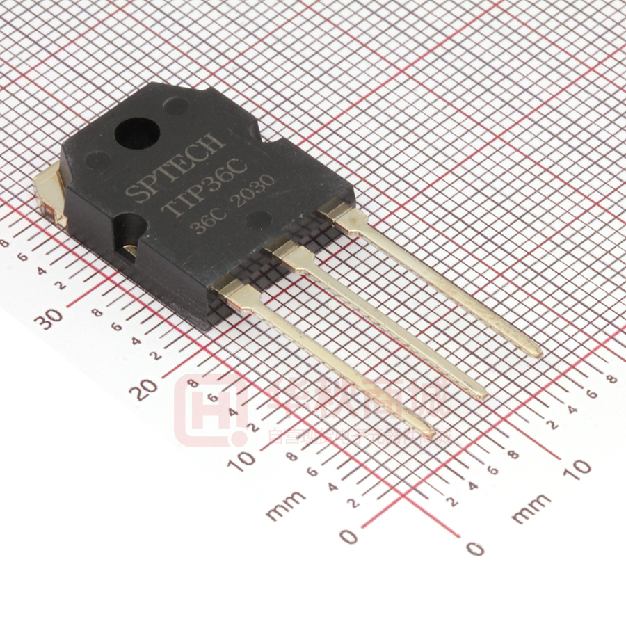

TIP36C
TIP36C
    STMICROELECTRONICS(意法半导体)
    TO-247-3
    互补硅功率晶体管
TIP36C 数据手册
TIP35C TIP36C Complementary power transistors Features . ■ Low collector-emitter saturation voltage ■ Complementary NPN - PNP transistors Applications ■ General purpose ■ Audio amplifier 3 2 1 TO-247 Description The devices are manufactured in planar technology with “base island” layout. The resulting transistors show exceptional high gain performance coupled with very low saturation voltage. Table 1. Figure 1. Internal schematic diagrams Device summary Order code Marking TIP35C TIP35C TIP36C TIP36C September 2008 Rev 5 Package Packaging TO-247 Tube 1/9 www.st.com 9 Electrical ratings 1 TIP35C - TIP36C Electrical ratings Table 2. Absolute maximum ratings Symbol Parameter Value NPN TIP35C PNP TIP36C Unit VCBO Collector-base voltage (IE = 0) 100 V VCEO Collector-emitter voltage (IB = 0) 100 V VEBO Emitter-base voltage (IC = 0) 5 V Collector current 25 A Collector peak current (tP < 5 ms) 50 A Base current 5 A 125 W -65 to 150 °C 150 °C Value Unit 1 °C/W IC ICM IB Ptot Total dissipation at Tcase = 25 °C Tstg Storage temperature TJ Max. operating junction temperature For PNP type voltage and current values are negative. Table 3. Symbol Rthj-case 2/9 Thermal data Parameter Thermal resistance junction-case max TIP35C - TIP36C 2 Electrical characteristics Electrical characteristics (Tcase = 25 °C; unless otherwise specified) Table 4. Symbol Electrical characteristics Parameter Test conditions Min. Typ. Max. Unit ICEO Collector cut-off current (IB = 0) VCE = 60 V 1 mA IEBO Emitter cut-off current (IC = 0) VEB = 5 V 1 mA ICES Collector cut-off current (VBE = 0) VCE = 100 V 0.7 mA Collector-emitter VCEO(sus)(1) sustaining voltage (IB = 0) VCE(sat)(1) Collector-emitter saturation voltage VBE(on)(1) Base-emitter voltage hFE (1) fT DC current gain Transition frequency IC = 30 mA 100 IC = 15 A __ IB = 1.5 A IC = 25 A _ IB = 5 A IC = 15 A __ VCE = 4 V IC = 25 A _ VCE = 4 V IC = 1.5 A_ VCE = 4 V IC = 15 A __ VCE = 4 V IC = 1 A_ VCE = 10 V f = 1 MHz 25 10 3 V 1.8 4 V V 2 4 V V 50 MHz 1. Pulsed duration = 300 ms, duty cycle ≥ 1.5%. For PNP type voltage and current are negative. 3/9 Electrical characteristics 2.1 4/9 TIP35C - TIP36C Electrical characteristic (curves) Figure 2. DC current gain for NPN type Figure 3. DC current gain for PNP type Figure 4. DC current gain for NPN type Figure 5. DC current gain for PNP type Figure 6. Collector-emitter saturation voltage for NPN type Collector-emitter saturation voltage for PNP type Figure 7. TIP35C - TIP36C Figure 8. Electrical characteristics Base-emitter saturation voltage for NPN type Figure 10. Base-emitter on voltage for NPN type Figure 9. Base-emitter saturation voltage for PNP type Figure 11. Base-emitter on voltage for PNP type 5/9 Package mechanical data 3 TIP35C - TIP36C Package mechanical data In order to meet environmental requirements, ST offers these devices in ECOPACK® packages. These packages have a Lead-free second level interconnect . The category of second level interconnect is marked on the package and on the inner box label, in compliance with JEDEC Standard JESD97. The maximum ratings related to soldering conditions are also marked on the inner box label. ECOPACK is an ST trademark. ECOPACK specifications are available at : www.st.com 6/9 TIP35C - TIP36C Package mechanical data TO-247 Mechanical data mm. Dim. A Min. 4.85 A1 2.20 Typ Max. 5.15 2.60 b 1.0 1.40 b1 2.0 2.40 b2 3.0 3.40 c 0.40 0.80 D 19.85 20.15 E 15.45 15.75 e 5.45 L 14.20 L1 3.70 L2 4.30 18.50 øP 3.55 øR 4.50 S 14.80 3.65 5.50 5.50 7/9 Revision history 4 TIP35C - TIP36C Revision history Table 5. 8/9 Document revision history Date Revision Changes 07-Sep-2003 3 07-Mar-2008 4 Package change from TO-218 to TO-247. 23-Sep-2008 5 Added figures 2, 3, 4, 5, 6, 7, 8, 9, 10,11. TIP35C - TIP36C Please Read Carefully: Information in this document is provided solely in connection with ST products. STMicroelectronics NV and its subsidiaries (“ST”) reserve the right to make changes, corrections, modifications or improvements, to this document, and the products and services described herein at any time, without notice. All ST products are sold pursuant to ST’s terms and conditions of sale. Purchasers are solely responsible for the choice, selection and use of the ST products and services described herein, and ST assumes no liability whatsoever relating to the choice, selection or use of the ST products and services described herein. No license, express or implied, by estoppel or otherwise, to any intellectual property rights is granted under this document. If any part of this document refers to any third party products or services it shall not be deemed a license grant by ST for the use of such third party products or services, or any intellectual property contained therein or considered as a warranty covering the use in any manner whatsoever of such third party products or services or any intellectual property contained therein. UNLESS OTHERWISE SET FORTH IN ST’S TERMS AND CONDITIONS OF SALE ST DISCLAIMS ANY EXPRESS OR IMPLIED WARRANTY WITH RESPECT TO THE USE AND/OR SALE OF ST PRODUCTS INCLUDING WITHOUT LIMITATION IMPLIED WARRANTIES OF MERCHANTABILITY, FITNESS FOR A PARTICULAR PURPOSE (AND THEIR EQUIVALENTS UNDER THE LAWS OF ANY JURISDICTION), OR INFRINGEMENT OF ANY PATENT, COPYRIGHT OR OTHER INTELLECTUAL PROPERTY RIGHT. UNLESS EXPRESSLY APPROVED IN WRITING BY AN AUTHORIZED ST REPRESENTATIVE, ST PRODUCTS ARE NOT RECOMMENDED, AUTHORIZED OR WARRANTED FOR USE IN MILITARY, AIR CRAFT, SPACE, LIFE SAVING, OR LIFE SUSTAINING APPLICATIONS, NOR IN PRODUCTS OR SYSTEMS WHERE FAILURE OR MALFUNCTION MAY RESULT IN PERSONAL INJURY, DEATH, OR SEVERE PROPERTY OR ENVIRONMENTAL DAMAGE. ST PRODUCTS WHICH ARE NOT SPECIFIED AS "AUTOMOTIVE GRADE" MAY ONLY BE USED IN AUTOMOTIVE APPLICATIONS AT USER’S OWN RISK. Resale of ST products with provisions different from the statements and/or technical features set forth in this document shall immediately void any warranty granted by ST for the ST product or service described herein and shall not create or extend in any manner whatsoever, any liability of ST. ST and the ST logo are trademarks or registered trademarks of ST in various countries. Information in this document supersedes and replaces all information previously supplied. The ST logo is a registered trademark of STMicroelectronics. All other names are the property of their respective owners. © 2008 STMicroelectronics - All rights reserved STMicroelectronics group of companies Australia - Belgium - Brazil - Canada - China - Czech Republic - Finland - France - Germany - Hong Kong - India - Israel - Italy - Japan Malaysia - Malta - Morocco - Singapore - Spain - Sweden - Switzerland - United Kingdom - United States of America www.st.com 9/9
